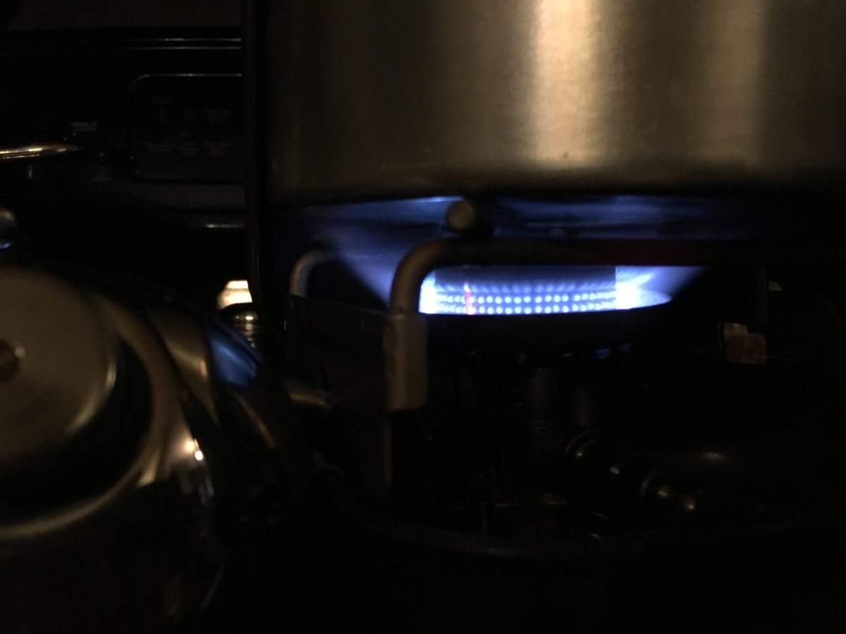

I found something that I think is truly amazing. An almost new 1941 Primus 41 with a nickel tank and the silent burner in almost new condition, with the original parts kit and box. I've also not before seen the spirits tin clipped to the windscreen. Here is an overall shot. The box and label. Apparently it sold for $19.75 at one point. Some shots of the tin exterior. The AF indicates 1941 as per the date chart. I don't know what the 17 means. Tin interior. Showing the "SWEDEN" markings, and the hinged control knob. This envelope contained a wrench, jet, igniter, and whatever that thin tin thing is... I need a new cap seal. this one is original and fairly hard. I forgot this shot of the back of the tin. There are holes in the shield where a tank shield may attach. I will have to make one. The old cork pip in the NRV is old and cork, and was leaking. Replaced with new viton from the Fettlebox. Glad I had them on hand. No lead washer, but I installed one. Flame shots. Tea time!
