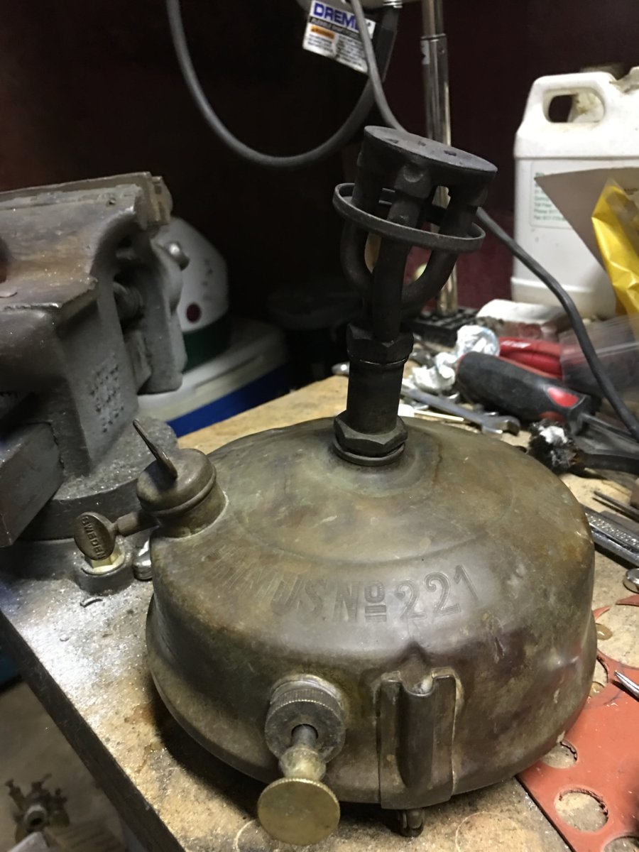

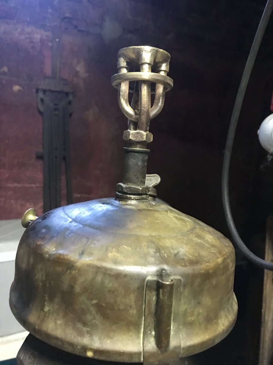

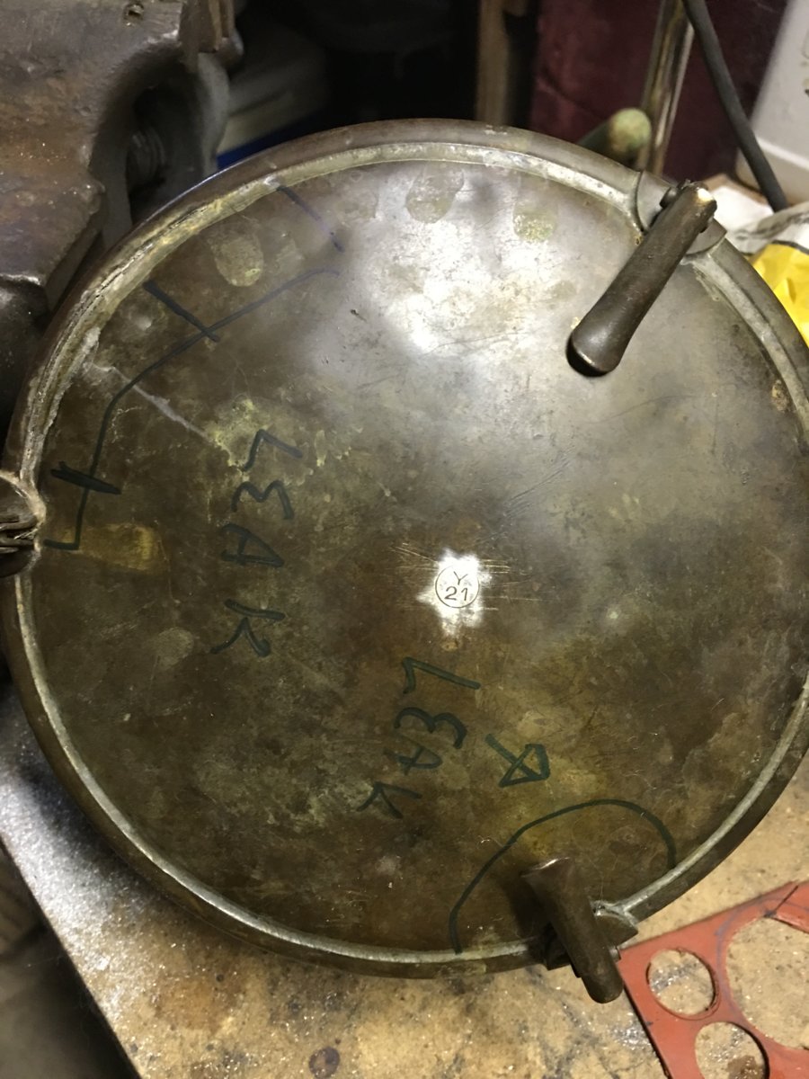

    she is very beat up looks a lot worse in person than in pix, :-k she has big leaks and a bent burner, riser, seams split but have always lusted for one =P~ and will have a go at this old girl; might not be purdy but she is mine :D/ :D filled her about 3/4ths with water and stuck in freezer earlier to see if can pop the biggest dents out,

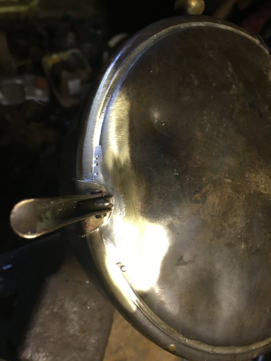

    IMG_2723[1].JPG IMG_2722[1].JPG IMG_2721[1].JPG IMG_2719[1].JPG IMG_2720[1].JPG
    Tony here we go ;)
    OK, got her out of the freezer and most of the big dents are popped out :D/; am not going to worry about the small :whistle: "to me" dings; had to heat the area around the riser a bit and after putting her in a vise and pulling after applying "blue wrench" propane torch and quenching,:-kleft me with the split seams which I just finished soldering, put water in her + wet rags over except where was soldering to hold off ruining[-o< the remainder of the seams, am going to let her sit tonight to see if she leaks; then have to straighten out her burner[-o<:(; HTH

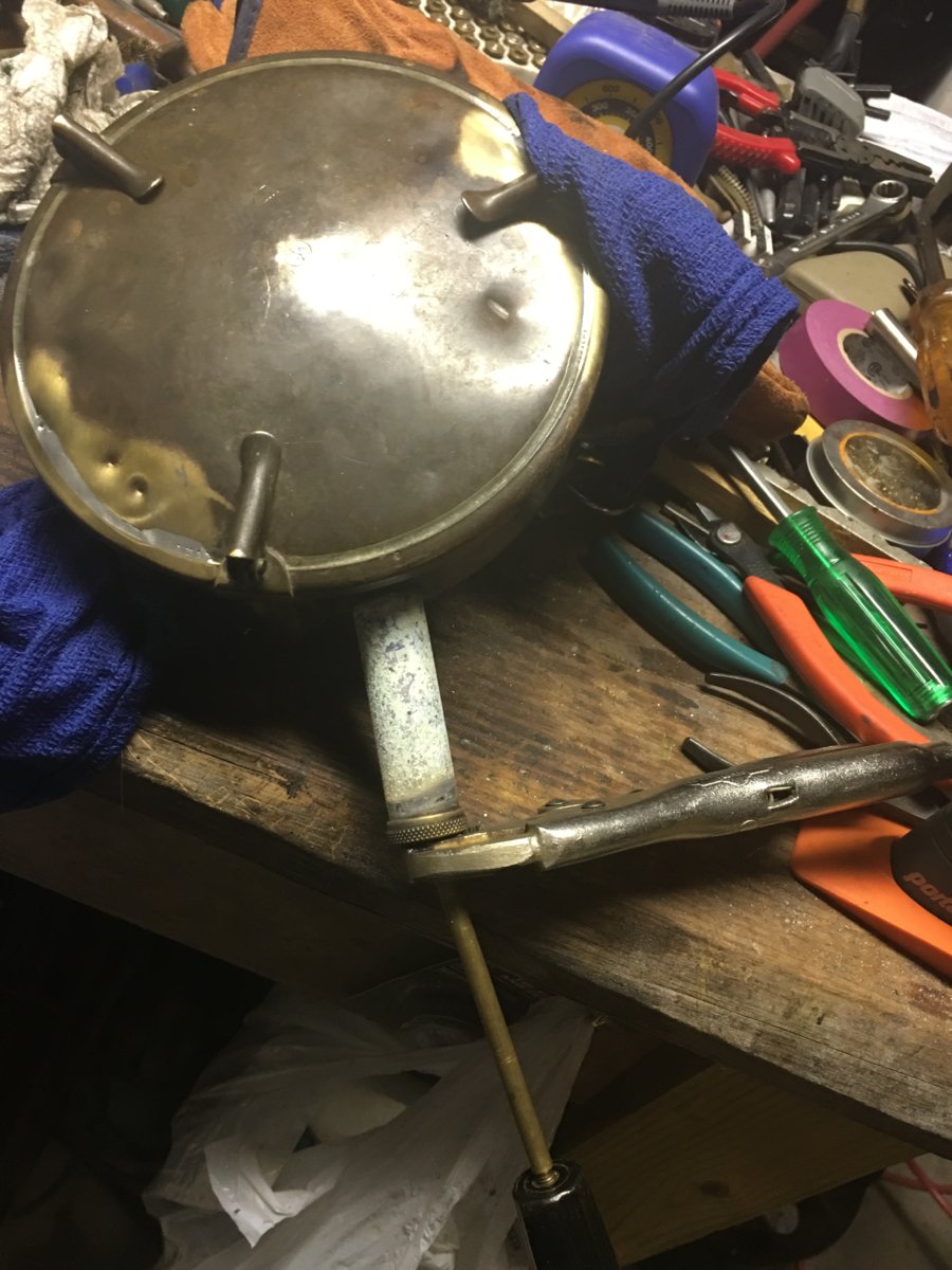

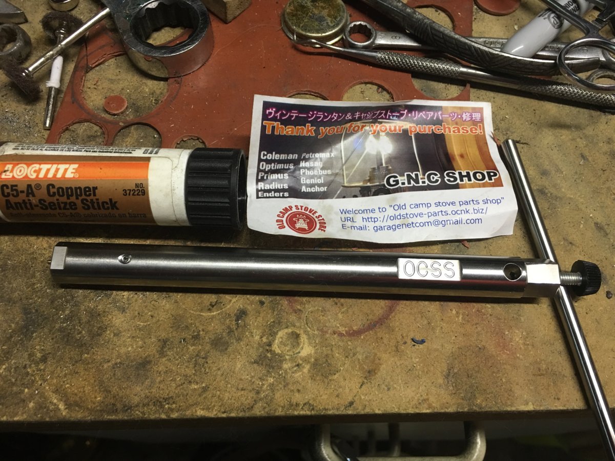

    well; guess the NRV is stuck; need one of Stu's magnificent NRV removal tool but no reply from Stu after a month; [-o<hoping he is well !; so went ahead and purchased the fancy NRV removal tool with the center guide pin out of Japan.............. put boiling water in canister so hot that had to handle the canister with welders gloves and it still will not budge ](*,)](*,)](*,):rage::-k next step is to desolder and remove pump tube :rage: will keep you posted on outcome
  8. n2666s
    Mar 29, 2014
    346

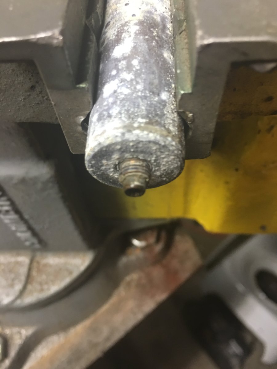

    now that I was able to remove the badly corroded NRV by desoldering the pump tube with 1/2 pint of water inside the canister IMG_2862[1].JPG IMG_2864[1].JPG IMG_2865[1].JPG
    and was able was able to get the inside of the NRV removed; but the male part that is inside the pump tube is stuck](*,)](*,)](*,)](*,):rage::rage:
    advice neede:?:; :-k do I heat and run the risk of desoldering the end of the pump tube:?:, drill it out and cut new threads:?: or just grab it with a pair of vise grips and give the remains of the NRV a massive counterclockwise twist:?: words of wisdom needed; cheers [-o<

  9. nmp
    Jul 10, 2011
    1,917
    I think which ever way you go you will end up wrecking the remains of the NRV.
    Soak in penetrating oil again warm it and try twisting it out!
    There is no easy answer, soldering the end cap back on is not difficult, but leaving it on the tube gives you more to get hold of while trying to remove the NRV.
    Try freezing it? Try tapping round it with a punch? To break the corrosion bond?
    Good luck Nick

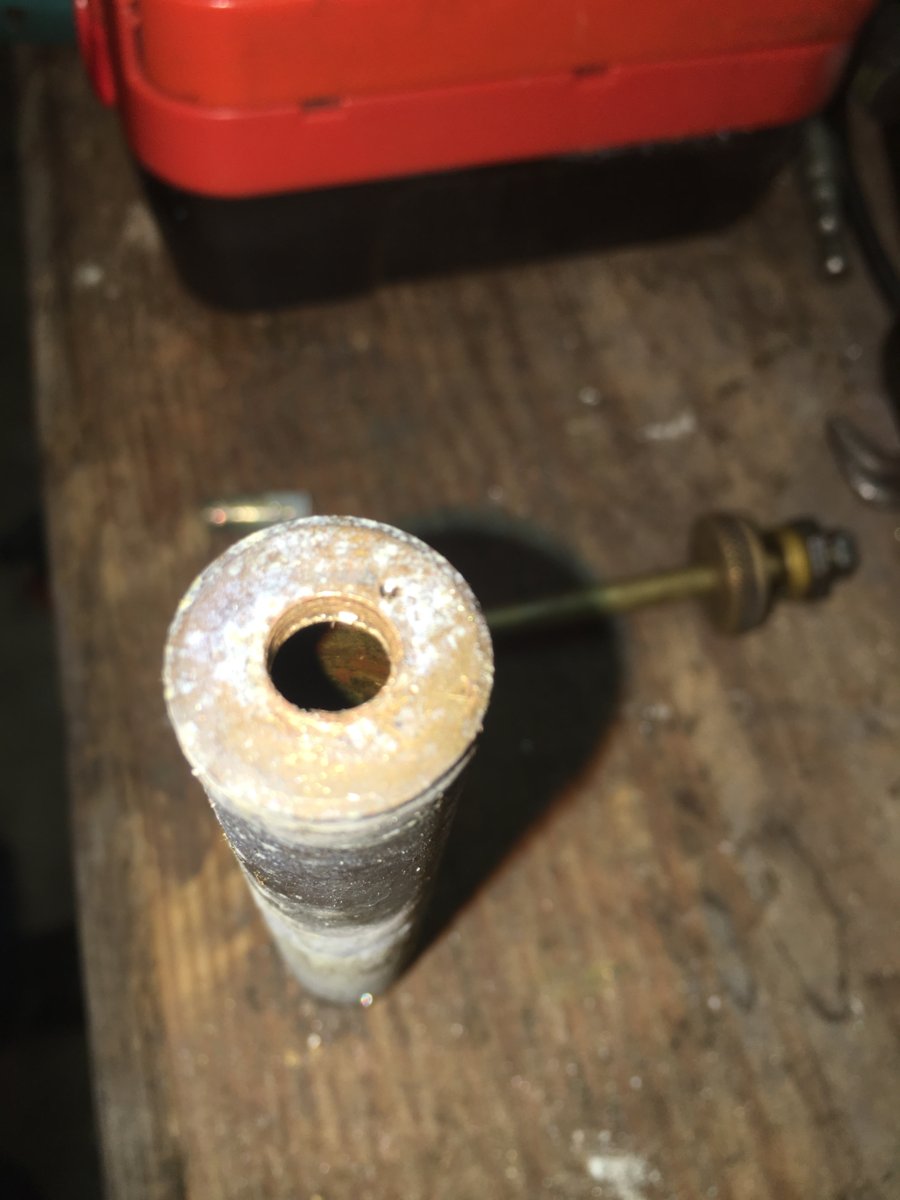

    OK; did the penetrating oil with touch of torch several times today[-o< but would not budge with visegrips ](*,):rage:](*,):rage:so ended up drilling her out conservatively but don't have a NRV handy to measure diameter and threads as :-k likely will have to cut new ones so will need the diameter of the male NRV the part that screws into the pump tube base + the thread pitch; info appreciated again thanks in advance;

    George; thanks again for your wisdom; think :-k have one last option and that is to insert a regular right hand thread wood bolt into the remains and see if can back it out that way [-o< might screw up the threads in the bottom plate though :-k

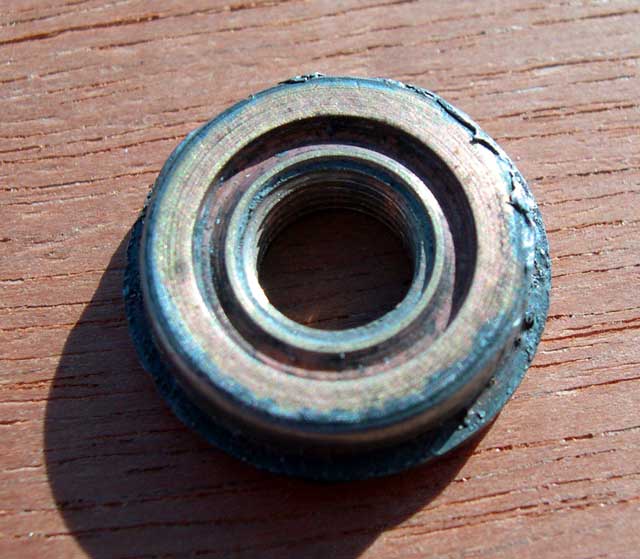

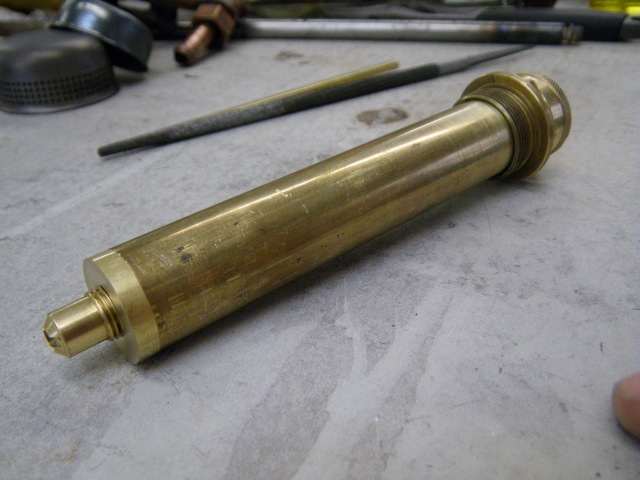

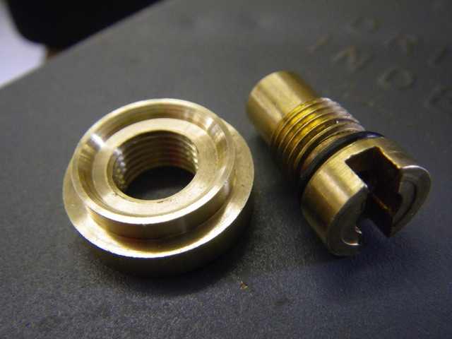

  12. teckguy_58
    Mar 20, 2011
    902
    Washington USA
    @n2666s
    Hi Lou,
    These NRV can be a real pain to remove even with the right tools.
    You might be able to remove the head with an easy-out but most likely the threads will be ruined.

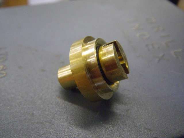

    You might want to go ahead and remove the plug at the end of the pump tube. I'm using some of the pictures in George's, kerophile, post.
    https://classiccampstoves.com/threads/pump-tube-nrv-assembly.14028/#post-138233
    Air-Pump-and-NRV-11.jpg Air-Pump-and-NRV-21.jpg Air-Pump-and-NRV-31.jpg Air-Pump-and-NRV-51.jpg
    I've never removed the pump tube before so I don't know what size the plug is. If the threads do get messed up you can either make another plug or if there is enough area on the plug maybe you could use a Coleman NRV.
    Here is a post John, presscall, did on using a Coleman NRV in an Optimus 22B
    http://www.classiccampstoves.com/threads/colemanizing-an-optimus-22b.18954/#post-194650
    The thread for the check valve is a 3/8 x 27tpi. Here are some pictures of a Colemanized No 12 stove pump tube. This mod was done by Gary Adam aka Bernie Dawg.

  13. n2666s
    Mar 29, 2014
    346

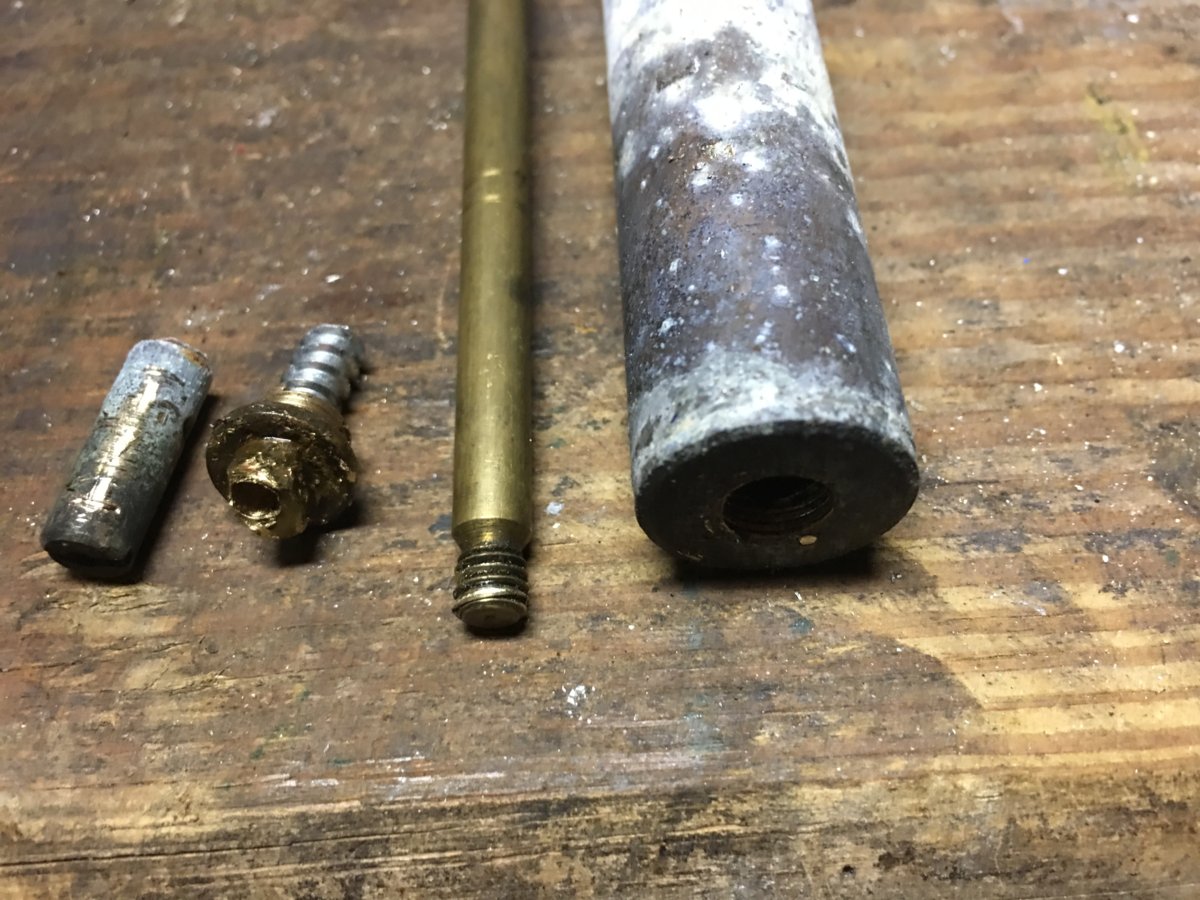

    OK, was:-k thinking if I totally screw up the threads[-o< can use Norms/BDs idea of Colemanizing the pump; here is how it went; IMG_2878[1].JPG
    strong steel # 12 wood screw; began threading with screwdriver then held the screw head with the vise grips; threading it clockwise from the base; :D/:D/ it is loose:D/:D/;
    loosy goosy:D/:D/ cut head off with bolt cutter; whoa :!: =;=; how are the threads:?: in the pump base:-k [-o<
    not pretty BUT if can get it to seal all is well [-o<
    the inner part <inside the tube> with cut off screw and NO washer beneath NRV:rage: threads as far as can tell are 8M x 0.8 M metric; :-k Japanese NRV extract tool.jpg will try to clean things up a bit more and find a loose NRV; hate to take one out of a functional stove though even if it is loose;
    pix of the lovely Japanese tool :thumbup: and the antiseize to put her back together and pray she doesn't leak [-o< fettling old stoves makes one curse and pray 'tween breaths:)
  14. nmp
    Jul 10, 2011
    1,917
    It is always a bit of a gamble getting the NRV out!
    That one looked really stuck so you have done well with the minimum amount of damage, it cannot be avoided sometimes and you still have a chance of breathing life into the old girl again. Great idea using a screw from the outside like an easy out!

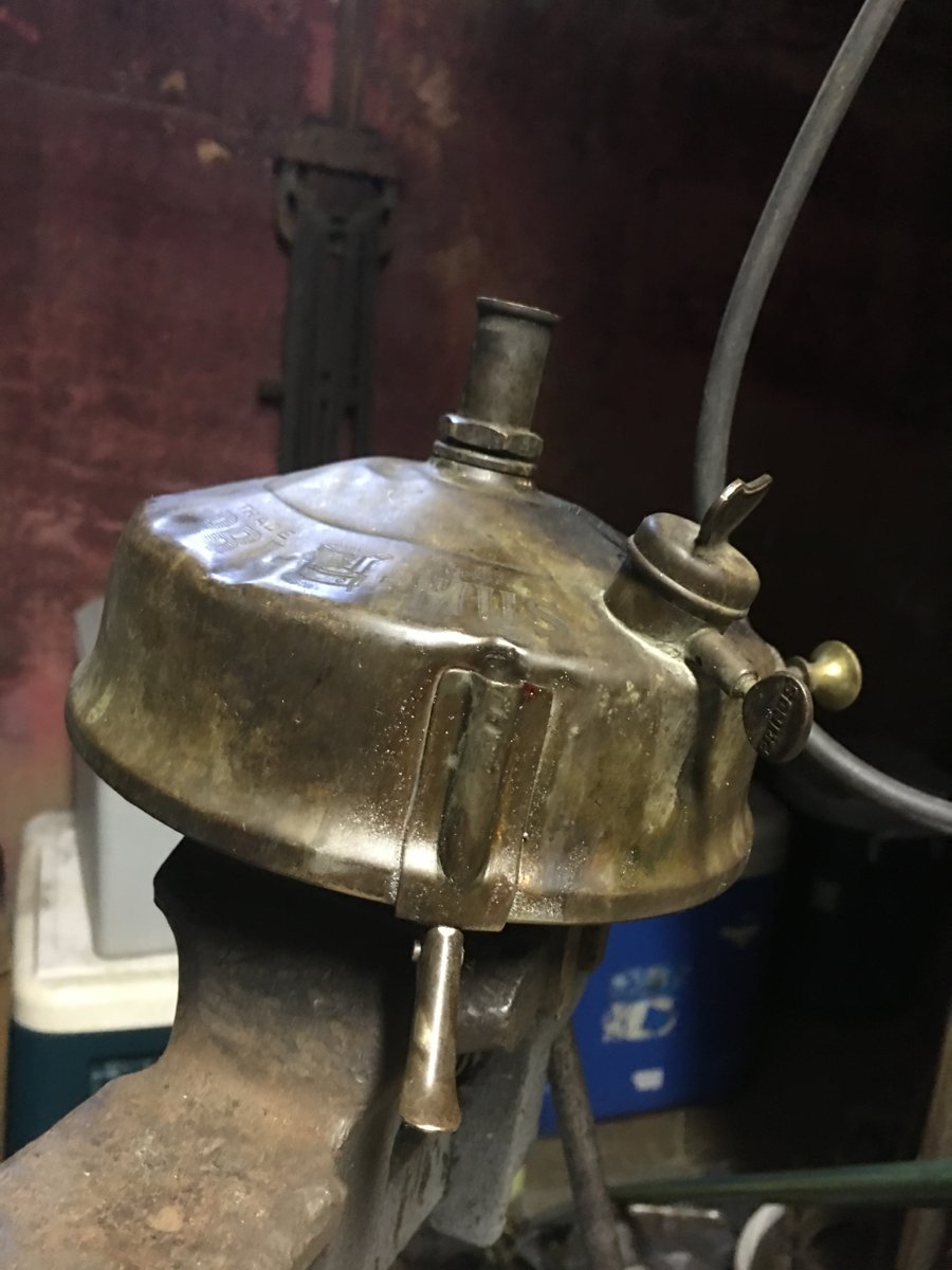

  17. n2666s
    Mar 29, 2014
    346

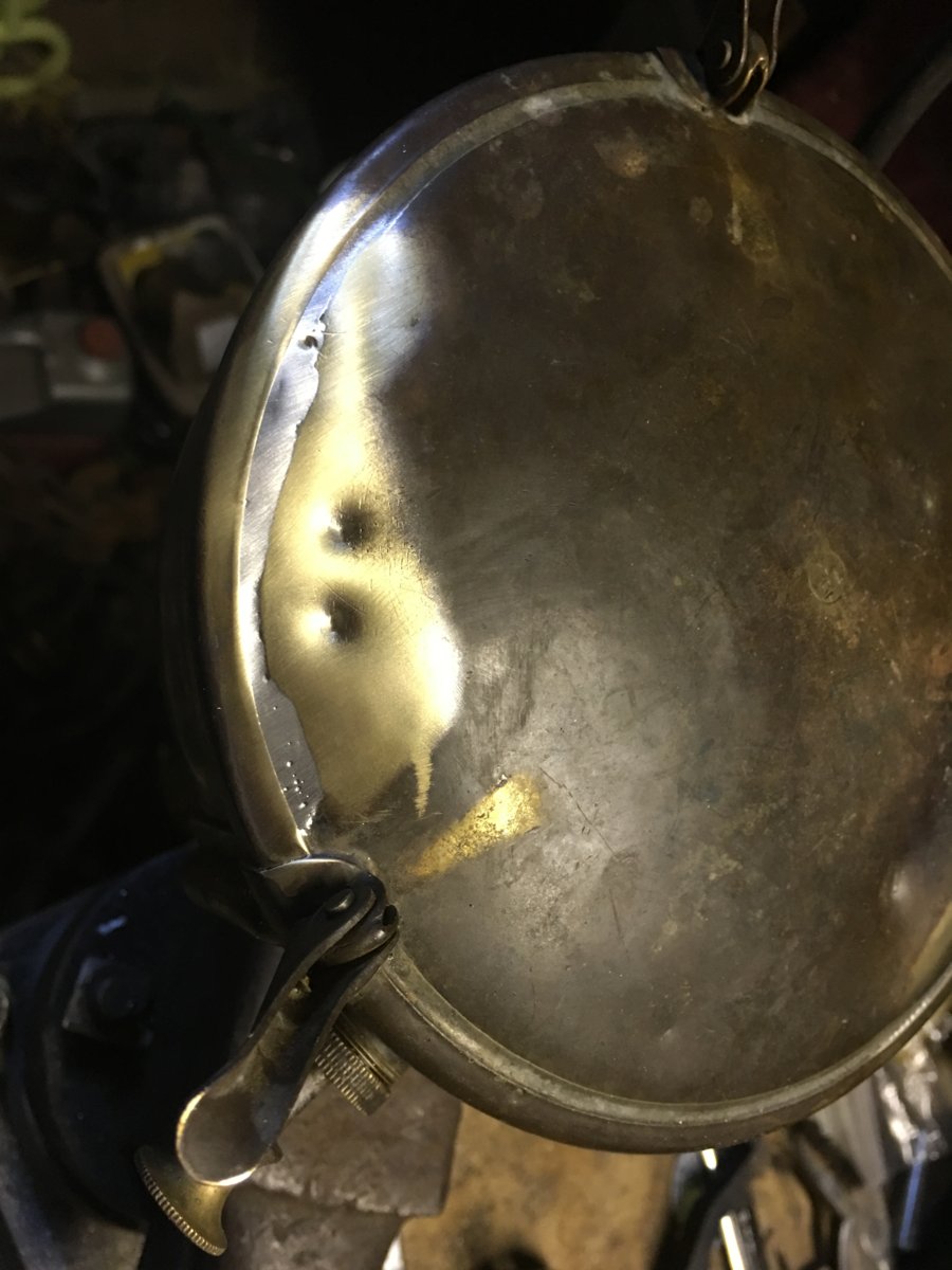

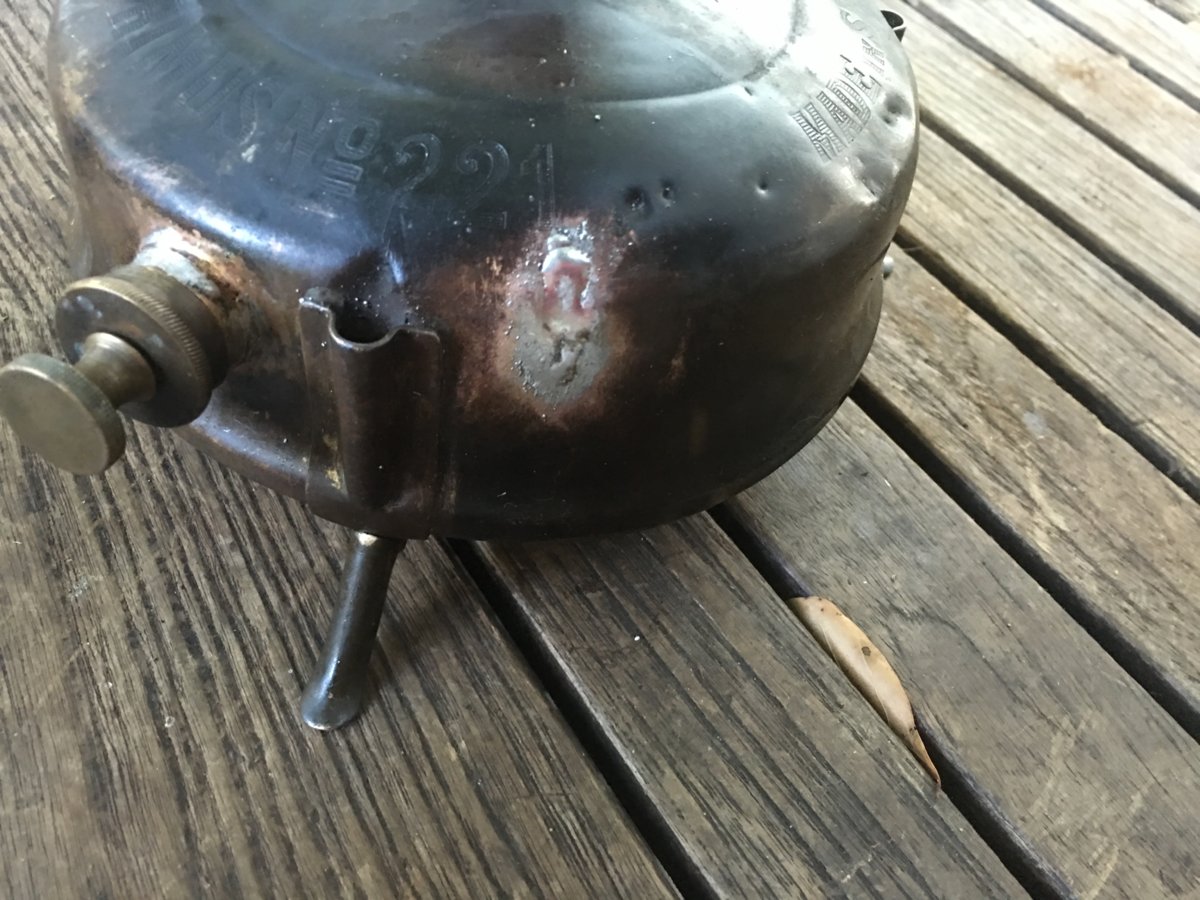

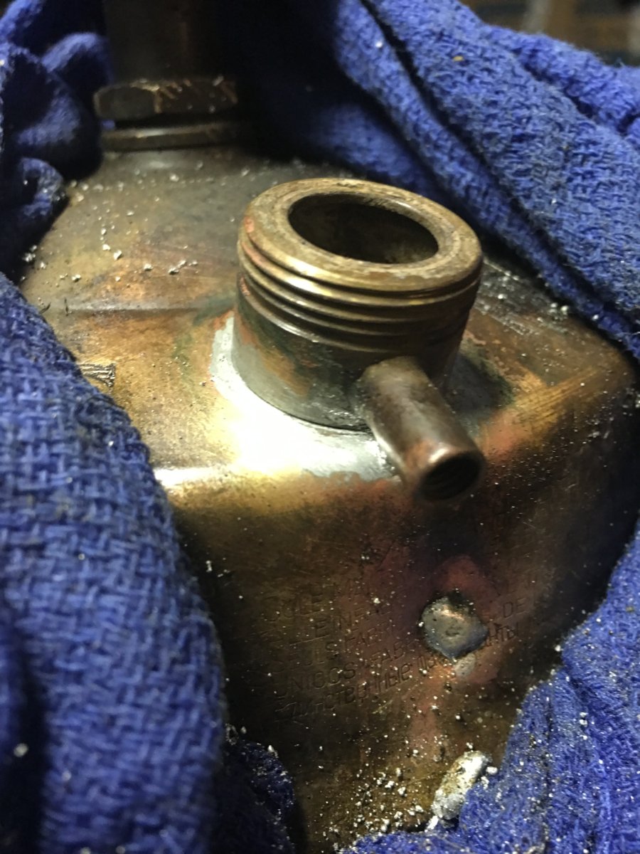

    found a couple of "dents" had punctures in the bottom:cry:; placed ugly solder patches without bothering to attempt to pull dents out as she will never be a looker;) IMG_2893[1].JPG IMG_2894[1].JPG just want her to be a worker so pressurized again and now found a leak at the neck base of the filler opening :rage::rage:](*,)](*,)](*,) IMG_2892[1].JPG
    those dents almost look like some one might have used her a a target for a "BB" gun :rage:

    You soldering of the holes looks authentic given the condition of the rest of the stove!
    Keep at it! You will win eventually.
  19. n2666s
    Mar 29, 2014
    346
    Thanks Tony :thumbup:; yep, no pretense here :lol: just have lusted =P~ after a 221 for a long time but all the ones have seen are a bit beyond my finances till I saw this sad old girl that had her burner tilted cockeyed like a cap on a drunk sailor :roll:...............will give the filler neck a go when I get up; cheers ;)

  20. n2666s
    Mar 29, 2014
    346
    fettled this leak on the base of filler tube earlier today; will try to fire her up again this evening and see if any more surprises ](*,) she has had quite a few for me :lol: :-k looking at the bottom part of the filler tube might have to go over it a bit more; soldering a circle can be painful :cry:[-o< IMG_2899[1].JPG
