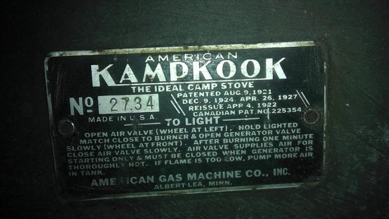

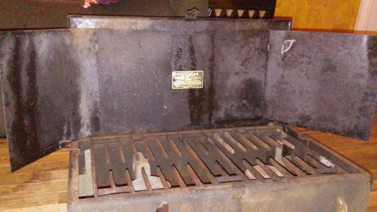

    I was trying to find information about my AGM Kampkook 2734. There doesn't seem to be a picture on the forum so I will attempt to add one. There was some literature, extra burner pieces and a couple generators stored in there. It's pretty heavy. I would like to find out more information on this machine.

    Trying to add more .......

  8. chainsaw.enthusiast
    Jun 3, 2014
    7

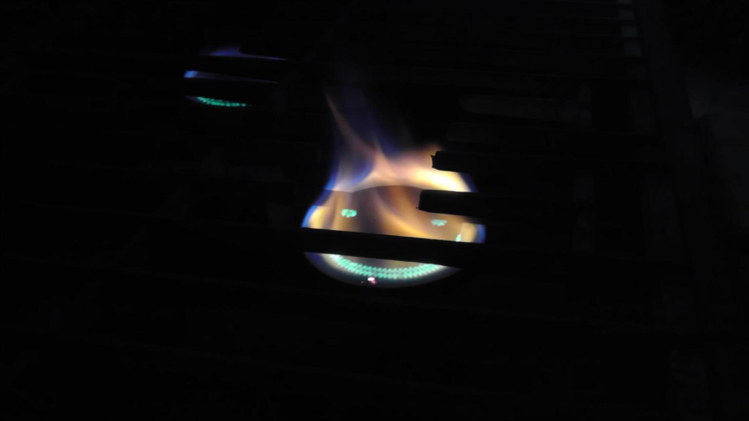

    It works. Somehow or another people are able to take pictures where both the flame and stove are visible. Not so much these pictures.

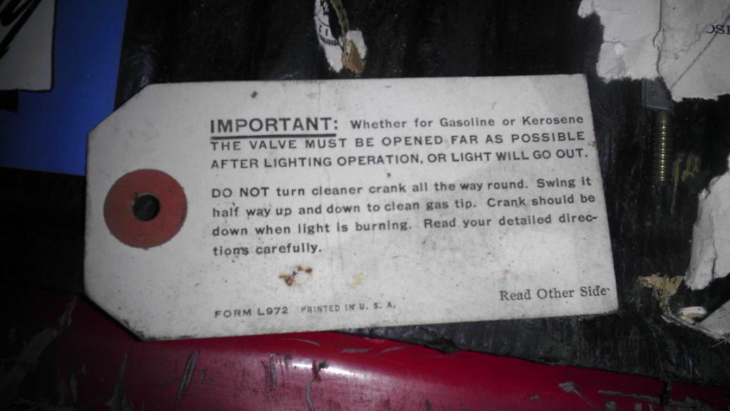

  9. chainsaw.enthusiast
    Jun 3, 2014
    7
    Literature. Closeups are available.

    It dripped a little from the control knob so it was taken apart to get at the packing. There wasn't packing, or any place for packing so it was cleaned up and reassembled. It didn't drip after that. The plunger needed some oil and away it went. Probably would need additional attention to the plunger for actual use. It's pretty cool. I don't usually bother to fire them up but. Inspiration or something...
