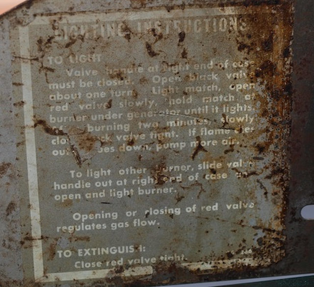

    This later AGM stove has a cast iron burner and the massive leaded gasoline generator. This generator supposedly filters lead from gasoline and does best with a lot of preheating. It can flood spectacularly without enough preheating - if you let it.
    The little black wheel is similar to the Coleman lighting lever, but needs to be opened a few turns as the stove is preheating. (It adds air to the fuel to make it an instant-light stove.) It can then be closed when the stove is ready to cook. There is no separate fuel cap, the entire pump is removed to fill the fuel tank.
    The KampKook Kamper (decal) lost his hat, the decal shown is from a very similar model, the LCS-31.

    Hi, I just got one of these stoves, but what is the correct way to light it?
  4. StanDahl United States
    Jan 9, 2014
    30
    Here are the instructions from the LCS-31:
    "To Light:
    Valve handle at right end of case must be closed. Open black valve about one turn.
    Light match, open red valve slowly, hold match at burner under generator until it lights.
    After burning two minutes, slowly close the black valve tight.
    If flame dies out or goes down, pump more air.
    To light other burner, slide valve handle out at right end of case and open and light burner.
    Opening or closing of red valve regulates gas flow.
    To Extinguish: Close red valve tight."
    I would recommend giving it plenty of time to preheat to make sure the fuel will vaporize and it won't flood.
