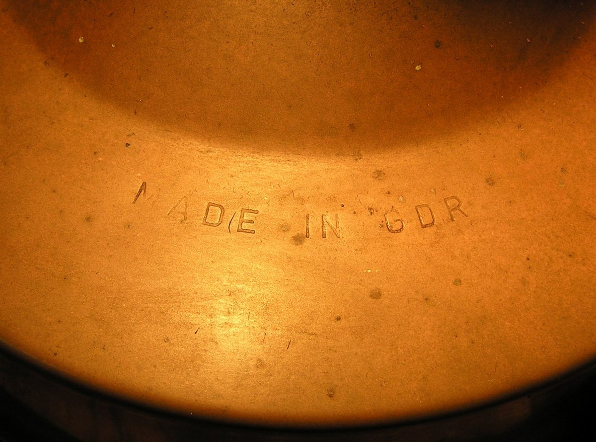

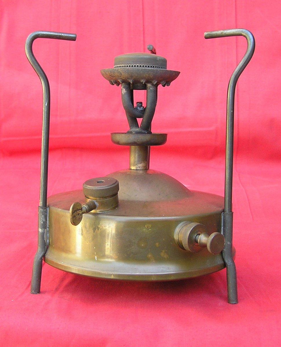

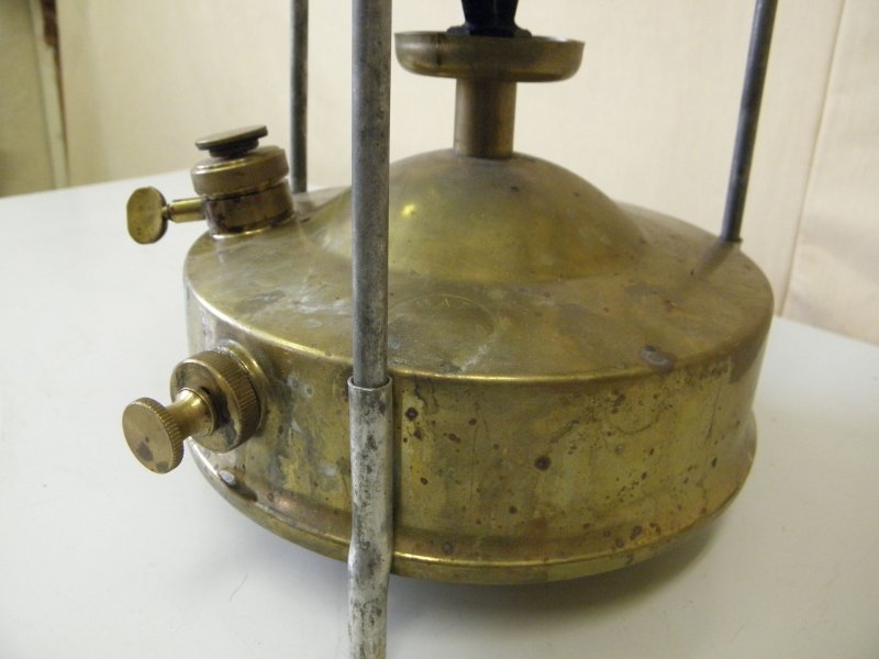

    Didn’t think this one would take much fettling. Replaced the filler cap seal, the burner seals and gave it a good clean out. Pumped up pressure and no leaks.
    2 pint kerosene / paraffin stove.
    No model Number on stove
    Silent burner
    Made in GDR (German Democratic Republic)
    Steel feet made from split tube.
    Riser fixed with steel fuel pickup tube.
    Removable pot supports.
    Although the pot supports are removable the burner connection is a fibre washer (not lead) as found on the standard fixed leg #1 or #5.

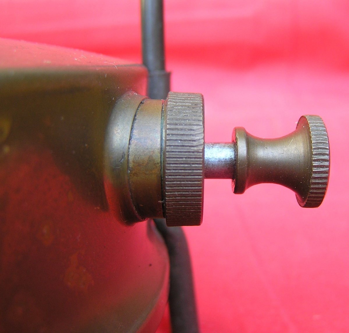

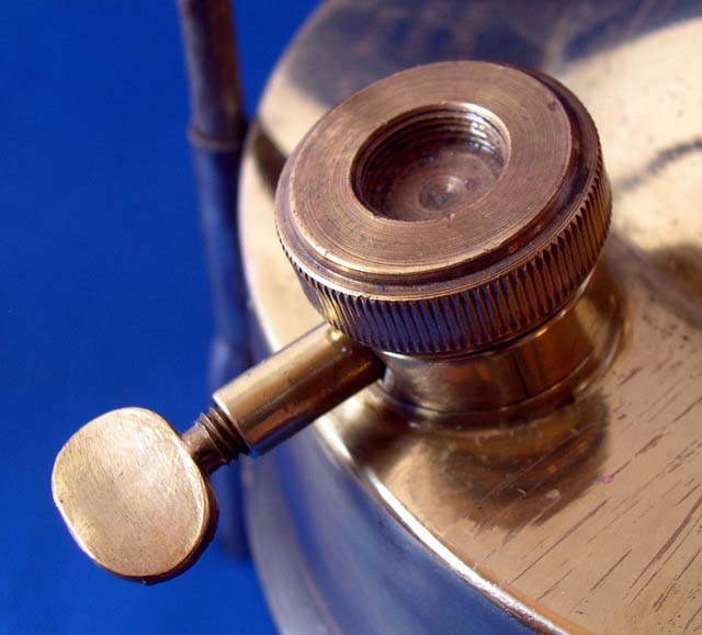

    Note. The reserve cap is missing but would normally fit on the filler cap. The mounting screw thread in the cap is approx. ¼” / 6mm.

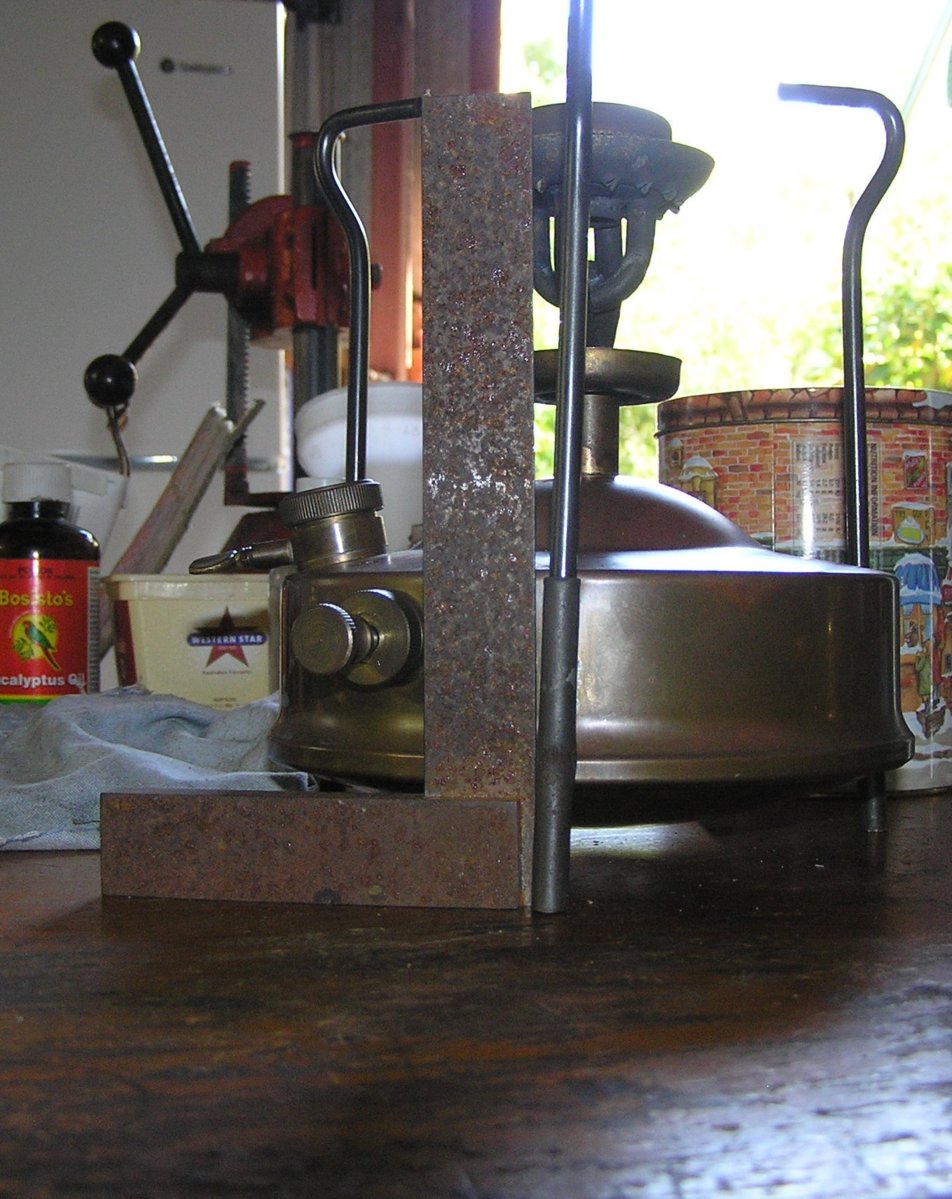

    When I sat the trivet on the pot supports it did not centre over the burner (really bad alignment). The burner was straight so wasn’t the problem. Placed a square against the legs and found the problem. Two of the feet were not soldered on square. Photo shows the worst of them.
    So won’t use the trivet.

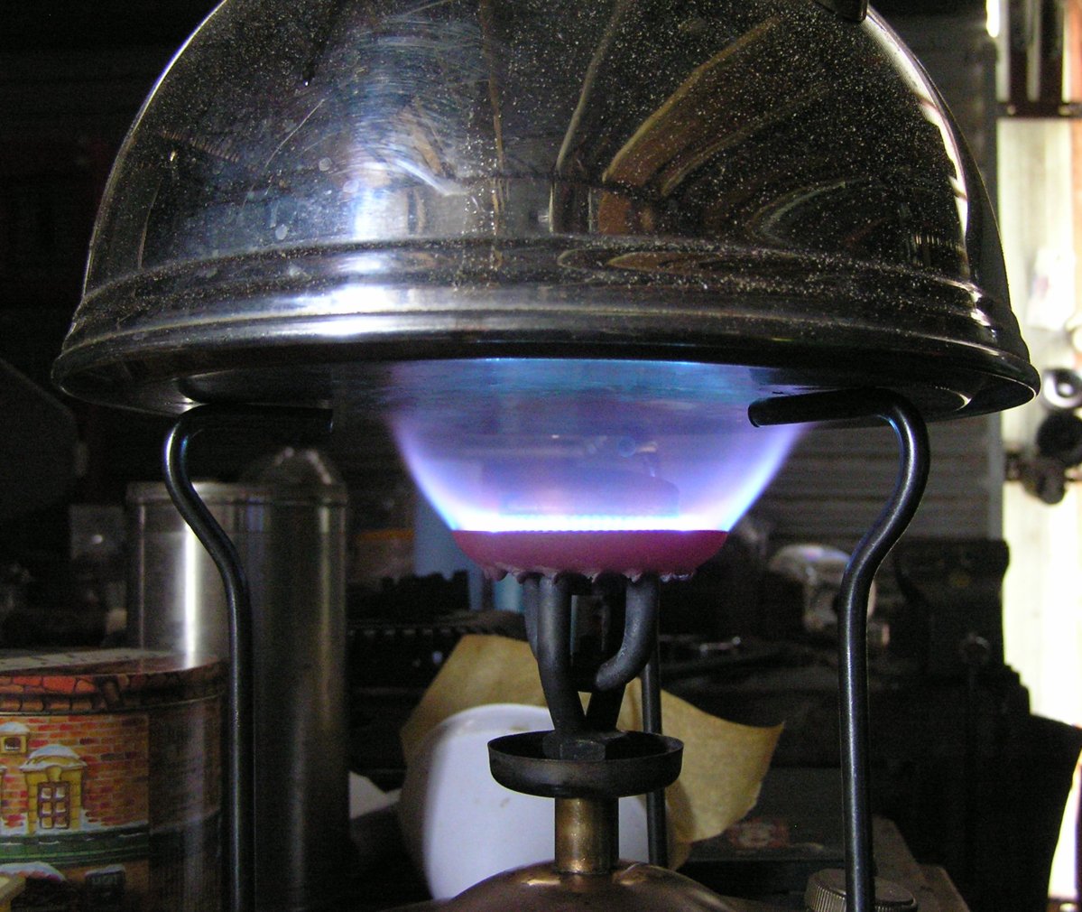

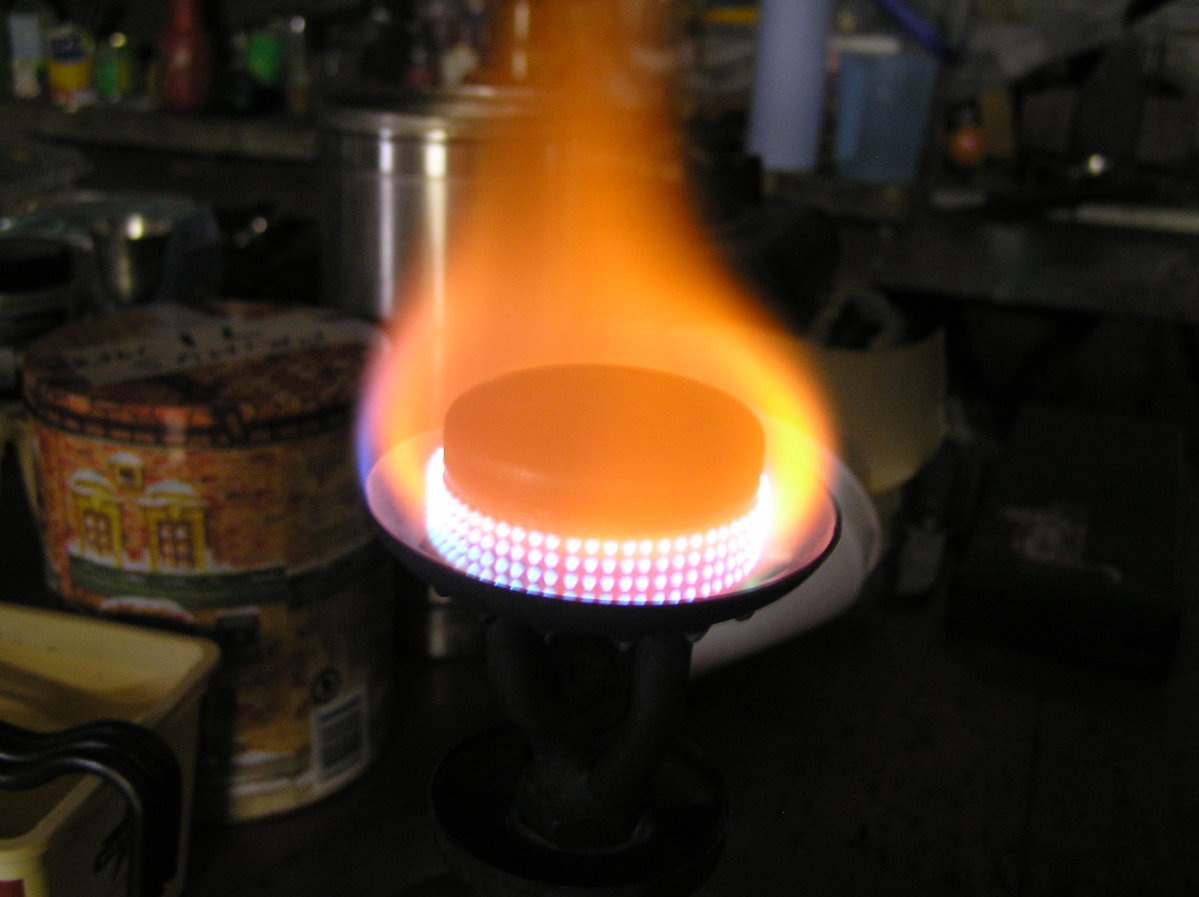

    OK primed the stove and I had flame. It was rather yellow and didn’t improve.
    Replace the jet and it helped but still yellow.

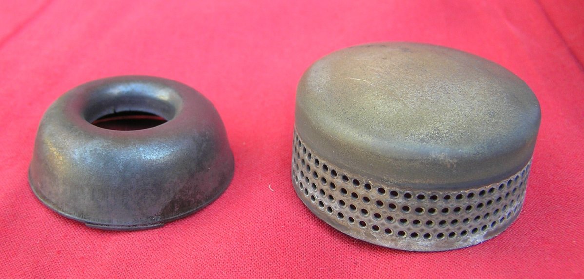

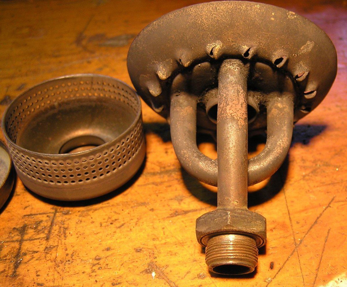

    A closer inspection of the burner caps found a problem. The bottom edge the inner cap had a lip (can be seen in the photo of the caps above) that stopped the cap sitting flat. Remover the lip and the colour improved but still yellow. Now have blue flame.

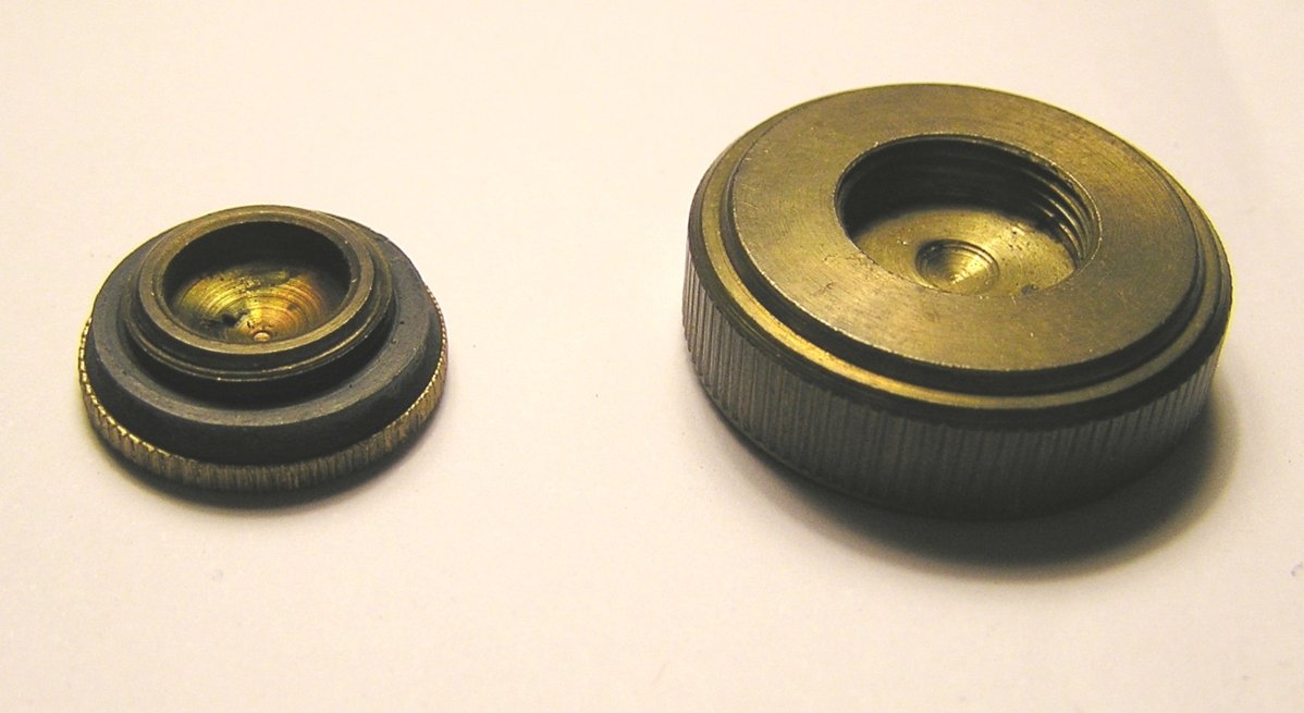

    IMO This is proper fuel cap - without reserve cap (from Kerophile)
    Yours - is from other stove

    here - Hipolito - f. cap

    Thanks for the picture above of a stove with this style of filler cap and reserve cap. I now know what I am looking for but think I will have trouble finding one.
    It is definitely a strange design for a reserve cap as there does not appear to be much thread.
    FYI the hole in the filler cap is blind and does not go through the cap.

    If I understand correct,the question is will this cap combination fit my stove?
    Answer is No. :(
    The f. cap fits but the reserve cap is too small (13mm diameter thread). The thread on my version of the stove is 14.5mm diameter (14.5x0.75mm).

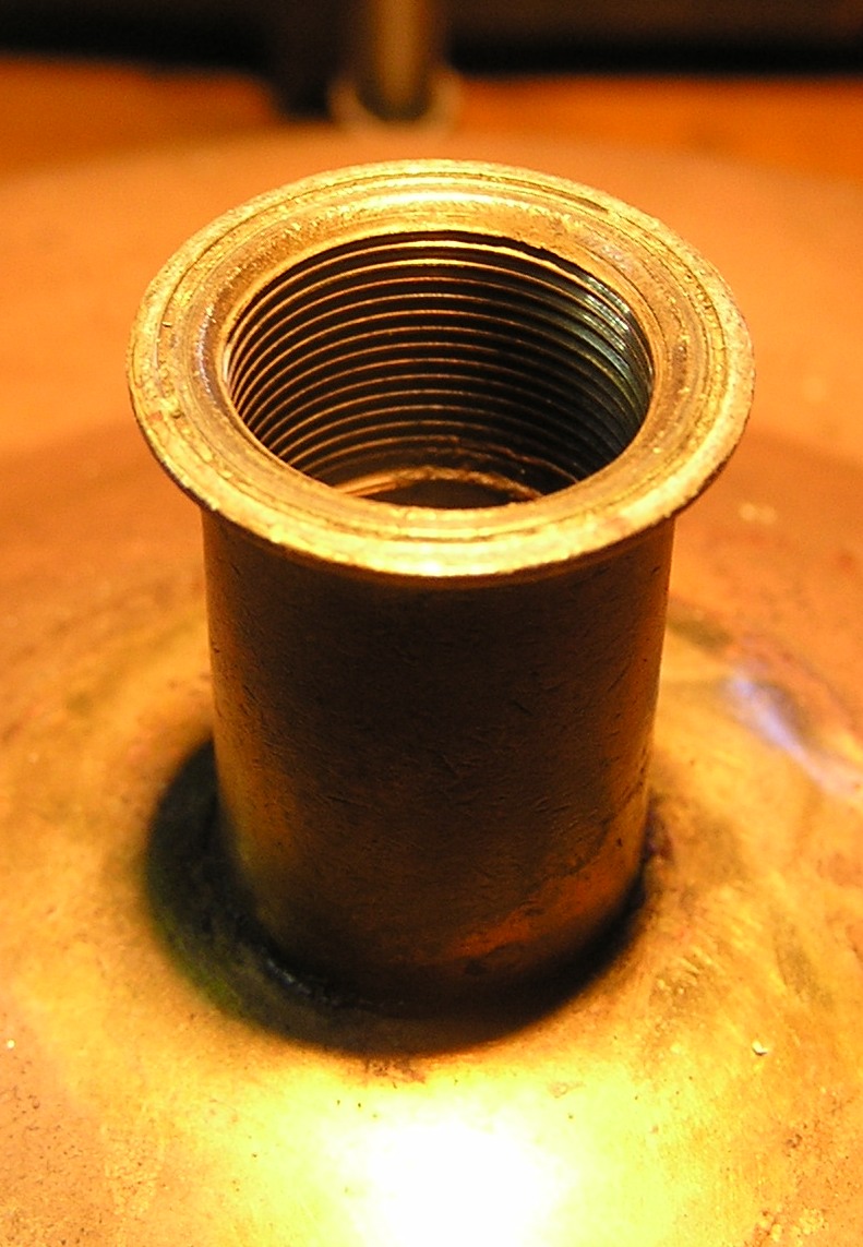

  13. ROBBO55
    243
    Thanks @Radler

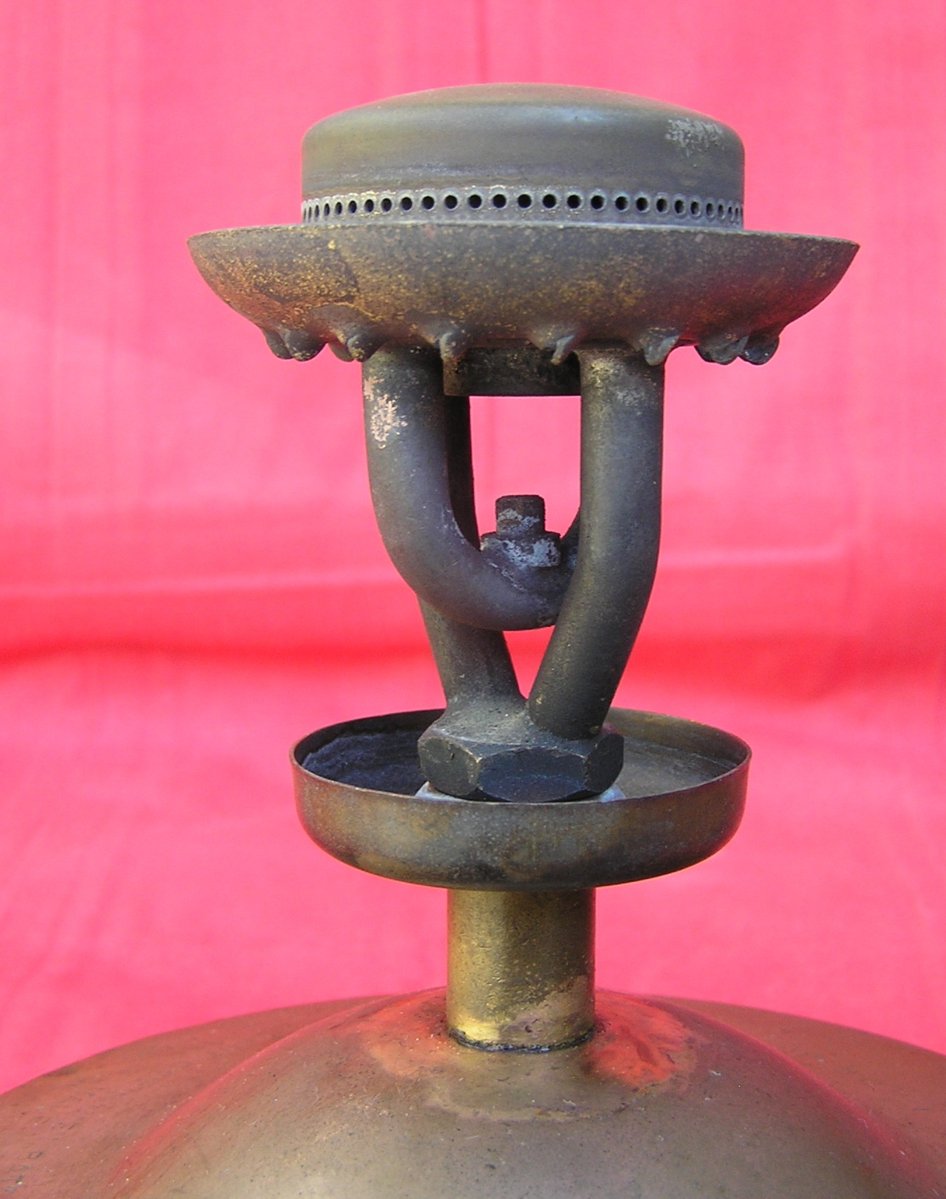

    Here are photos of the burner and riser connection. I don't know how many times the fibre washer would last being taken on/off. A lead washer under the priming cup might work??

    Thanks for the pictures. I expected something different than just a standard connection because of the travel cap parking thread. :(
    I have the same doubts as you about the fibre gasket. Most of them only survive ones or twice unscrewing of the burner. A lead gasket is only usable in a special connection where it can't creep out and maybe the temperatur could even reach the melting point of lead (330°C).
