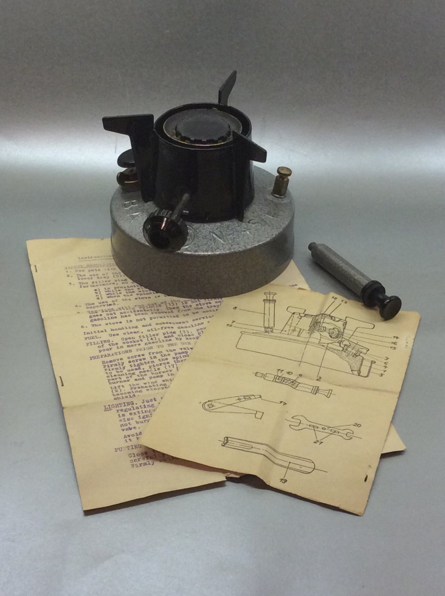

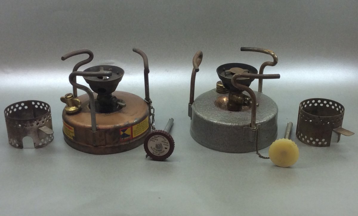

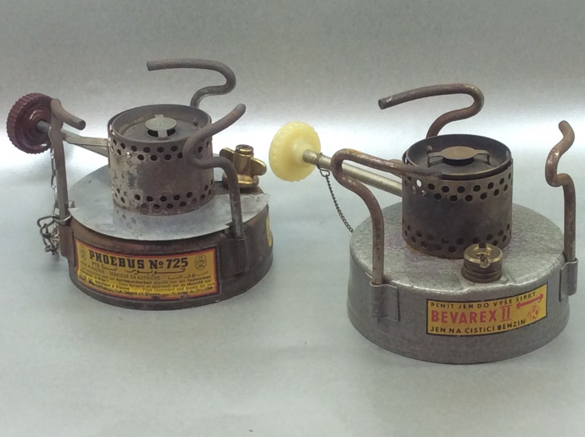

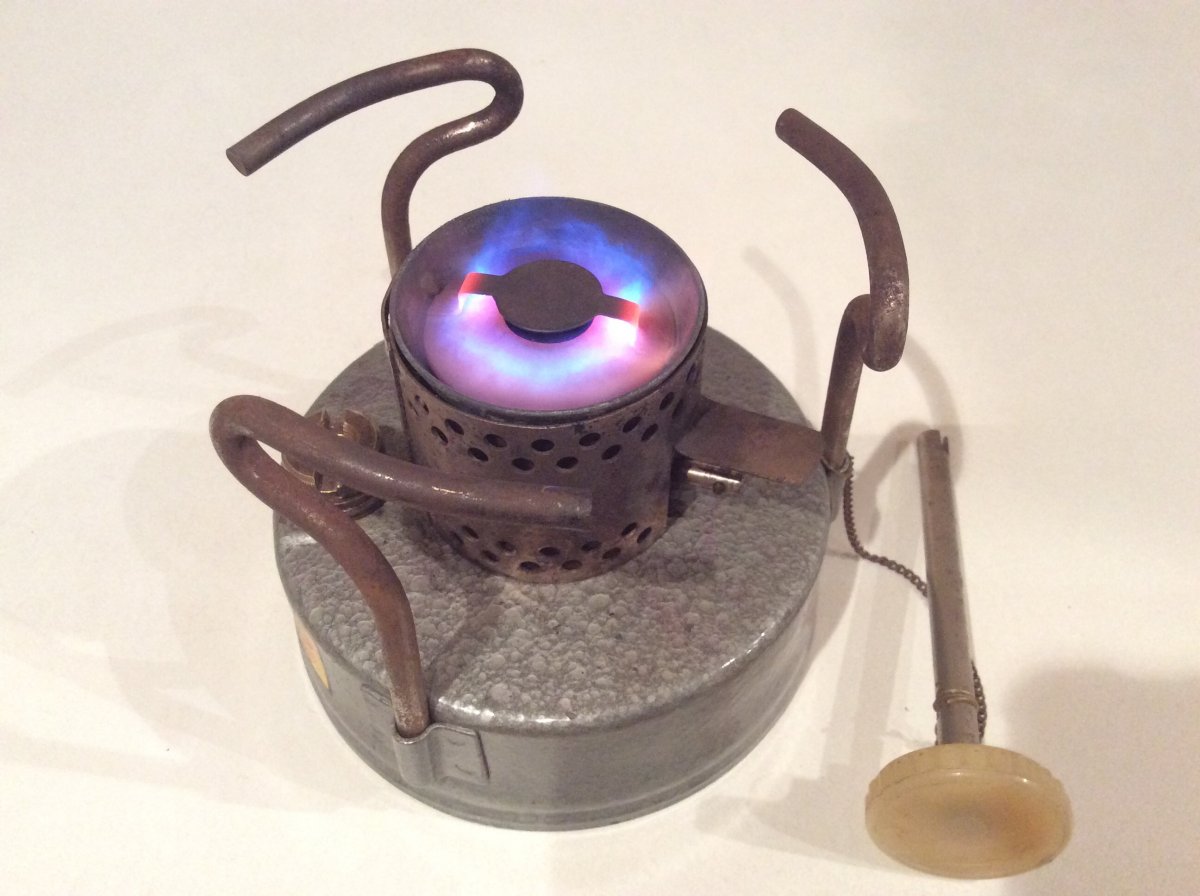

    A very close match, Bevarex on the right
    A tell-tale perhaps that the manufacturer intended the stove to have the stove with the same gold paint finish is the paint finish exposed by the burning away of the top coat in the primer cup

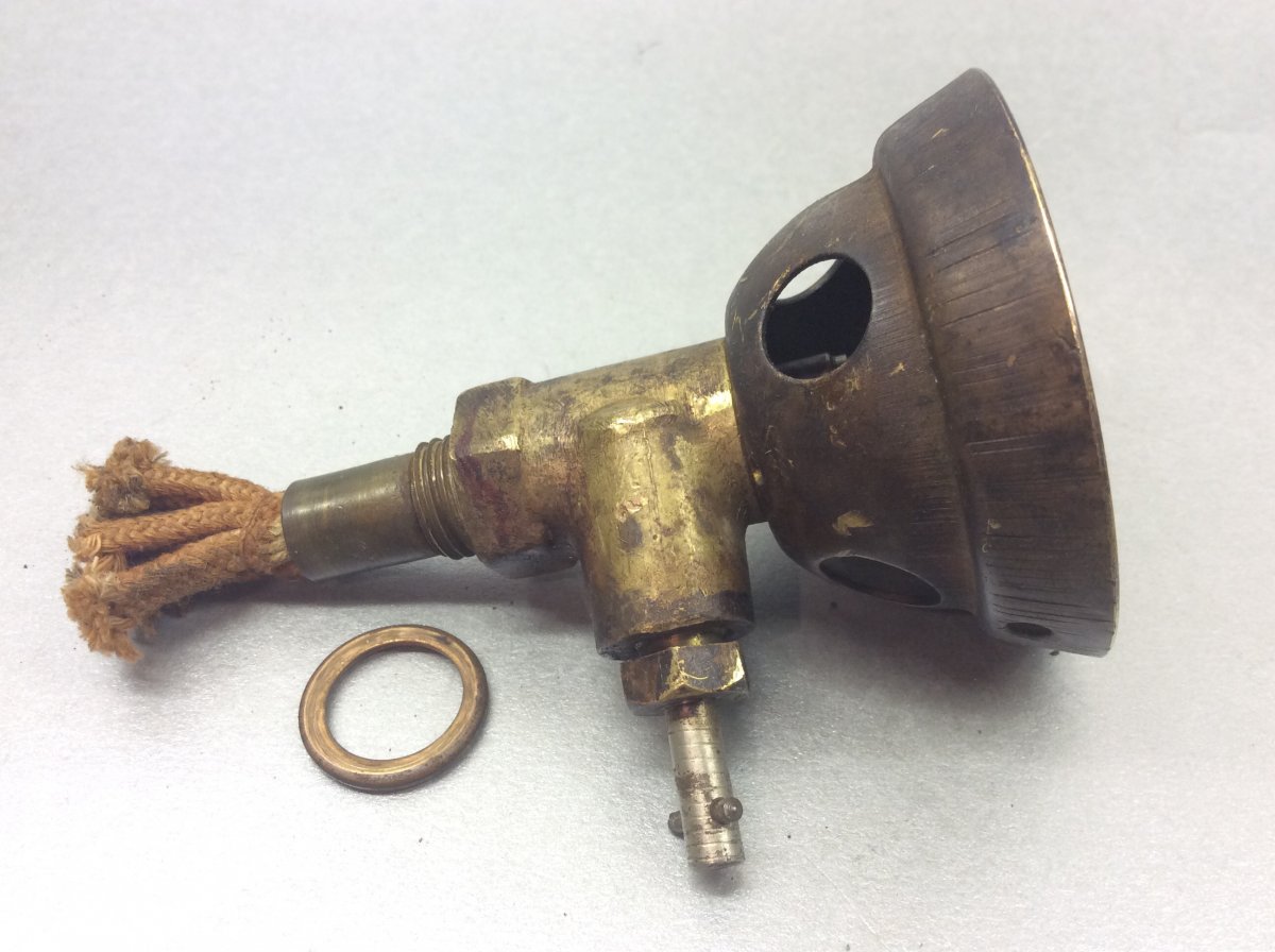

    The Bevarex burner seals to the tank with a crushable brass washer, which I annealed by heating it up to red heat before reassembly

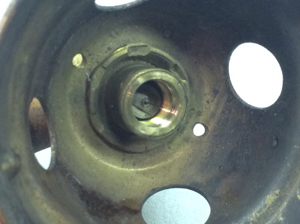

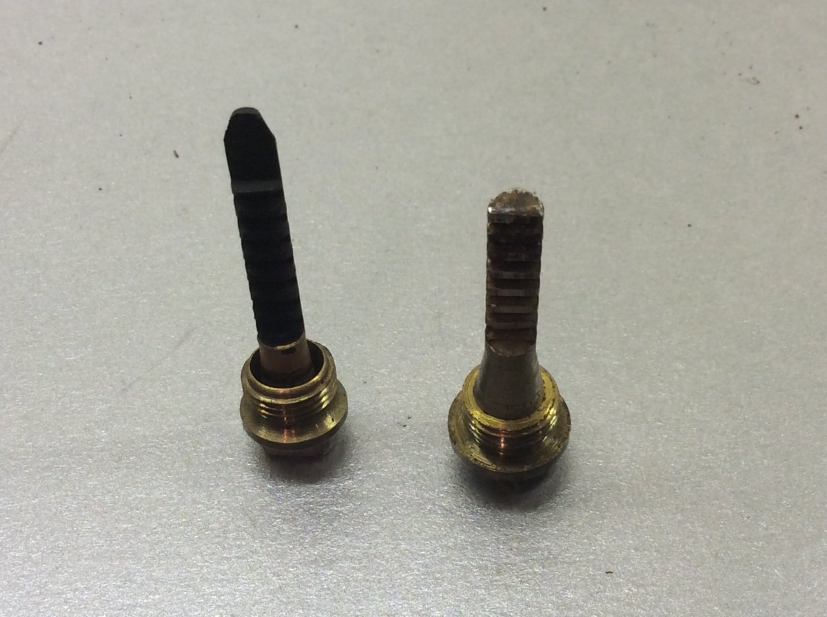

    Some detailed differences between the pricker rack/needle assembly and jet. The Bevarex doesn't have the feature of a replaceable needle as does the Phoebus (on the left)
    On the Bevarex, only the tip of the pricker wire enters the jet and doesn't project through to the other side, but does the job
    Both stoves achieve shut-off by having the tapered shoulder of the pricker mount make a seal against the rim of a constriction in the riser tube, just above the regulator pinion

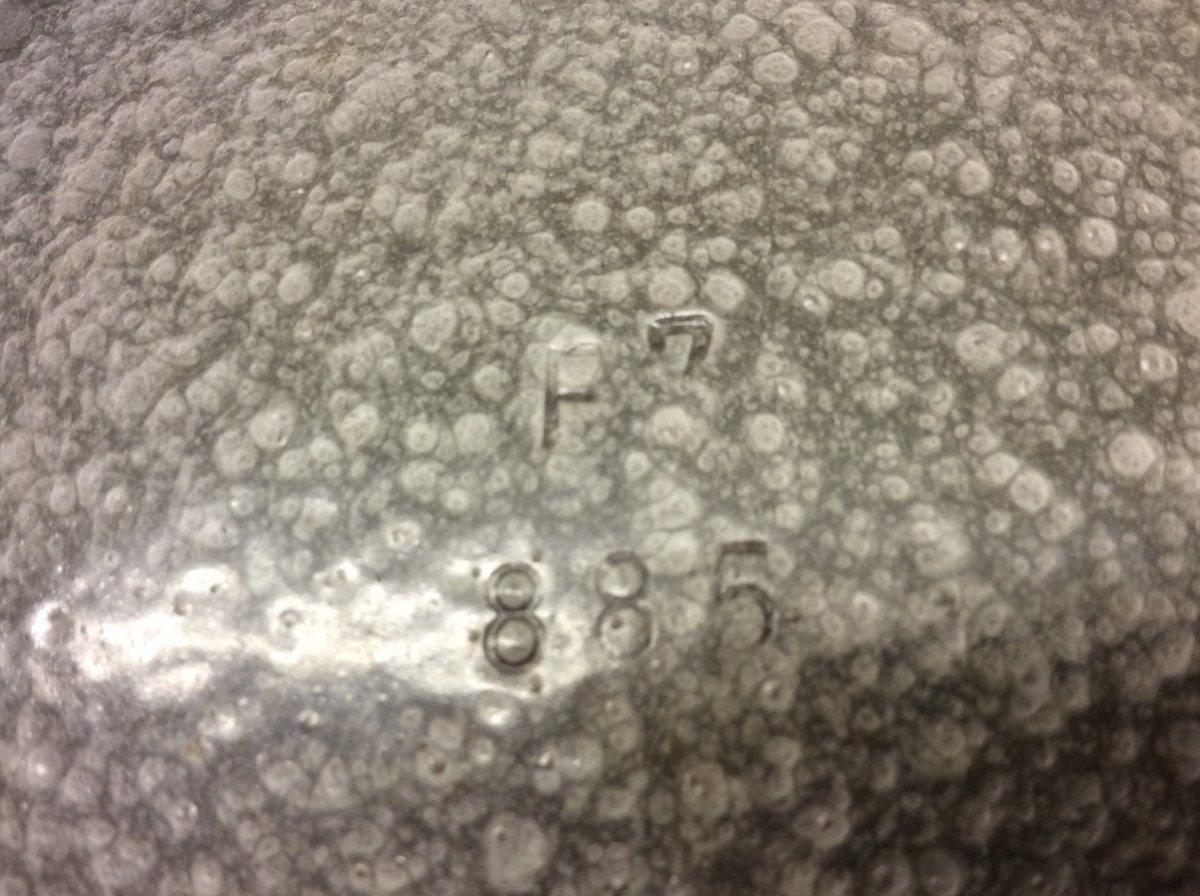

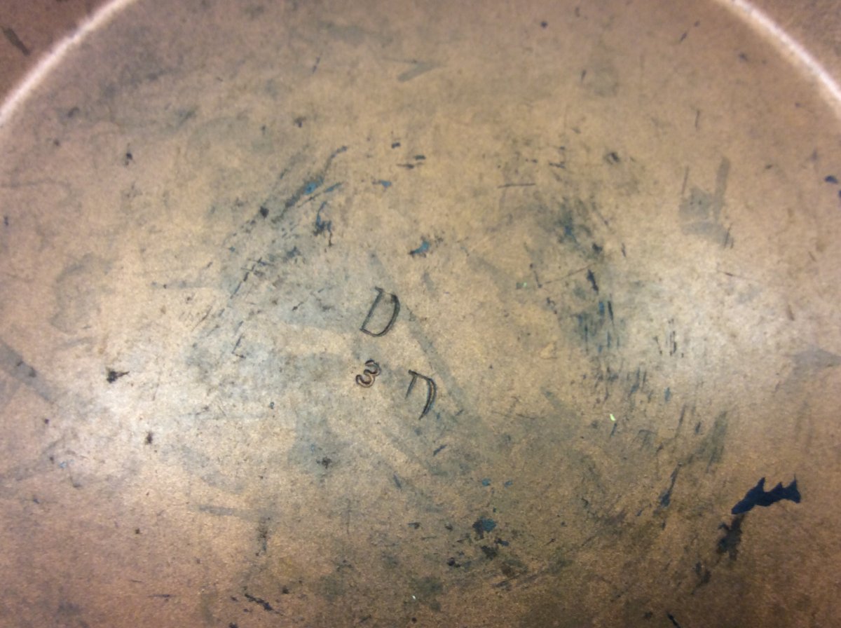

    The bases
    I'm unable to interpret the stamping at the centre of the base of either stove

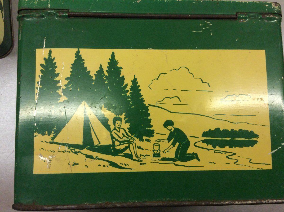

    The boxes. That of the Bevarex is roomier
    Bevarex box graphics

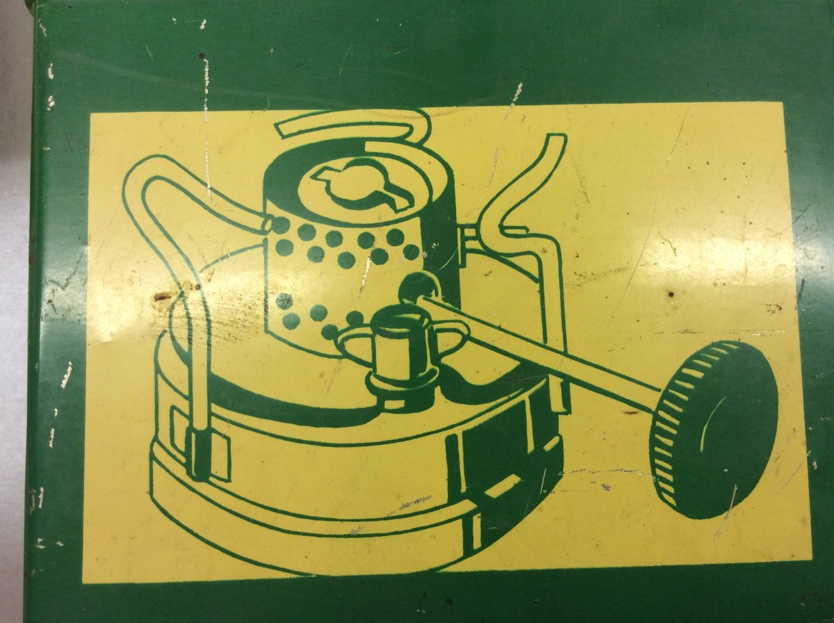

    Curious that the illustration of the stove is a clear representation of a Phoebus rather than the Bevarex - filler cap/safety release valve and windshield (separate brazed-on lifter handle on the Phoebus)
    The graphics on the Phoebus tin
    Fuel tank decal on the Bevarex

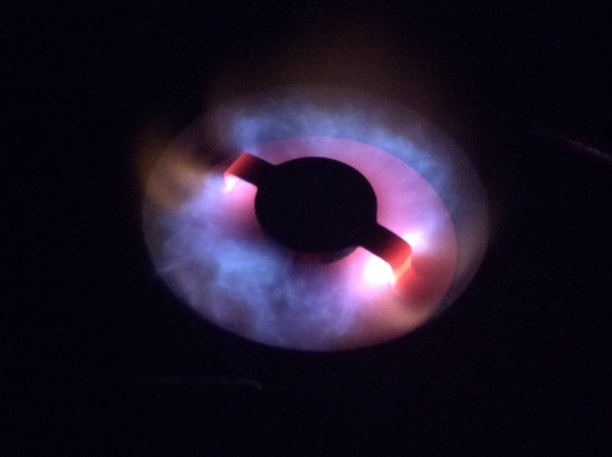

    Filler cap and safety release valve seals replaced, then fuelled up, primed with alcohol and away it went. Indistinguishable performance from that of the Phoebus, unsurprisingly

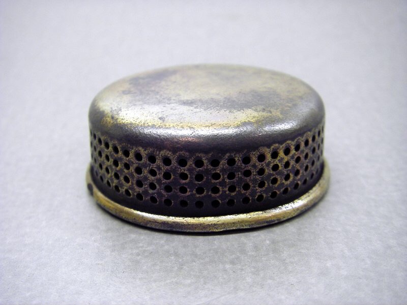

    Good result too with the roarer flame plate replaced with a silent burner converter cap from this Duo-Burn stove
