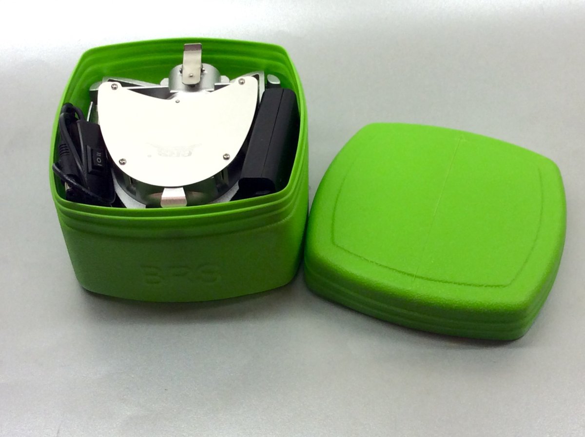

    £35 and a fortnight to ship from China, Amazon purchase. I've fancied a Biolite but the cost of one was daunting. I saw an unused Markill version on ebay but remembered Terry (Trojandog) had one, featured HERE so asked him how it served in the longer term - the fan packed up and he binned it.

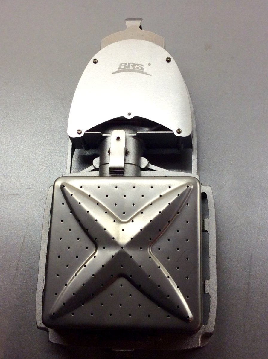

    Packs up compactly.

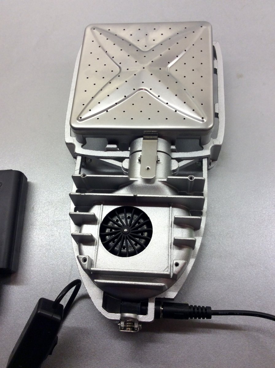

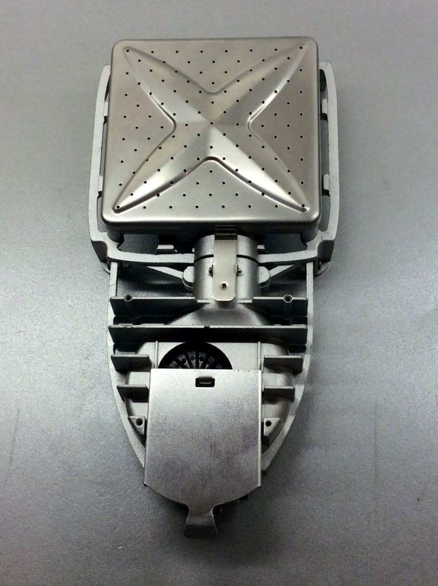

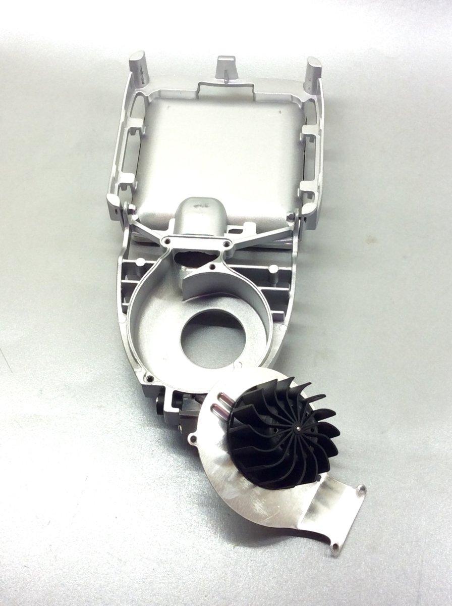

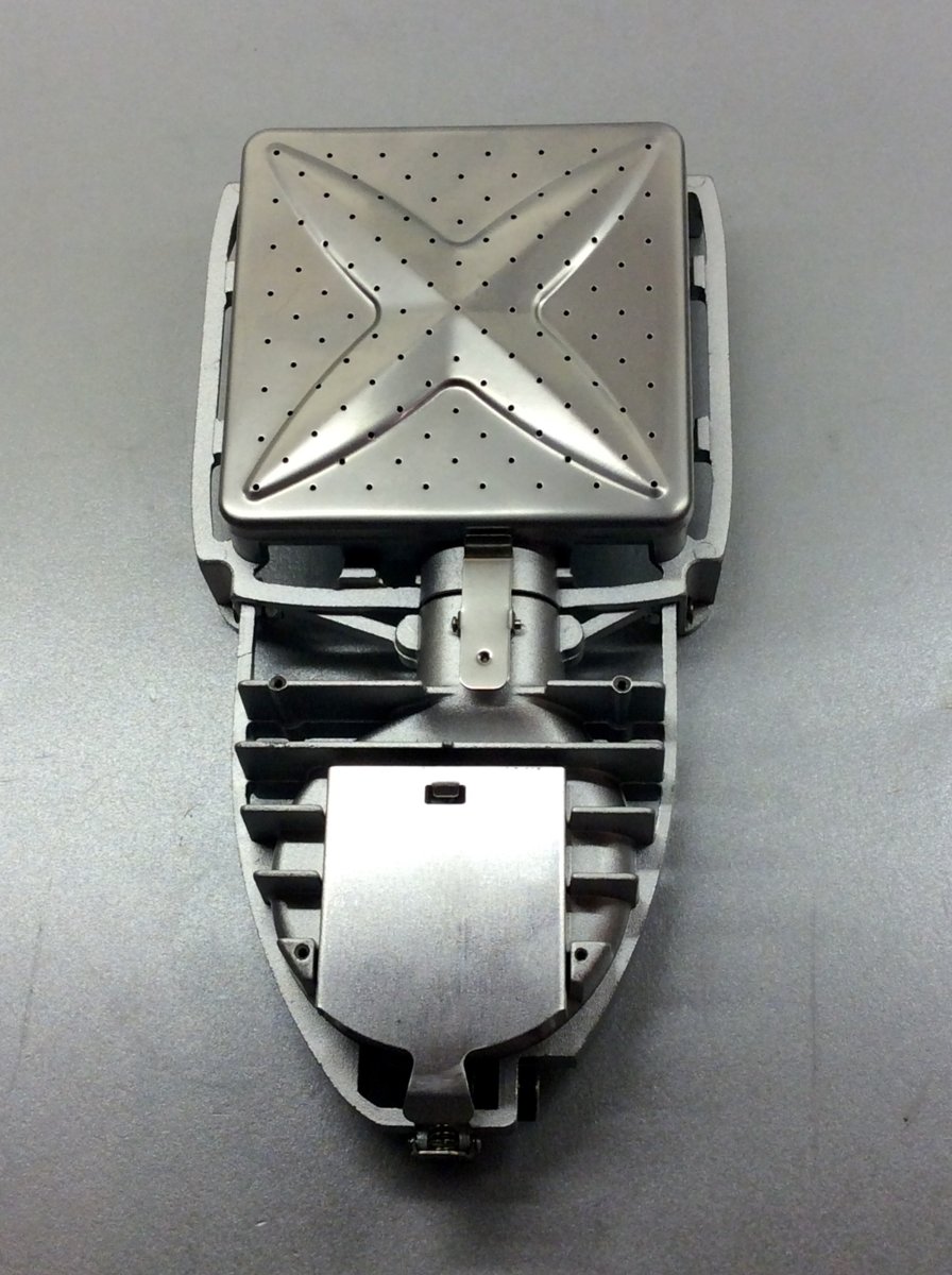

    The powerhouse, a battery-powered centrifugal fan with a two-speed setting.
    A fair blast of air through the stainless steel pierced firebox base.

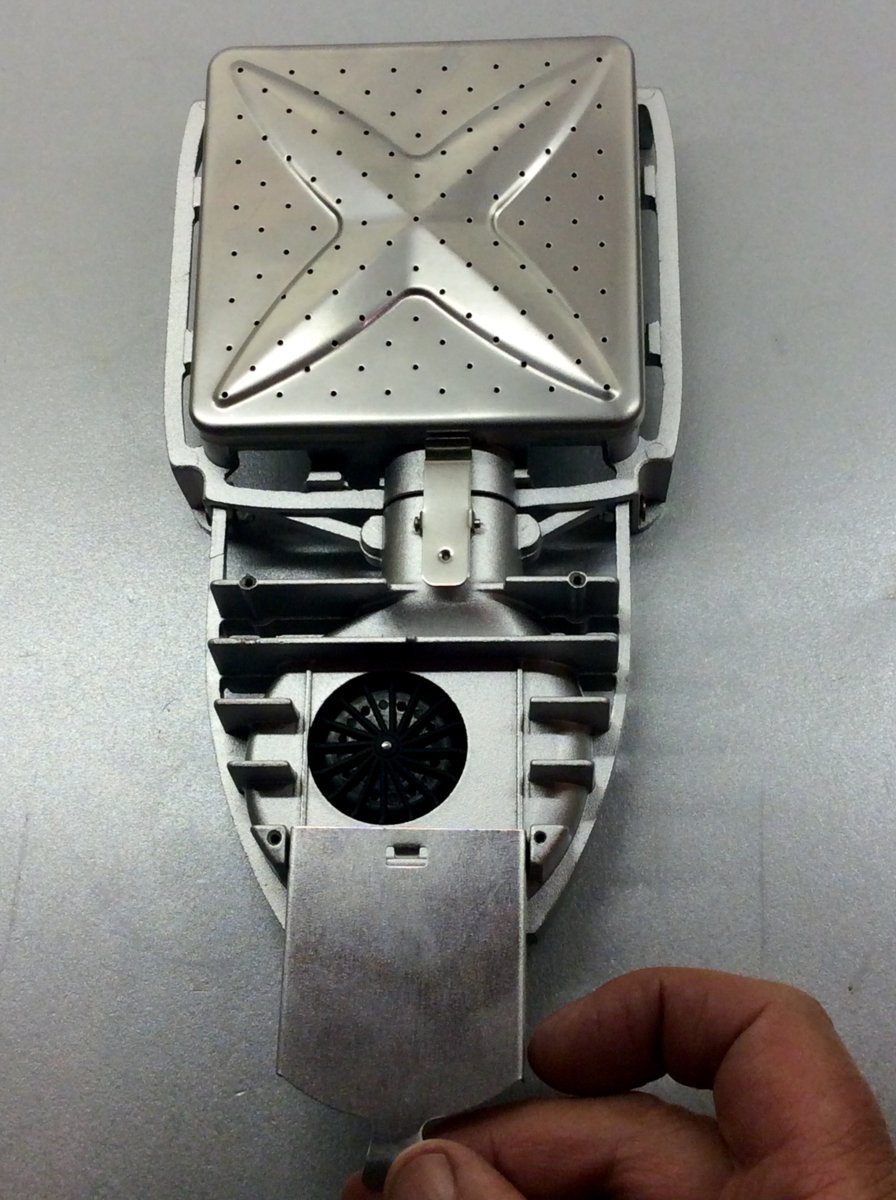

    Many of the posters of Youtube videos of this stove - and there are quite a few - overlook the rather vital detail of the air control shutter and keep it shut during the firing. Clearly, little or no air blast gets through to the firebox if the shutter's not opened. The combination of shutter and fan speed offer a wide range of control.

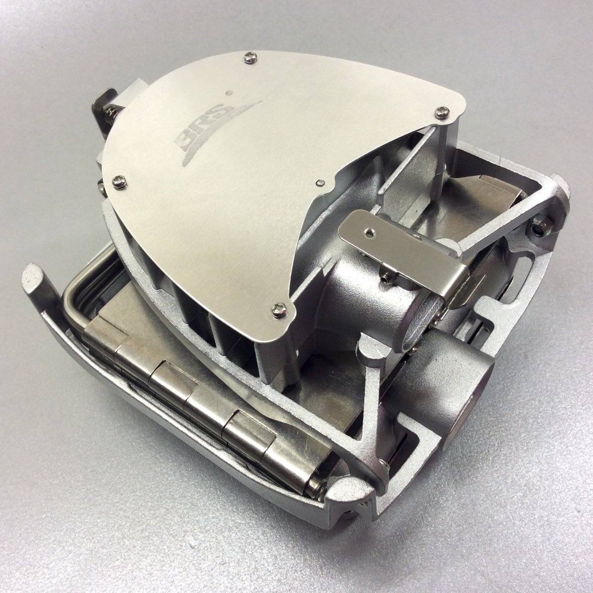

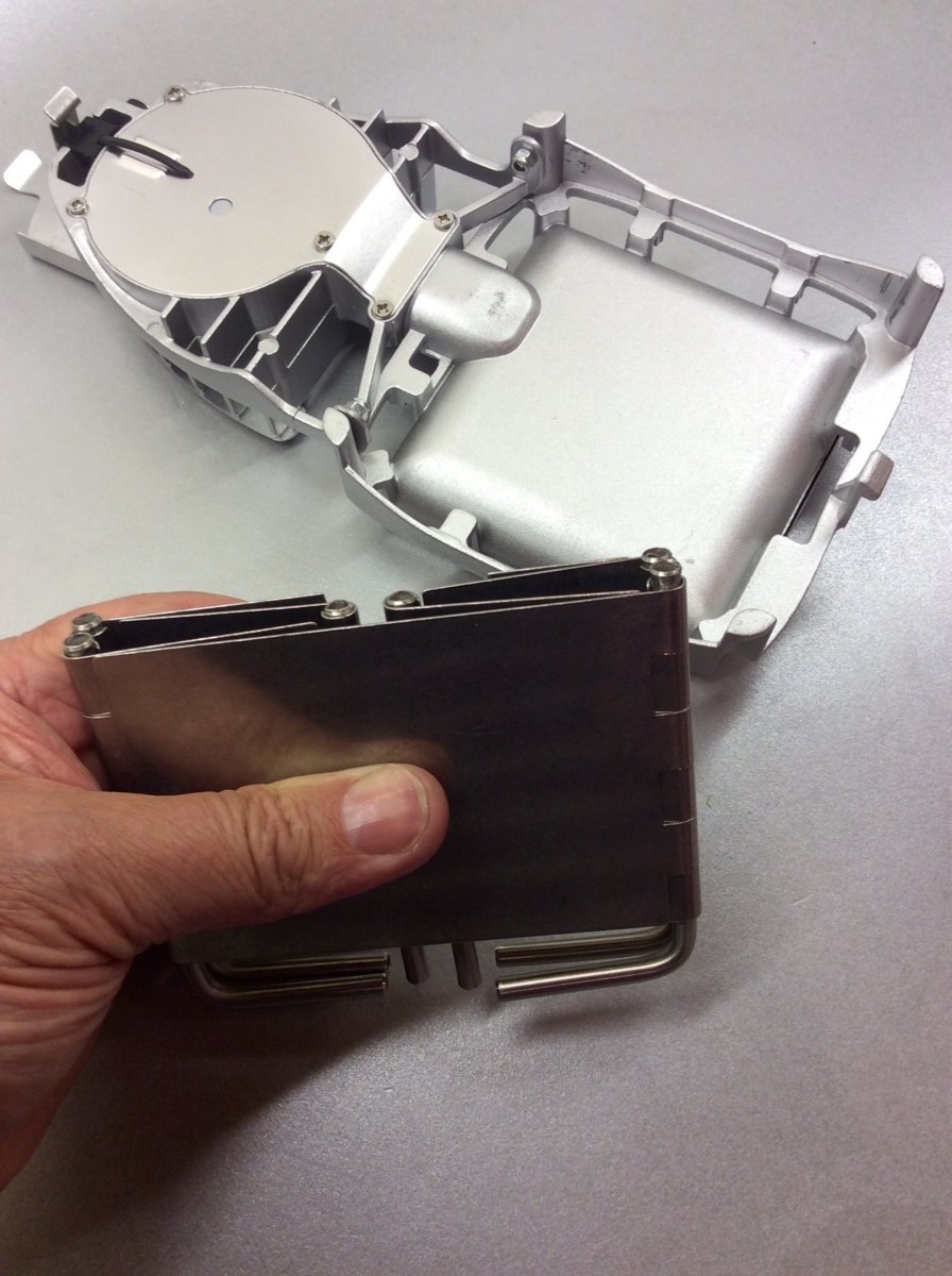

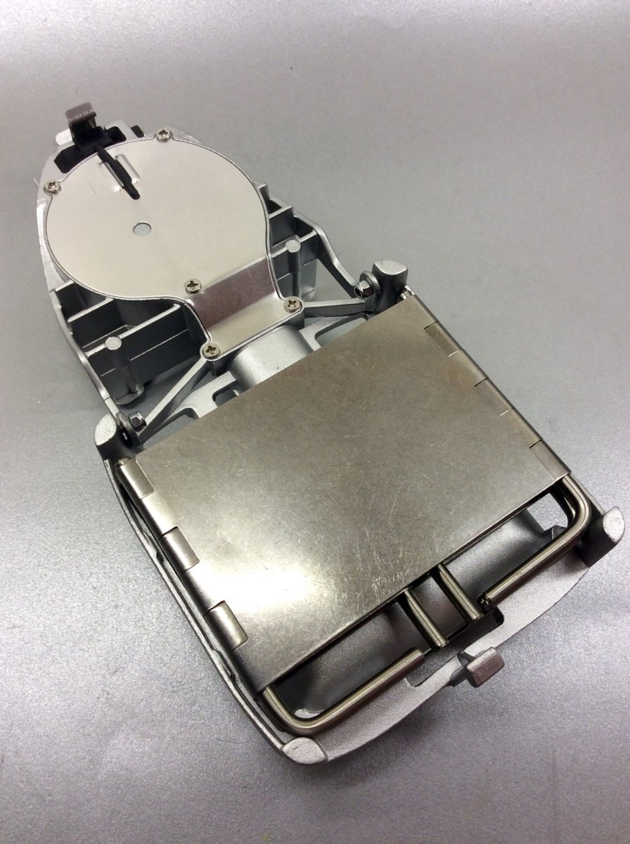

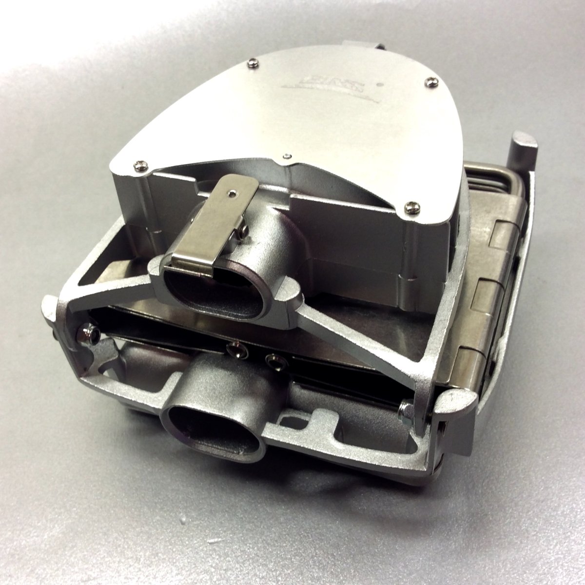

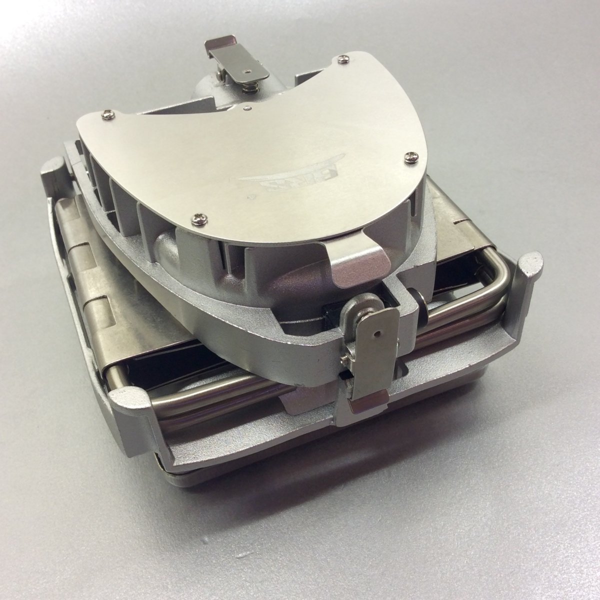

    Cover in place over the shutter.

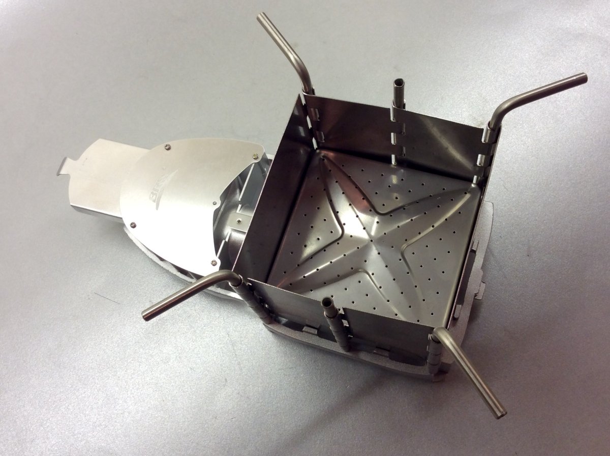

    Collapsible fire box and pot rests.
    Pot rests swing out for larger pots.
    Everything packs away.

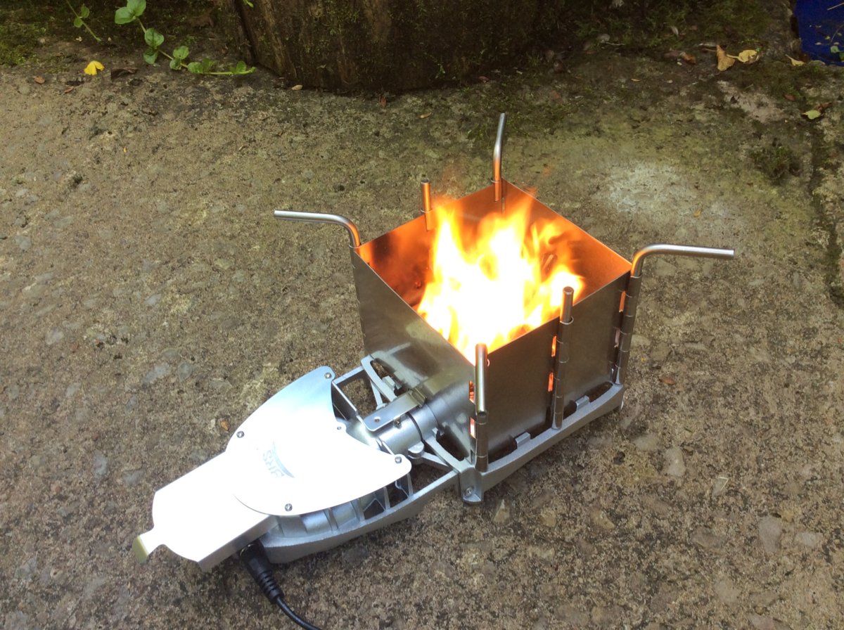

    I'll be firing it up and featuring the results next opportunity I get - lots of heavy rain here for the past 48 hours.

    Hi John. It looks much better made than the Markill. On the Markill, the fan and electronics were cheap and flimsy, plus they were directly below the fire pot. In use, the bottom unit housing the fan, electrics and battery, could only be touched wearing gloves. Looking forward to your assessment of this gizmo.

    It may well be ... all will be revealed when I fire this sucker up ... I know that's not how you speak Ken, it's received Americana from watching a couple of series of Bosch on Amazon Prime.

    Once again .. Great Thanks John for another comprehensive/concise stove report.
    This thread and its extensions are, alone, worth the price of CCS full membership.
    The last pic of glowing embers is in a class of its own...quality above the already high benchmark you obviously set yourself. Quality.
