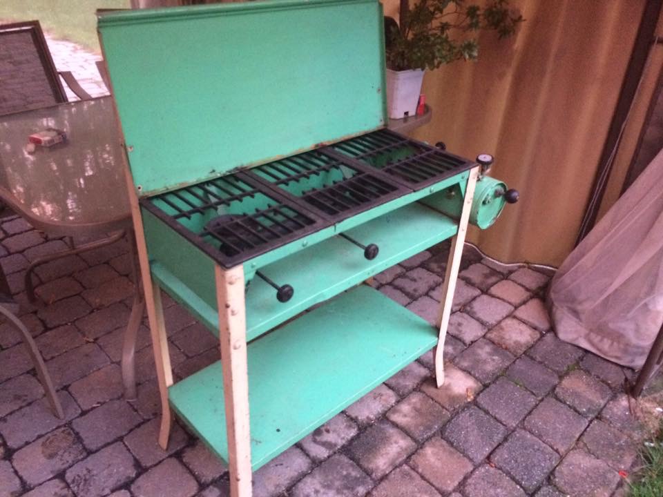

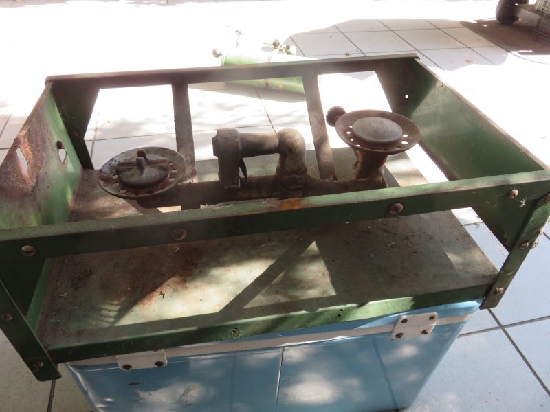

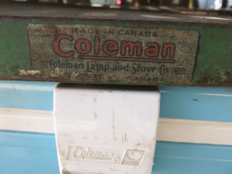

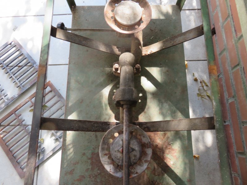

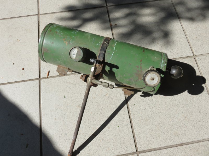

    We scored an old cabin stove today. Old but perfectly functional. Even has original paint and decals.
    Canada is big, our stoves were huge. Flame shot to come.
    IMG_2233__1475687543_64822.jpg IMG_2234__1475687602_39658.jpg IMG_2235__1475687666_33675.jpg IMG_2237__1475687799_52427.jpg IMG_2239__1475687930_99246.jpg IMG_2243__1475688193_37434.jpg IMG_2249__1475688687_35906.jpg IMG_2252__1475689115_77346.jpg IMG_2245__1475688356_88009.jpg IMG_2236__1475687730_89885.jpg IMG_2246__1475688428_80307.jpg IMG_2248__1475688573_47465.jpg

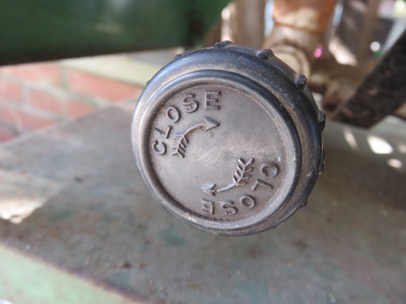

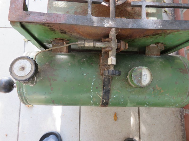

    When you fire it up talk us through the lighting procedure please. I see a fuel valve resembling one on a Handy Gas Plant mounted on the fuel tank, then there are the two other control wheels on generator and secondary burner.
    Pump 'ball' is handsome, but does that rule out the usual Coleman check valve 'thumb over the pump knob hole to pump' procedure or is there still a hollow pump rod there?
    Apologies for the questions but you've presented something of great interest and out of the ordinary.
    Edit
    On closer inspection of the relevant photo (excellent photos) I can see the hole in the brass centre boss on the pump knob, so I believe that's answered that question.

    I lit this puppy according to these instructions:
    "It's pretty easy to light. The large valve on the tank should be opened 1/4 for lighting. That gives an air fuel mix for lighting. The gen valve works just like any other you have used. Once it's lit and warmed up, you push the detent down to allow the tank valve to be opened all the way. This takes it of instant light mode, and delivers fuel only to the gen."

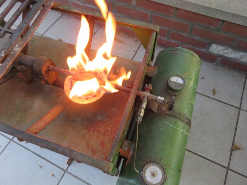

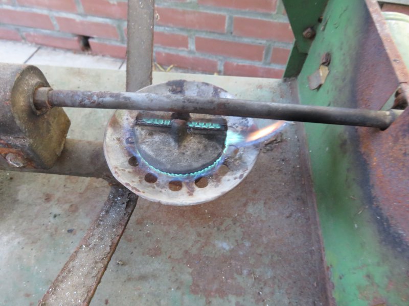

    Flame shot this evening.Last pic is @ full throttle.First pic seems to show primary burner flame is directed to the generator. But I am not comfortable with the flame shooting at the hand wheel. IMG_2261__1475716070_49021.jpg IMG_2262__1475716119_72322.jpg IMG_2263__1475716167_27979.jpg IMG_2264__1475716216_93603.jpg
