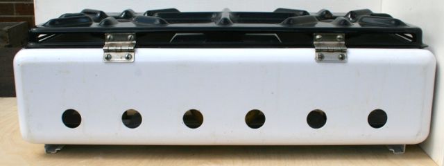

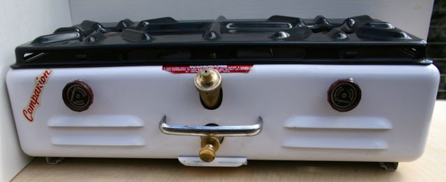

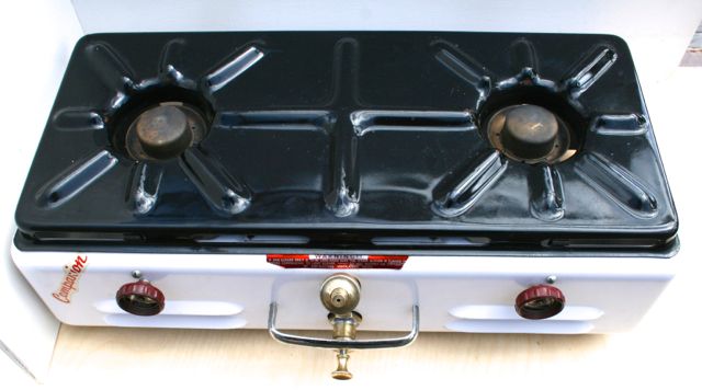

    This is a Companion (kerosene) stove I have never seen before. It has been used, but very little and came in very good condition.
    The only fettling I did was to replace the washers and seals and clean it with soapy water.
    It is designed, I think, as an indoor stove.

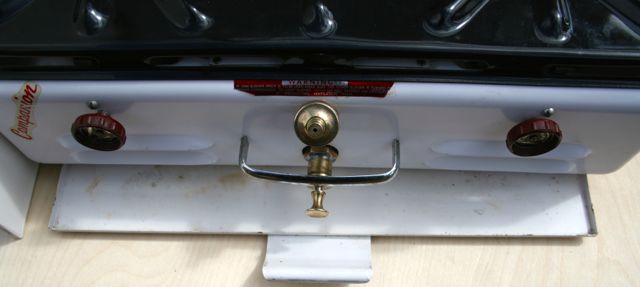

    With sliding drip tray:

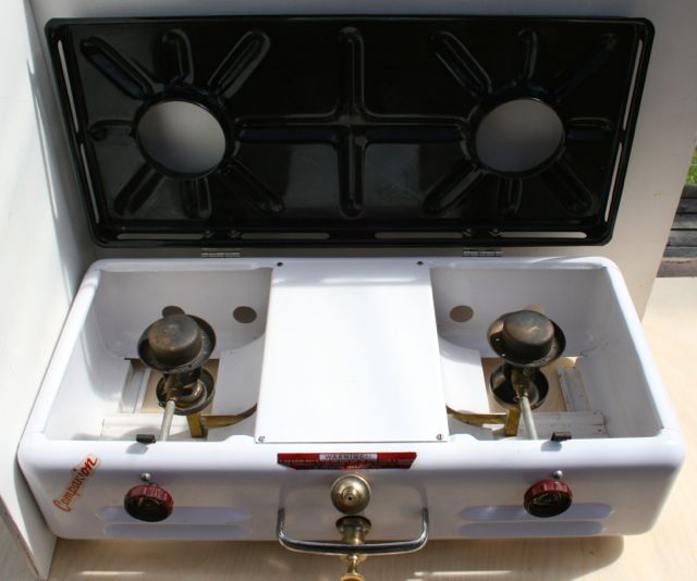

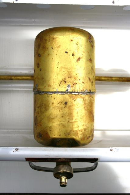

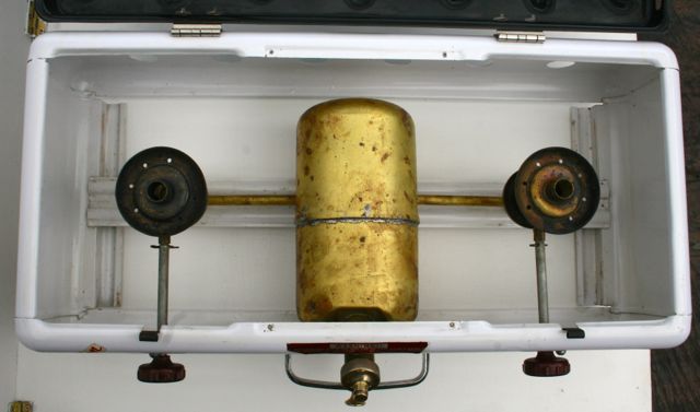

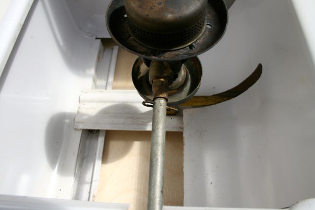

    The workings, with covers removed:

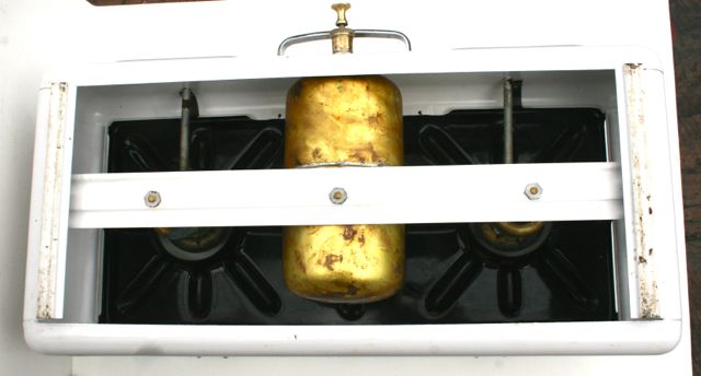

    Underneath:

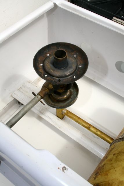

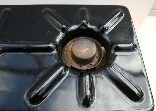

    The burner:

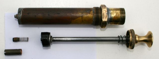

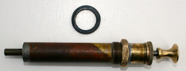

    The pump is a standard bore, but with a 'simple' NRV set up which screws directly to the end of the pump tube from the outside:
    The pip was cork (crumbly) so it was replaced with a 4.5mm viton pip from The Fettlebox.

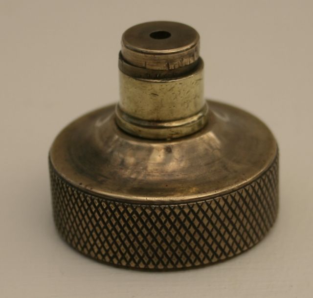

    Fuel cap and pressure release valve:

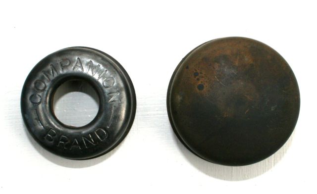

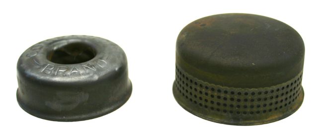

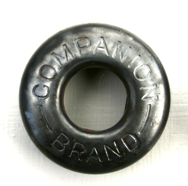

    The outer burner caps are brass and the inner steel:

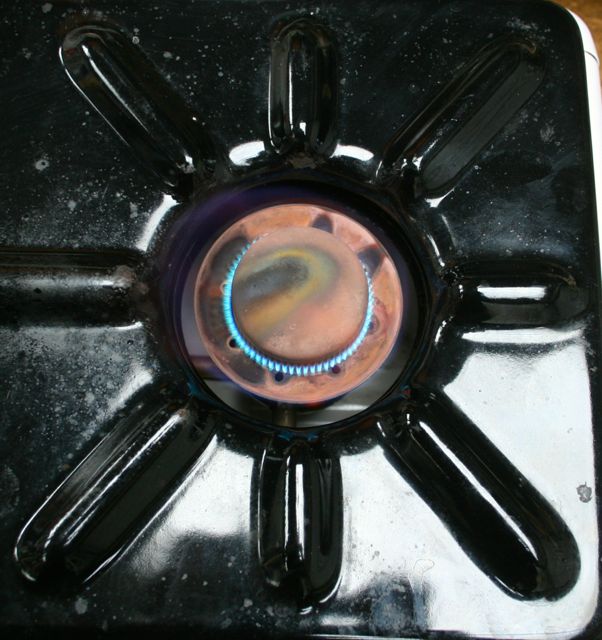

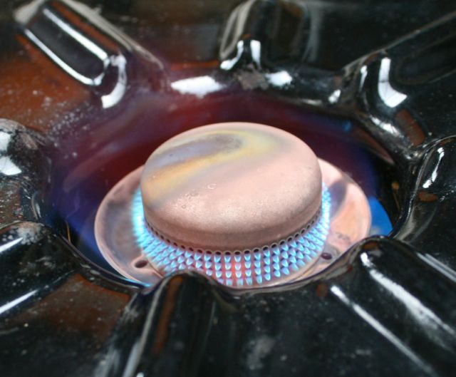

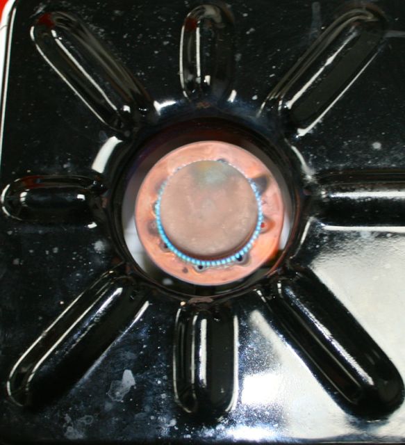

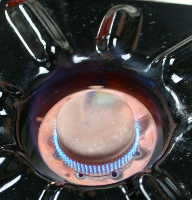

    It fired first go:

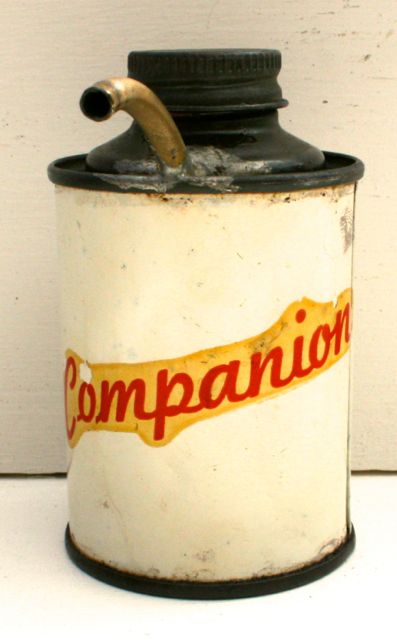

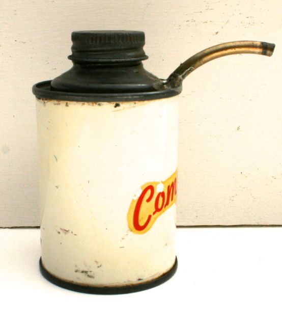

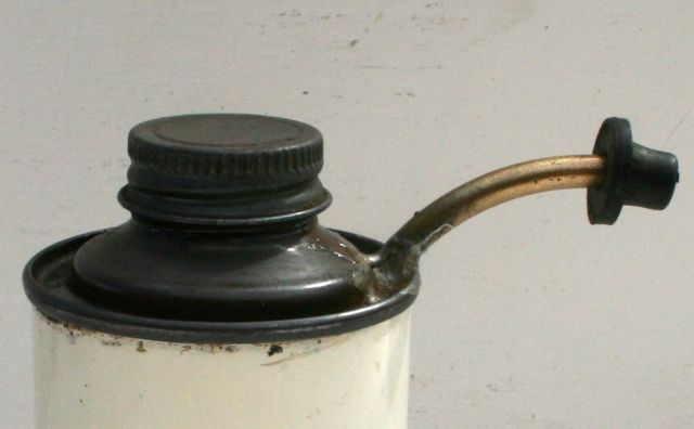

    It came with its own spirit can:

    Im guessing but it has that caravan stove look about it

    It was certainly designed for indoor use but would be fine to use for 'car camping'.
