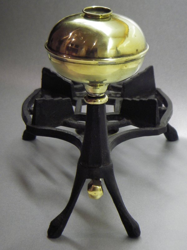

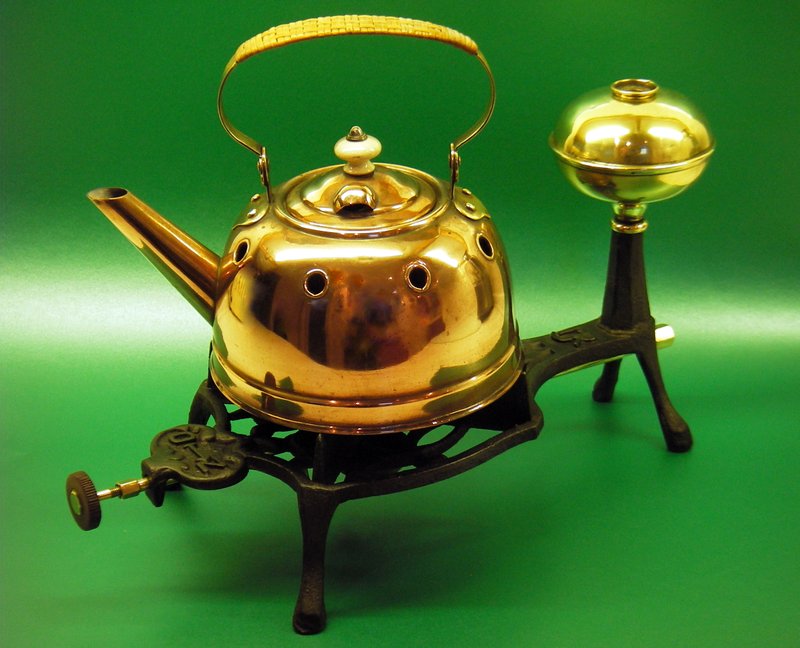

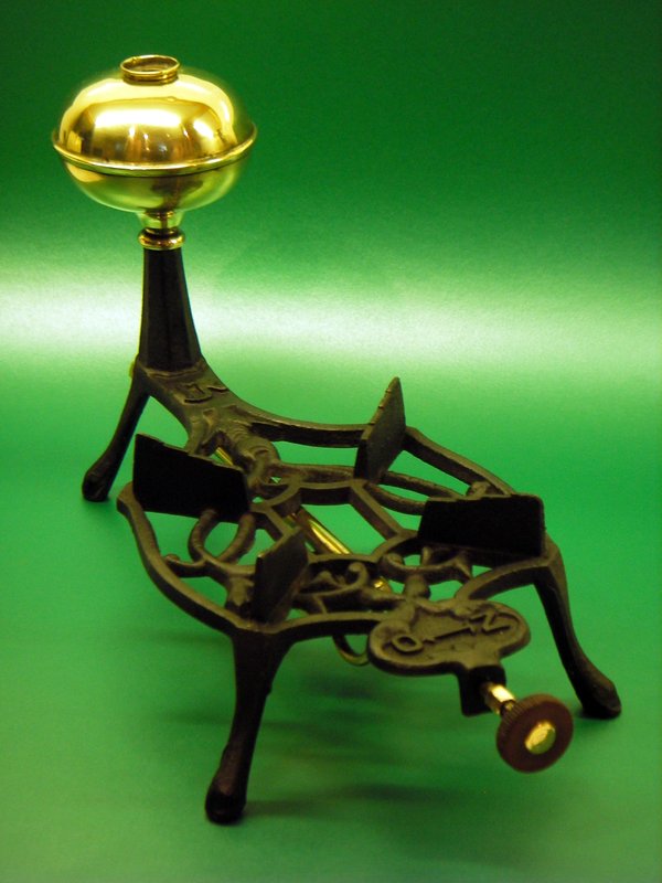

    A technically more sophisticated but less ornate pattern of spirit stove appears in the earliest (1930) Phoebus catalogue in the Stove Reference Library here on CCS and the art nouveau decorative detailing in this stove's design suggests it's from around 1910, or a bit later

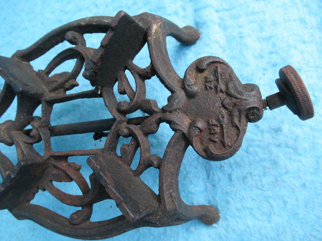

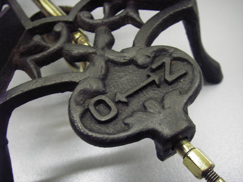

    MJR logo (Metallwarenfabrik Josef Rosenthal) - Phoebus

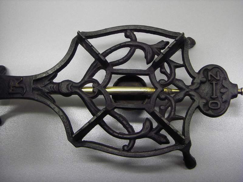

    Öffnen - to open, and Zudrehen - to turn off (a tap)
    Very art nouveau cast ironwork
    Architectural qualities on such a utilitarian object always gets my vote
    A fibre control wheel

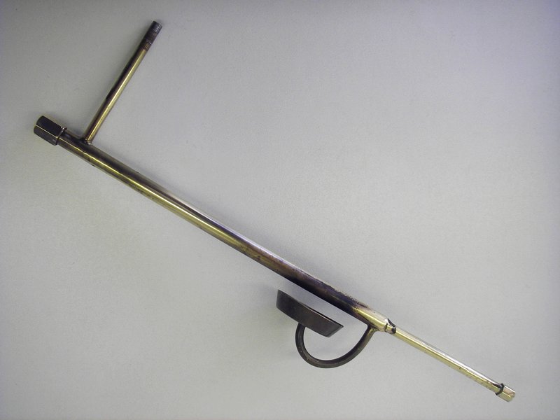

    The vapouriser/burner. A simple design but well constructed
    I said at the outset that more sophisticated Phoebus spirit stoves came along later and this is simply a priming cup and a central jet
    I was eager to see how the burner performed but first had to clean out the filter/vapourising roll of fine-mesh brass gauze
    Cleaned in an ultrasonic bath. Although it's a bit torn, I re-used the gauze because I'd none in stock of such fine mesh and wanted to be sure I was getting the authentic as-designed performance out of the burner

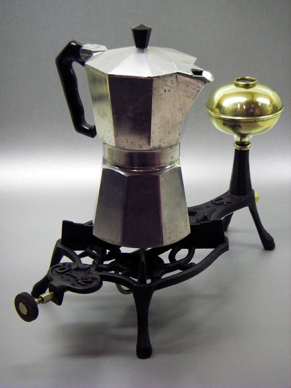

    Priming right through maximum output and finally a simmer. I'm delighted with the way it worked. very quick to get going and very controllable. Seems just to sip fuel too
    Time for tea ...
    ... and a bit later, coffee

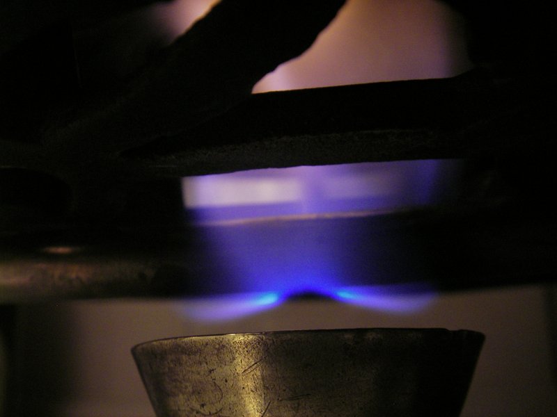

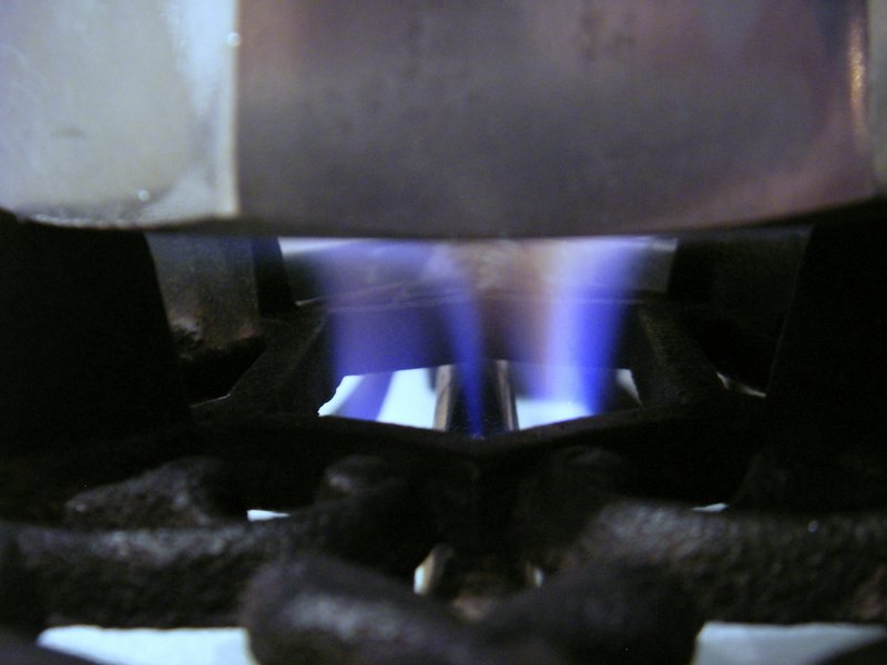

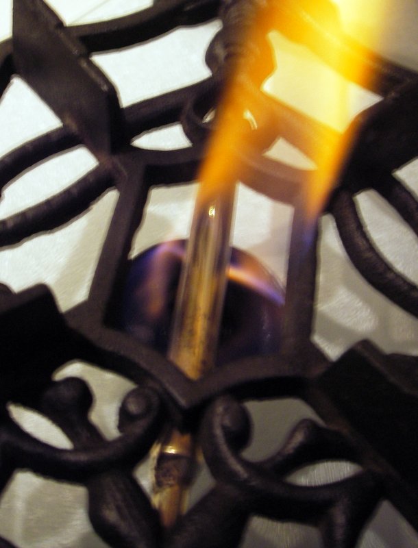

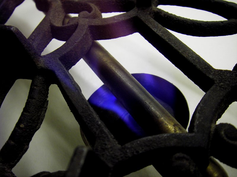

    'Less is more' when it comes to the charm of the burner, which prompted me to get a couple more pics to capture the flame pattern, reminiscent of that on a petrol coil burner self-pressurising stove. Much bigger jet aperture on this Phoebus of course, being a gravity-fed alcohol stove

    I'm grateful for the offer of helping out with replacement gauze George but there are no symptoms of the original piece - now it's been cleaned - reducing the performance so I reckon it's good for a while longer, maybe another 100 years.
    I've heard you say you've retained original cork pips in NRV's when they've still worked so I know you'll understand where I'm coming from.

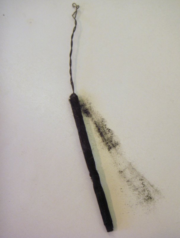

    I've not come across a roll of brass gauze used for a spirit stove filter before but it's an interesting alternative to the usual asbestos fibre ones - and much better than the type bound in a steel spiral that tend to rust and block the vapouriser tube.

    Incidentally, the other spirit stoves I have are silent burners. This Phoebus operates on a roarer burner principle, the jet stream from the jet outlet impacting on the vaporising tube as on a flame plate - so while not as noisy as some, it's no silent burner.

    PS. The "O <> Z" on your stove is just German. It means "offen" (open) and "zu" (closed) this was often used on many applications.
