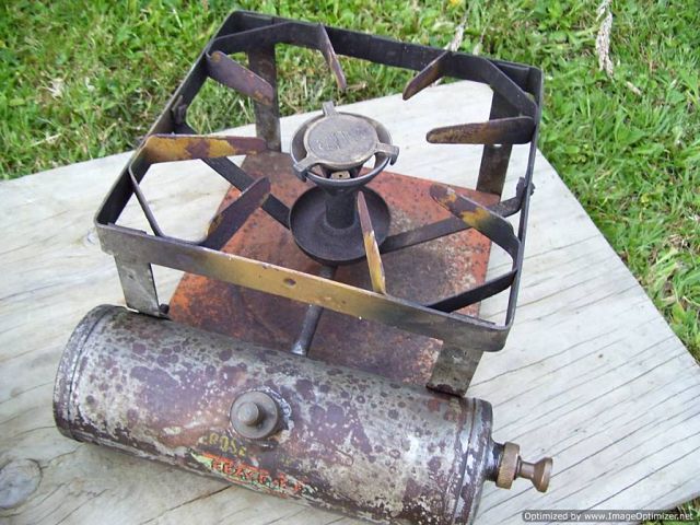

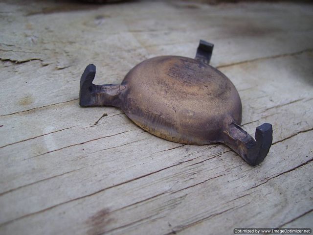

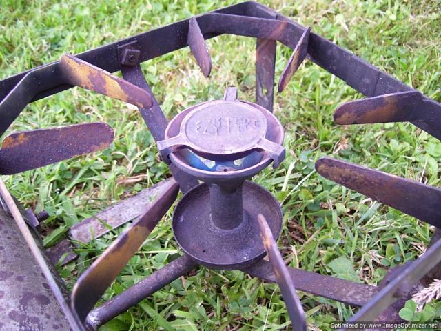

    This is a very powerful stove. It boils 1 litre of room temperature water to a full rolling boil in just under 3 minutes. :shock: :)
    It has a very noisy pulsating hissing roar that resonated so loudly that my wife thought that I was working on a strange sounding engine in my garage. The stove was in fact running on our front lawn at the time. Passers by were wondering what that noise was coming from our property. :lol:

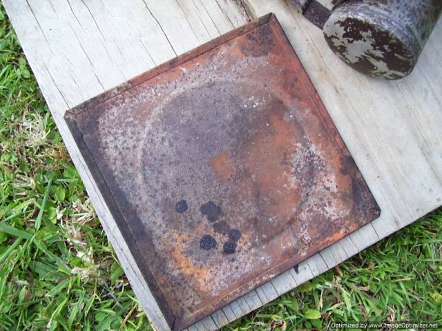

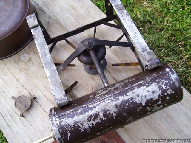

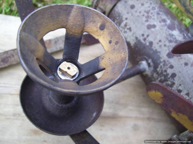

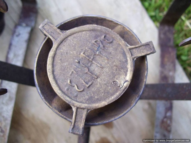

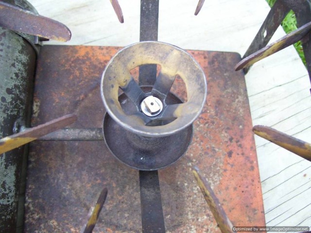

    It has a heavy solid brass burner and burner plate that takes a lot of preheating to get it hot enough to fire up. Hence the huge preheating fuel dish for a kerosene fueled preheat. Once going, it has to be bought up to full power in stages so that the fuel has a chance to vapourise at full power.
    Once heated up and should it be blown out, the burner will retain it's heat for a longer time (compared to civilian stoves) so that it can be reignited more easily without having to rush so much.
    The burner jet is typicly huge for a military burner(about twice the size of a self pricking 123R or a 207 Burner jet). It has an aperture of about 0.38 - about the same as what a blow torch jet is.
    These were not made to simmer and would have had to heat food or water very quickly as in a war situation.

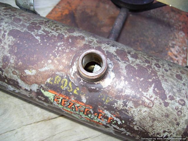

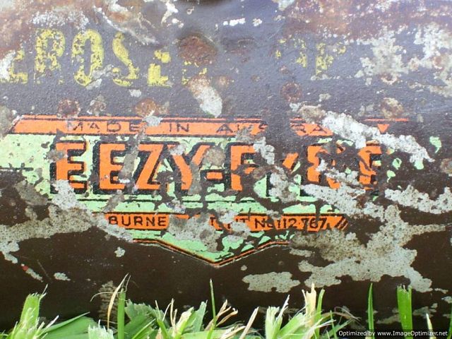

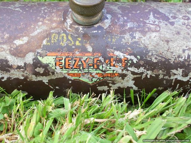

    The steel fuel tank is in very good condition. It appears to have had a galvanic coating inside and out before being painted in Australian army paint.
    A previous owner has removed the old blistering paint in places to remove the surface rust only(luckily). The galvanic coating had done it's job. The inside was like new and the NRV in the pump was not sealing because of crud so it may have been stashed after not much use, needing to be fixed. I would guess that the outside had deteriorated during storage but it would easily be restored without any major work having to be done.
    I am going to leave it as it is.

    I was attracted by the burner when I first saw it and that the auction wording for the stove said that it was made in Australia. That suggested that it may have been an Australian made Sievert product.
    The burner design appeared to be from an earlier period - say late 1800's to early 1900's.
    Hello Kerry.
    I think that it may be quiet rare as I cannot find any other examples of it on the Internet at this date.
    There are only a couple of references to EEZY-FYRE stoves in adds from old Singapore newspapers advertising this brand of stove in the Australian Army Surplus sales in Singapore, directly after the Second World War.
    The stoves referred to are for both single and double kerosene burner type but I suspect the double burners were 2 single burner stoves bolted together. There were no photographs or sketches to refer to so I do not know what they should look like. There could be other variations out there.
    I am hoping that someone here on CCS may have more information about EEZY-FYRE stoves. I am very interested in their history and whether they were made for the military only.

    I will have to clean out the burner properly in the future so it may burn even hotter Mike. I had flushed the whole system through after removing the gauze filter(burnt clean) and cleaned up the jet but the burner needs some tarry carbon removed from inside the vapour tube under where the female jet seat is. It wasn't bad enough to remove the burner from it's fuel pipe to do the job. With time or even a little persuasion from a blow torch; that may be enough shift it.
    My camera did come close to heating up with a couple of those shots and the hairs on the back of my fingers have singed back a bit from an invisible blast of flame(in daylight) that was coming up from the bottom of the kettle. Yes, a very hot performer. No flies will be safe flying any less than a meter above it. They will loose their wings if they did. Seen it happen with one of my Campingo's :lol:.

    The burner is different to the lipstick type where the burner bell slips onto the 'lipstick'.
    It is basically like a giant version of a SVEA 123 or Optimus No.8, Primus 71 type burners, but the burner bell and vapouriser are one piece and the stove is designed to burn kerosene only.
    It's a shame that the stove you know of Dan is missing it's burner.
    The pump assembly is essentially the same as what you have in say an Optimus/Primus number 5 except for the pump tube cap and the pump knob.
    Interestingly the pump NRV has a large round thick disk at the top rather than the more usual capsule shape and it has a slot so a large screw driver can be used to remove and install it. John
