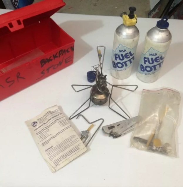

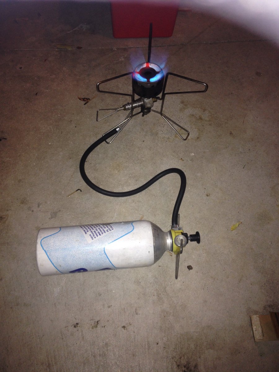

    First time post. I came across this site while researching my new interest in MSR stoves.
    I just purchased 2 old stoves. The first is a garden variety Whisperlite from the mid-90's. This is the second one. It looks like a very old Firefly and of course the fuel like is totally broken. I plan on having a friend repair it with a section of fuel line. Sorry for the bad picture. I'll post more when I can. Any suggestions on the size of fuel line, other parts for it, anything else?

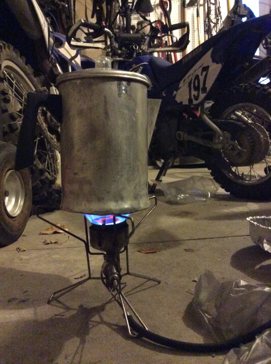

    The Firefly works great.

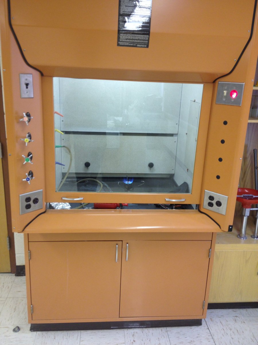

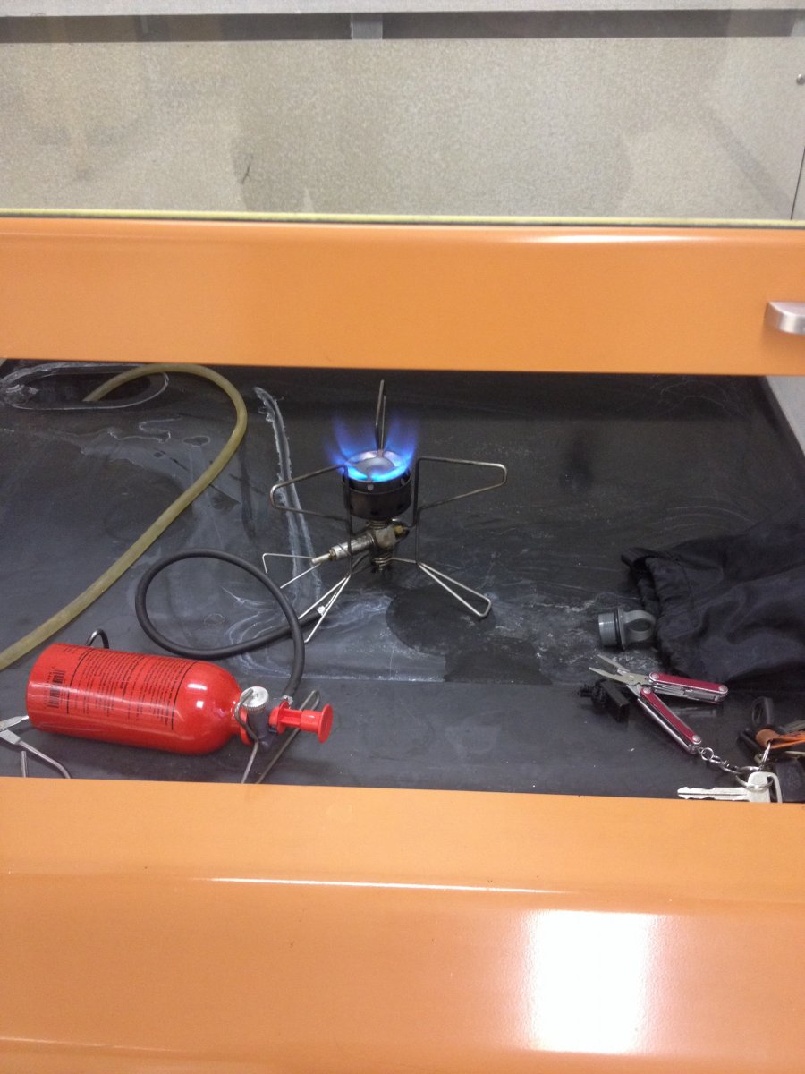

    It came with the original replacement hose. However, the thing was like wax. It even came with replacement instructions. So I went down the street and got a 50 cent fuel line. I clamped it on and fired it up in a flame/explosion resistant box with a ventilation fan at work (no kidding).
    The old yellow pump was missing the intake tube and would not suck up any fuel. So I switched over to my red pump and everything worked great.
    I used a 3/16 inch fuel line with the original clamps. It is rated at 50 psi and 175 degrees. The MSR stoves run at 20-30 psi so it is ok for now. But, if there were a problem I don't think this fuel line could handle it. So I ordered a metal braided line for $3.00 and free shipping from eBay and it should be showing up in a few days.

    Looks like the FireFly is flying! I like the explosion resistant box. I need one of those! Okay, I know it is not practical for home use, but thanks for showing your fix of the FireFly. It's burning really cleanly.

    This is a shot of the original fuel bottle and pump from @ 1983. I was able to get a small section of hose for the pump fuel intake to get it working.

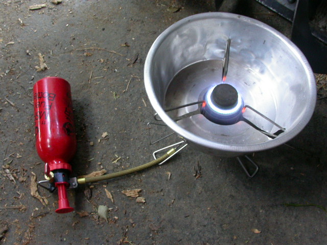

    Tractor Supply carries dog bowls that are the exact dimension to the original soft aluminum windscreen that came with the MSR Firefly from the factory except it's made out of stainless steel. I mean they are exact, down to the circular indentations in the bottom of the windscreen. You should also know that your Firefly is a little more rare than the typical Fireflies. MSR had a recall on these particular stoves. The fuel lines were once made of the clear rubber whose that was also used on the ends of the yellow pump. These specific fuel lines didn't have any flame retardant braided fabric around them and were prone to dry rotting and fire hazard. They're easy to recognize because the ones that survived like yours are brittle and broke. I also have one of these pre recall stoves listed in the forum on this under Got Dibbs. I was able to gently pry open the hose clamps on the brittle fuel line and reuse them to attach a fuel compatible hose I picked up at Ace Hardware. Normally used for lawnmowers and weed eaters. Awesome find for your first stove. I love these and have 15 of them. Around 40 MSR stoves all together. Hope this helps and check out my Firefly post. I believe one of those dog bowl windscreens is also pictured.

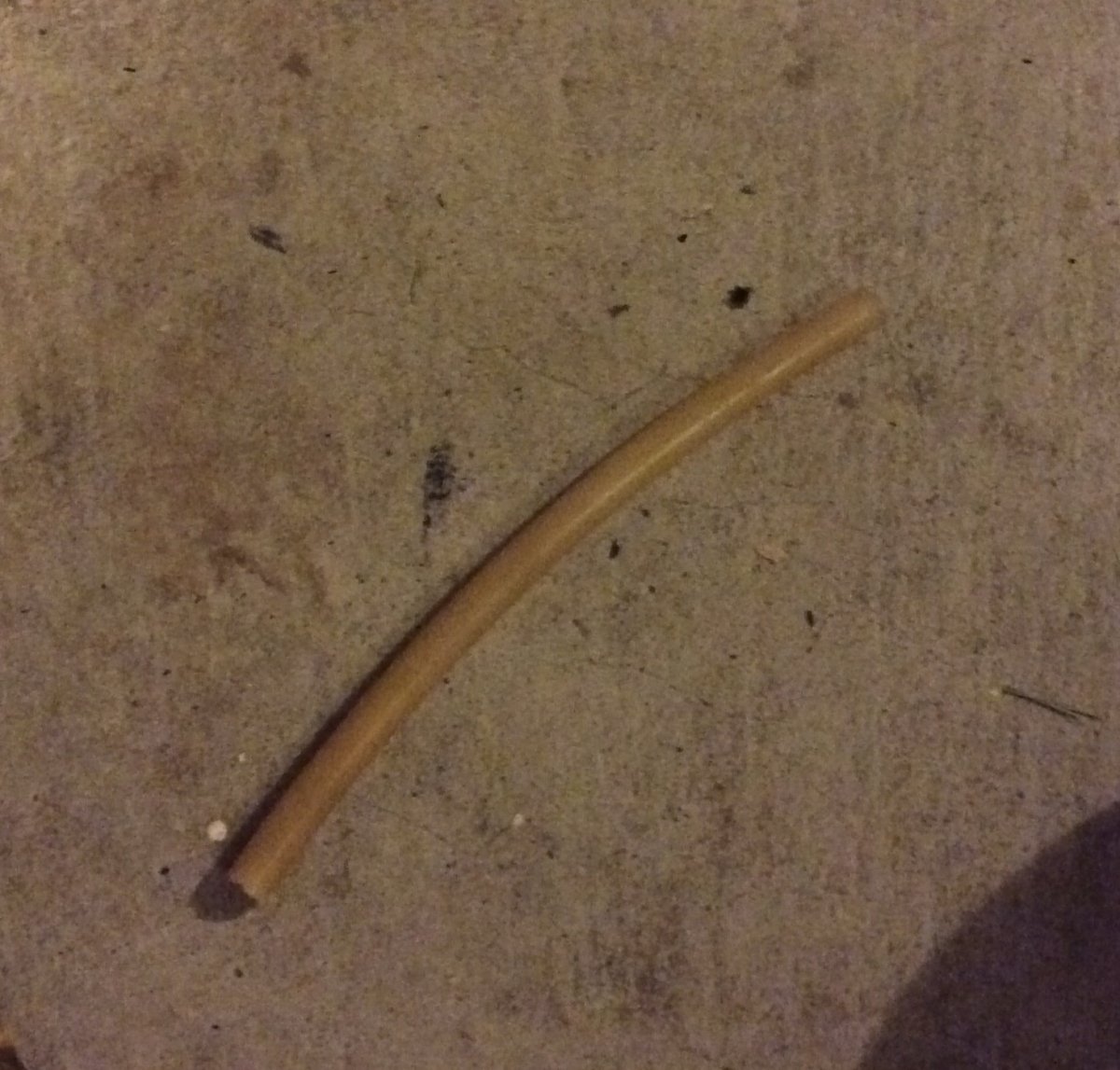

    This is the original plastic fuel line (replacement section) that came with the stove. It is basically a wax plastic mix that crumbles under stress. image.jpeg

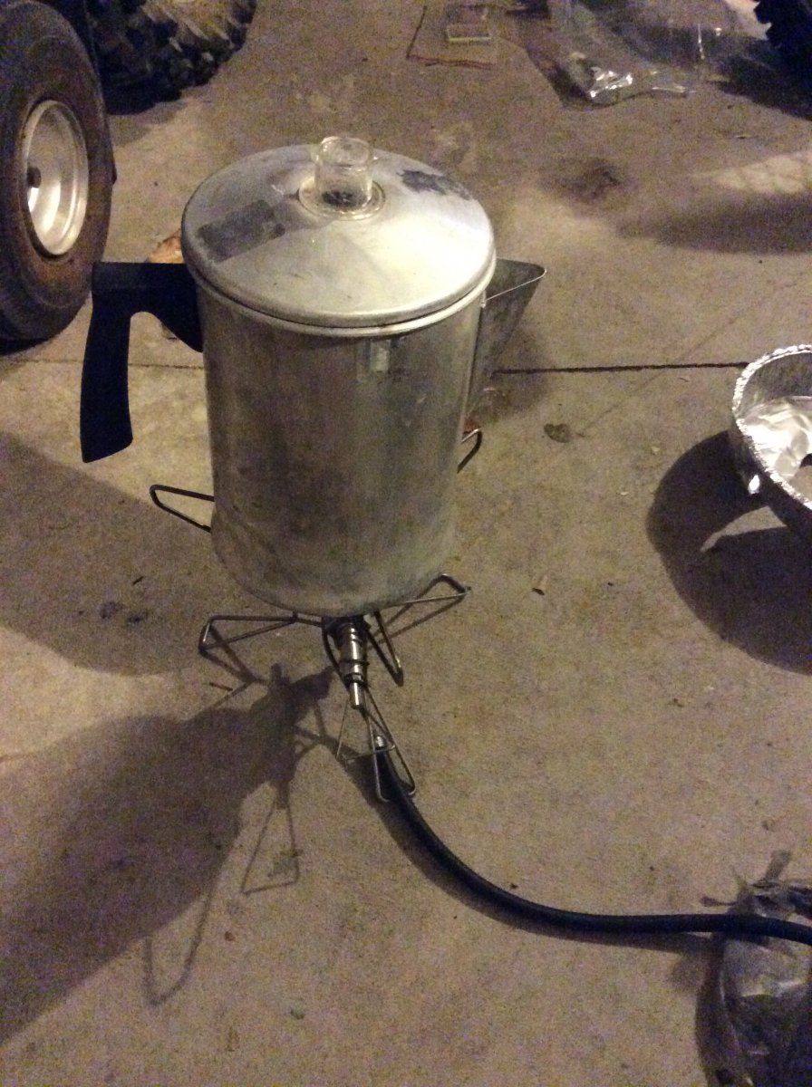

    I found an old coffee pot that goes with the stove. I am hoping to field test this set up next weekend.
