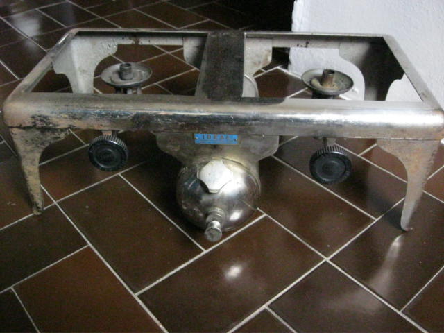

    Petroleumgas stove made in Czechoslovakia by Josef Zeman in the city Chocen.
    Burners : A.B.RADIUS - PATENT - STOCKHOLM

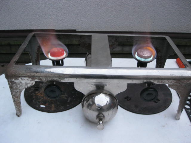

    It is good to see that you have got the stove working, but the left side burner seems to have 'underburn'.
  4. dusan Czech Republic
    Apr 13, 2014
    155
    Brno / CZ
    Yes, I known. What is to do?
    Burner head changing help not.
    Spare parts are from Meva.
    Dusan.
