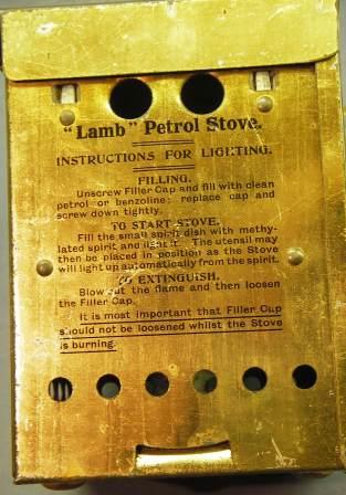

    I got this little petrol (gasoline) stove a good while ago and decided to dust it off to make a pot of tea. First impression, an angular box absolutely covered in printed instructions and graphics

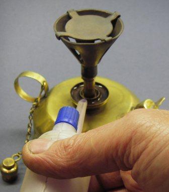

    Cap removed, the jet nipple is revealed. No, the jet hole isn't massive, it's just a dimpled surround like that on a Coleman burner jet
    OK, brew up it is. First the priming. Mere seconds into the priming the tank presurises, a petrol jet starts to play on the burner plate and the characteristic roarer sound starts up

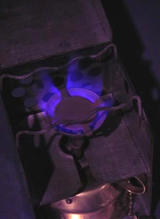

    ... and I'm ready to put the kettle on, but first, I cut the lights to get a flame shot
    Brew time over, the stove has no shut-off valve, so the burner flame is literally blown out, then to the sound of unlit petrol vapour hissing out of the still-pressurised tank, it's safe to unscrew the filler cap to shut down.

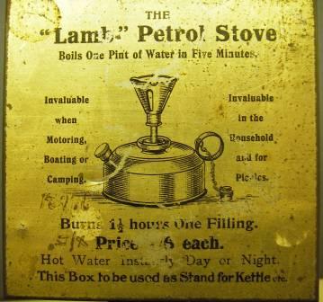

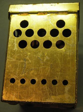

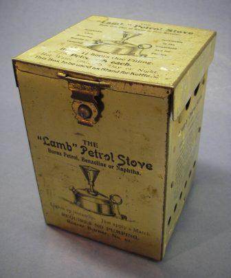

    While the stove's cooling off, I take some photos of the case, which as I've said is positively covered in graphics. First the lid ...
    ... the front panel

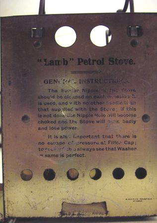

    ... the inner flap
    ... the right side panel
    ... and the left panel
    Only the back ...

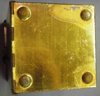

    ... and the base
    ... of the outer surfaces of the case are unadorned.

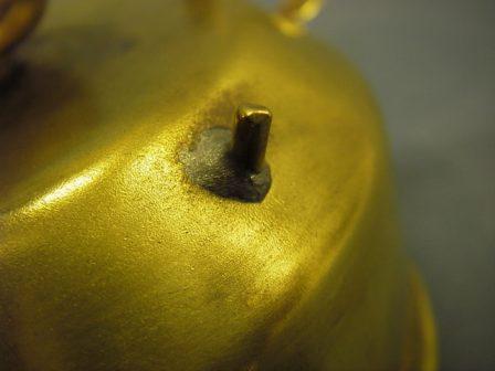

    The stove's cooled down enough to handle now, so I get some detailed shots of it. The pressure release pin ...
    ... which is sprung-loaded to a connection in the base so that if the stove were to overheat (plenty of warning before that happened I reckon) the solder around this pin would melt and the pin would disappear into the tank, venting off the pressurised petrol. That's not something I'd personally witness you understand, because I'd be in the next county by then.

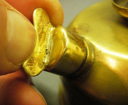

    The filler cap's tiny, as you can see.

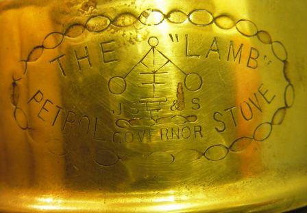

    I really like the engraving ...

    Postscript: I realised during the firing up the stove for the pics that it was a bit off-tune, needing a run-through of the jet with a pricker.
    Here's a couple of pics of the stove at full tilt afterwards. It doesn't roar, incidentally, but gives the hovering 'copter beat sound. Glorious!
