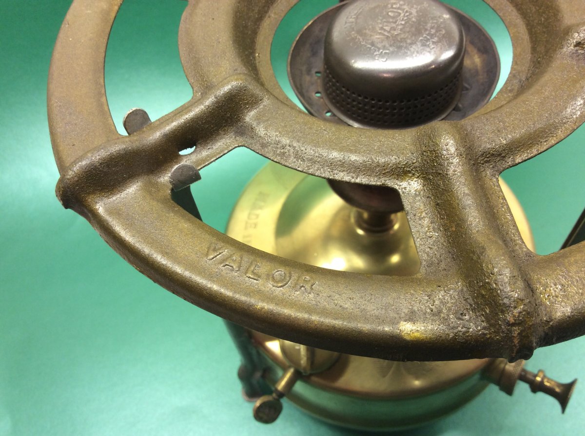

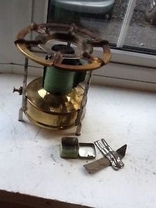

    I believe that's a misconception, probably fostered by the chopped-down pan ring sported on the 1948 Valor 51, also with pressed steel legs featured in this Reference Gallery post by the stovie formerly known as Iani
    Quirky modification by an owner in that example, but clearly a regular Valor pan ring is intended for this stove and fits perfectly well without any modification necessary

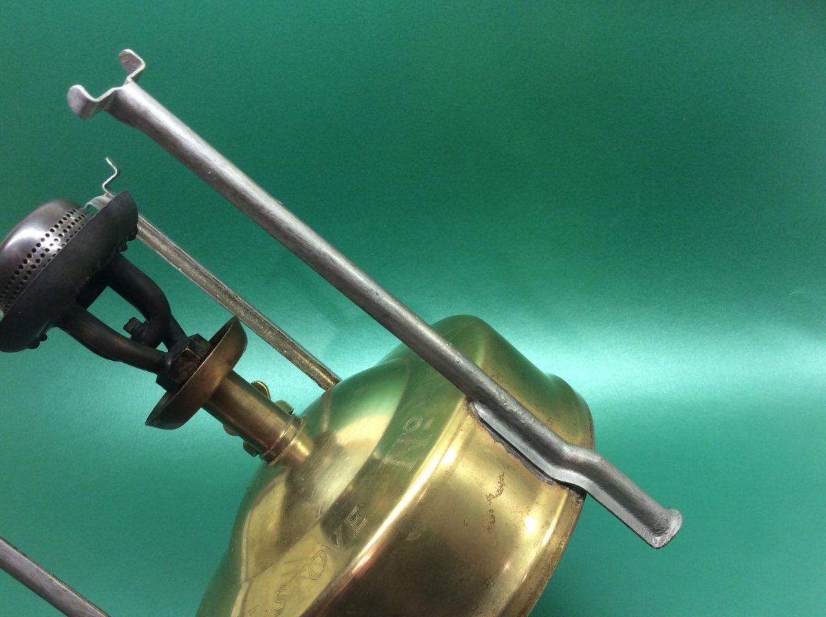

    The question is why Valor briefly (only seems to be on 1948 models produced in May and June of that year) fitted pressed steel legs instead of the usual steel rod stock.
    Igh371 used the word 'utility' to describe them. Certainly they have the look, and doing the maths there's marginally less steel than in a round-sectioned rod. Probably cheaper to fabricate too - taking one stamping operation - whereas I'd have thought the convention of forming a foot on each round-sectioned leg was done separately from the job of putting the bends in the rods. Having said that, new tooling would be required, which would take a lot of sets of legs to recoup costs and it doesn't explain why it didn't last as a Valor feature.

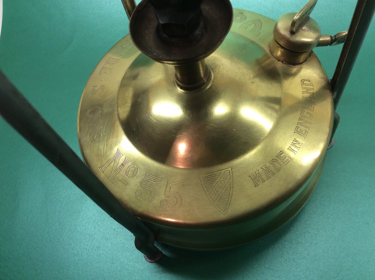

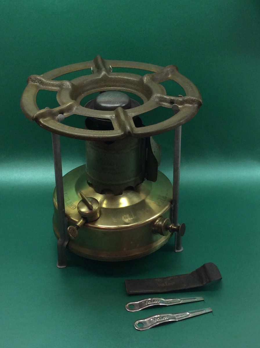

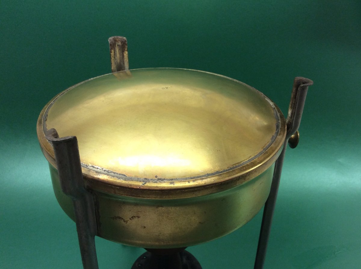

    Apart from the non-original fuel filler cap (from a Radius) ...

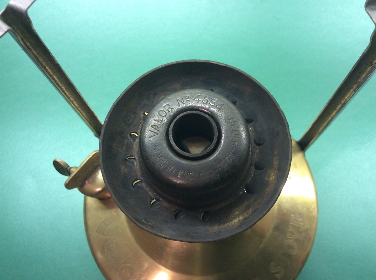

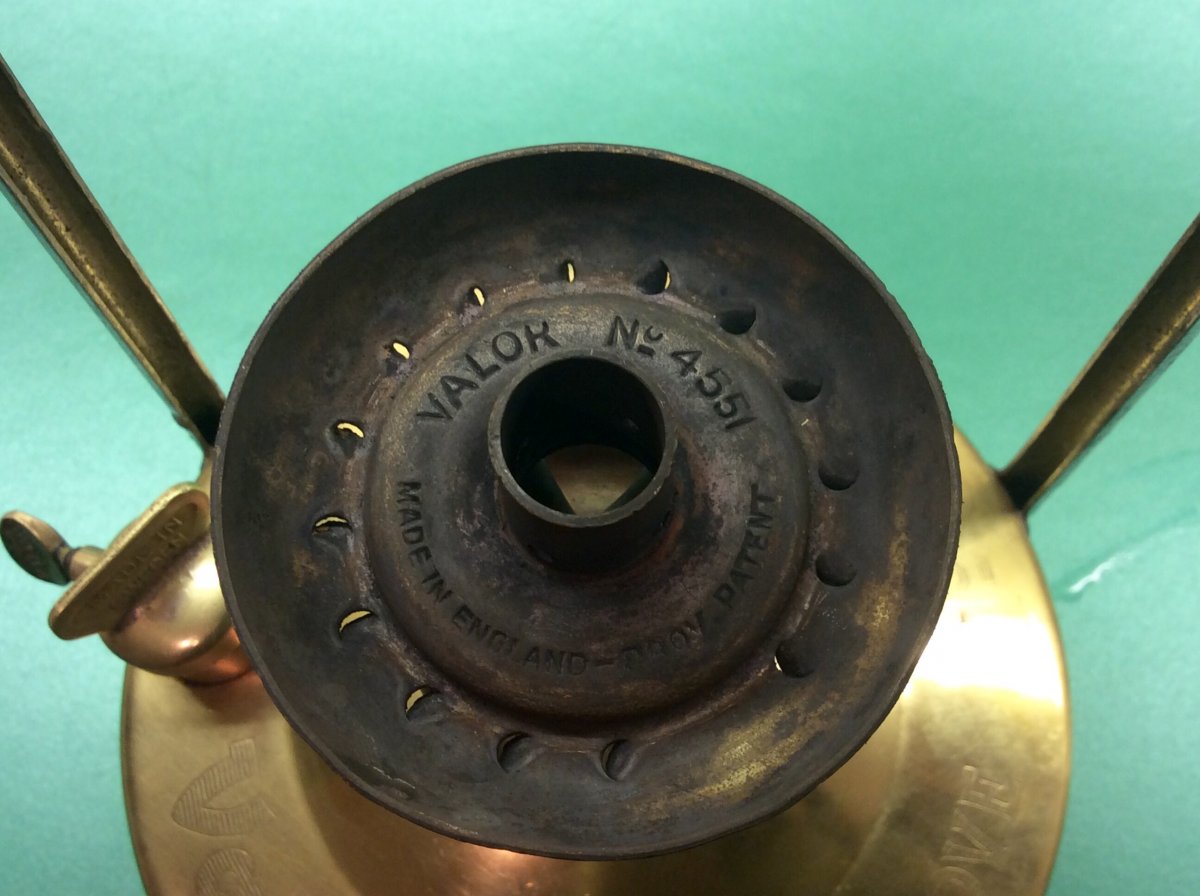

    ... the stove is pretty much complete, with Valor burner and caps ...

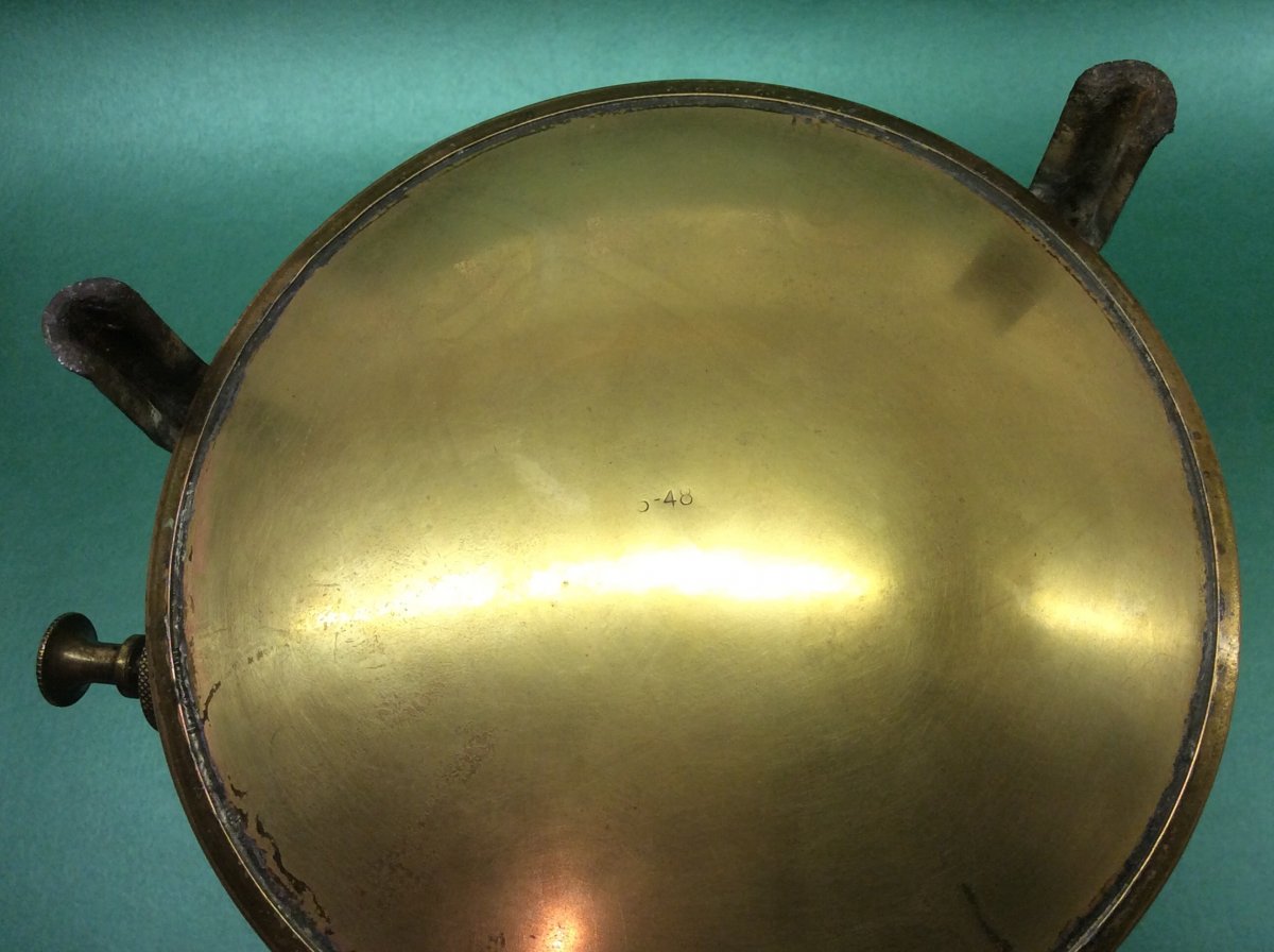

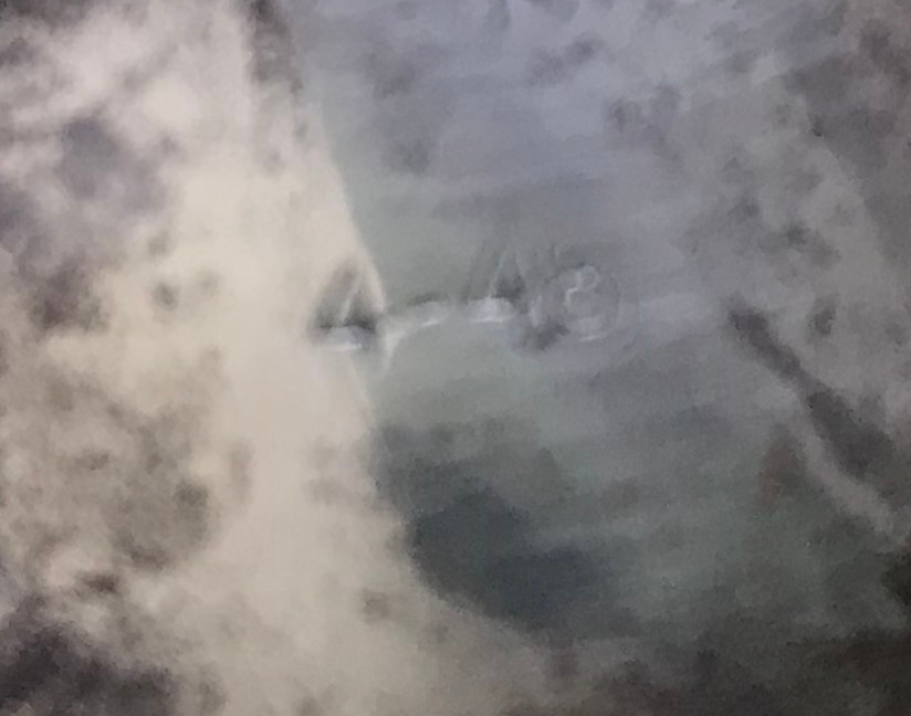

    ... a fuel tank in decent condition (date stamped on the base) with just one small dent beneath the 'a' of Valor

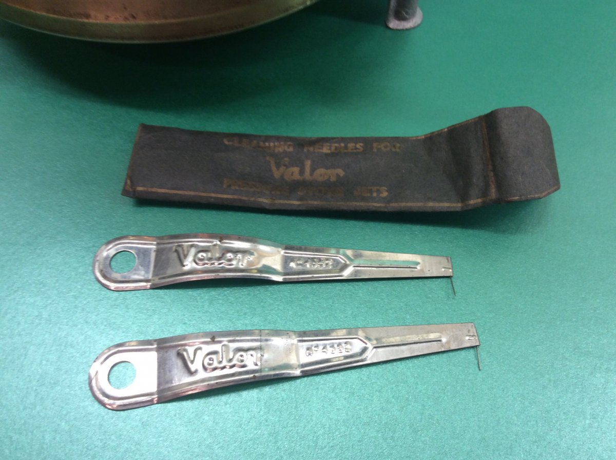

    Unused Valor jet prickers

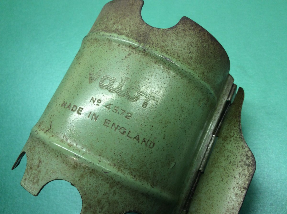

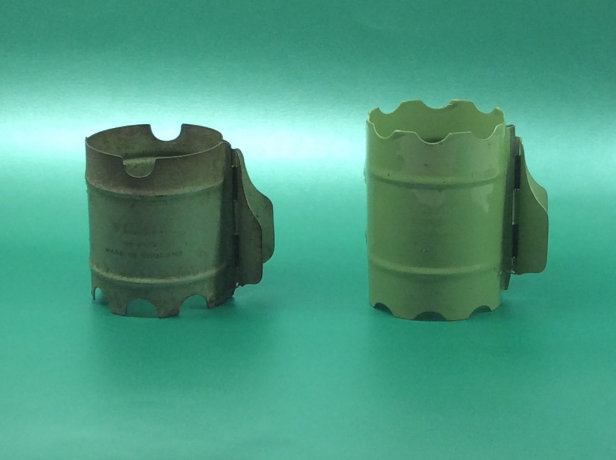

    Windshield
    The one on the left is for this stove, the one on the right's from a mint Valor Packaway
    Though different in height, they share the same part number, 4572

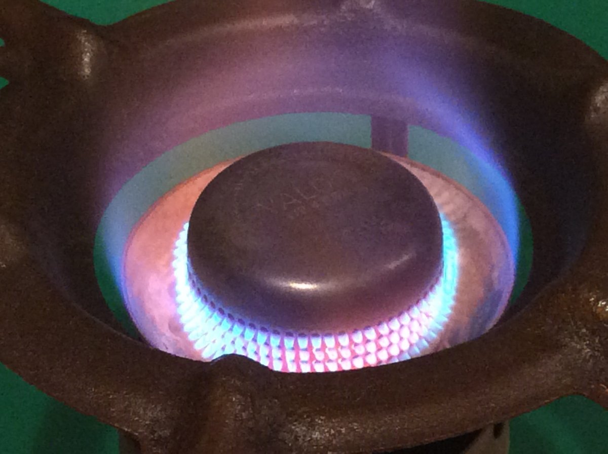

    It just remained to fuel up and fire up

    Iani wasn't one for offering explanations so the factory-docked-or-not pan ring is down to the evidence of that photo alone. What's left of the pan ring is either scorched or heatproof black painted, which hides many sins.
    Question is why someone would bother, but it's not the first chopped pan ring to have cropped up on CCS as a 'special edition'
    Curiously, apart from mine there's another clean example of this stove on ebay at the moment, also with the 'whole' Valor pan ring.
    Without any Reference Library or other authoritative sources of evidence that a 'special' truncated pan ring was part of the kit, I'm unconvinced.
