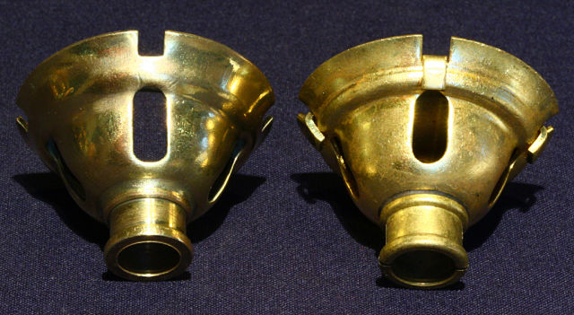

    There are a number of differences between the pre-1950 version and this 1954 version (in the following comparison images, the pre-1950 is on the left and the 1954 is on the right):
    The Bell:
    In 1950, Monitor introduced and patented a split in the collar of the burner bell. The patent ( Link ) states "The slits….. give a certain amount of resilience to the collar or sleeve so that there is no risk of it jamming on the burner tube and the stove can be readily dismantled into it's component parts for packing after use.":
    There is a ridge inside the collar of the pre-1950 bell, but the 1954 has a 'smooth bore':
    The ridge in the upper part of the bell is more defined on the later model:
