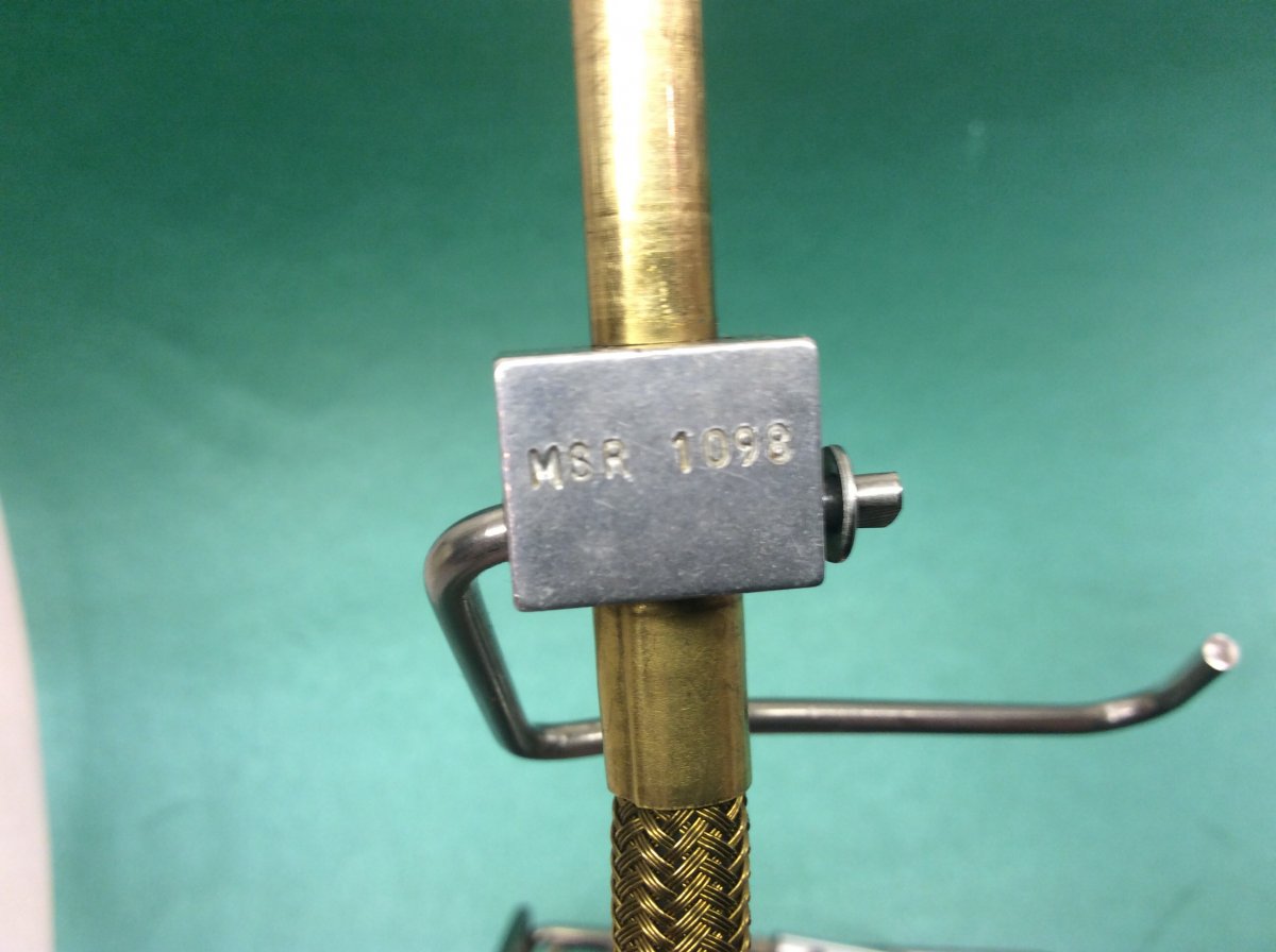

MSR Dragonfly, dated October 1998

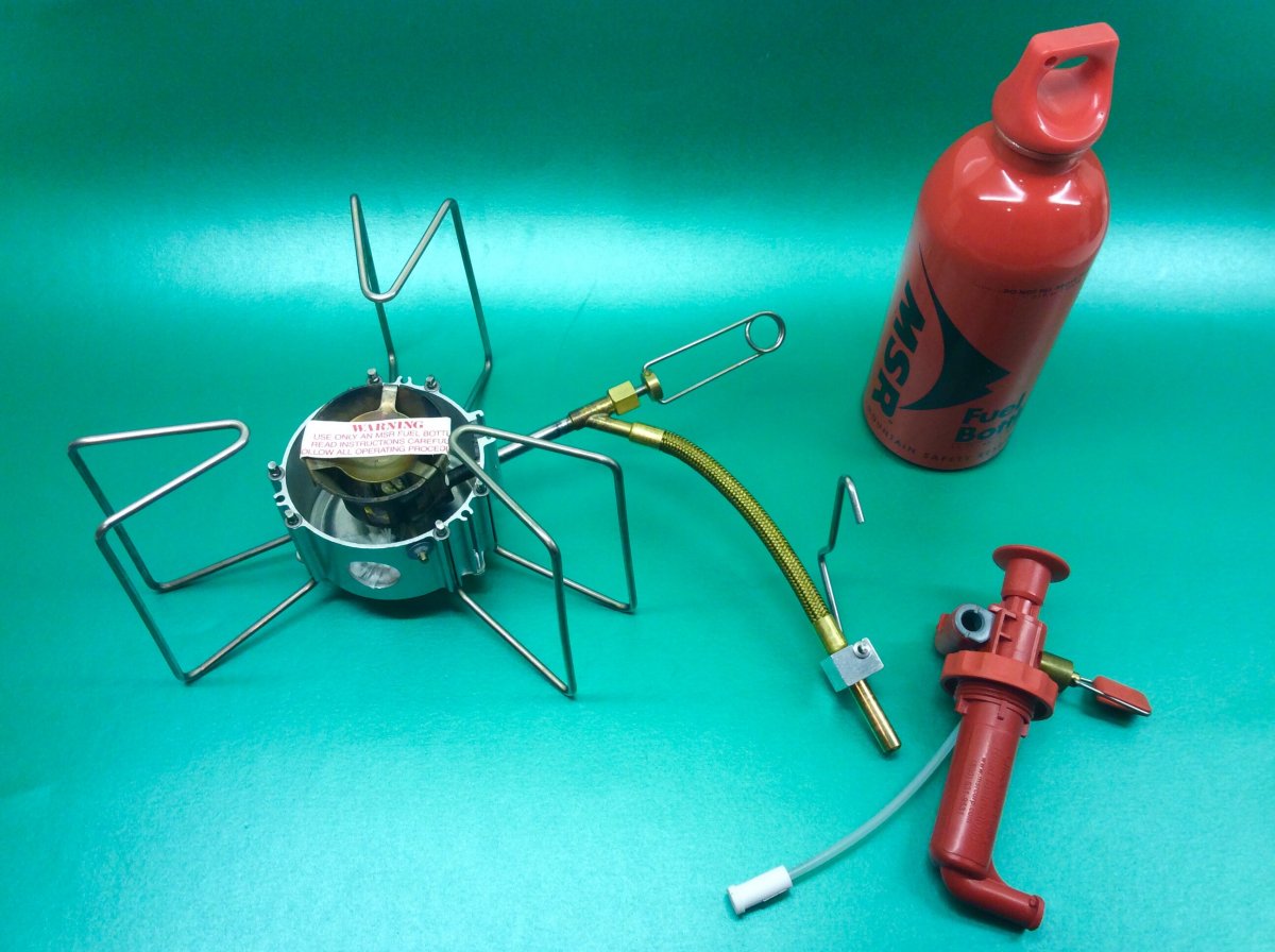

    Cheap for a Dragonfly, though without a pump (no matter, I preferred a Duraseal) stuff sack, kerosene jet, tool, spares, instruction leaflet or fuel bottle. I was unaware until I received it that it was unused.
    They're a popular stove, have been in production for over a decade and they're still available new when I wrote this (early 2016) so I'm not presuming to be telling anyone anything they've not already discovered for themselves about the Dragonfly ... just my impressions of something I've not tried out before.

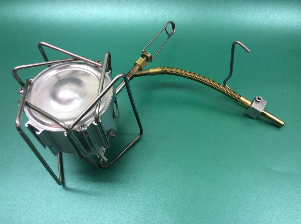

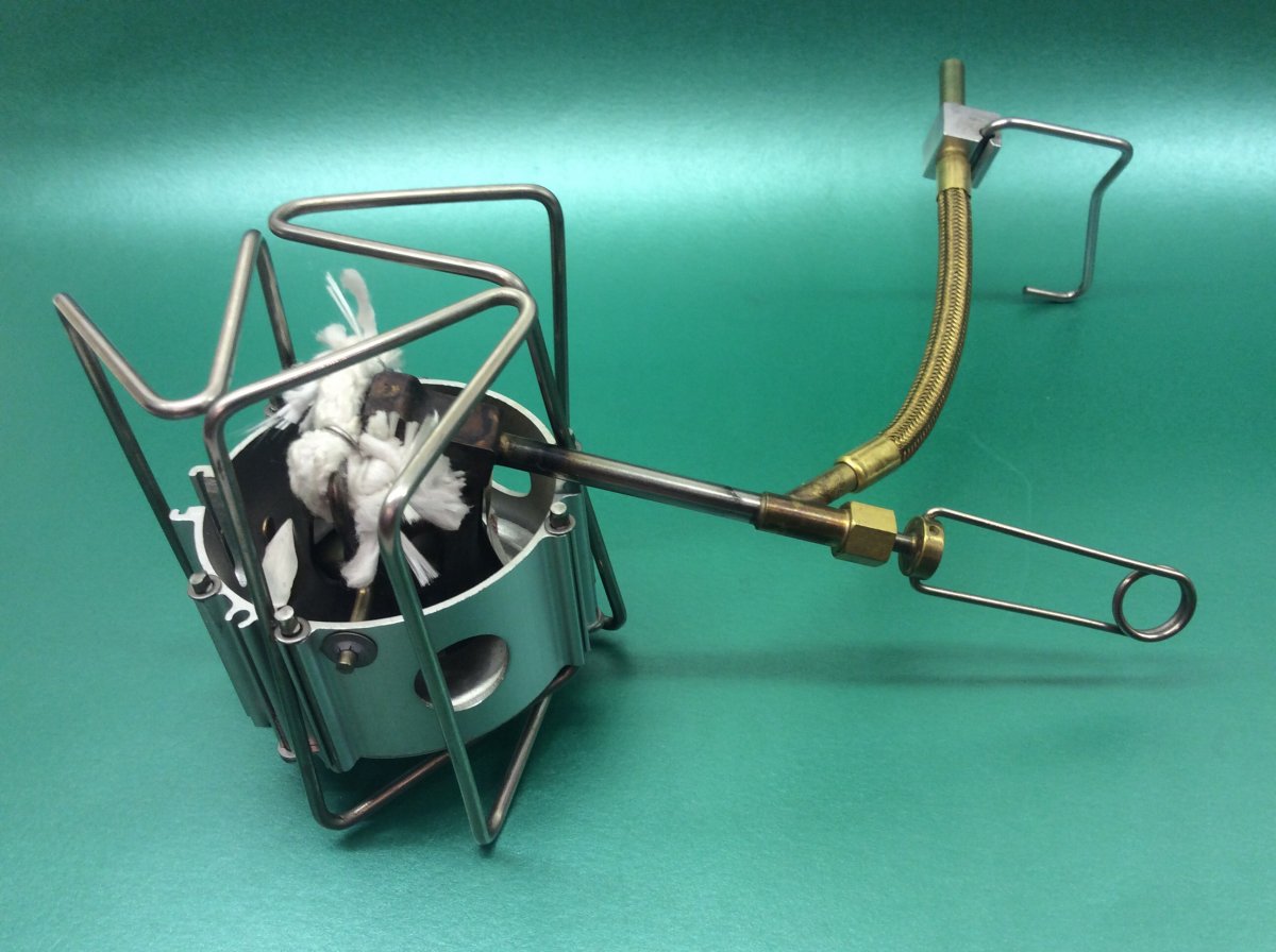

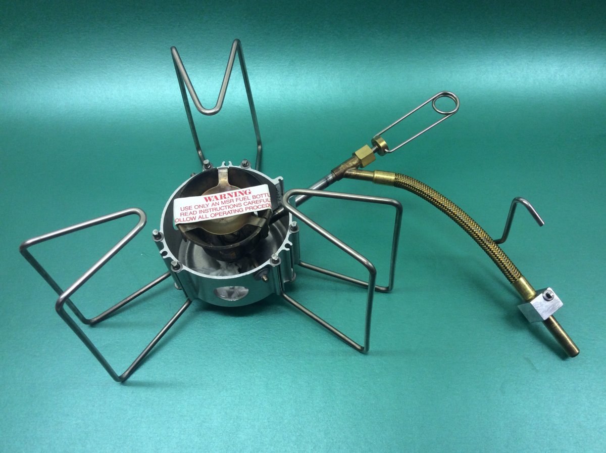

    Legs/pot rests folded up, as has often been said it's not the most compact to pack.
    It's a clever design, unclipping the pot supports from a stowed position relies on their natural 'spring' to flip out into the in-use position ... simultaneously swinging out the burner assembly from it's stowed to clipped-open position.

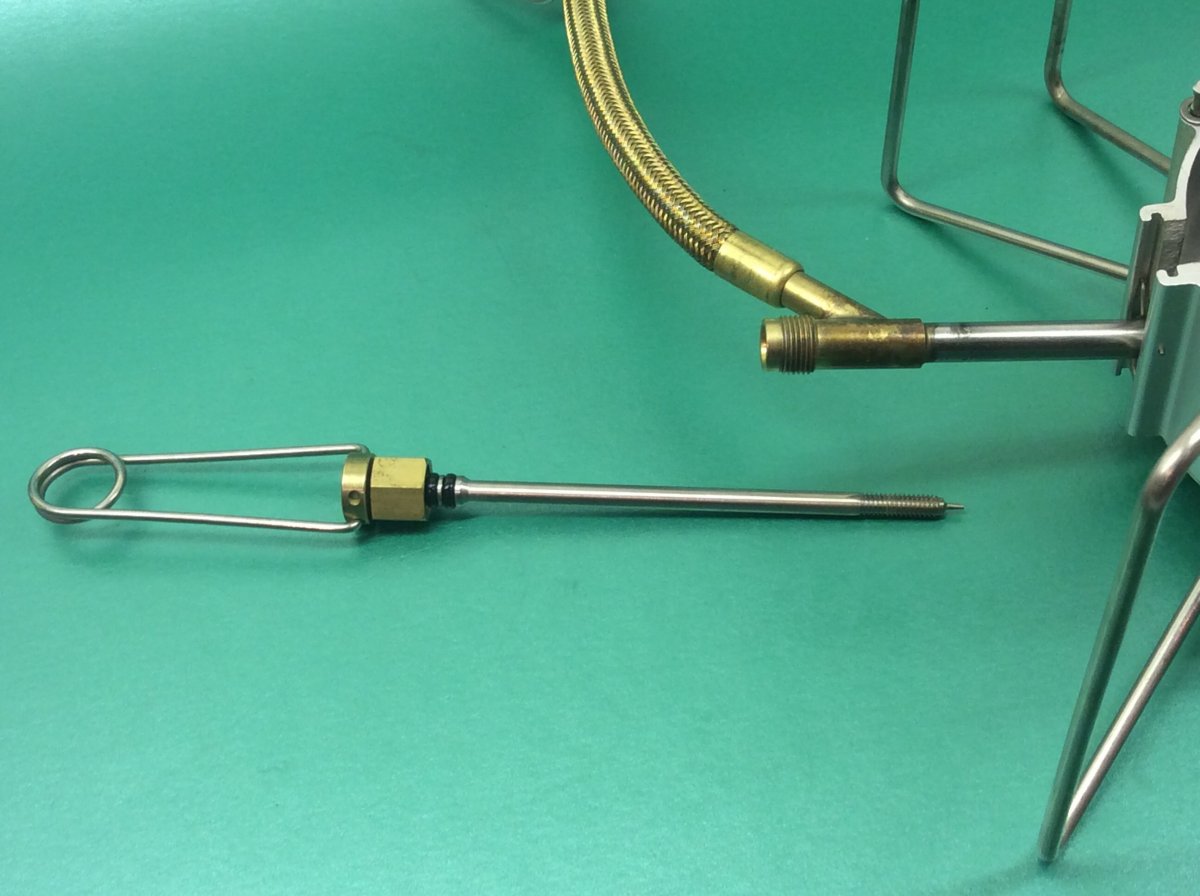

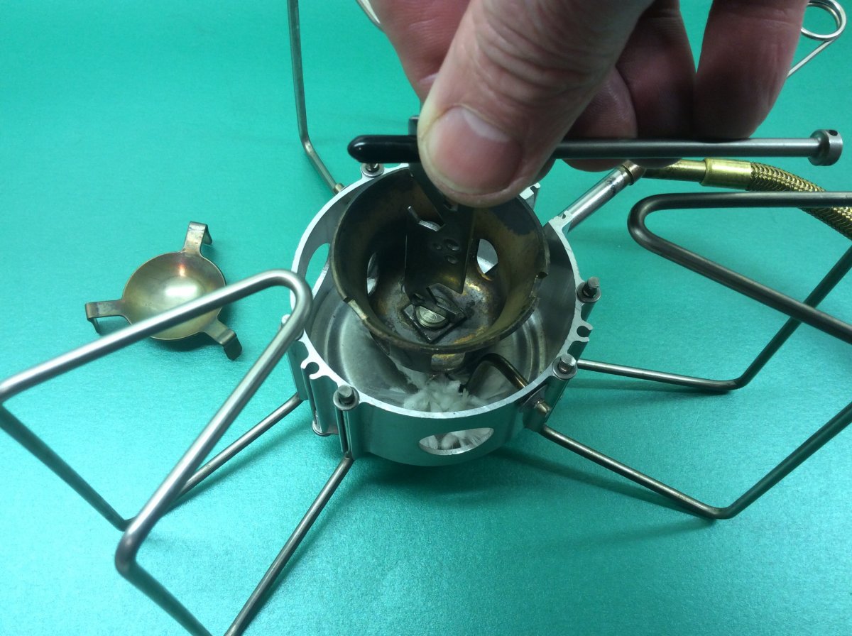

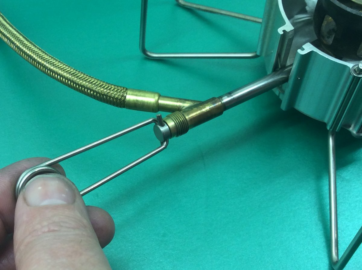

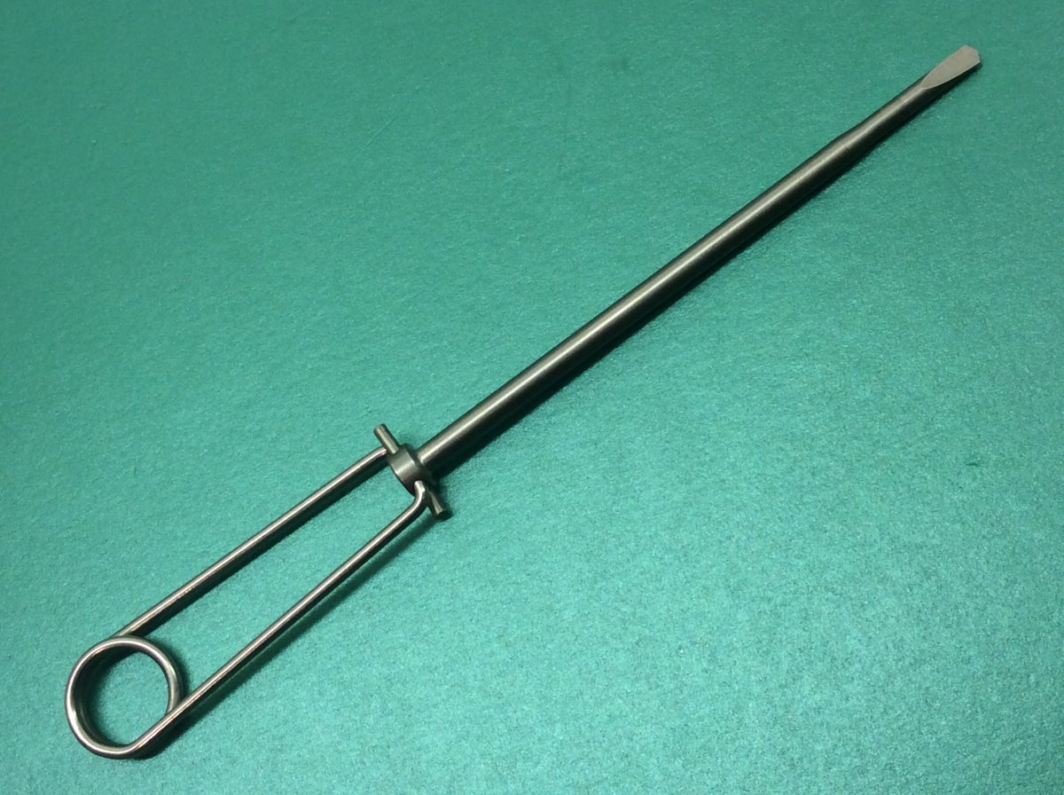

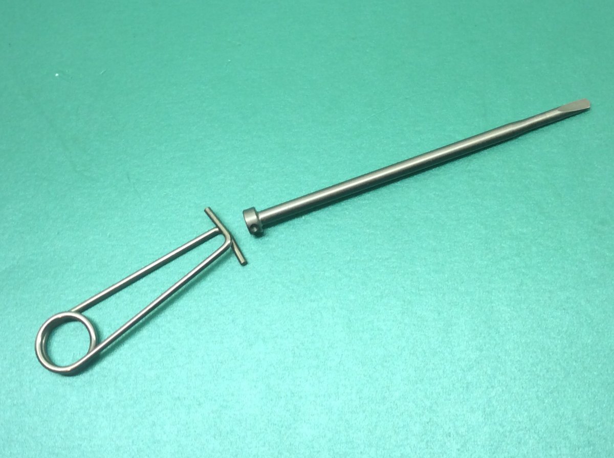

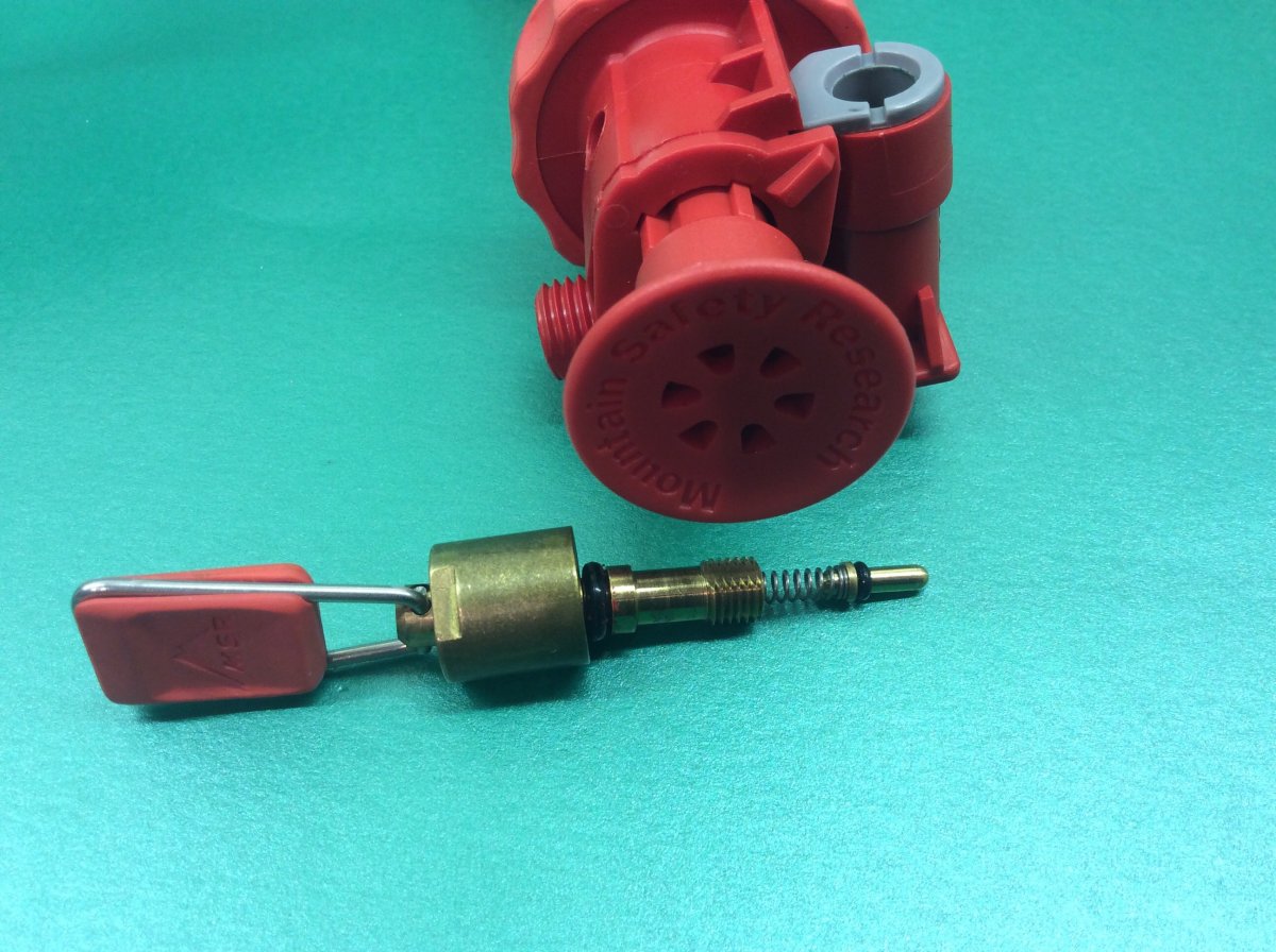

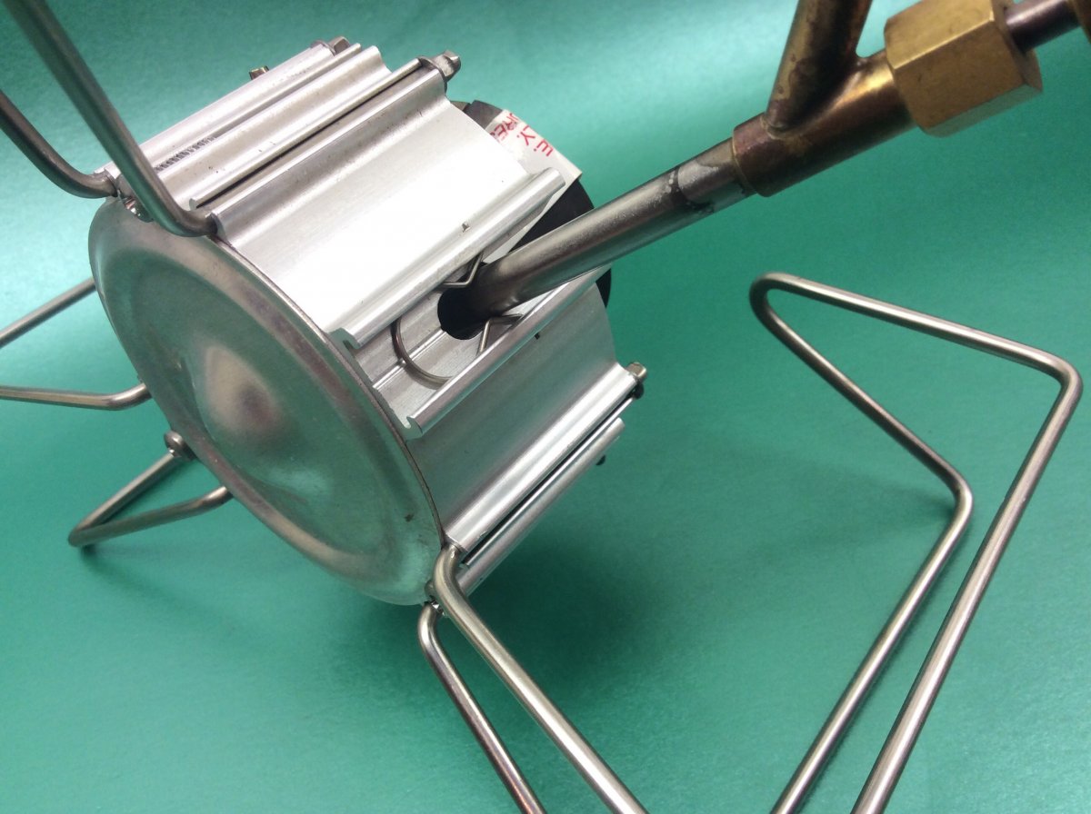

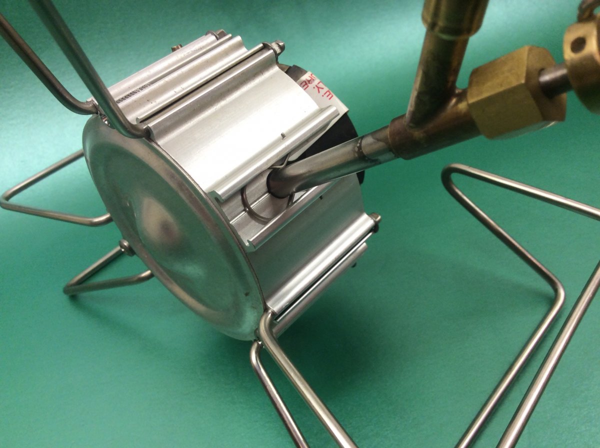

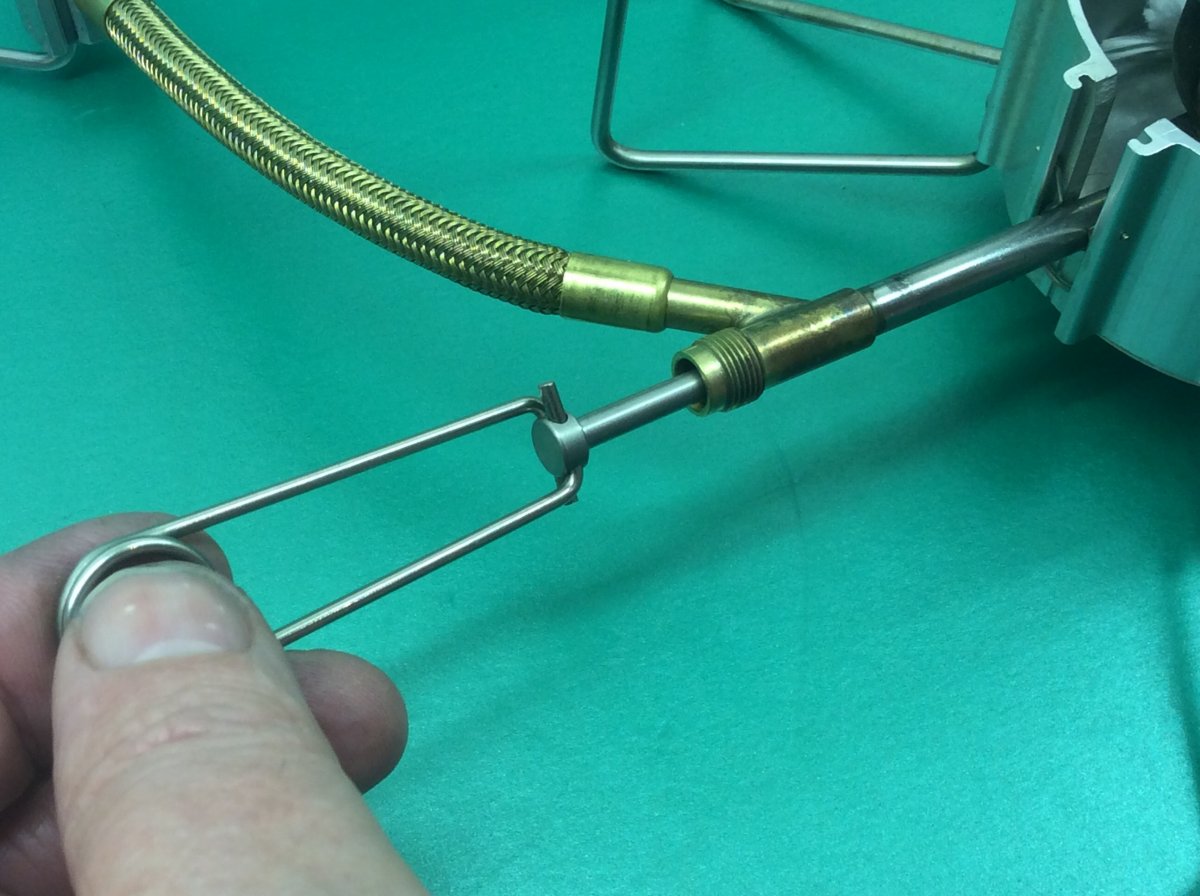

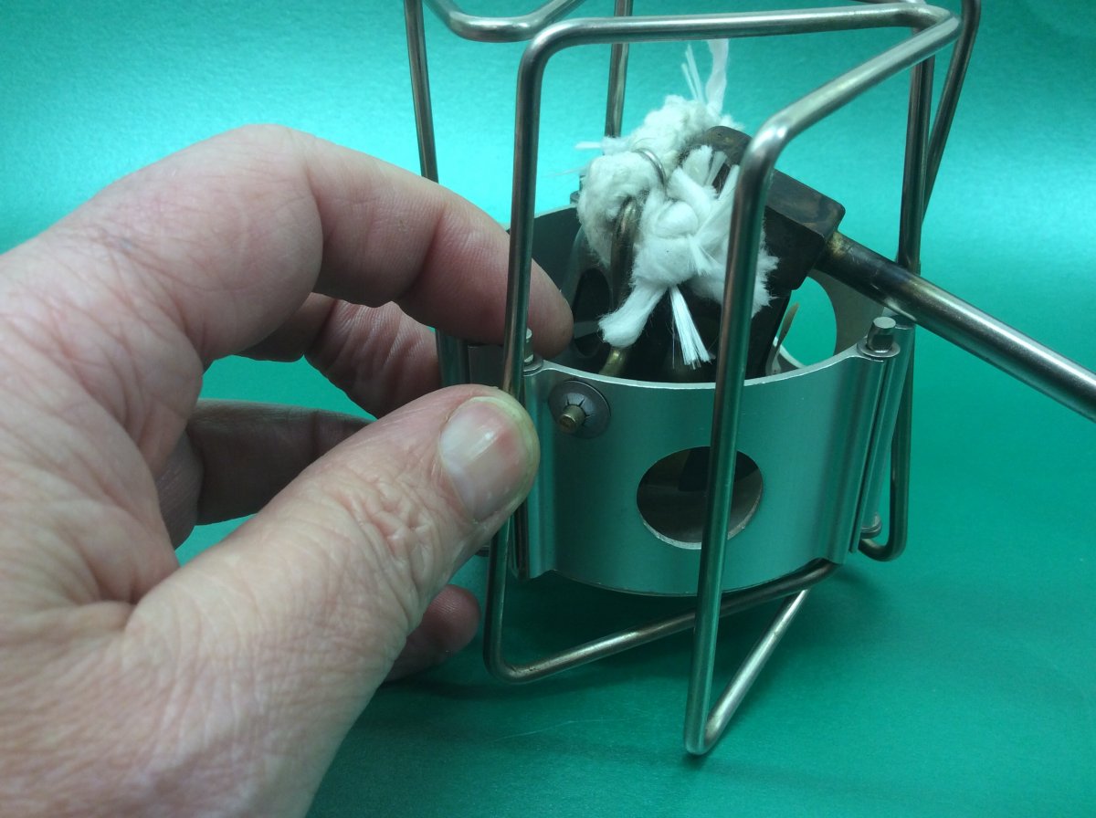

    Jet removal, only necessary to swap a kerosene (DK) jet for the gasoline (DG) one. I'm using the MSR tool/wrench with the burner inlet tube cleaning tool as a lever.
    That cleaning tool acts as a reamer in the fuel tract once the burner control spindle has been removed and the wire handle swapped from spindle to tool (and back again after the cleaning's been done).

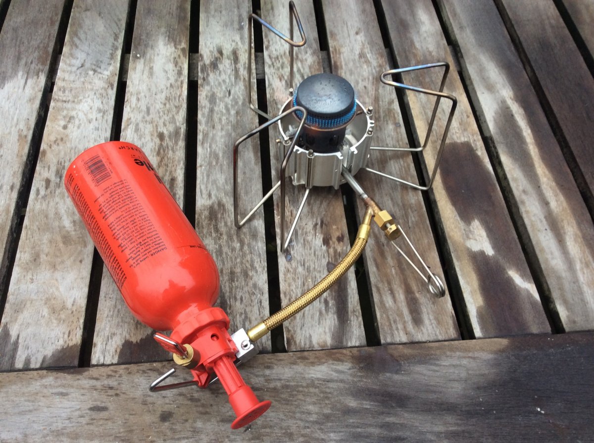

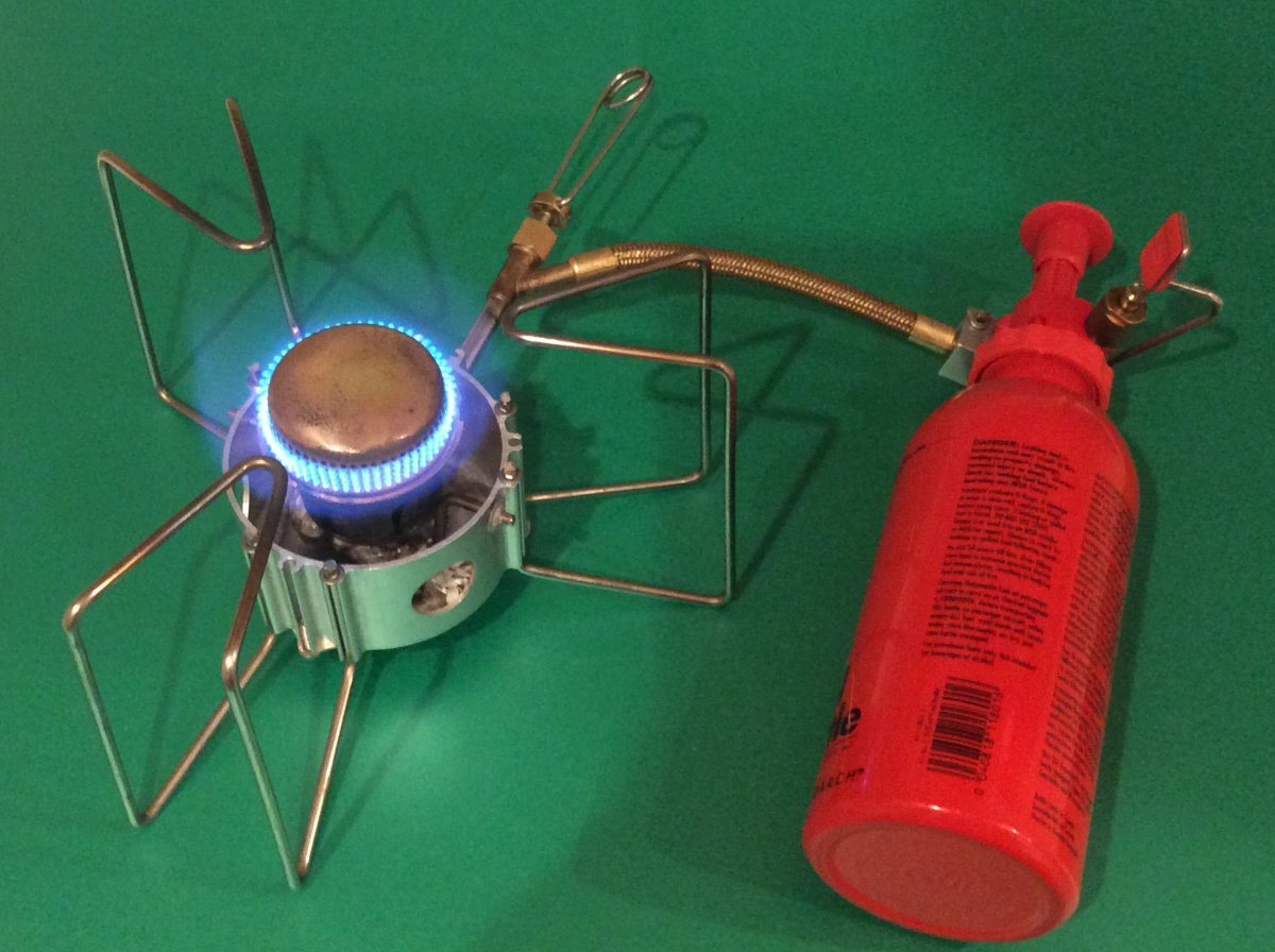

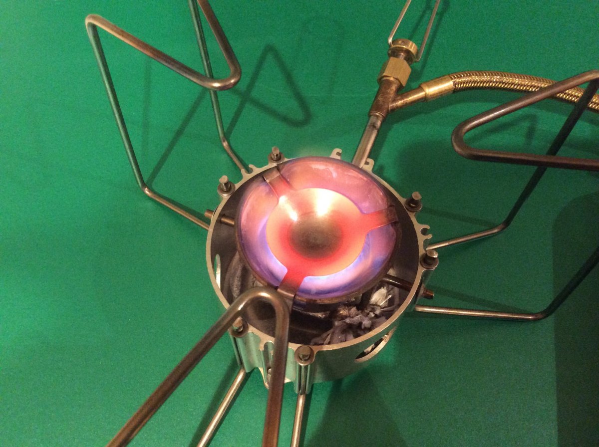

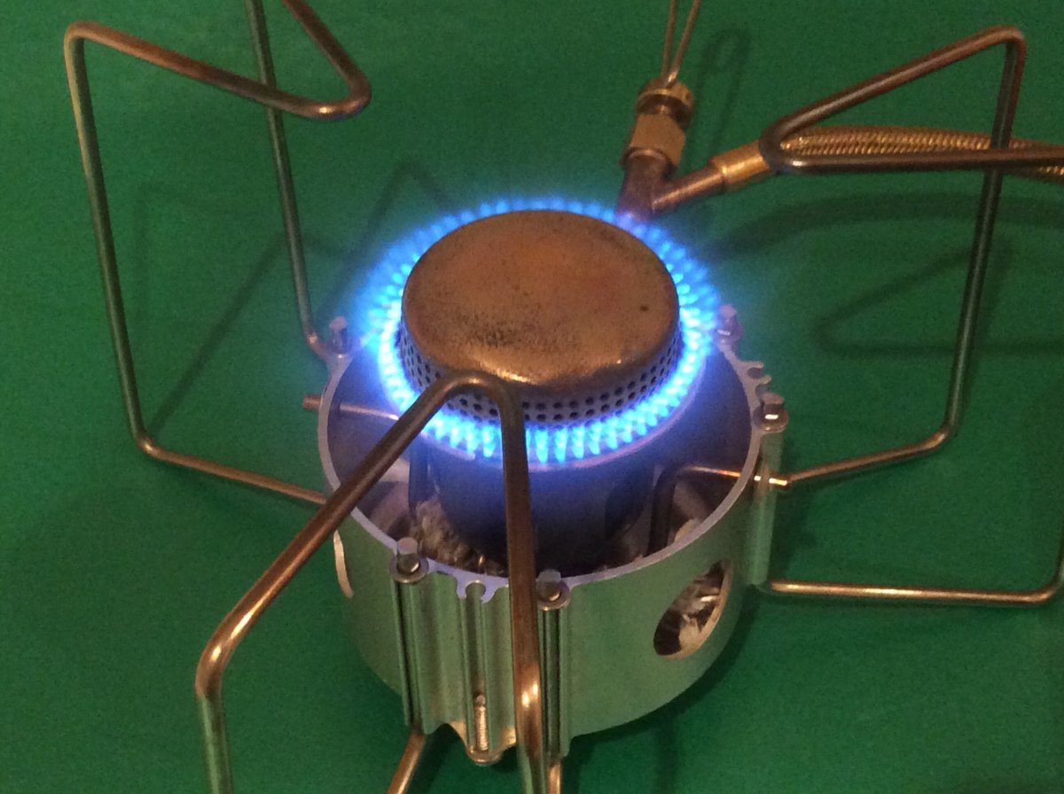

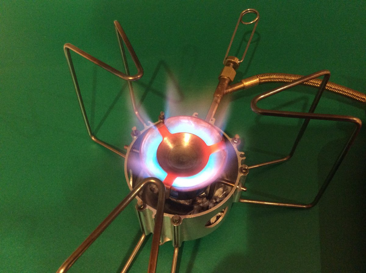

    Firing up the Dragonfly on gasoline (Aspen).
    ... and it's renowned capacity for simmering. I can vouch for that, very controllable, best of any bottle stove I'd say.

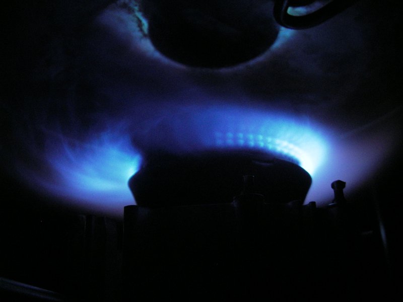

    Like the MSR Firefly and XGK I have though, it's LOUD, putting out an unremitting shriek.

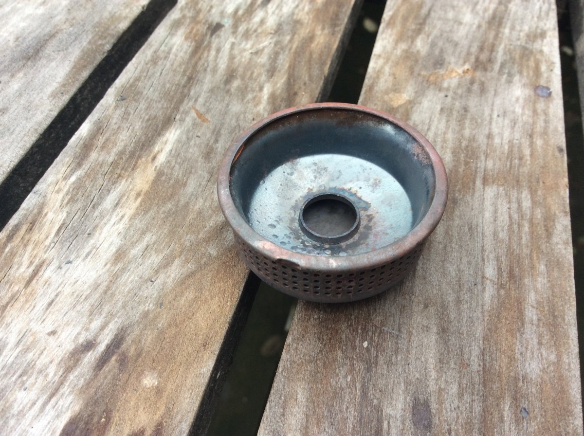

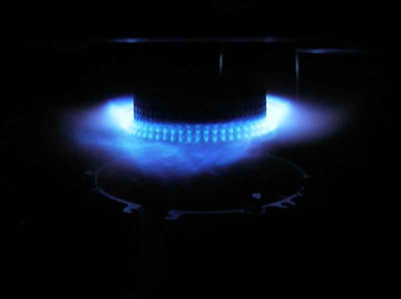

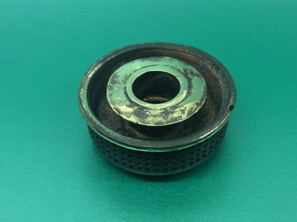

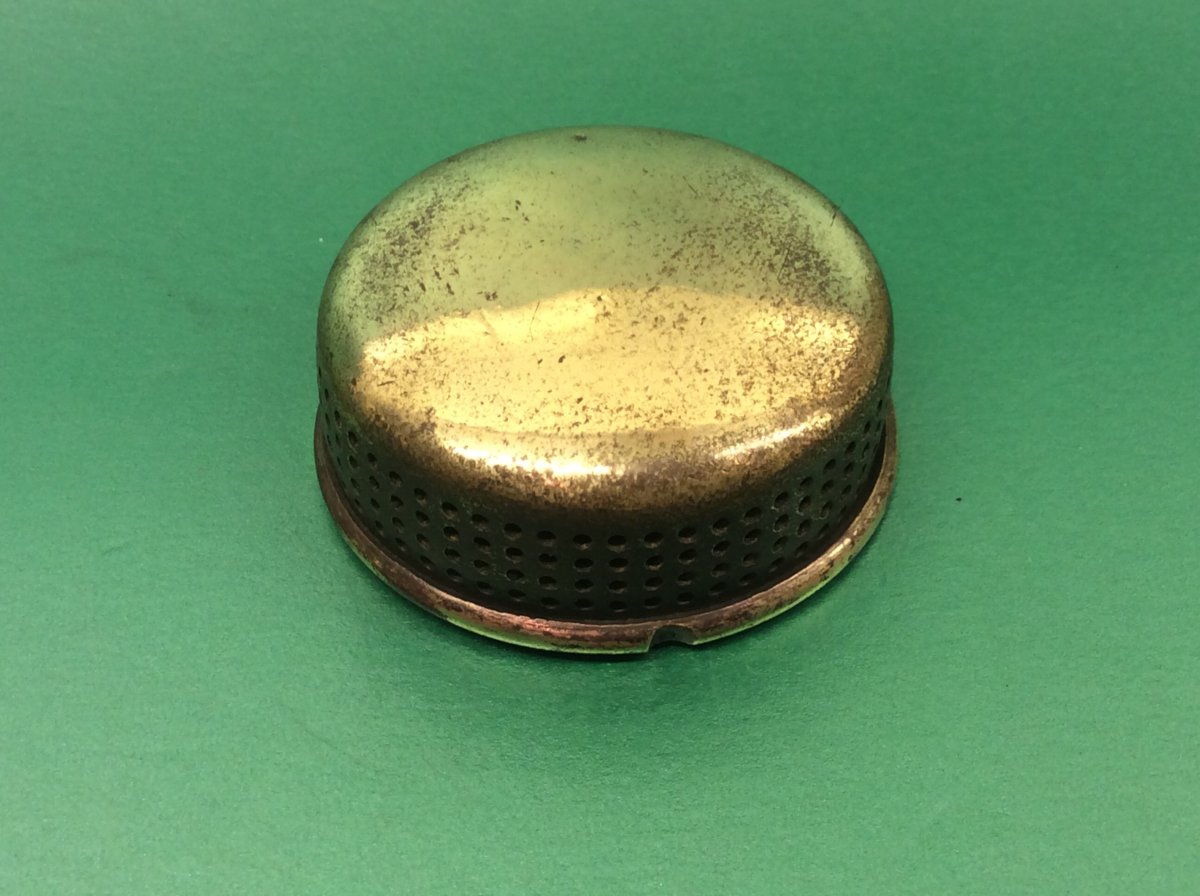

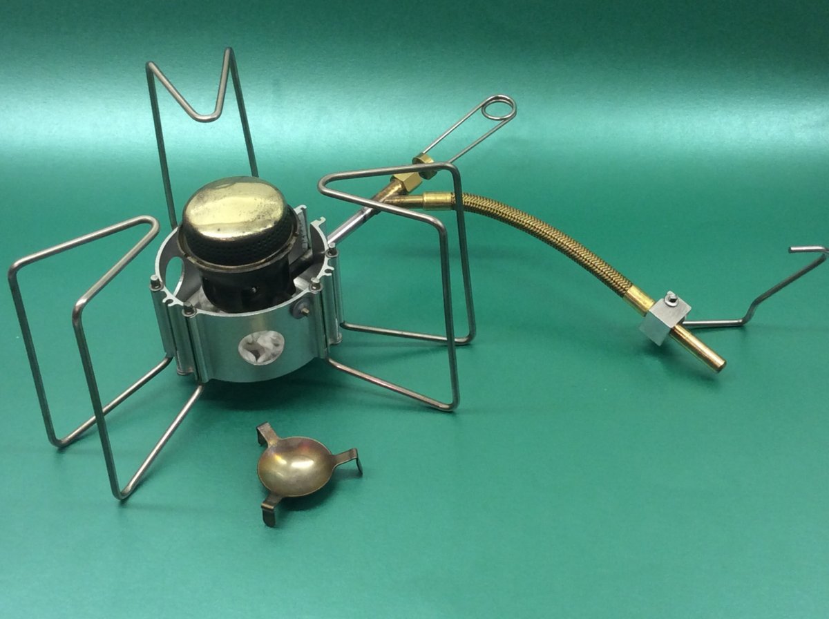

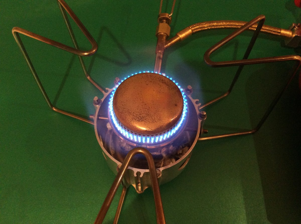

    That doesn't bother me particularly, but it's good to have an optional silent mode and it was fortunate that this Duo-Burn kerosene stove converter cap that I'd previously adapted to instal on an Optimus Nova fit the Dragonfly perfectly and performed very well.

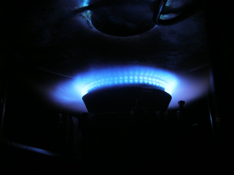

    Full blast - not a usable setting

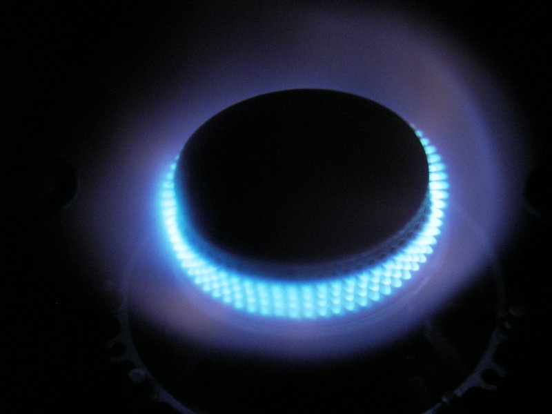

    A very usable simmer.

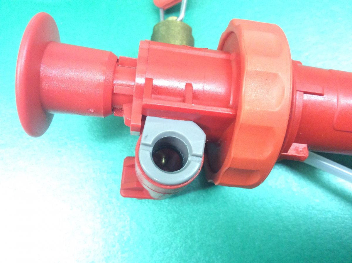

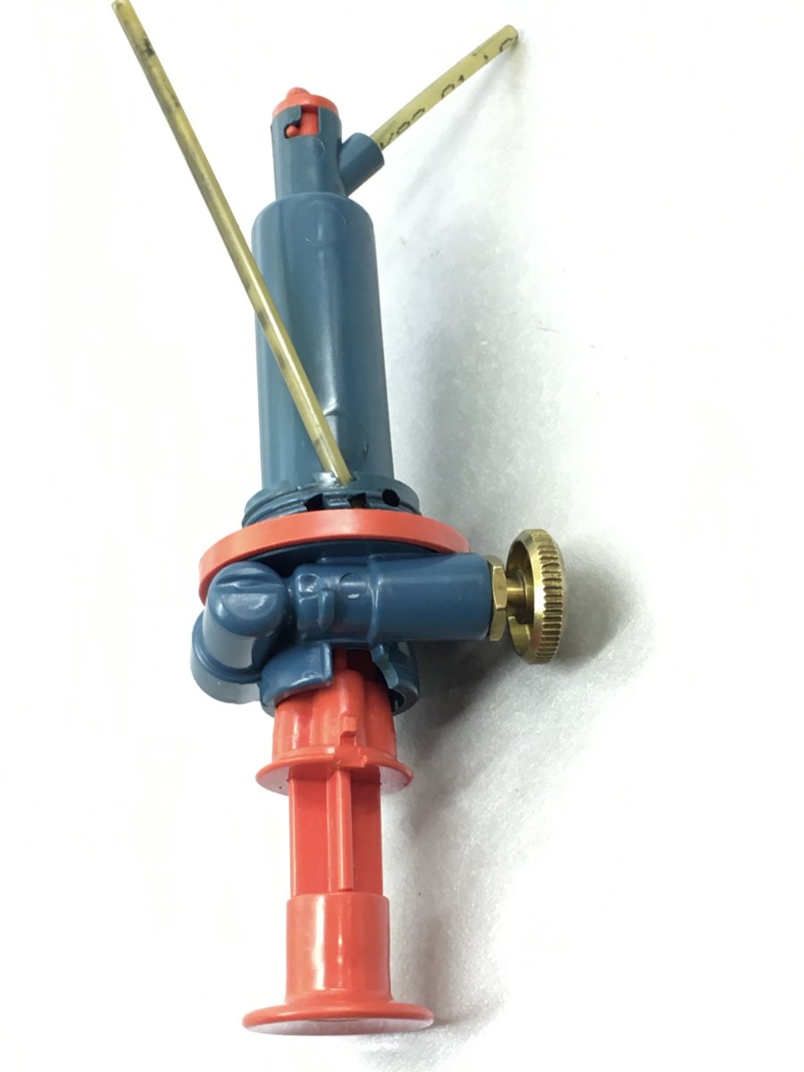

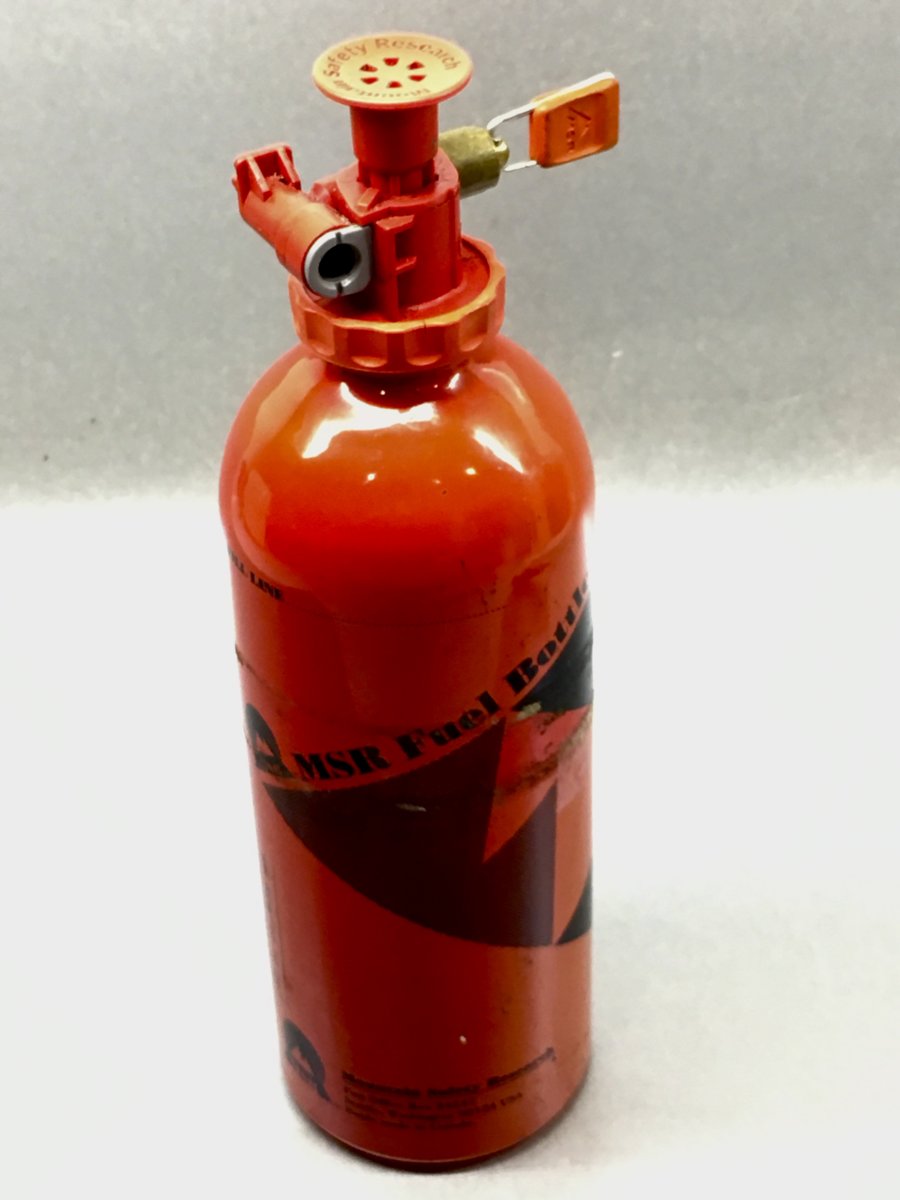

    Finally, some observations on the Duraseal pump. On the Dragonfly version of the Duraseal pump, but not on the version of the Duraseal for other MSR liquid-fuelled bottle stoves (which have a smaller-diameter pump connection tube) there's what MSR call a poppet valve in the stove tube inlet.
    It serves to prevent fuel from dribbling out of the pump when the stove is separated from it after use and would stop fuel flow if the pump valve were to be inadvertently left open when the stove is disconnected from it.

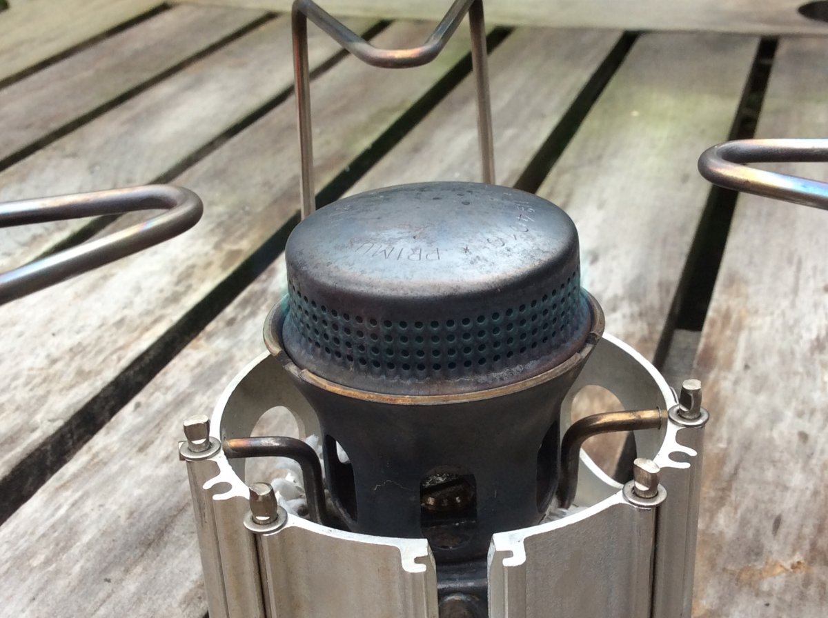

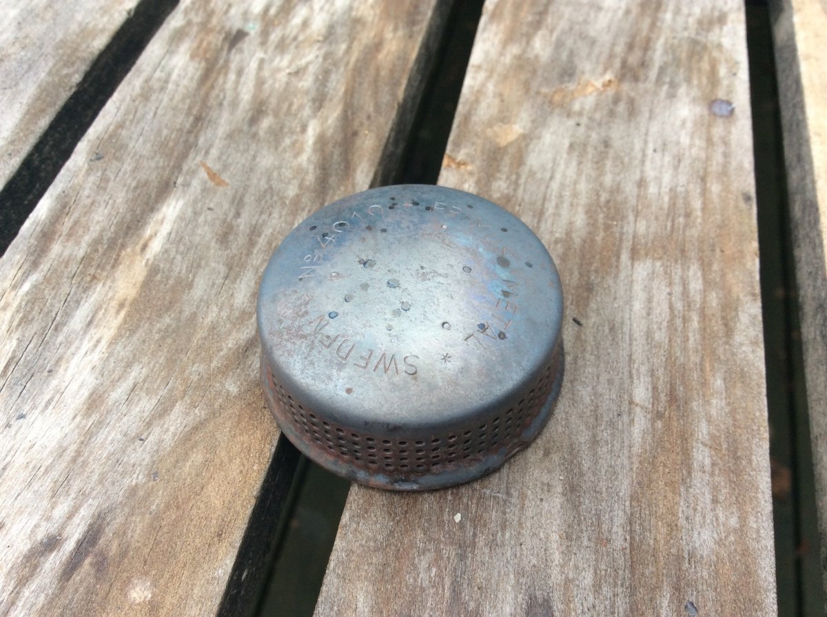

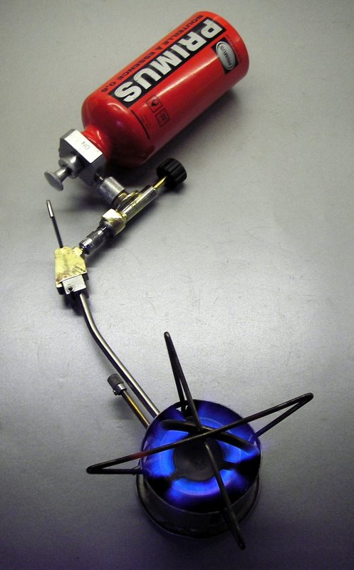

    I don't know if you ever bought one of those Primus 4010 converter caps for a Primus 100 when Base Camp were selling them, but the Duo-Burn cap is the same specification apart from being made of brass rather than Primus Metal.

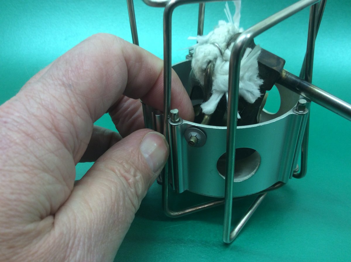

    Once the Dragonfly's roarer flame spreader's been removed the Primus cap sits in the burner bell just as comfortably as did the Duo-Burn cap without tipping or getting stuck in there once the stove's been fired up.
    @cottage hill bill

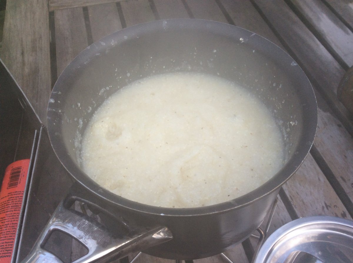

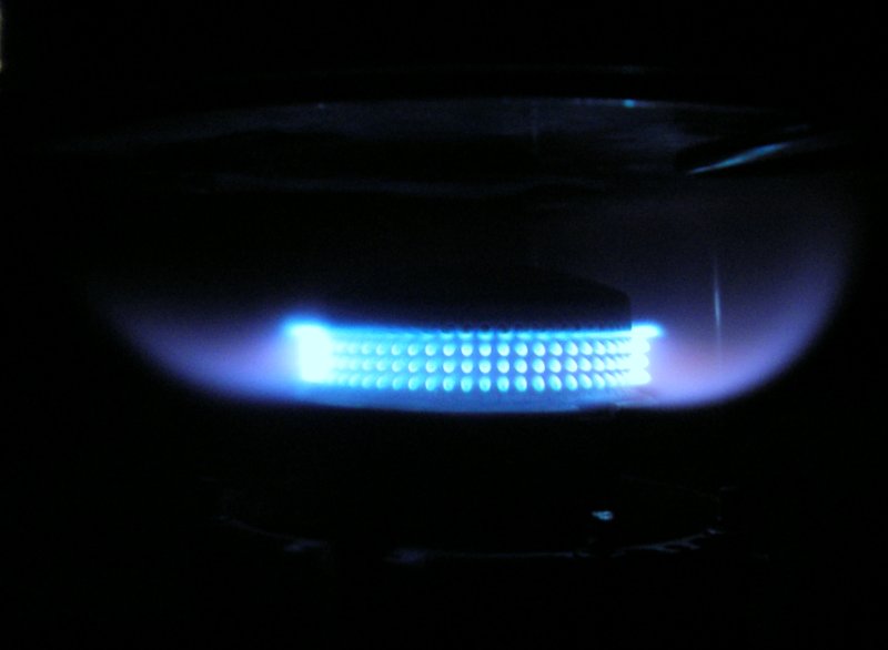

    Moreover, having used it at lunchtime to cook those TRUE GRITS and brewing water for tea a few times since, I can confirm that it gives the necessary thermal conduction to the burner bell to maintain vapourisation and not just while the stove's still hot from the priming charge.
    Simmer setting for the Grits.
    I notice that in THIS recent post, Ross said,
    So even if Base Camp have sold out the Primus product, there's a possible alternative source.

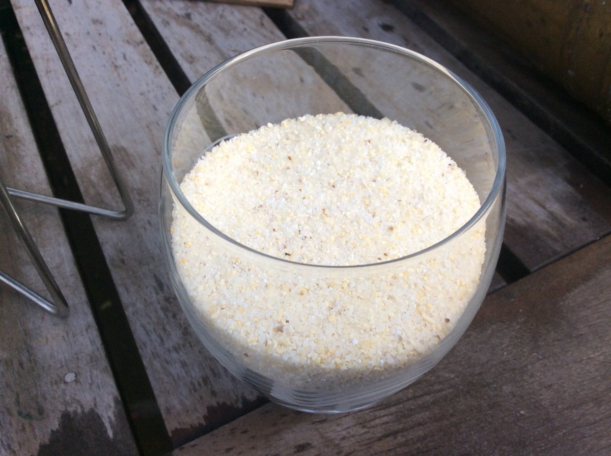

    The Grits by the way ...
    ... uncooked
    ... cooking
    ... cooked

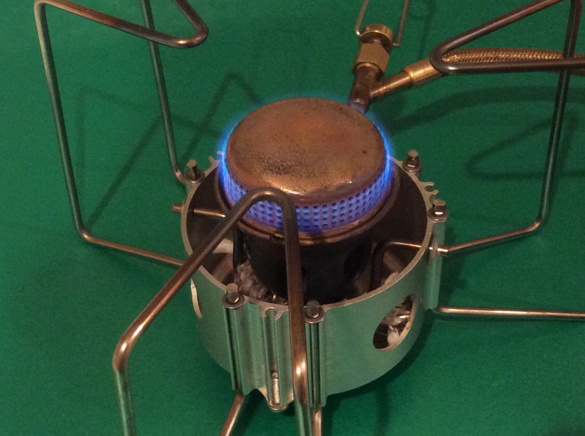

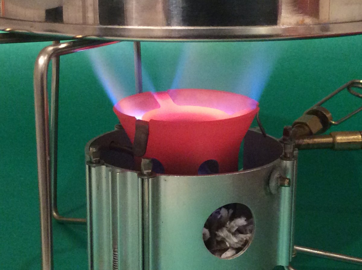

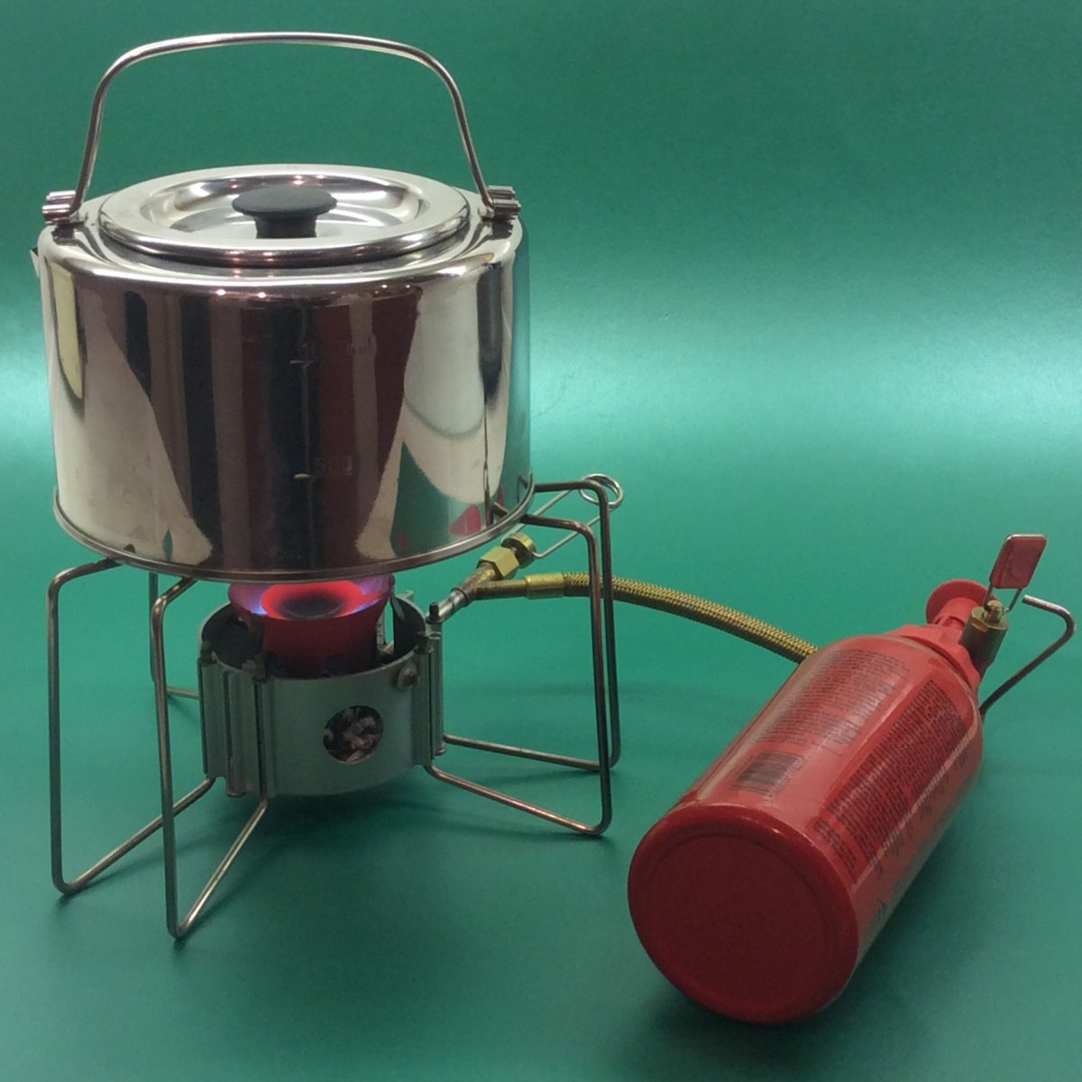

    The pot base level set by the pot rest height above the burner may well determine the manufacturer's commendable commitment to producing a stove with a minimum of carbon monoxide emissions, but it extends boiling times too much for my liking.

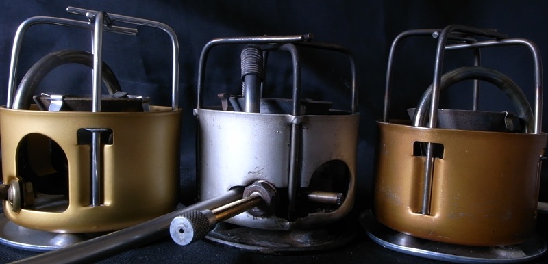

    In his in-depth analysis of the MSR XGK Rob (Snowgoose) presented this photo of an XGK line-up to show how the changing fashion of pot rest height affected that model. The Dragonfly goes way over the top of these, literally.
    Although I wouldn't contradict the manufacturer's stance and am all for stove safety, given that I'll not be using it in-tent or indoors I'll be shortening the pot rests - cutting out a section of each vertical rod and silbrazing up the final version.
    True, the use I've made of a silent burner converter cap has probably worsened the effect of the large distance between burner and pot base. The roarer burner has a distinctly vertical flame pattern and the silent burner directs flames horizontally - an endorsement here then for the manufacturer's recommendation not to stray from their specification or modify their product. Fair enough.

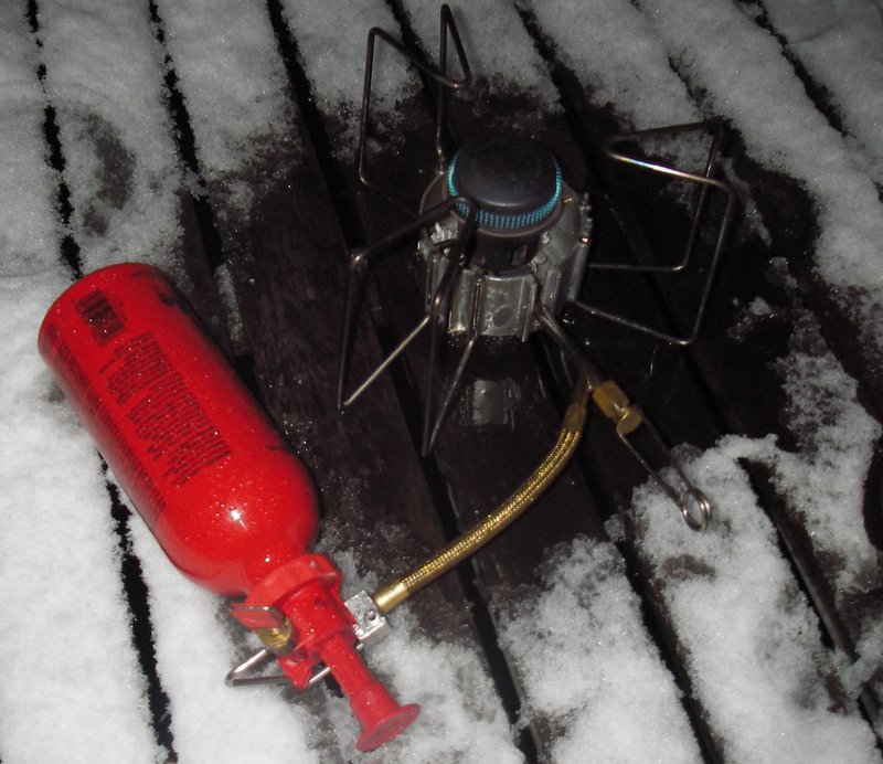

    Snow fell and I took the Dragonfly out for an evening session.
    The converter cap can get overawed by the power of the Dragonfly.
    With the throttle turned down a bit, it's fine.
