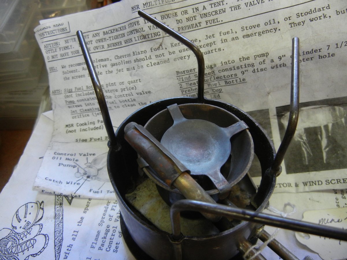

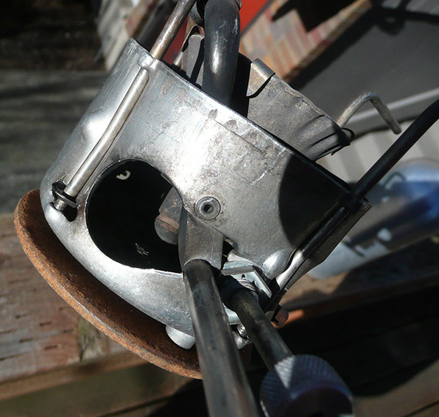

    My MF came to me with the tin, or thin stainless steel piece, already wrapped about it's generator. In the next photo, you can see my own MF on the left, and how it was originally shipped by MSR, in the center, with the last version of the MF, or possibly the DF by then on the right, it's generator wrapped with round spring wire, just as is yours. Again, mine is on the left, but the other two belong to my good friend, Sam, up in Idaho, who had loaned them to me for a comparison photo and research. (Thanks, Mate!!) @idahostoveguy
    I now own one one of the later versions of the MF stove, and have come to believe that this one was really what MSR once called the DF, after they realized that it really was not going to work as a true multifuel stove. In point of fact, it wasn't until the GK was debuted that MSR finally had a really true Multifuel stove. What changed to make it so? Easy: the flat generator did not easily lend itself to removing the rod within it. It was with the G and GK that the round, braided cable finally replaced the earlier solid rod inside the fuel lines, and thereby, which finally allowed removal, and scouring of the fuel line. The GK, the generator also went from flat across the top, to round, which, with the addition of the braided wire cable, helped MSR to finally succeed!

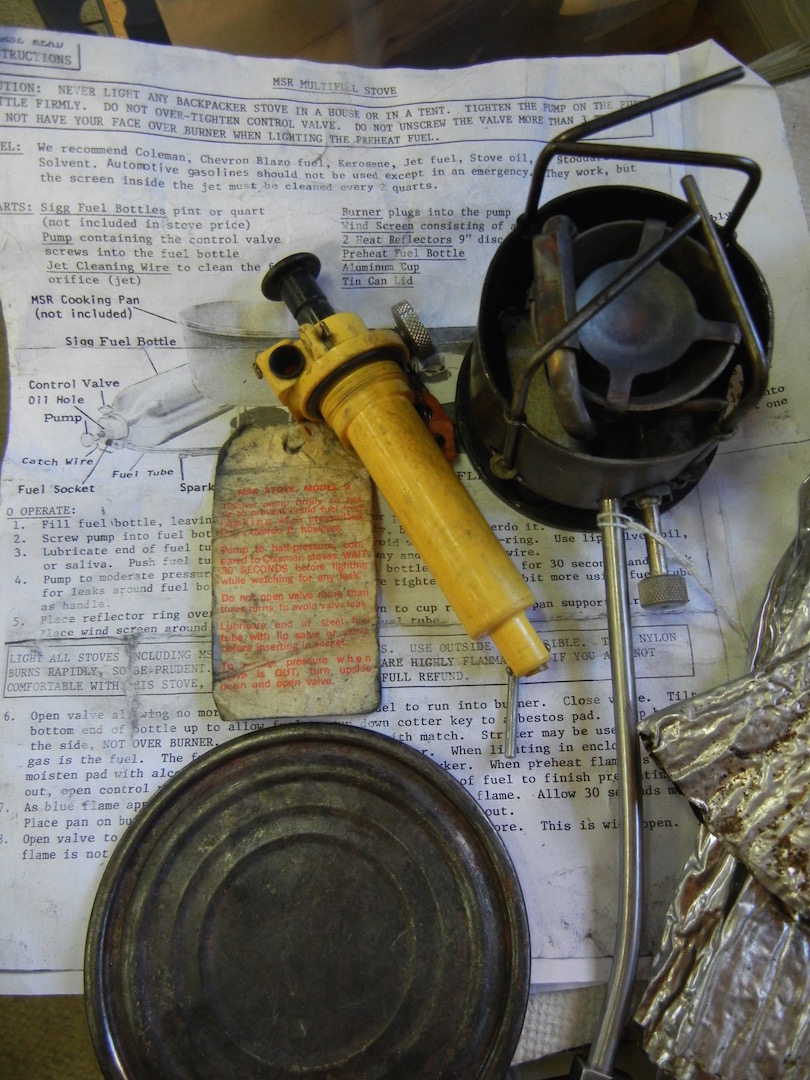

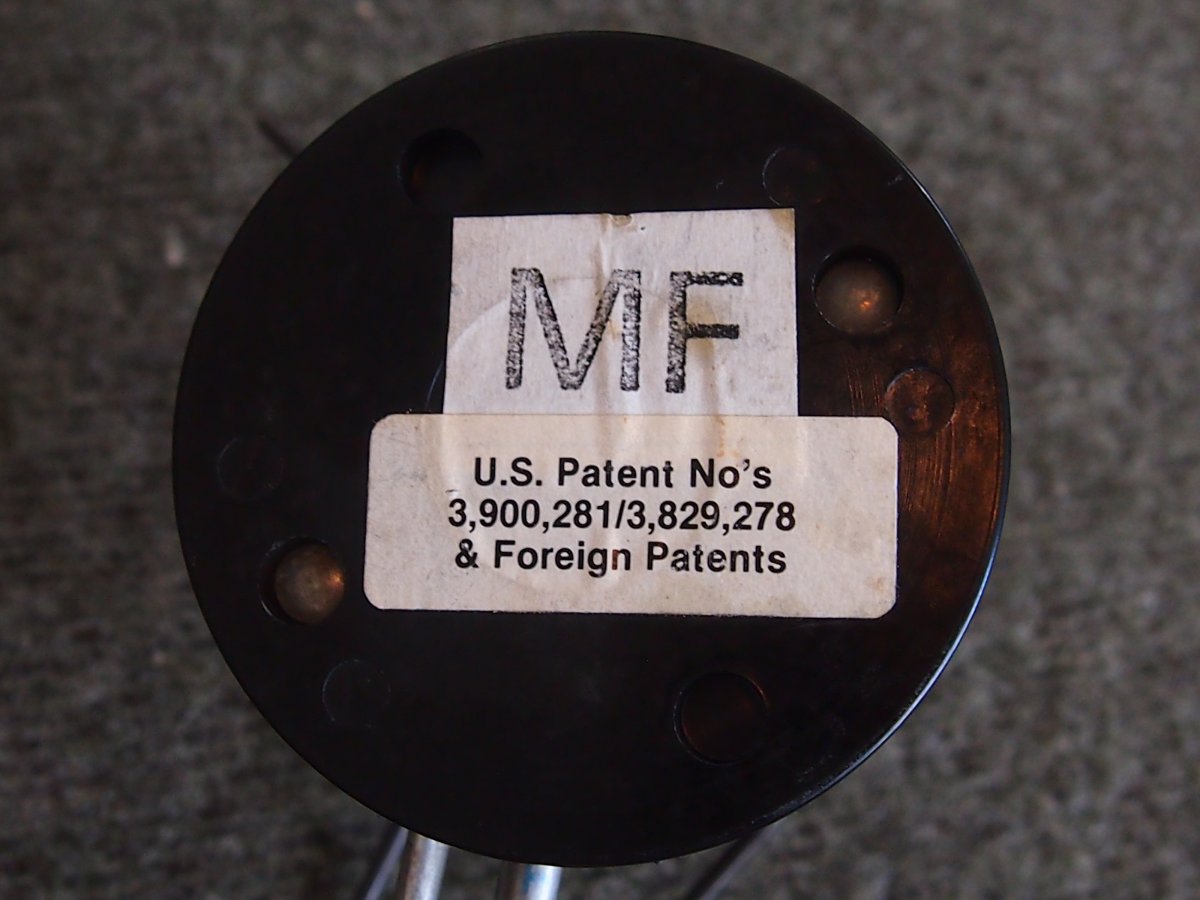

    Here are a few photos of my own MF, and it's original pump, which is interestingly labeled "MSR Stove Model 9", along with the dated instructions, and it's original simmering device, sent by MSR. It was nothing more than that sent with their Model 9, too: a flat tin can lid!
    Remember, all these various models, were derived from the original MSR which Larry Penberthy designed, built, and marketed under the Mountain Safety Research banner, the venerable, and quite rare Model 9!! Though I dearly LOVE all the stoves in the Model 9 to X-GK EX family, it's Ol' #9 that is still the best of breed, when burning Coleman Fuel!! That scalloped burner bell, really gave the blue flame a lovely pattern, and it still captivates my heart! Here's a shot of it, taken at night, at CASG #7:

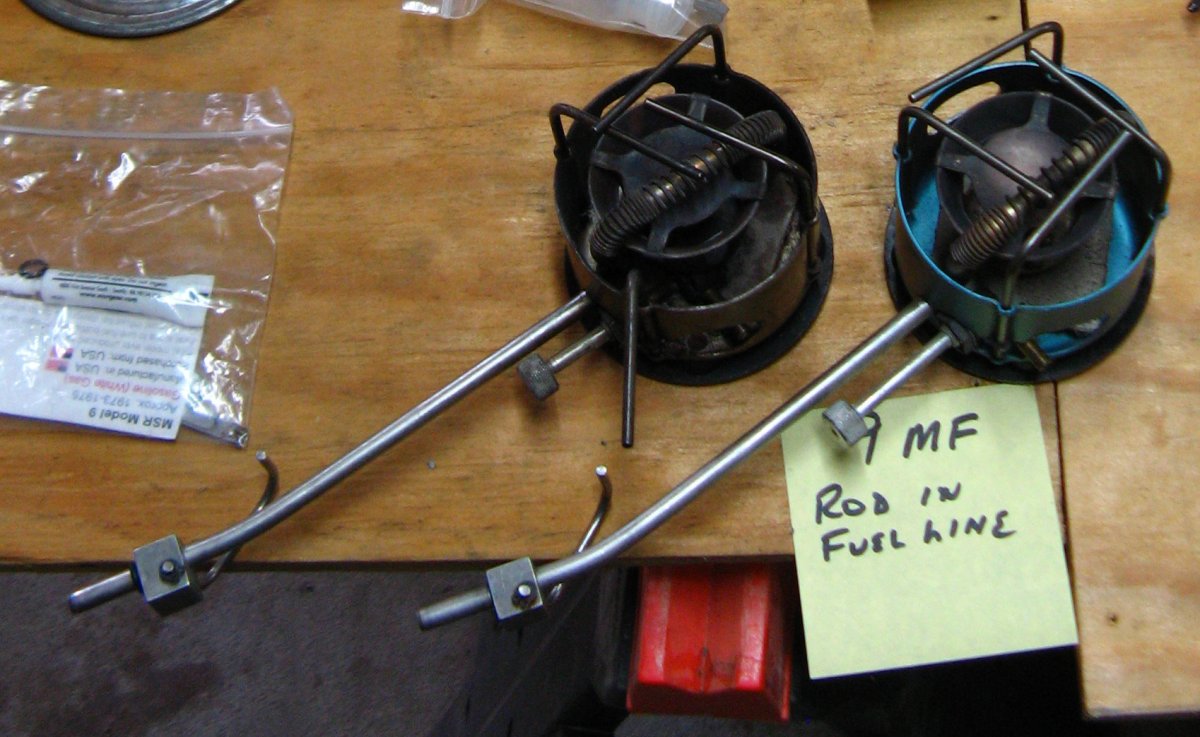

    Here are the 3 MF/DF stoves I have. I am not going to state all details.
    No date codes on any of them.
    All have the 'stubby' sparker.
    These 2 (9MF) have a solid rod in the fuel line.
    One is a blue color.

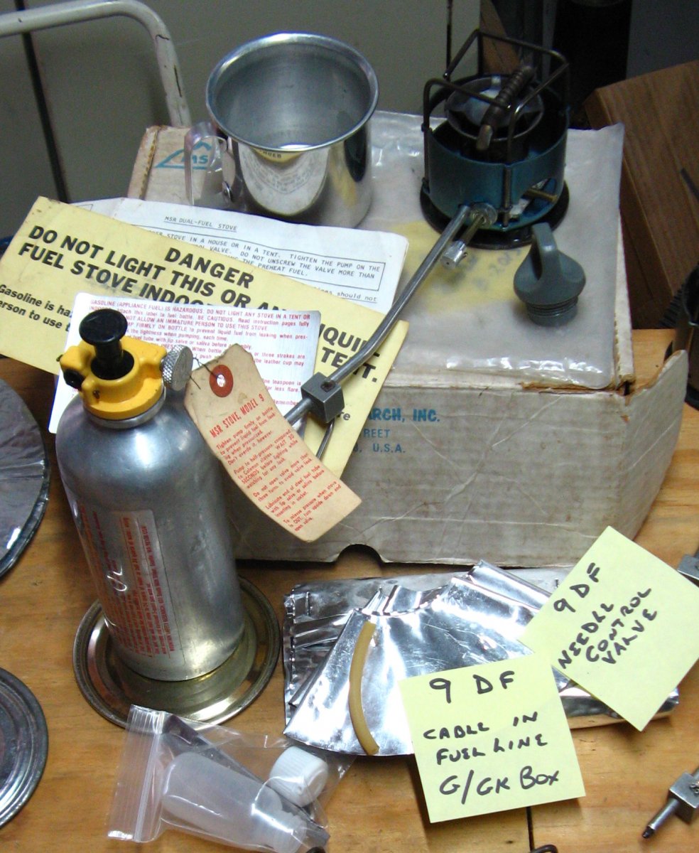

    Now, what I believe to be the 9DF, as seen in the link above .... LINK.
    This one has a cable in the fuel line.

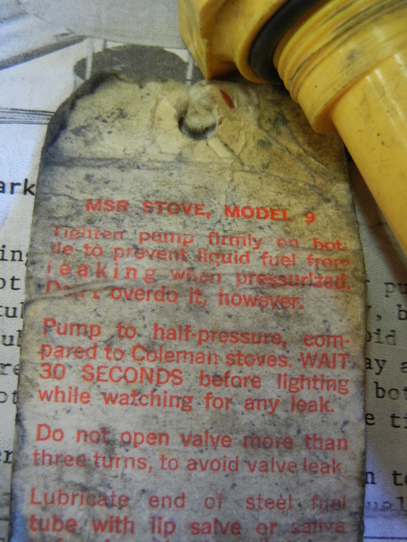

    Cotter pins in pump to hold parts together.
    MSR Model 9 stove tag.
    Instructions state MSR Dual Fuel Stove.
    Instructions note a NEW needle control valve,
    The instructions I received with this stove, located in the Library, are dated JUNE 1976.
    Blue color.
    G/GK box of a different size, larger, than later G/GK boxes I have seen.

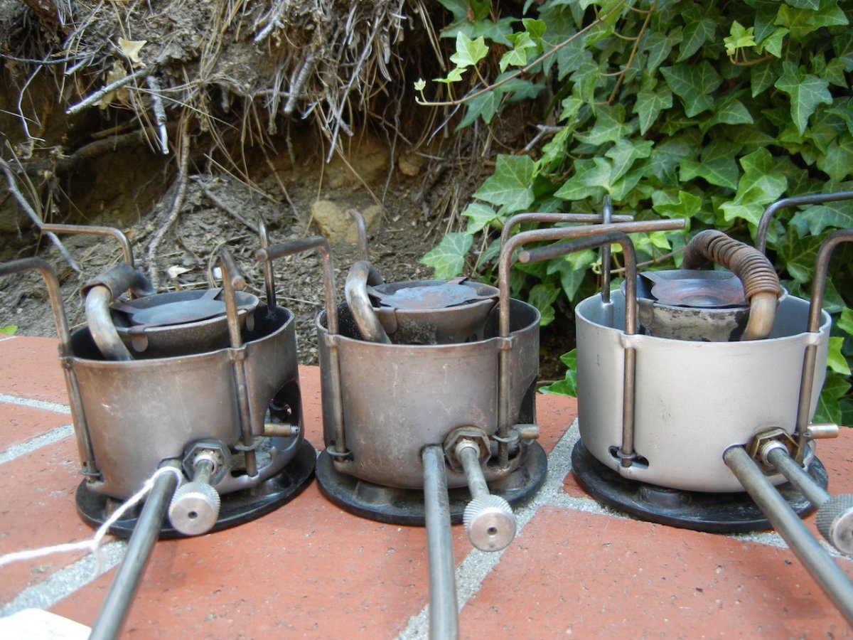

    I was going to start a New Thread but decided to put this information here in hopes of continuing the discussion of the MF and DF timeframe that stopped on February 24.

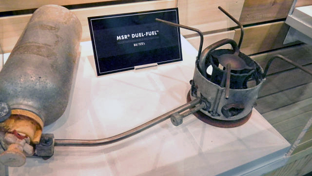

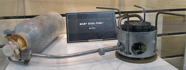

    This stove was on display at the MSR booth during the Outdoor Retailer 2011 trade show. This photograph was shot by a CCS member that attended the show.
    steve1000 - http://classiccampstoves.com/threads/msr-overview-from-outdoor-retailer-2011.19410/
    The same stove photographed and uploaded to trailspace.com.
    http://www.trailspace.com/blog/2011/08/17/not-so-new-msr-stoves.html
    A link to hikin_jim’s post with further discussion.
    http://classiccampstoves.com/threads/historical-msr-stove-photos.19096/
    And this one from eBay.
    Interesting, these stoves look very similar. See any similarities between these stoves and the Model 9? Seems like MSR did make this stove after all and it could be the original Model 9MF.
    There isn’t any documentation to support these stoves exist, not yet anyway, but these pictures are worth a thousand words. If these stoves were not manufactured by MSR, why would one of them be displayed by MSR at a trade show?

    That is true. However if it was true why do they not appear in any collections of members here?
    It might be that MSR displayed prototypes at the show not production models. This is common at car shows where less than half the concept cars actually make it to production. It could even be that prototypes were the only historical stoves MSR had to display.
    Even then though those prototypes would of been snapped up long ago by collectors
