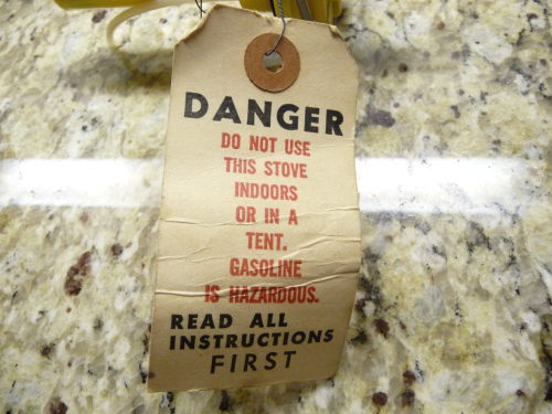

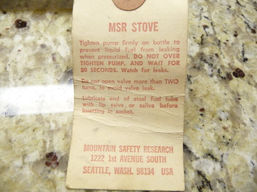

    Sam, your X-GK is a VERY nice one, Mate!! It's not one of the earliest ones, but is still nice and early. If you check the tag on your pump, I'd appreciate knowing what it says, please.

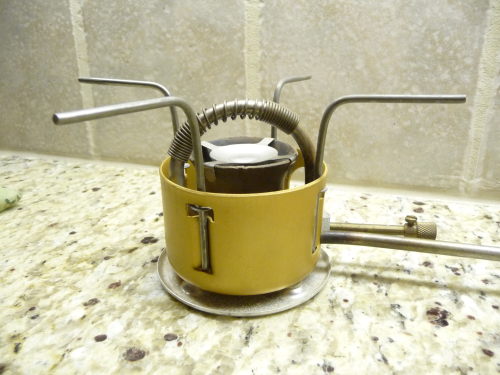

    Here is the whole banana yellow MSR XGK. There are some interesting aspects to this stove:
    • The first thing is that it is yellow along with the pump.
    • There's that coil spring around the generator tube over the burner.
    • Built-in flint starter.

    Doc, I posted pictures of the tag that was on the pump. Mostly safety stuff.

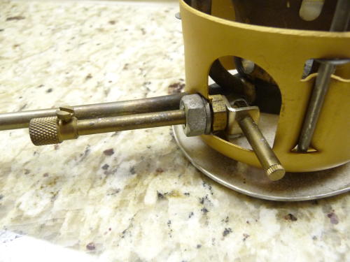

    Well, here it is. It's got that yellow body to it. The coil spring around the generator tube is interesting. I suppose it's for extra heat for the fuels that need it, like paraffin.
    There's that flint starter that actually came with the stove.
    Ok Doc, here's that tag on one side...
    Here's the other side....

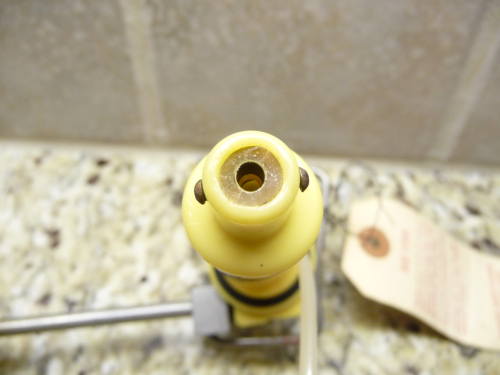

    Here's the end of the pump. Looks like something broke off. It pumps and holds pressure in the bottle. Any danger without the tube inserted there?

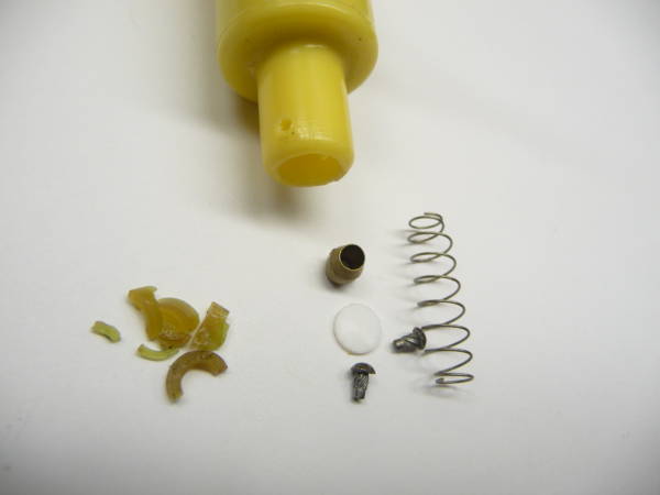

    I got to messing around with the pump and figured I probably have a faulty pump. I managed to pull the studs that hold the air intake tube inside the end of the pump. The pictures shows what popped out when the second stud came out.
    It looks like I could insert a new tube with the right dimensions and pop everything back in and it would work. Finding a compatible tube may prove problematic since it has to fit inside the end of the pump and fit with the brass lock collar on the inside of it. I guess it will be worth searching for a tube unless someone knows of a source and what the dimensions of this tube ought to be. Anyone?

    You can see the broken off remains of the air supply tube inside the pump's body. Typical for whatever reason. Did you pull the cable out of the fuel line to check it? Are there any letters or numbers imprinted on the aluminum block at the end of the fuel line (where the fuel line inserts into the pump)?

    Doc will know what kind of tube you need. At least one of my yellow pumps has the same issue as yours. The material that MSR used on the air supply tube seems to grow brittle with time and break off, at least on the light colored air supply tubes. The darker air supply tubes I've seen on some other yellow MSR pumps seem to hold up better.
    They will work with the tube broken off. However, now that you've removed the spring and the little disk, I don't believe the pump will work. IIRC, you do NOT want to lose that little disk.

    Two numbers on the aluminum block: 022 and 883
    Any significance?
    sam

    "Two numbers on the aluminum block: 022 and 883"
    March of 1988 I think... sounds right. Doc knows more about dating codes. I am still trying to figure out Primus some days. :lol:

    Sam, DO NOT LOSE THAT LITTLE DISK, whatever you do!!!! If you do, you are screwed, period!! That little guy is made of teflon, and is irreplaceable!! :shock: :shock: ](*,) ](*,)
    I use 1/4" OD polyethyene clear tubing that has a 1/8" ID. I buy it at Ace Hardware, and it does not seem to break down in fuel, or at least, not so far. It is supple, and seems like it will last a good bit longer than the original brown tubing. However, the fly in the ointment is that the holes you will need to punch through the tubing, so that the pins have a place to go to hold it in place, need to be done with a very specialized punch. I will post a photo of it when I get back from this current gig. Sweet Bride had one, and so far, I've used it with 100% success on the air tubes I've rebuilt, have worked like champs, using that special punch. I'd never seen one of these before I got hold of Sweet Bride's. The only problem that I foresee "possibly" happening, with the tubing I use, because it is softer than the original MSR stuff, is that you might rip it past the pins, if you're not careful in handling it. So far, that's not been a problem, but, in thinking about it, I can see how it "might" be, someday. If so, it's easily fixed.
