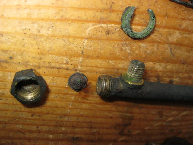

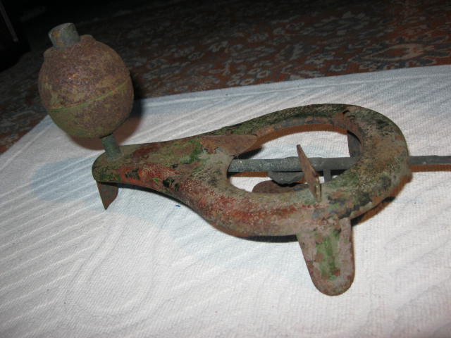

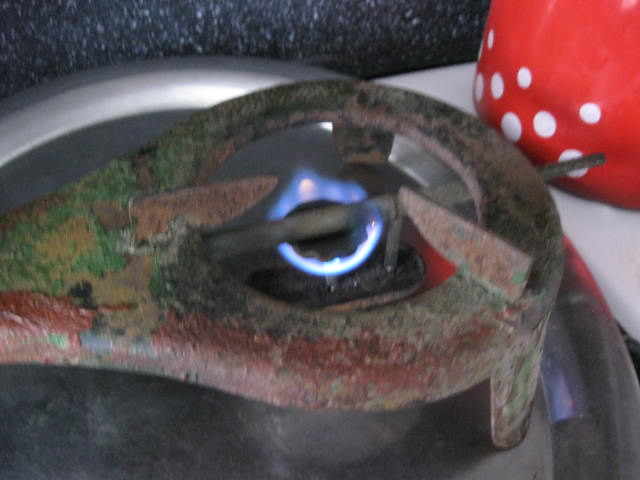

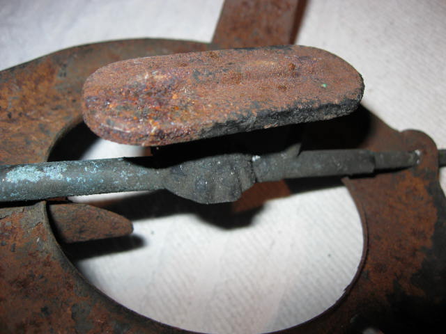

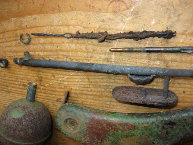

    with rose flamm spreader.Find in the Czech rep.
    Pre Pragus/Meva alc.stove type 444 / 555 ?
    Built way is very simmilar to them.
    Tank tread M7 ,reg.spindle M5 , wick lid G1/8" ,also very "modern" treads.
    Hidden wick lid - also before finding hole in the foot.
    Very old stove - or not so old ???
    D.

    These alcohol stove can really take a beating and keep running. I'm impressed. This is the first one I've seen that has a single jet with a flame spreader above. Most have several jets. Still it looks like a good design judging by the flame it produces.

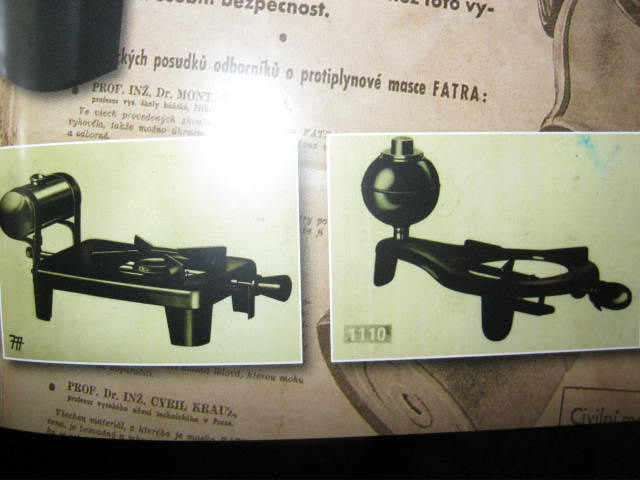

    Now is clear , it's Meva No. 1110 .Other stove by side is No. 777 .
    Boath pre war with wooden reg. knob.
    I think,pre ware with wooden knob are Pragus.
    After war , with bakellite reg.wheel only MEVA .
    Shortly after war are some stoves body with " Pragus " deccalt and with " MEVA " bakellite reg.wheel marked.
    D.
    From MEVA almanach

    Dusan - You know better
    - but Tank was like lemon or F1 grenade...
    on the photo was "normal ballon"

    Tank is realy magnetic and heavy , 50 g .Bras is only tube and lid.
    But my tank is more "balloon" as "eg" and only one side flat.
    Must be after first war .
