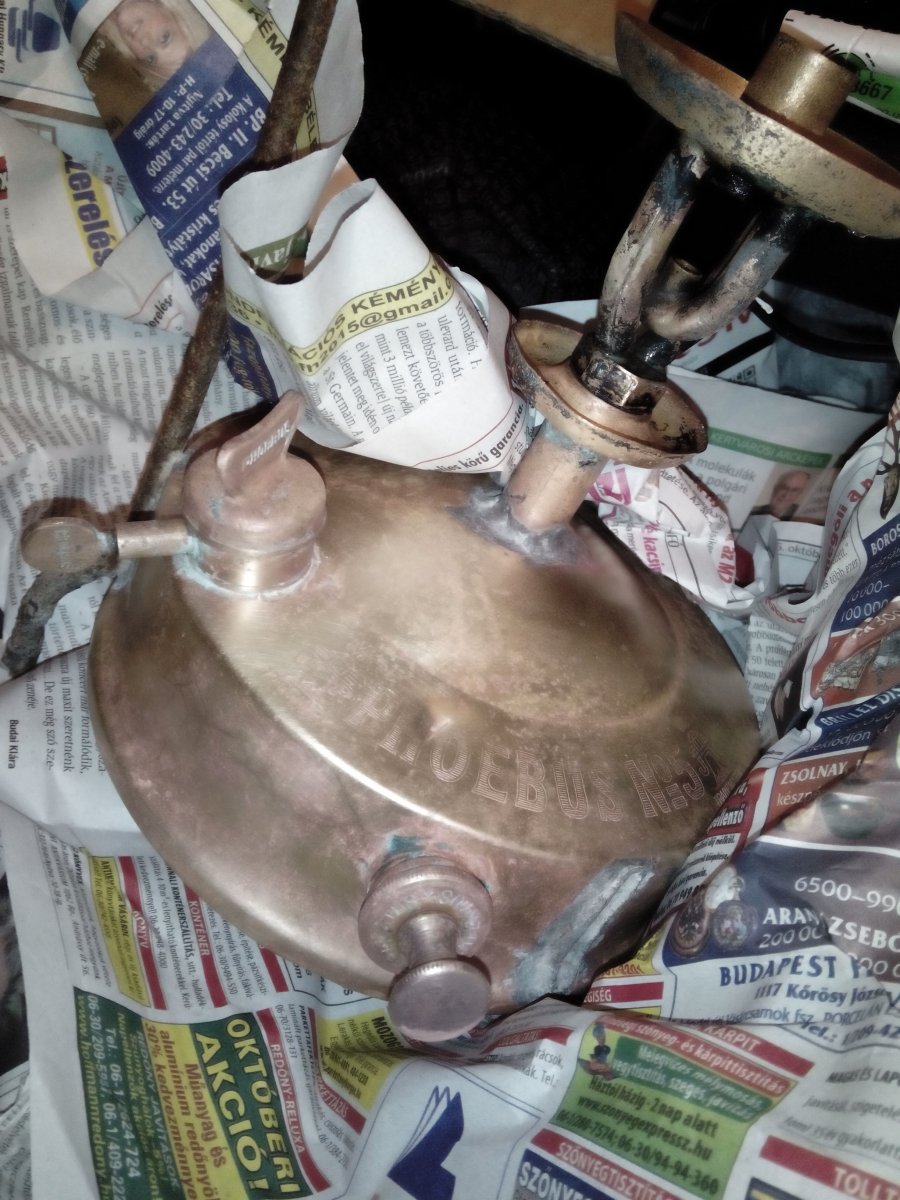

    I found this stove in my grandmother's house: Phoebus No. 5 MJR
    It was not in working condition, so I ordered missing parts from fettlebox: inner + outer cap and nipple.
    Replaced pump-leather, and tried to open the burner screw but it is stucked.

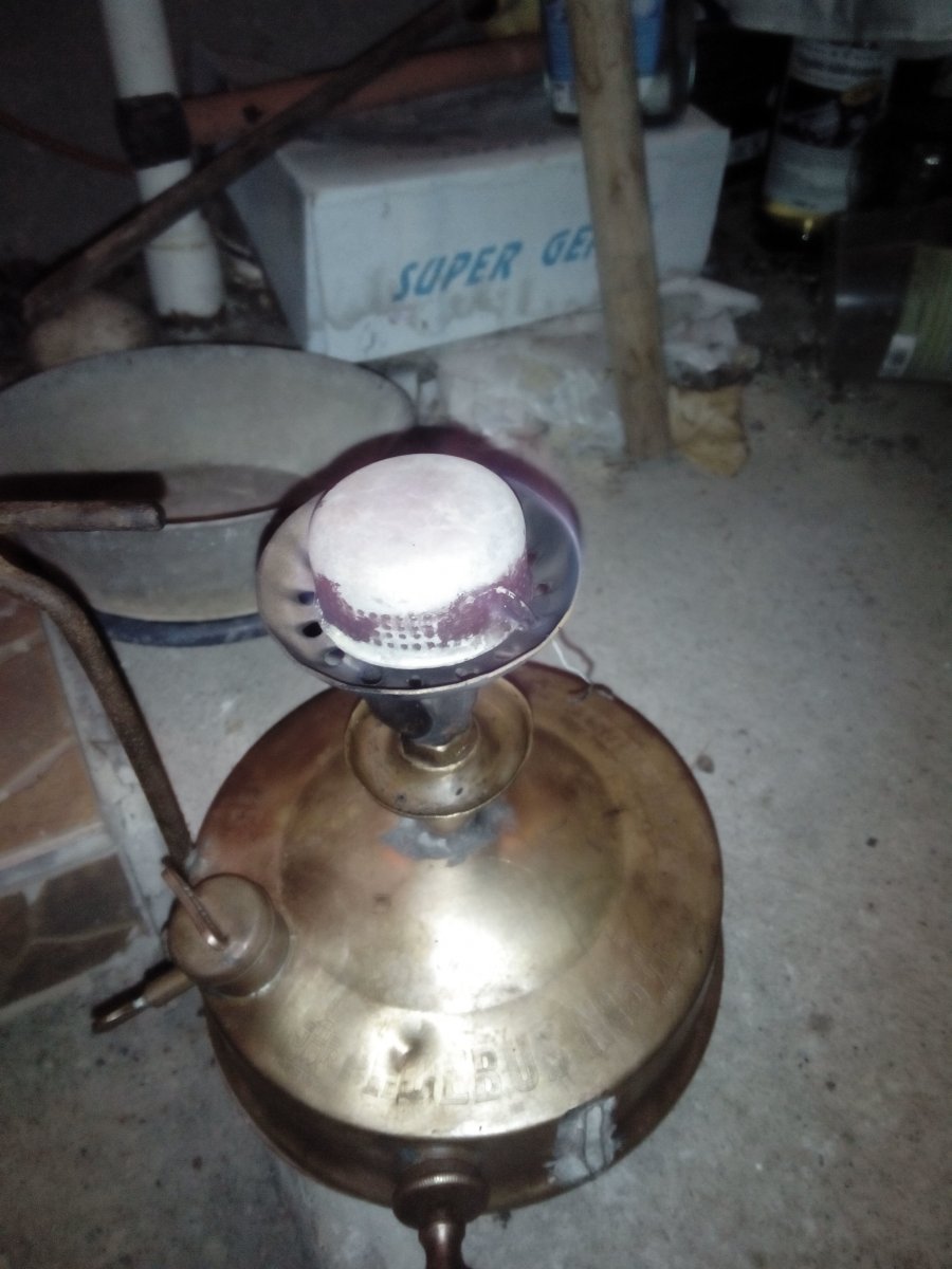

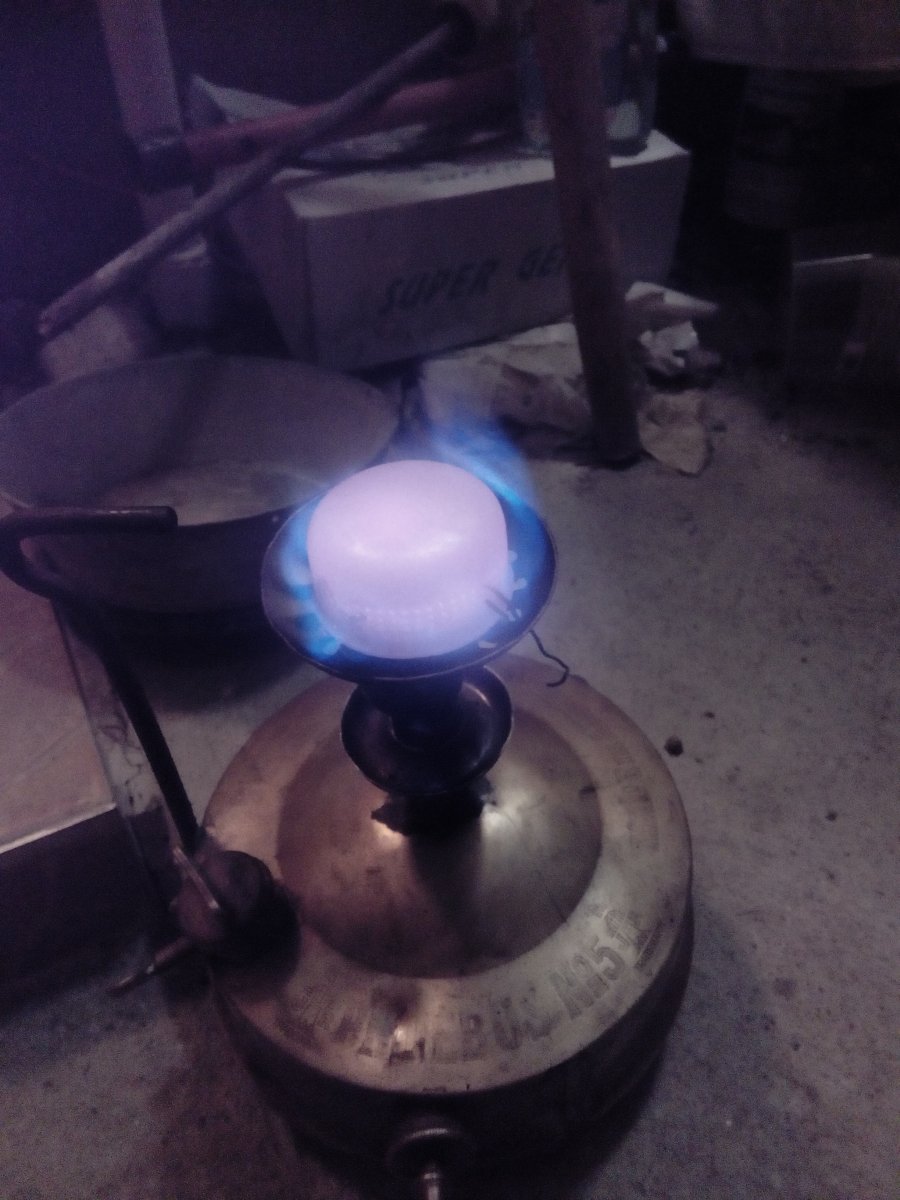

    There was no leak on the tank and intensive pumping can pressurize the hole system. Today I found some fuel and want to start it. After a few tries it has enough pressure to keep continuous burning.
    Nice to see the stove is still working!

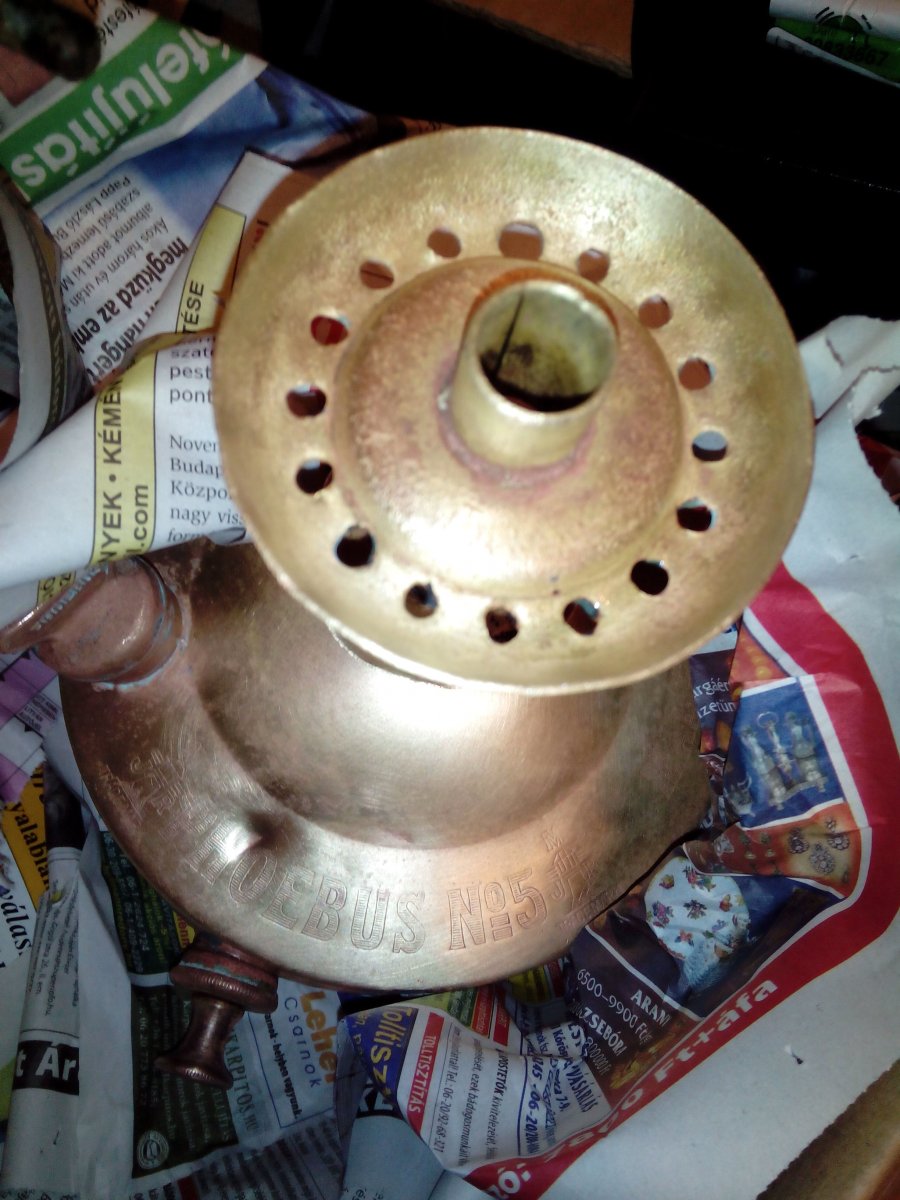

    (Small wire only holds outer cap. Do not want to loose it. :-))

    Thanks! If understand you right, something is wrong with my nipple? It is a brand new item, but I have no tool to tighten it. (used a small pliers)
  4. Tony Press
    2,337
    @attb2
    There are many causes of underburn. Sometimes it's a matter of swapping a few inner and outer caps around until you get it right. Sometimes your outer cap isn't sitting flush on the burner and needs to be 'polished' on a sharpening stone.
    Looking at the photos, though, the outer cap looks crooked. Is it sitting flat on the burner?

    Thanks Tony! I did not realize the outer cap position!
