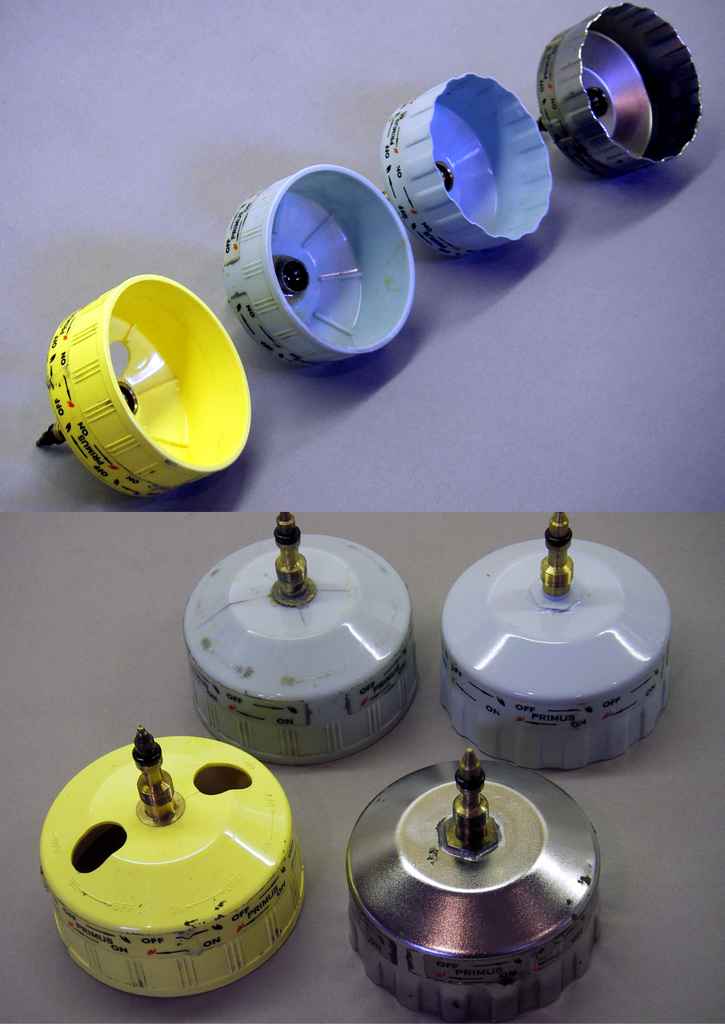

    Curiosity got the better of me and I've put together a collection of Primus Grasshopper stoves that demonstrate what I've identified as the four main variations produced during its production life
    Left to right they are: yellow/orange colour scheme, plastic control collar; pale green colour scheme, plastic control collar; pale green colour scheme, painted metal control collar; pale green stove frame, lacquered steel control collar
    There's no date code on stove or box but I'm confident this is the earliest version, since it's mint and was packaged together with a contemporary gas cartridge which had a price sticker on it that was in pre-decimal currency (UK), so purchased before February 1971. (More on this example here: Unwanted Christmas present )
    I know the type below was marketed no later than 1973, since it's clearly the version that appears in the 1975 reprint of the 1973 issue of 'Stoves for mountaineering' here in CCS's Stove Reference Library (Ninth image in this set)
    The control collars provide the main distinguishing feature between the different versions
    The plastic collars have a flaw - they develop cracks and the only other one I've seen had the type of repair a previous owner gave the green one here
    Primus (Bahco earliest version, Primus-Sievert later) must have got themselves pretty confused when delving into their stock bins to assemble individual stoves, as this sticker suggests in referring to a metal control collar when it's got a plastic one

    Detail on the early/later gas cartridges
    Back to the green colour scheme, plastic control collar version, it has an assembly clip that sets it apart from the other versions
    Clip on other versions top, that on the green plastic control collar type below
    What that photo shows is how the heftier gauge clip projects from both sides into the control spindle cavity. Its those two projections that prevent the control spindle from screwing right out
    On the green plastic control collar version with the slenderer gauge assembly clip, the clip doesn't stop the spindle from unscrewing too far and it's left to this rather primitive arrangement of a screw butting up against the control collar, which probably contributed to those cracks developing in the component
    Curiously, on two of the other variations (yellow/orange colour scheme and laquered metal control collar) the assembly clip provides the spindle stop but the stove frame's equipped with a stop screw in the stove frame too. Only the earliest version doesn't have that stop screw in the stove frame

    Hello and welcome to CCS! Your comment makes me realise I didn't describe the operating principle clear in my write-up, but as you've said (rotating the butane tank to regulate the flame) that's how all of those Grasshoppers pictured work.

    The screw fitting thread's the same, but unless the gas cart is this shape ...
    ... it won't fit inside the regulator sleeve, this component ...
  18. hikin_jim

  20. presscall
    13,057
    Not turning the gas canister (but the regulator sleeve) is the safety advice in the stove instruction sheet. True for the screw fitting canisters and for the bayonet ones with adaptor too.
