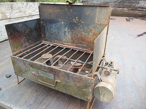

    I have used this one a lot over the years. Funky pump on it.

    i have just like that and also apart for some repair.i bet a drop of oil on the pump leather and you will be cooking cheese brats in no time!

    She cooks great! I made a mistake though, as it says 8B on the tag I think. Tag is rough shape. I dont know how to edit that. Someone must have had a bacon fire? lol.

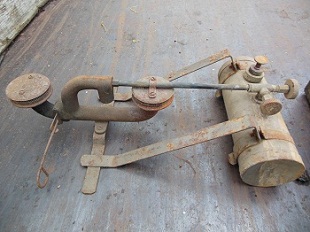

  4. DAVE GIBSON United States
    Aug 6, 2004
    4,054
    Minneapolis Minnestota USA

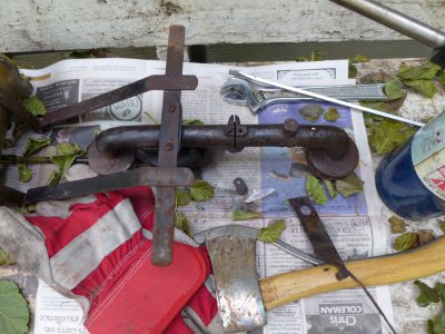

    thats the guts out of mine.they got a soak in WD40 spray oil and some tapping with that ax to free up some rusty parts.
    it all looks good so far except the small burner jets are rusted away in places.

    Lol. You gotta have the right tool for the job... A hacksaw works well for cleaning that slot for the second burner control. I just got the Cheese Brat thing. lol. Notice I used capitol letters... Post pics of the initial fire please.
