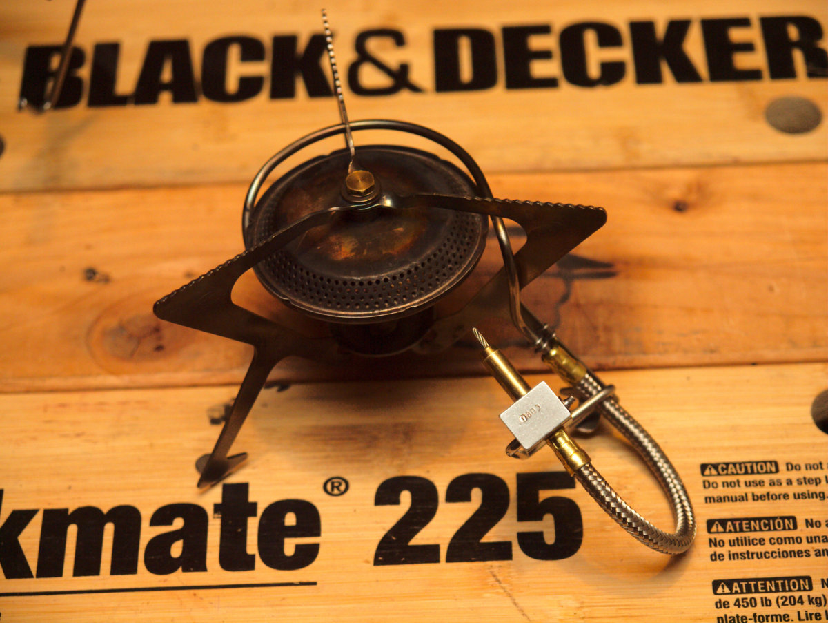

    What did you use to clean the stove with? I just bought one today at a yard sale for 5 dollars, and it is covered in soot. I want to take it down like you did and clean it up. Do you have any tips for me?

    " Do you have any tips for me?" Yep , don't waste your time cleaning it, these soot up quickly, especially when you are new to using them.

    I cleaned my whisperlite by taking it apart and giving it a 20 minutes soak in citric acid, then a good scrub with a toothbrush and dish detergent. Works like magic.
    Remember to install the legs in the right order. Each one is different.

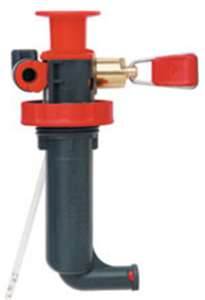

    Talked to MSR & they will do a "complete overhaul" on my Whisperlight International for $25 & will trade out my gray/black pump for current model pump for an additional $10.00. I was going to send it off but am reading many poor reviews of current red/black pump. Perhaps I should overhaul the stove & pump myself. Is this advisable for a newbe on such an old(pre-shaker)stove.

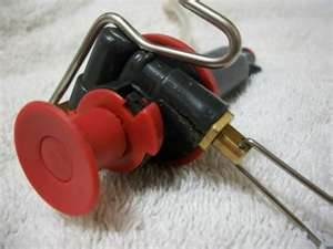

    Hi Steve, It is not the new pump you are reading about in the reviews, it is the one prior to the latest model. The previous pump was terrible, the new one is a good pump,
    Good pump
    Bad pump

    That's a critical bit of info! Thank you yellowdog.
    May be worth sending it off for overhaul & upgrade after all.

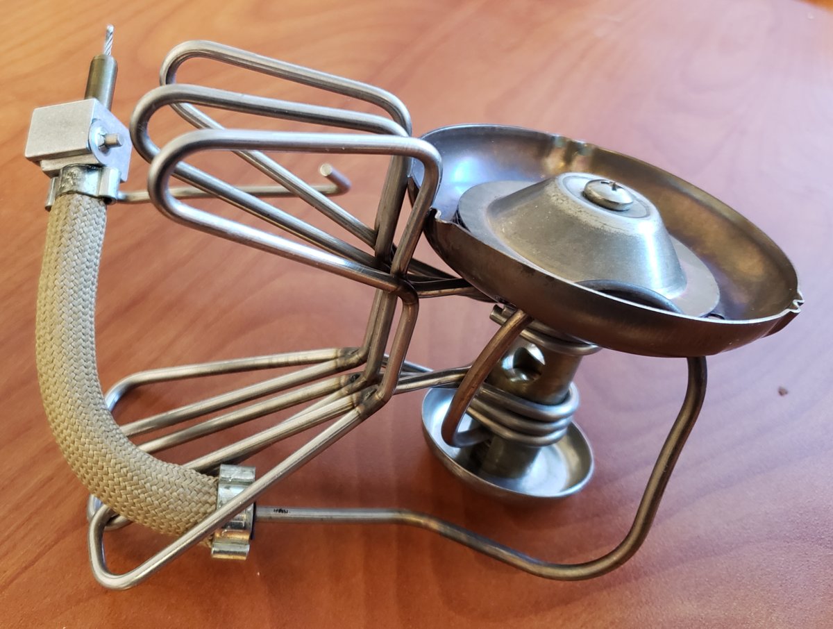

    Paul smacked the nail right on the head, Folks. I "hate" the original WPLI, as it failed on us, priming with and burning kerosene, because MSR told me it would work like a champ. Unfortunately, the generator loop was just too small, and the stove gave up the ghost in less than 200 miles! I've bad-mouthed it ever since, mainly because I was taking stellar care of it, and doing maintenance way above and beyond what should be needed for such a stove, and it STILL failed!
    I have also bought and used the replacement WPLI, which sports a larger generator, as has been noted, and a better fuel line, with braided brass cover, and found that it works MUCH better! As has been stated in this report, it still doesn't simmer, and therefore it's only a "One Note Johnny" of a stove, but it certainly does not fail like it's predecessor did.
    Now owning the WPL Universal, and am happy to report that it beats the Internationale, hands down, in every category that is important to me! So, I'll very probably not use the WPLI again, in the field, but would definitely recommend it to those that like to use kero, but don't like to use a roarer burner stove, IF they have no need to buy the more expensive Universal, which is really a better stove, IMHO.

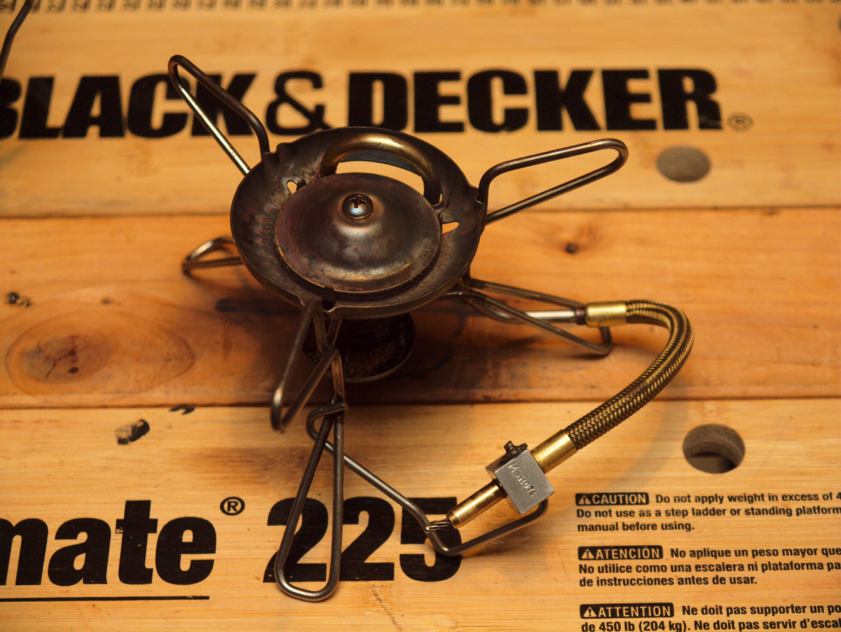

    Sam, I too have the same stove and use it often - mostly fueled with kerosene. I prefer to pre-heat the stove using alcohol. The trick I have found to cleaning the soot off the stove is to do it while the stove is still very hot like right after you shut it off. I carry a small brass brush that looks like a large tooth brush for this purpose. The brass wire is quite fine but it peels the soot off the stove like taking the skin off an onion and a quick wipe with a cotton rag afterwards is all that is needed. If you don't have a brass brush just use that same cotton cloth but make sure the stove is still really hot! To the point where it will burn the rag if left in contact with the stove. Do not use synthetics or nylon rags for this......they melt to the stove!!! Good Luck
