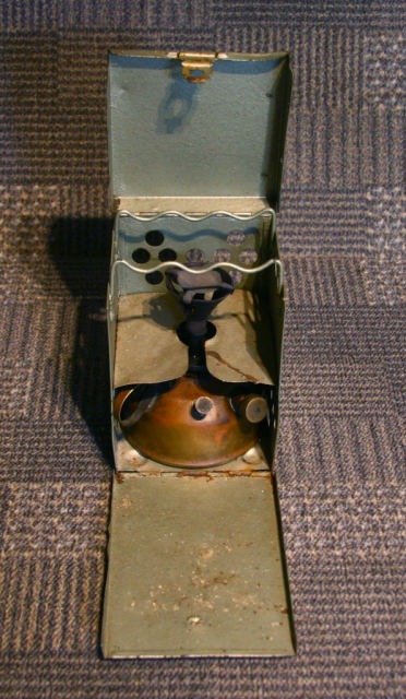

    Unfortunately the case has been painted at some time in the distant past so there is no decoration or labels. The stove is complete except for the travel cap. The cap from a Lamb fits, so I can use one of those when I take it out on walks. BTW, if anyone picks one of these up without it's case, it does not fit in a British Army No7 case.

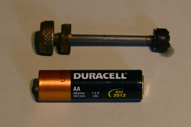

    Overall the stove is in very good condition with no damage or dents. I made a new viton seal for the filler cap and had to make a new tiny 11mm pump leather. I don't have a small enough removal tool for the NRV, but luckily it is working fine. In fact, the stove happily self pressurises with no need to pump. The pump next to an AA battery gives an idea of it's size:

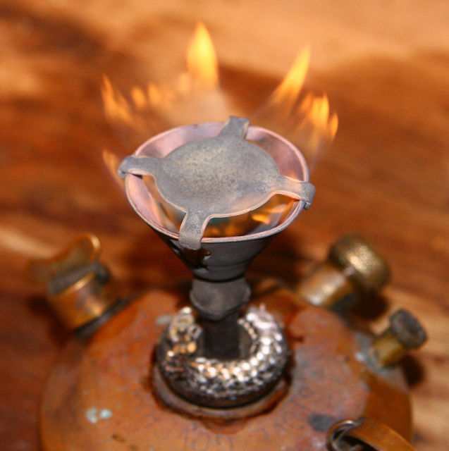

    Firing the stove for the first time, I had a mass of yellow flame which did not settle down after multiple pre-heats:
    On checking the jet I found the hole was very oversize. I checked my box of odd jets and nothing matched. I wondered if I could peen the jet a little and then remembered a box of old blow lamps (torches) I picked up at a car boot sale. I don't collect blow lamps but they are often made by stove manufacturers such as Primus, Optimus, Monitor etc, and can be a useful source of cheap spare parts for stoves. The jet on a Radius 52 looked similar so I swopped it into the stove and it was a perfect fit. Unfortunately, it too was oversized ](*,) . A little squeezing in the vice and it was better though the hole was now a slight oval but the flame, although not perfect, was much better. It'll do until I can acquire a decent jet:

    What you say about the stove self-pressurising is consistent with the one I have, which I think is responsible for overfuelling, even when the jet size is theoretically 'ideal' and not worn. I was able to construct a jet ( my Governor paraffin stove ) so chose a jet orifice that surely isn't oversize. It fuels nicely on start-up but overfuels when the self-pressurising kicks in within a minute or two.

    Hi Terry what a brilliant score, it is not often we see a baby paraffin Lamb stove.
    It just goes to show how small the lamb is, by the pump rod assembly up against a AAA battery.
    Being such a small stove, with a smaller burner basket compared to a 96 type, the jet orifice would be smaller than the standard 0.23 of a 96 type stove with lipstick burner, and would imagine very hard to find a replacement.
    I have a mini Bladon petrol blowlamp I restored while back, and the jet orifice on that was smaller than any pricker I had, I would imagine the orifice on the lamb would be similar
