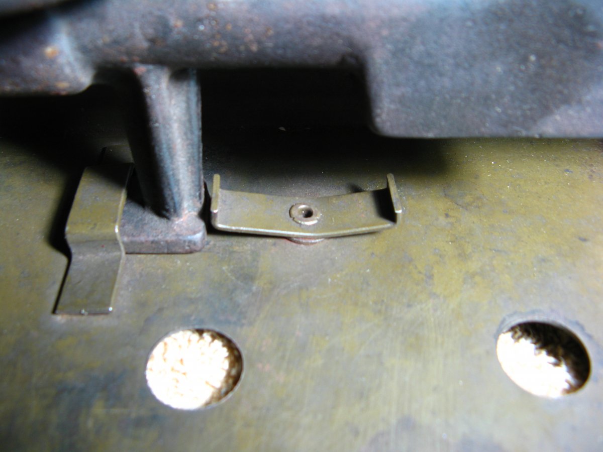

    This stove has a nice, secure way to keep the burner assembly and the tank assembly from moving around during storage/travel. You can see in the photos below the swivel locking mechanism for the burner assembly. There is also a 'collar' for the generator, with the tank assembly turned 'Up Side Down', that then uses the grill to hold the assembly into the collar when the box is 'locked'.
    When in use the generator is 'locked' into the manifold with a threaded collar that cannot fall off of the generator tube.

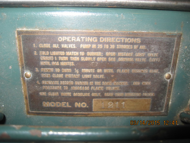

    Hi Ken, your Turner is different than mine. Here are some pictures for you
    here is a picture of mine
    regards Jan
