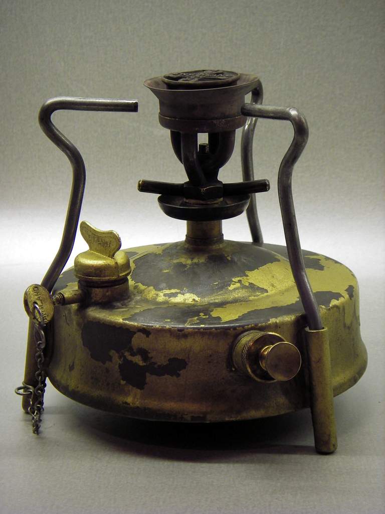

    Odd one this with some unusual features. The fuel tank is steel and the camouflage effect is unintentional, the gold paint having largely flaked off, revealing an olive drab finish beneath
    Unlike a conventional collapsible stove, the pot rest supports obviously can't be used without the pot rest
    The pot rest was missing one of the support mounting lugs ...
    ... so I'd to make one out of strip steel and braze it in place

    The burner has a built-in tommy bar to enable it to be fitted and unscrewed from the burner riser tube without the use of a spanner (wrench). I replaced the heat-proof washers

    Assembly of the pot rest has to be in this sequence, so no fitting the pot rest supports to the fuel tank first
    The pot rest, in painted, pressed steel, is an obvious legacy from Twigg's 'Buflam' line of wick stoves
    No sense in fixing a securing chain to the air screw!!!. It would be understandable if the keeper cap (which the stove has) was attached to the chain, but there's no obvious way of attaching the keeper cap to the chain ...
    The steel tank is perfectly sound, with no rust. Note the fact that the leg tubes to take the pot rest supports have stopped and rounded ends - a refinement that prevents bringing home soil samples, though I'd be surprised if that was the intention
    I've seen this pattern of non-return valve before, with the seal cup 'tail'. The cork seal was discarded in favour of a nitrile 'pip'

    Military precision is required to pack the stove away. The tank has to be orientated just as illustrated or it won't fit in the box.
    It becomes clear why there's that large hole in the pot rest - fits over the filler cap when packed

    I'm assuming it's original to the stove, but this travelling/keeper cap wasn't well thought out. Although the burner has that useful tommy bar, a spanner (wrench) would have to be packed with the stove just to remove and replace the cap
    I'll keep the cap with the stove as a curiosity, but I'll be using this - made up from a short length of brass rod and a remnant from a junked silent burner - to use with the stove. Far more in keeping with the spanner-free concept
    Handy too for lifting out and lowering the stove into the box
    Next job is to sort out an arrangement to attach a longer chain from the stove leg to the cap in place of the existing chain affixed to the air screw.
