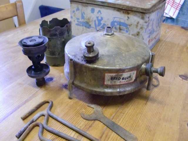

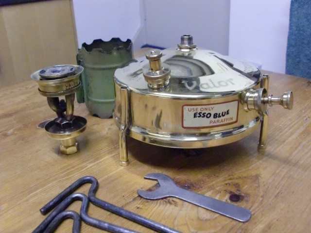

    This arrived, in a pretty filthy state, packed in a tin full of cobwebs (and powdered rust) but, after a few hours cleaning, I was pleasantly surprised to find that the fount did not have a single dent or ding. The flame ring, too, was minus the usual dents and chips so it looks like the stove was well cared for before it was retired.
    The small feet are non-standard but I added these to stop the rough tube ends from scratching surfaces as the stove will likely be used indoors on occasion.
    Out of the box.
    After a bit of spit and polish.

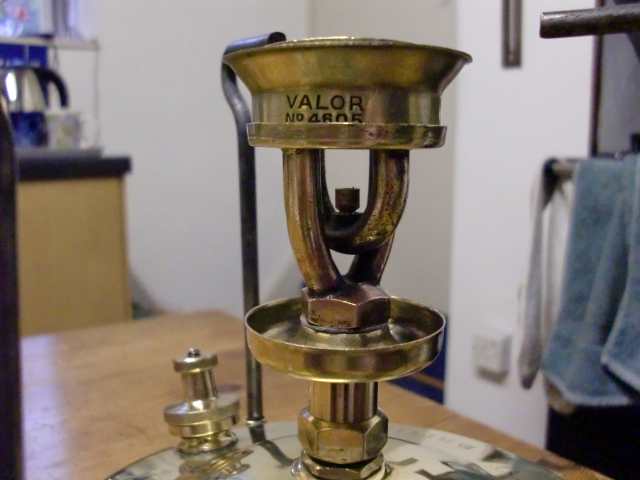

    Burner.

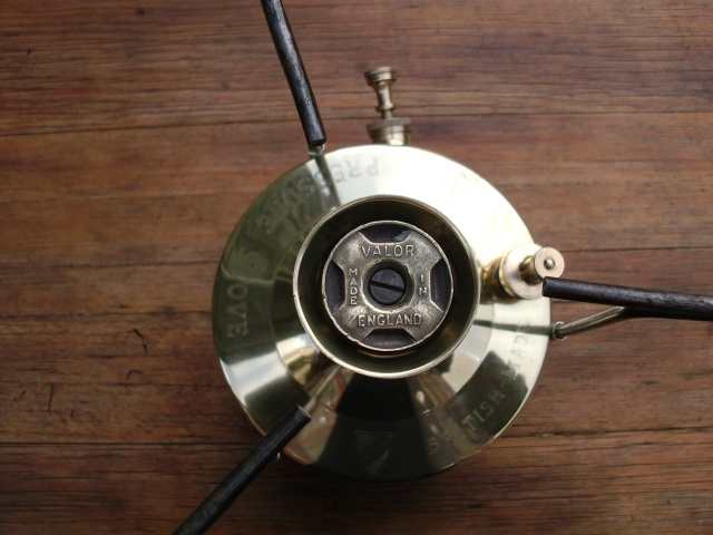

    "Made in England" and showing the removable screw which gives a straight access to the nipple.

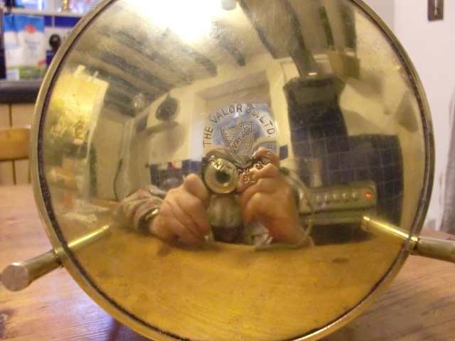

    I polished me bottom .... :whistle:

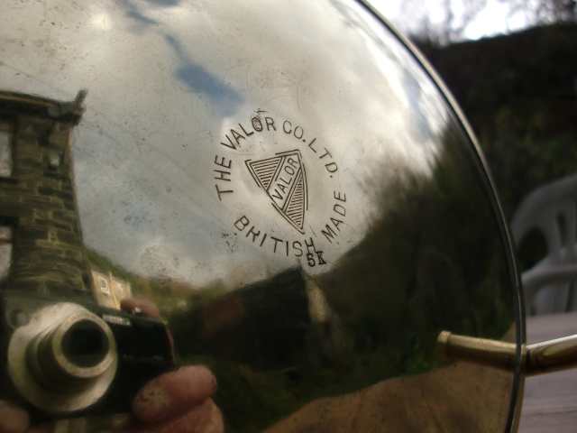

    Beneath the main Valor stamp you can see "5K". Could this be a date stamp?

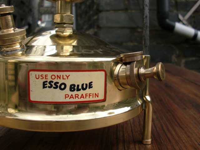

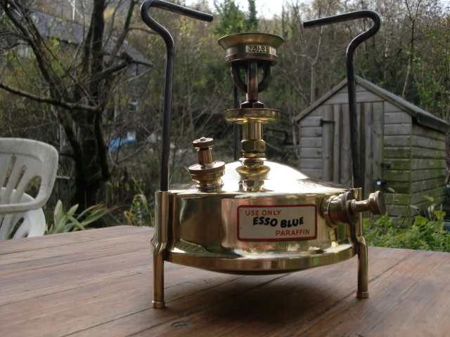

    Stove out in the wild, fully fettled - all seals and pips replaced.

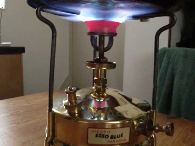

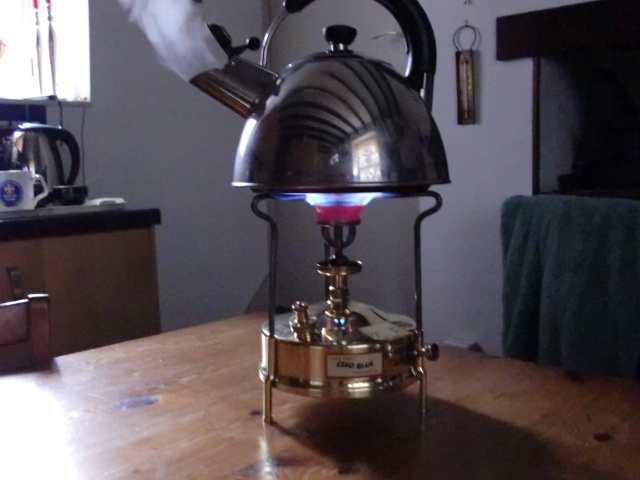

    Doin' what a stove oughta do.
    Powerful flames.

    The restoration was not too difficult apart from removing some very stubborn stains and old lacquer patches and having to make a new nipple removal tool.
    The nipple fitted was quite a bit narrower across the flats than usual but did not appear to have been modified, in fact it showed no burred edges or rounding and looked as though it had never been touched (it was a bugger to remove though as it was very, very tight).
    I would be interested to hear from other Packaway owners (or those who have other Valor models) if their stoves also carry a similar stamp to the "5K" on the base of mine.
    I have written to Valor to see if they can shed any light on this and will report back if I hear anything positive.

    Hi Dave, mine also has 5K on its bottom!

    Been thinking about this and if it's not a date stamp it could be a production model code.
    Be interesting to see what Valor say, if they reply.
    Dave.

    With you on that Rik, mine sits in the kitchen waiting for coffee duties, works everytime. Also looks like yours Davwal in the 'before' pics. Once I removed the green stuff that had accumulated on the underside it also has the 5k, will check the nice version if I can get to it. :whistle:

    Could you explain a little more detail what you did to the feet please. I see, I think, that you have inserted some brass rod into the ends of the pot stand tubes, but what, and how have you affixed them?
    Cheers.
    Rob
  15. Davwal
    Aug 21, 2010
    48
    Robtz
    For each foot I turned down a short section of brass rod to a tight interference fit in the tube and then turned the visible part of the foot to what I thought would be a suitable size. This was then parted off, finished to size and polished The feet were then tapped into the tubes using a hardwood drift. I had thoroughly cleaned the inside of the tubes so that I could take accurate measurements for the fit.

    Beautyfully done Dave,i like the feature on the burner with the removable screw,it makes changeing the jet/nipple so much easier useing a straight nipple key.
    And well done on keeping, the Esso blue decal on the stove, and it is not to easy to find one in perfect condition

    Very nice fettle. I have the same stove, but it has 10k stamped on the bottom, and is missing the tin.
