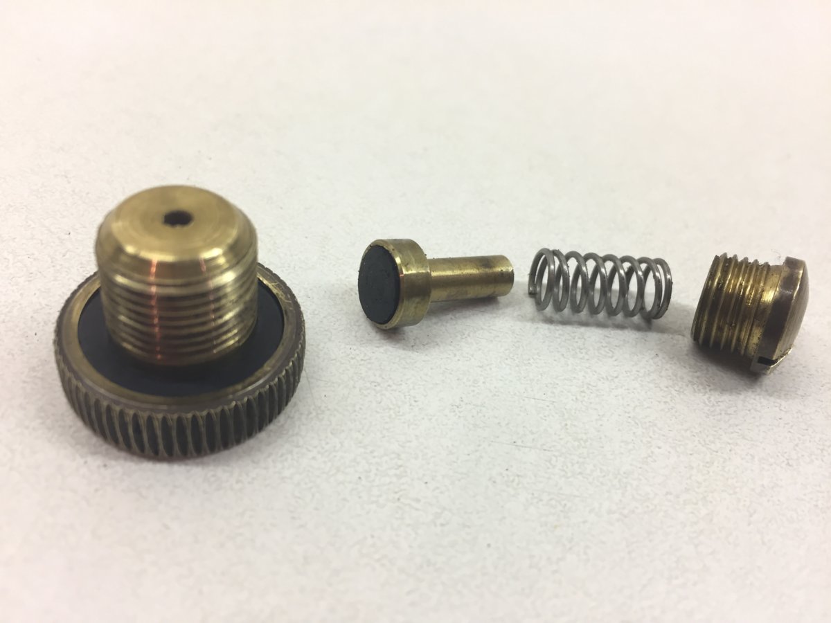

    Some minor fettling was required before I fuelled up and fired up the stove, the fuel filler cap seal was rock-hard and the cork 'pip' in the safety (pressure) release valve built into the fuel cap was suspect, so I replaced both seals with viton ones.

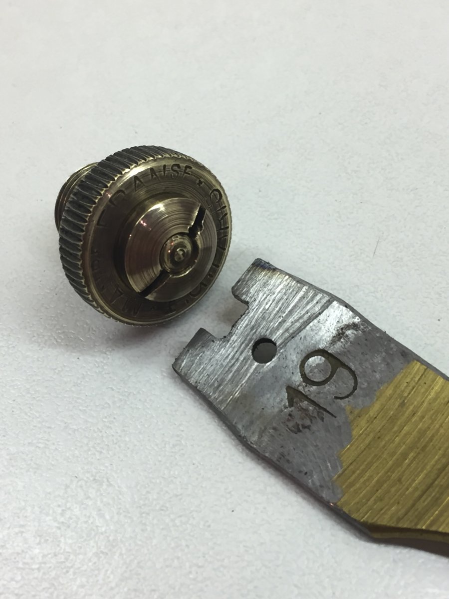

    The cork SRV 'pip'
    Replacements installed.

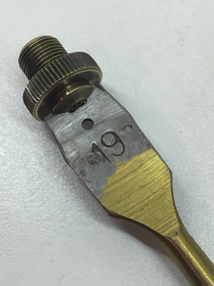

    Tool made from a spade drill to undo/tighten the SRV cap

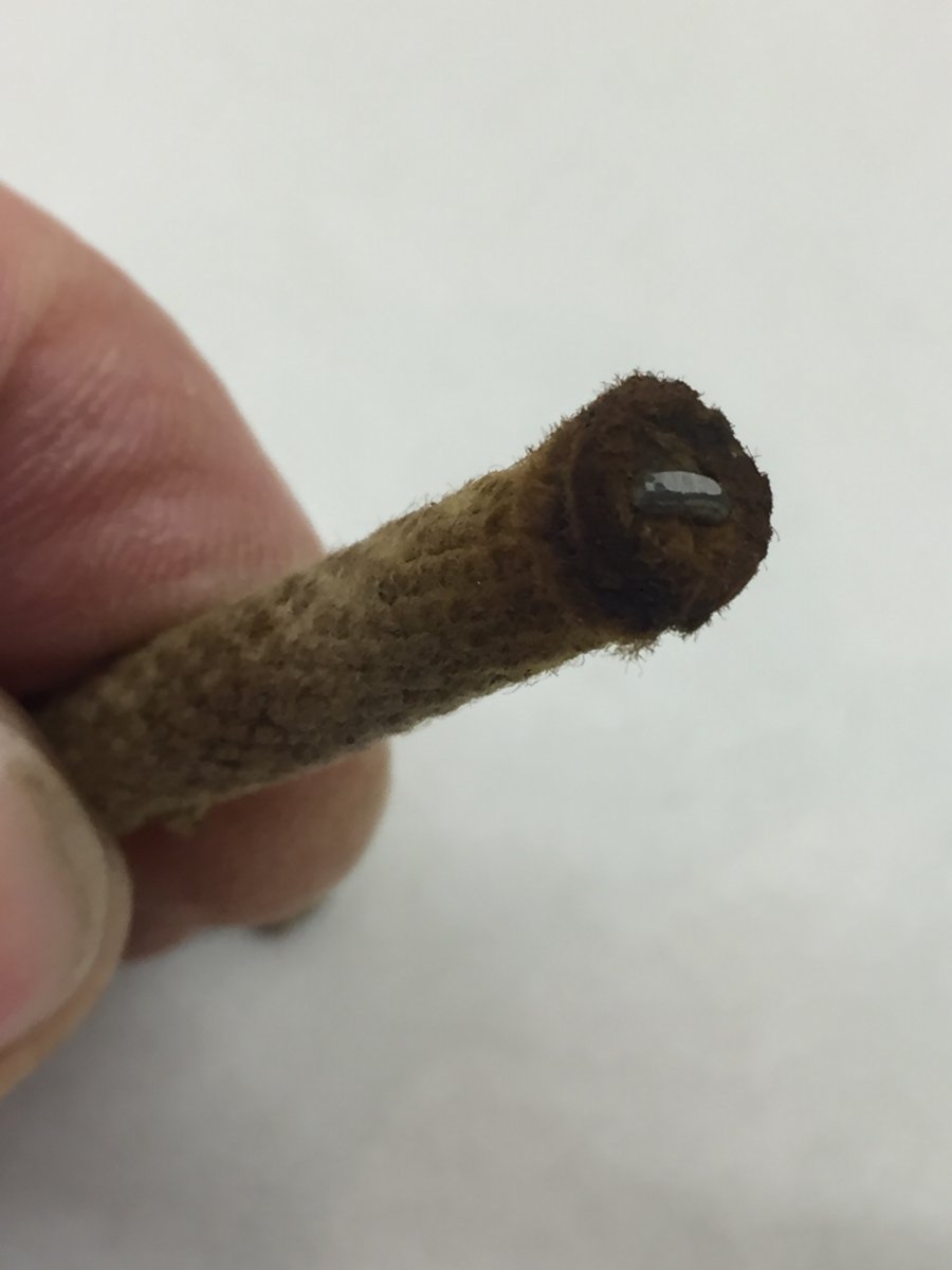

    I didn't pull the wick, deciding that with the fuel cap/SRV fully functioning that the stove was safe to fire up and were the wick in poor shape I'd soon find out with poor performance and a reluctance to prime (the woven cotton rope wick contains a brass wire core to transfer heat from the burner to the fuel).

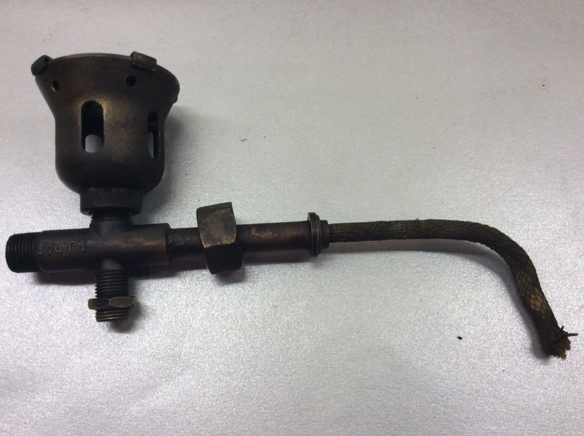

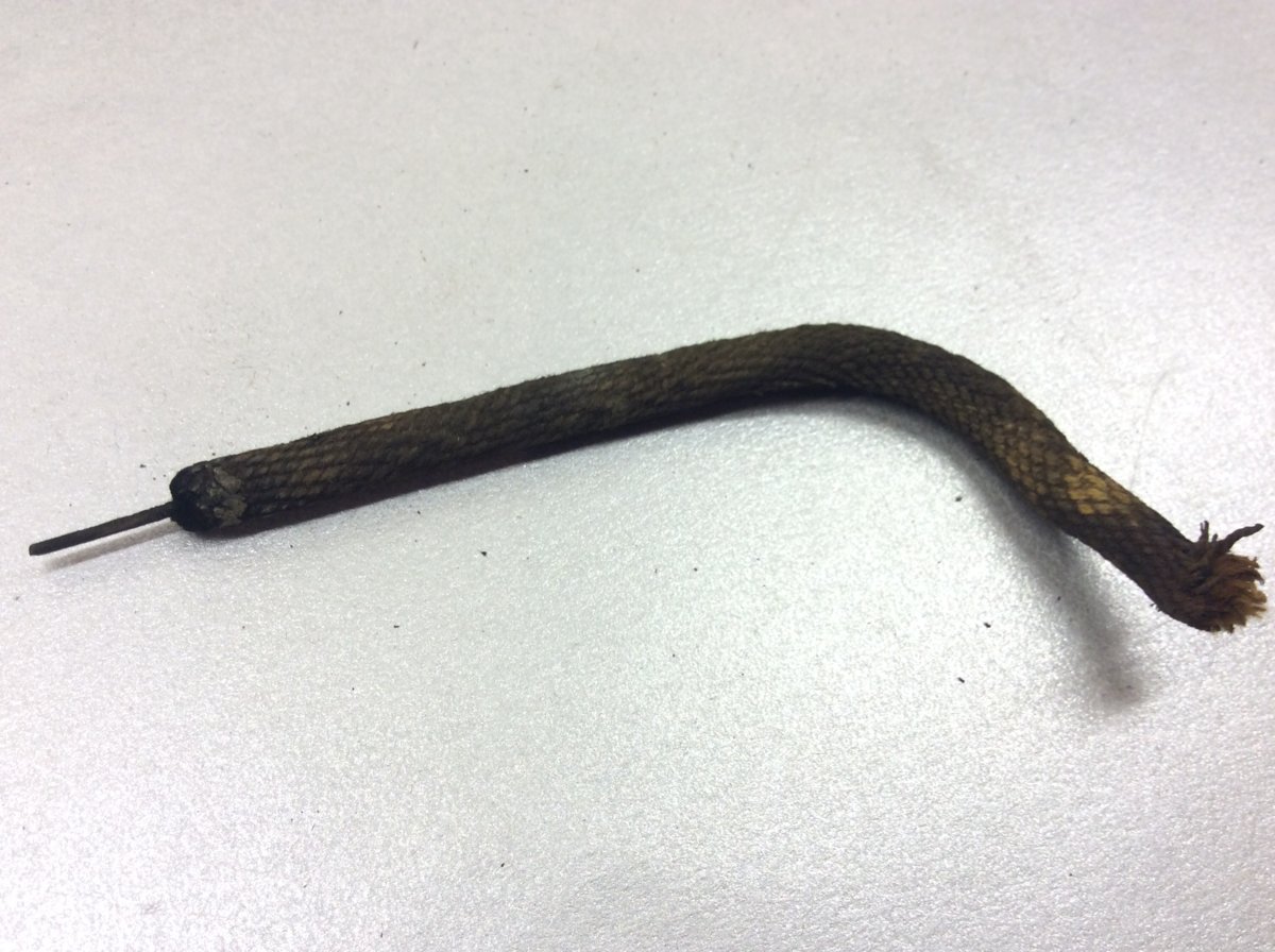

    Here's the wick - this example from a double-burner 303 Vesta I've yet to restore.
    ... and here's how it's installed in the burner, other end dunked in the fuel tank of course. As well as conducting heat from burner to fuel to initiate and maintain self-pressurisation, the downward curve of the wire core usefully diects the wick to the lowest point of the tank to scavenge fuel.

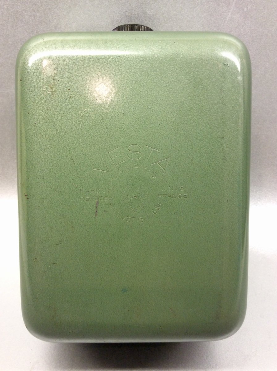

    The stove lid with model name and manufacturer's logo stamped in it.

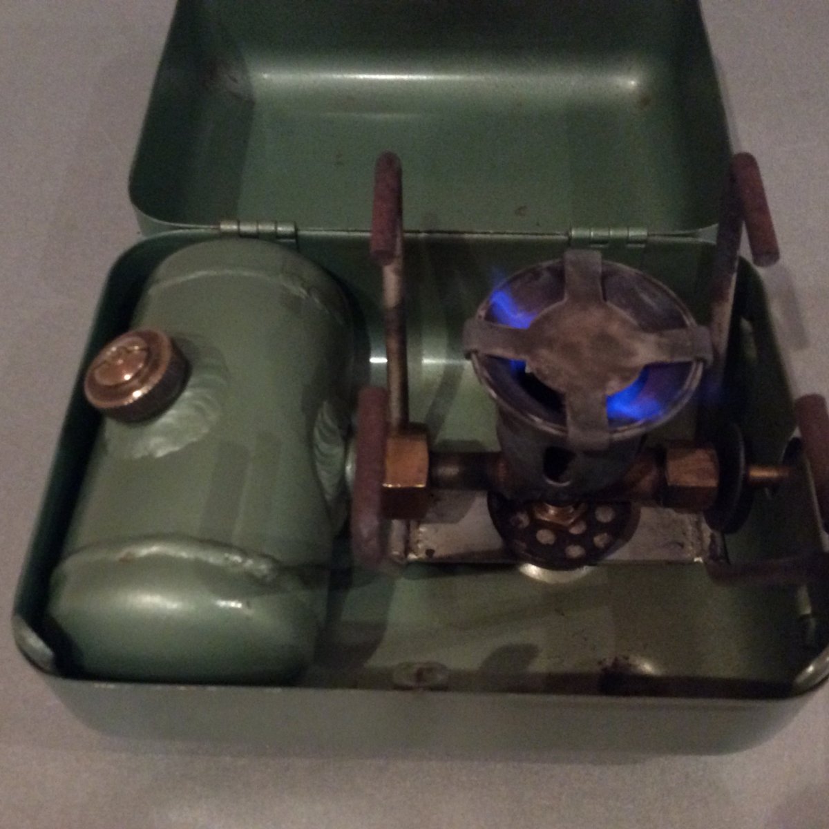

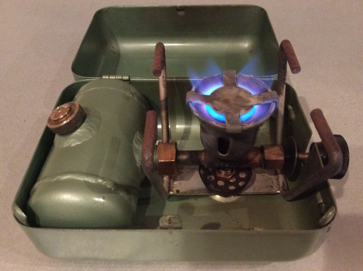

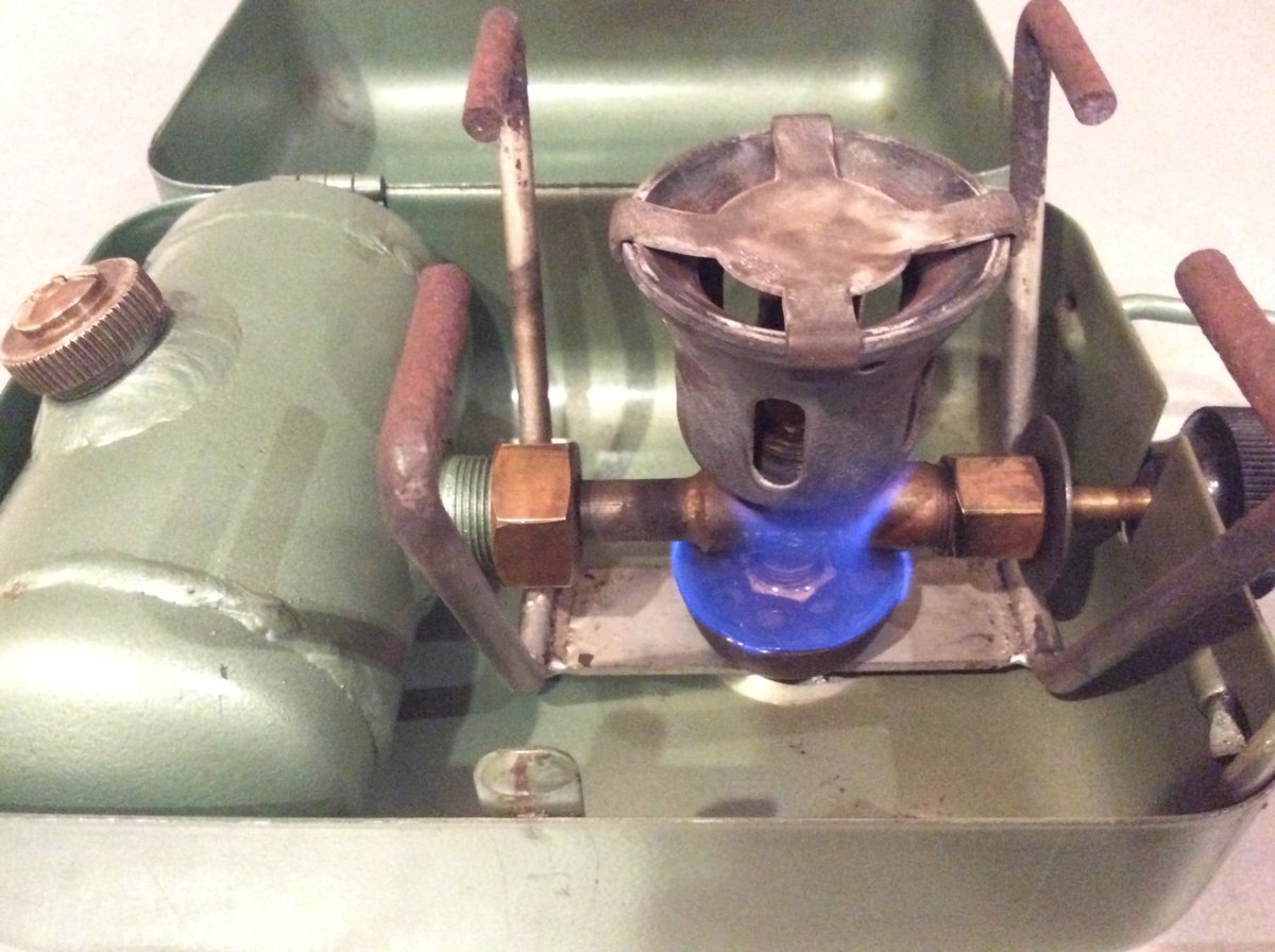

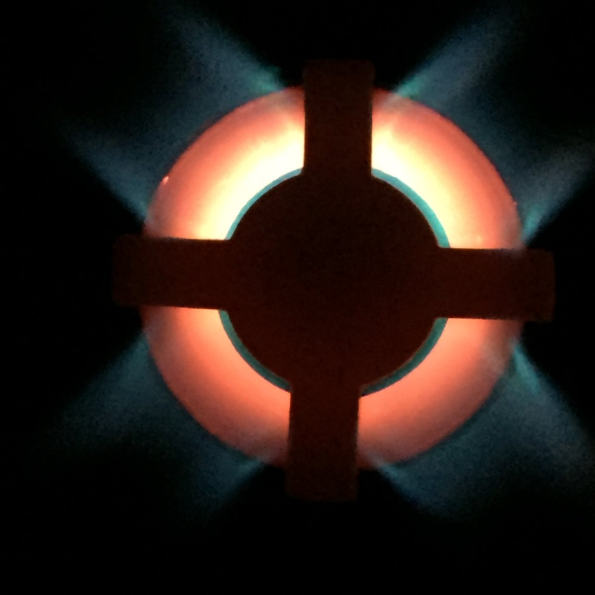

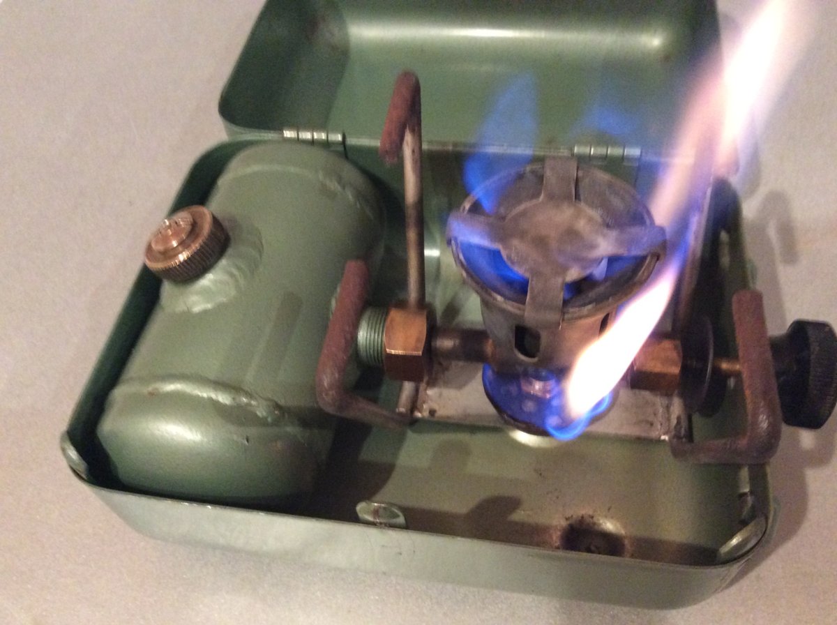

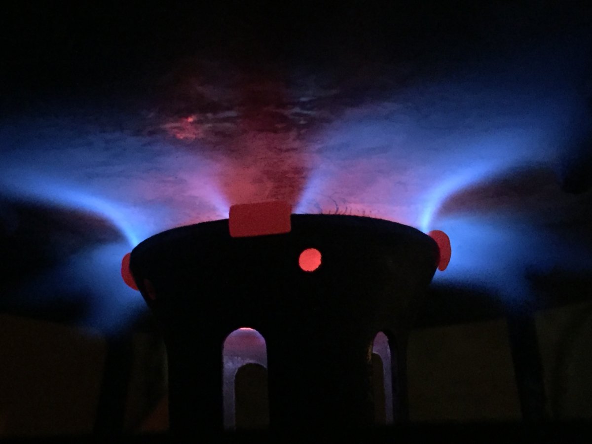

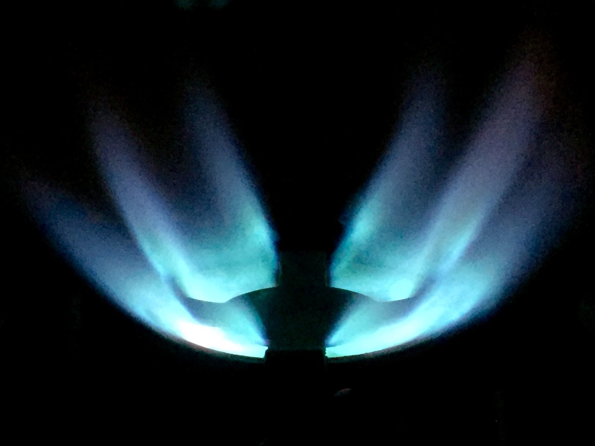

    Here I've opened up the regulator and the burner flame is beginning to develop.
    Gets going ...
    ... and intensifies.

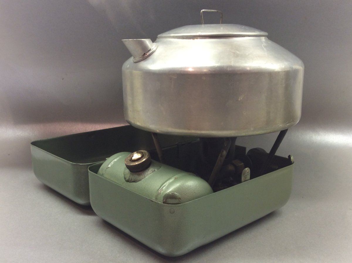

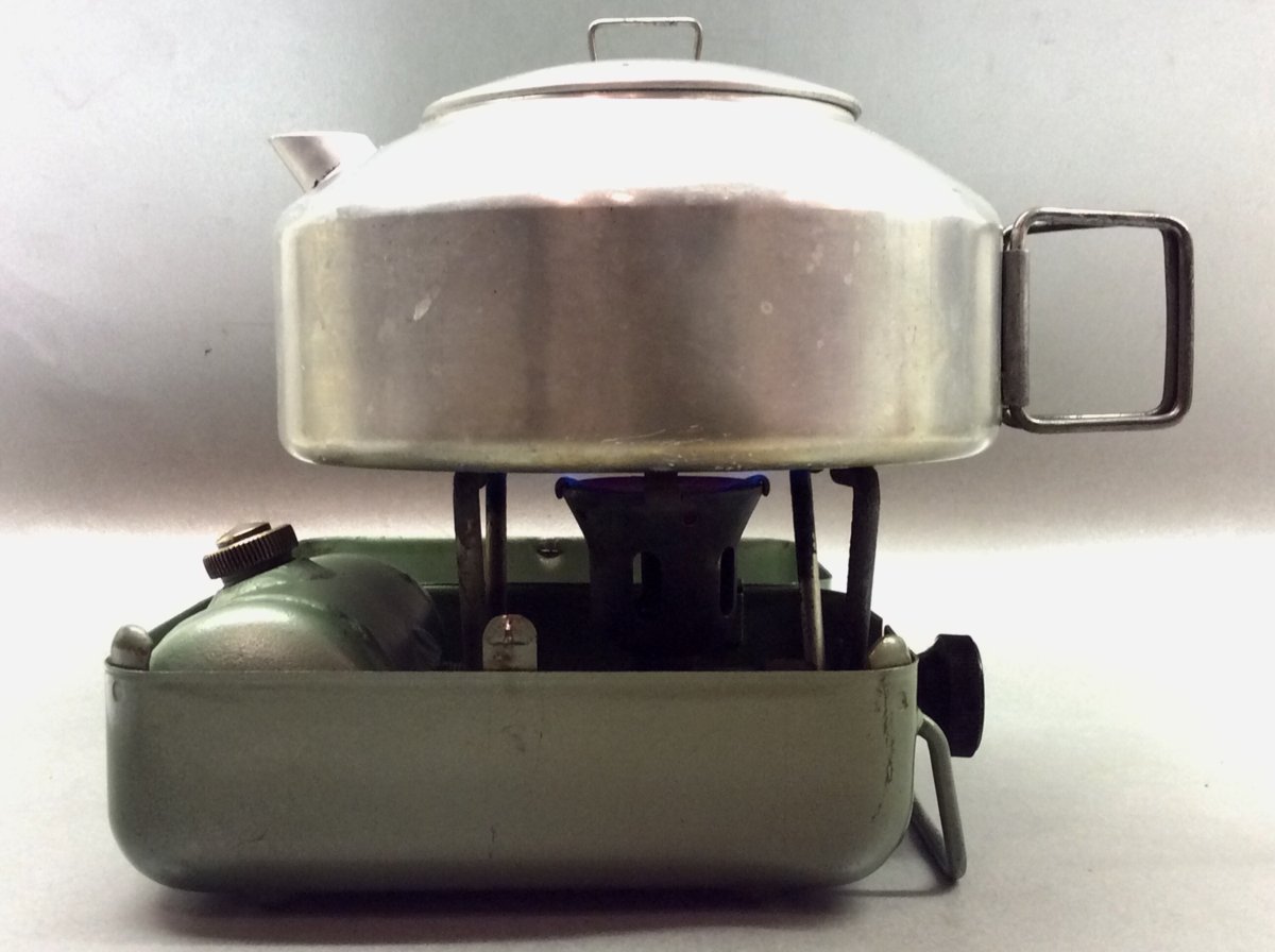

    Kettle set to boil.
    Simmer is reliable, by which I mean it can be easily set and doesn't peter out, but asymmetric. I can understand why Ben went down the route of using a burner plate, which probably would have worked fine without the drama if he'd not allowed himself to be distracted!

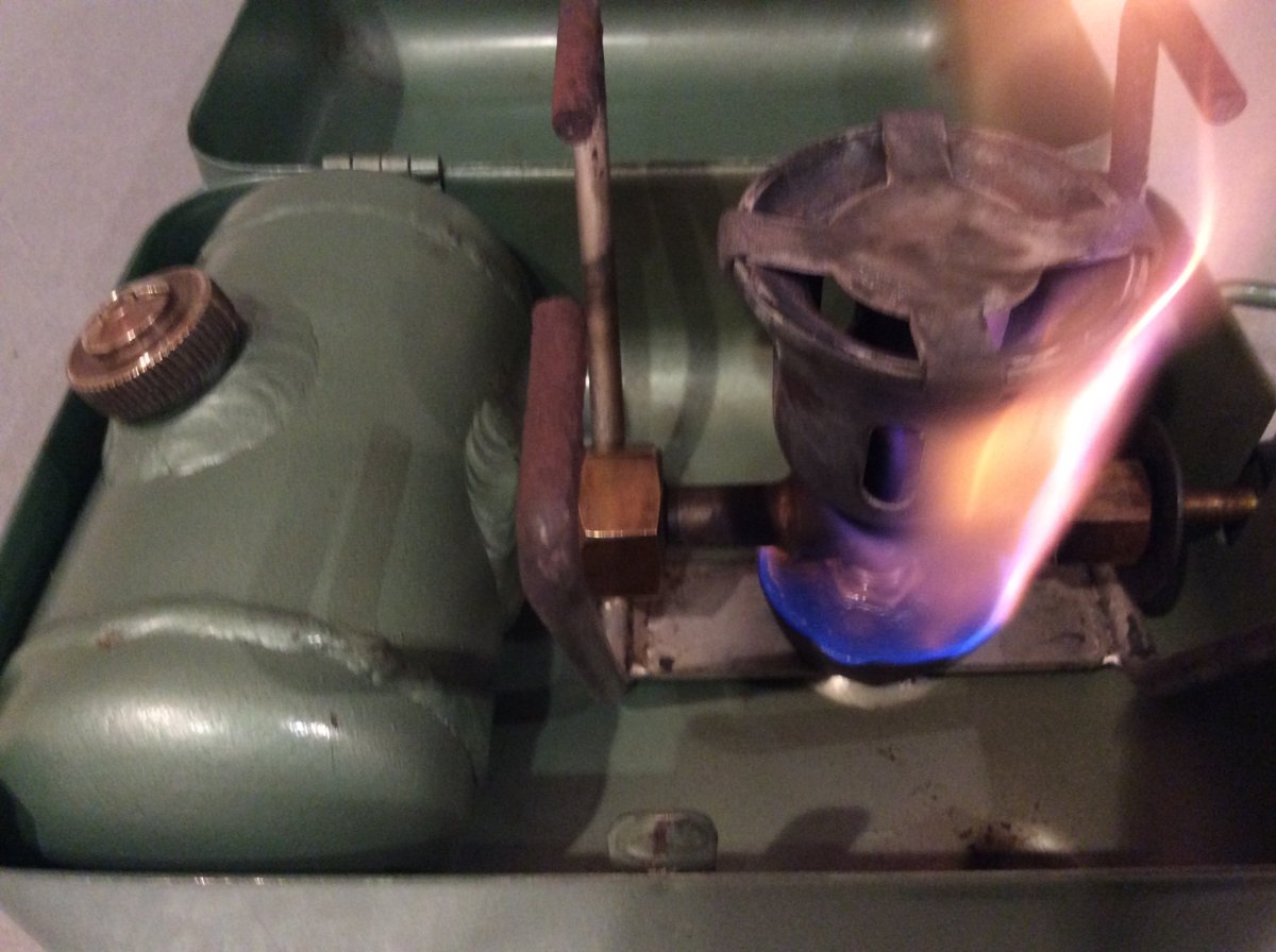

    Getting the single burner Vesta going was a doddle. I've a bigger challenge on my hands with the dual burner type. Complete but for pot rests, which I've to fabricate, but in need of renovation.

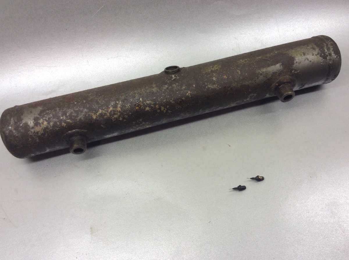

    Stove tank suffers from surface rust merely, otherwise sound - dual and single burner stove tanks are of heavy-gauge seamless steel pipe with end caps, filler cap and burner connection bosses welded in place.

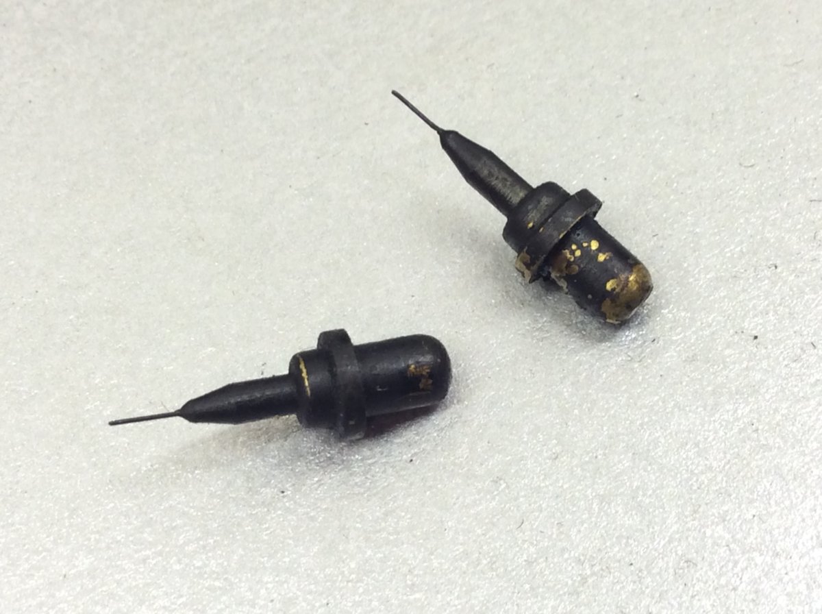

    Thankfully, both burner jet needles are in good shape.
    Priming of the dual-burner is a longer process, as is evident from the increase in size of each of the burner priming cups in comparison to that on the single burner.

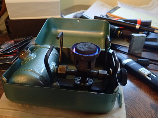

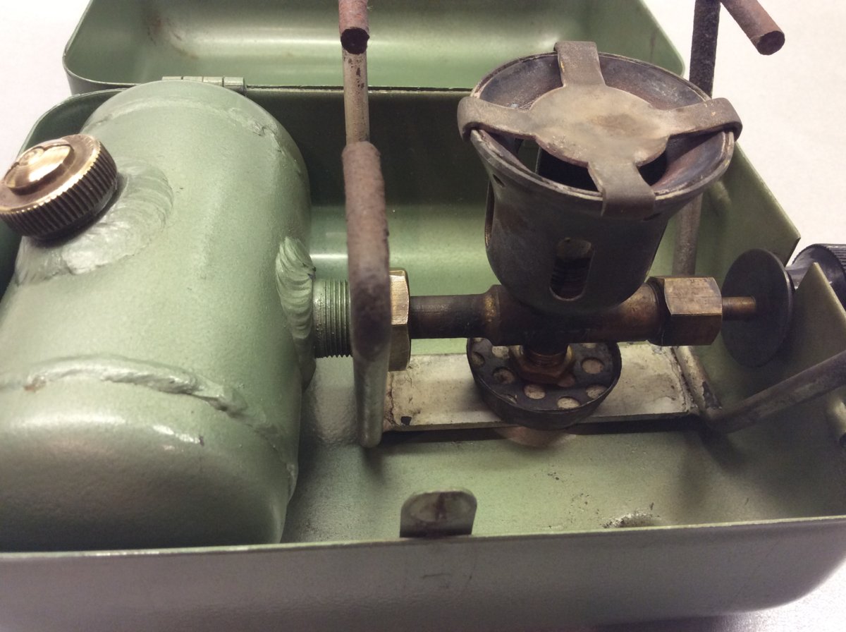

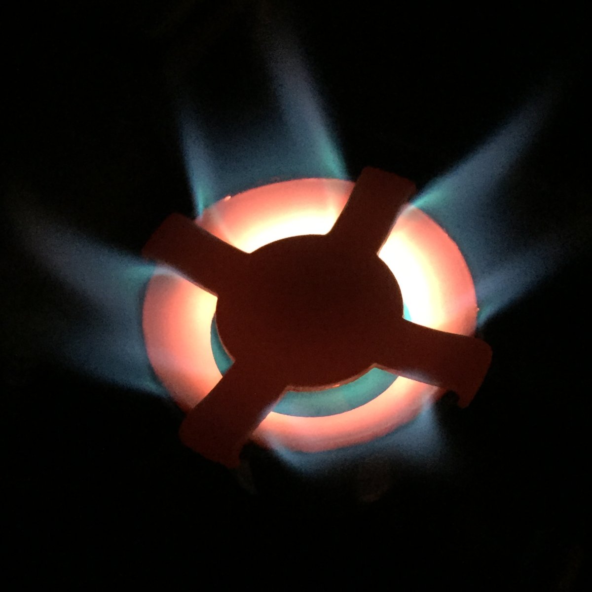

    Updating you on achieving a reliable simmer too, Ben. I removed the jet pricker and spring and have been running the stove without them.
    True, not now 'specification' for the stove and there's the occasional requirement to manually prick the jet but the modification is reversible if required and the results are very pleasing.
    Smooth transition from simmer to maximum.
    Access is good for a manual pricker and the broad flat face of the jet makes locating the jet orifice with the pricker wire easy to do.

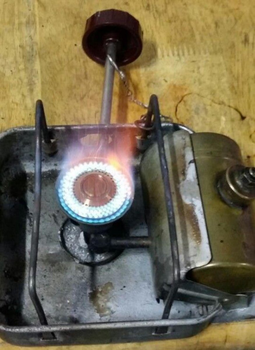

    Some more tuning completed.

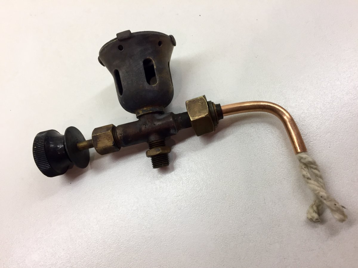

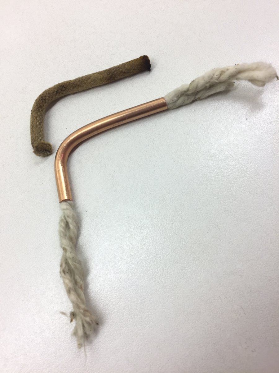

    The heavy-gauge steel of the fuel tank is a poor conductor of heat and even though it permanently sits inside the stove case with no heat shield between it and the burner, a significant conductor for heat from the burner to the fuel to pressurise the tank is the wire core of the wick.
    The woven cotton wick itself is a conduit for fuel by capillary action but being a thermal insulator does not contribute to heating/pressurisation of fuel in the tank.
    I decided that I could enhance the heat transfer to the fuel and retain the fuel transfer conduit of a wick by utilising 6mm outer diameter copper tubing with cotton wick strands threaded through it. I used a small pipe bending tool to create the bend in the tubing. Here's the tubing with the cotton wick (before trimming) threaded through it. Alongside it is the original wick.
    Here's the tube with the internal wick trimmed at the burner end ...
    ... and here it is inserted in the burner.
    Cold fuel, ambient temperature freezing tonight in my part of the UK but the Vesta's burner immediately leapt into life after priming, when it was much slower to get up to speed before.
    It's livelier too on max, but (with the jet pricker needle removed) retained the controllability of the flame down to a low simmer setting.

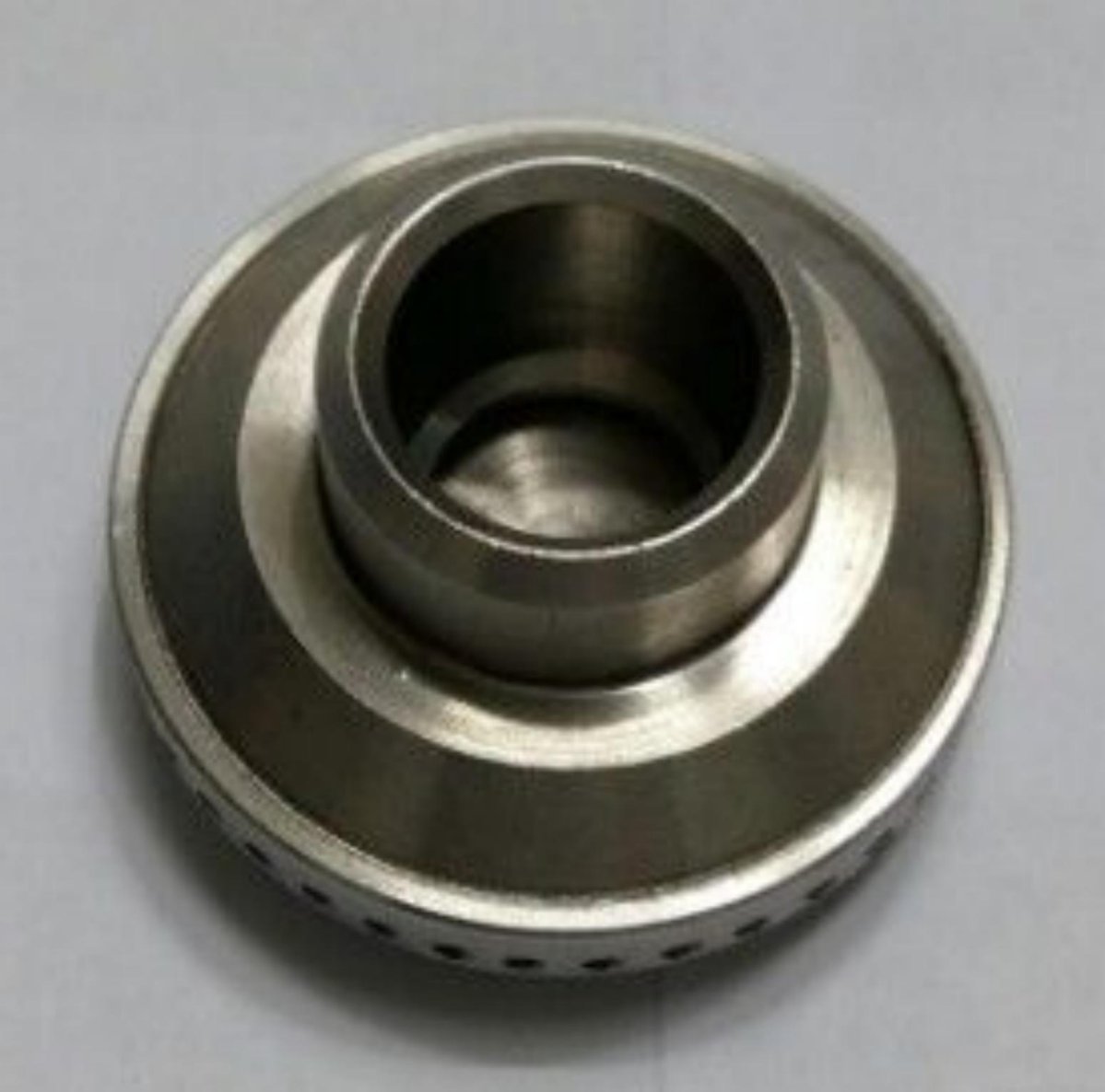

    The Vesta may be a good candidate for a new silent cap out of South Korea. It is very similar to the one I featured, but it is the smaller burner bells. Optimus 8, 8R, 80, and the 99. Primus 71 and also the Radius 42 and 46. Also the SVEA 123.
    Here are the different stoves it was tested on.
    Here is the link for this silent cap.
    http://www.ebay.com/itm/222244313728?_trksid=p2060353.m1438.l2649&ssPageName=STRK:MEBIDX:IT
    Here is the you tube video.
    All of this is just in case you might be interested.

    The copper tubing and inner wick core arrangement has really made the difference on start-up in cold conditions.
    You mentioned the 'fit' of the copper tube in the fuel pipe, Norman. I picked a diameter of tubing that was a close fit (to conduct heat efficiently) but not a tight fit.

    The Vesta cleaning needles are fragile and several of mine broke. Gary (BernieDawg) Adams at Bluewater Stoves went to a great deal of trouble making some replacement needles for me. Running the stove without the cleaning needle never occurred to me but I'm going to give it a try. Drilling out the jet allows me to get a nice simmer but adjusting the flame size at other settings isn't as smooth as I'd like. I run my Vestas on Coleman fuel which burns so cleanly the needle probably won't be missed.
