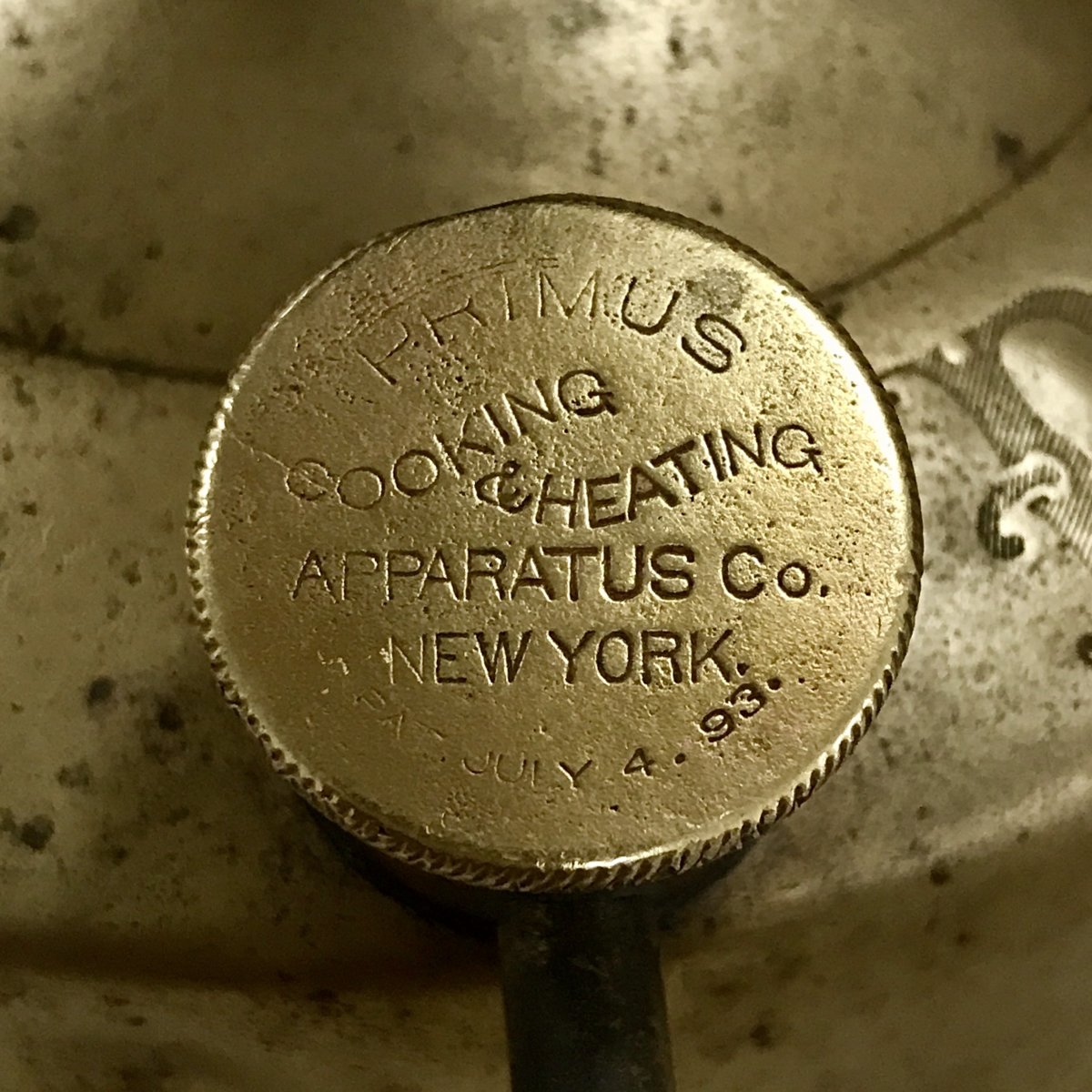

    This is a real old guy, the oldest of all my stoves. According to the catalog, it was produced in the United States around 1897. 3F448534-639C-45D5-A41A-3D9FBA91B7BF.jpeg 7C403A57-DFFF-400F-A58C-DBE7EFADF174.jpeg It's a little different from the Swedish production of the same period D29A0C74-E0D9-4C8C-9E86-E89A5EC39D37.jpeg The stamped text on the tank is beautiful 62616195-CF90-47CC-A51F-FAE57691DC24.jpeg There is some useful information on the tank lid 282B424E-E131-441E-A84E-FBCE80118566.jpeg No text at the bottom
