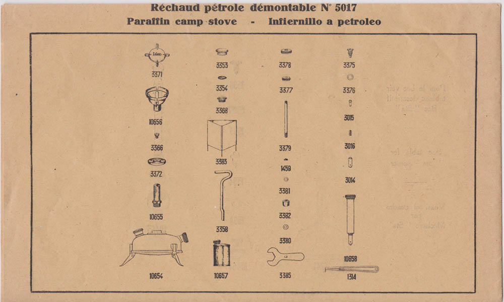

    Here is my example of the very rare Lilor 5017 "Tourisme" camping stove, made only in the years 1928 and 1929. A tiny 1/2 pint kerosene stove with a lipstick type burner.
    This is the second ever collapsible stove, made by Lilor. The first is the 5015/16 "Rond" kerosene stove, with a Primus silent type burner setup, which was launched in 1925 and still sold in 1930.
    A funny thing is that the stove displayed on the Lilor 5017 tin box lid is not the 5017 stove, but the earlier 5015 Rond stove, which is quite different.
    I was happy to get a complete set with a wind shield, spirit can, spanner and cleaning needle handles. Fired up nicely after pre heating and was a bit "noisy" in working mode.
    Great to have this Lilor stove as a complement to all my Lilor lamps.
    /Conny
    Lilor 5017 stove.jpg Lilor 5017 stove tin.jpg Lilor 5017 stove box with parts.jpg Lilor 5017 stove parts.jpg Lilor 5017 stove pump1.jpg Lilor 5017 stove pump2.jpg Lilor 5017 stove plug.jpg Lilor 5017 stove filler plug.jpg Lilor 5017 stove lipstick generator.jpg Lilor 5017 stove lipstick and jet.jpg Lilor 5017 stove without burner top.jpg Lilor 5017 stove from above.jpg Lilor 5017 stove with wind shield.jpg Lilor 5017 stove with spirit can and wind shield.jpg Lilor 5017 stove spanner.jpg Lilor 5017 stove pre heating.jpg Lilor 5017 stove fired up1.jpg Lilor 5017 stove fired up2.jpg Lilor 5017 stove fired up3.jpg Lilor 5017 stove fired up4.jpg
    Lilor 5017 stove instructions 1.jpg Lilor 5017 stove instructions 2.jpg Lilor 5017 Rechaud Tourisme.jpg Lilorkök 5017 sprängskiss.jpg

    Interesting that the lipstick vapouriser was equipped with a removable jet nipple as standard, evident from the illustration in the instructions. A sensible design feature, though going the whole distance and equipping it with a more efficient tubular burner as a Manaslu 96 has would have been a better idea perhaps.
    Is the jet orifice of 0.23mm or 0.32mm diameter I wonder? Even the Primus 100 with a larger lipstick vapouriser than that of a ‘96’ has a 0.23mm jet orifice.

    Thanks John @presscall
    I can just make it with a 0,20 needle; can´t get through with a 0,22. Probably jet orifice of 0,20/0,21!
