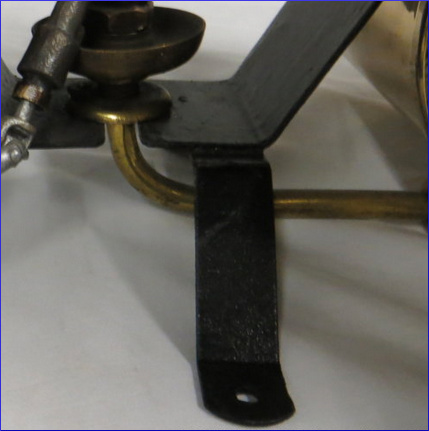

    Another difference on Ted's stove are the supports below the burners which allow the frame to be screwed or bolted to a surface.
    None of the catalogues showing the 526 and 527 stoves show this feature.
    A 1925 catalogue does show this type of support on the two-tank marine version of this stove, the 524 and 525.
    This stove poses a few questions to which I do not have definitive answers at the moment.
    It may be that in 1934 Primus offered both the silent and roarer versions of this marine stove and called them both 527, or maybe the retailer was willing to change the silent burners for roarer burners.
    It could be that one of the owners of this stove replaced the original burners.
    If the burners have parts numbers stamped onto them it might help in solving this mystery.
