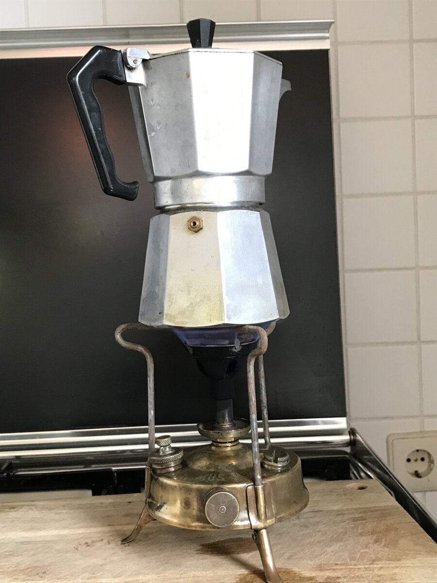

    Hi all,

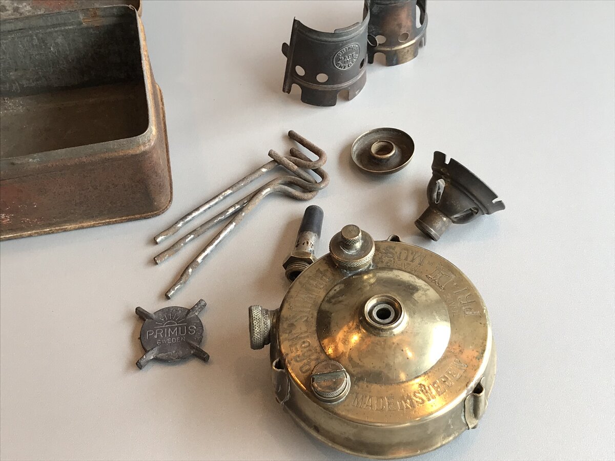

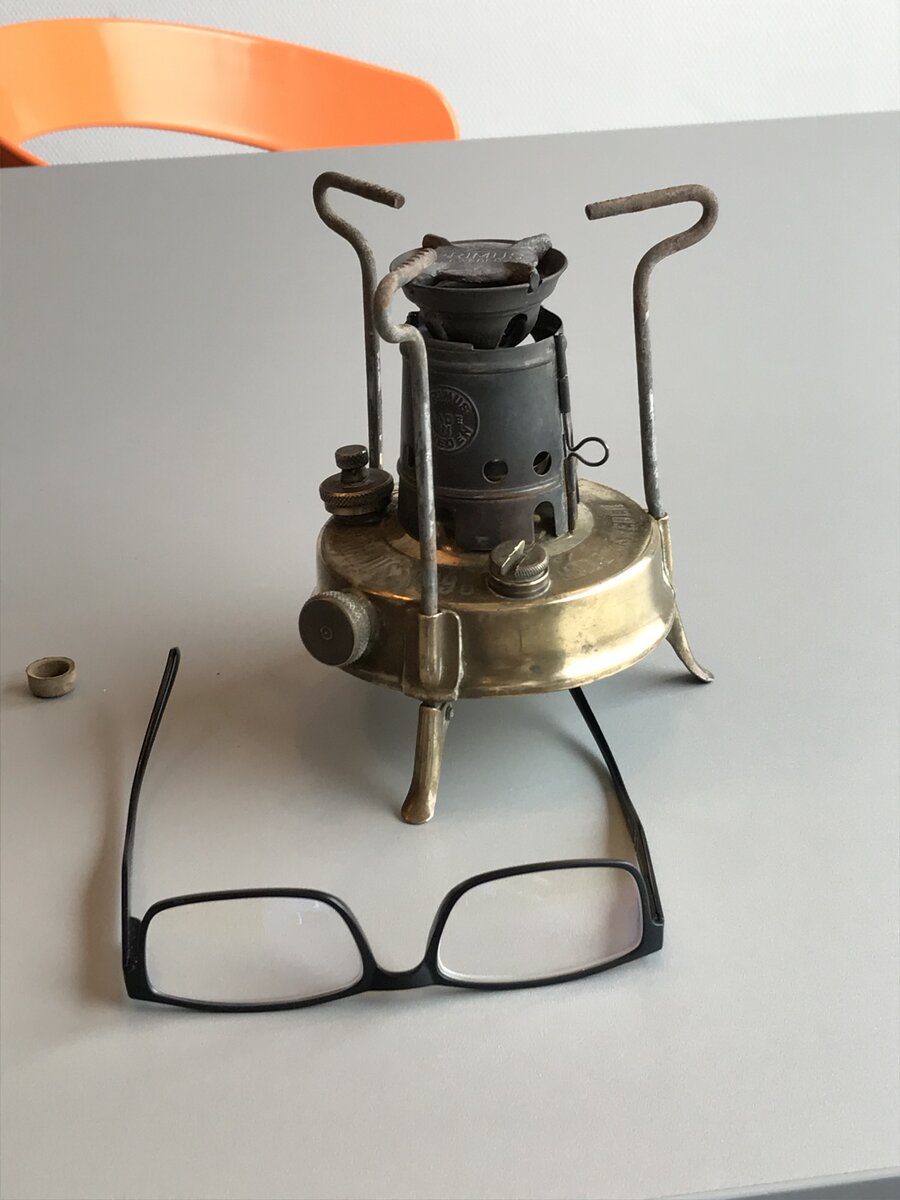

    I just received a new stove, a Primus 96, marked Z, so of 1935 origin. It came to me from France in a tin that deserves some tlc. It misses the spirits can and the spanner (for now I use an original Bahco adjustable spanner, from the same manufacturer, which I found appropriate, but very much later fabrication date), but is otherwise complete.
    In the last picture you can see a reserve pump leather that came with it (dry, but came out oiled very usable), which it really needed, as the pump action was without result with the original leathher. I also changed the fuel cap seal, but otherwise did not do anything but to fire it up!

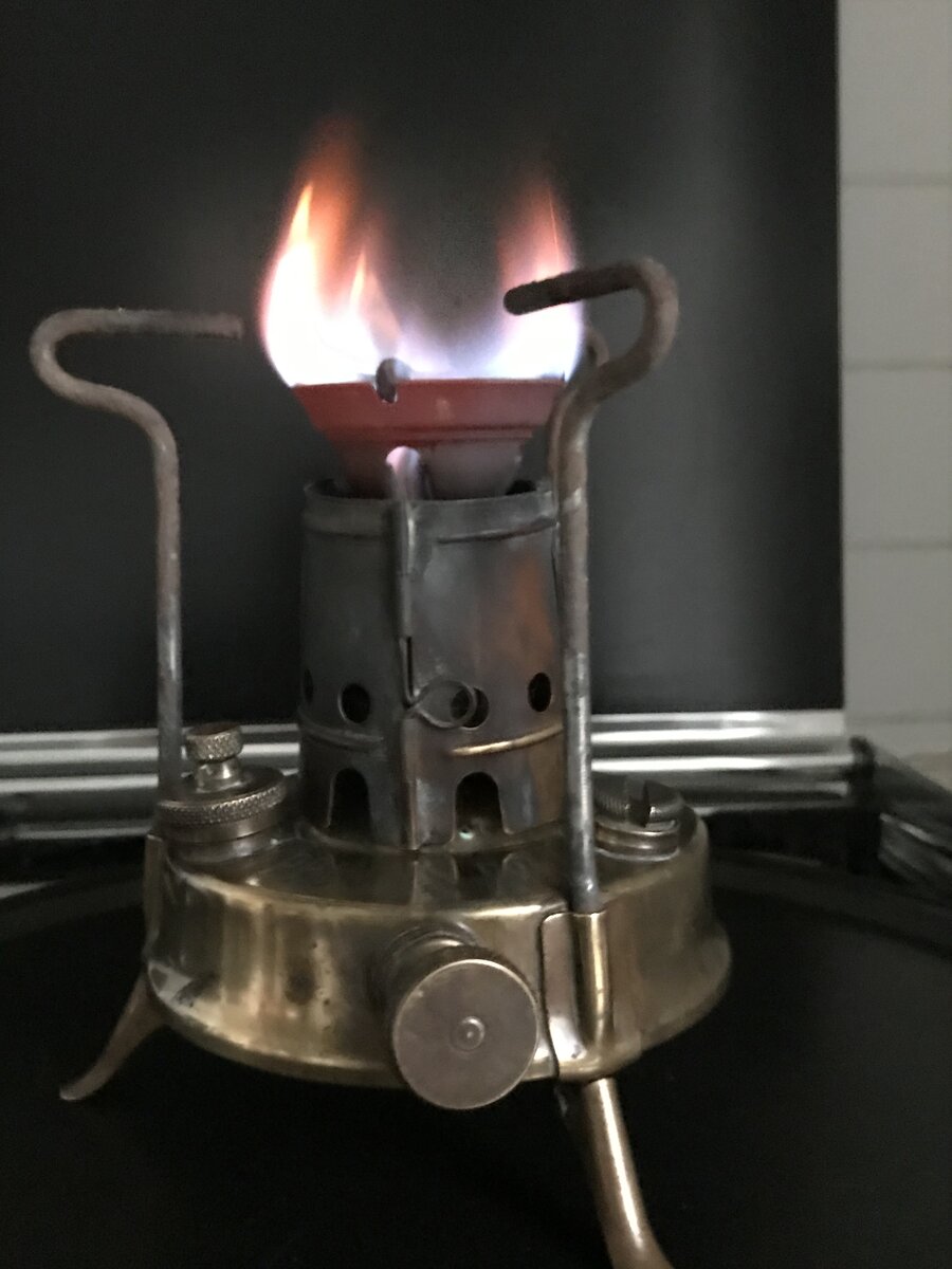

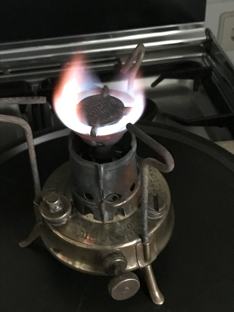

    and again after it became a bit darker in the evening, for extra pictures
    a tad yellow, but fine for now.

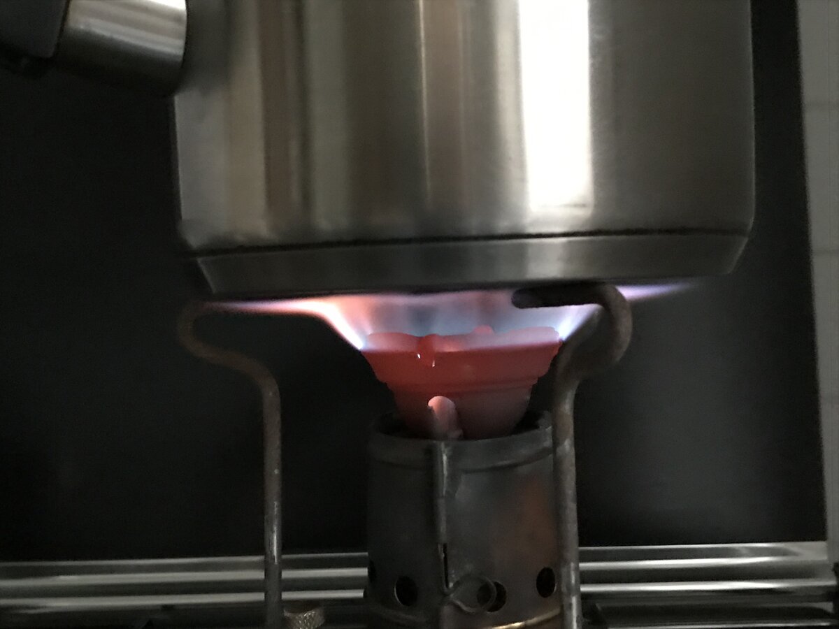

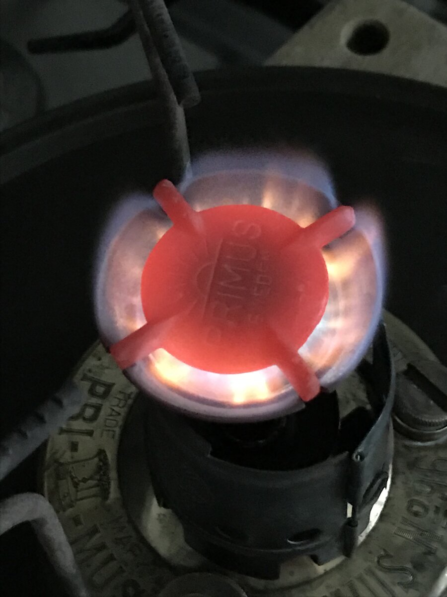

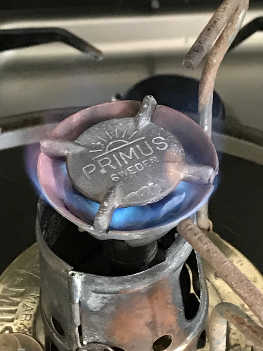

    Simmer also a bit yellow:
    My first disc stove, it takes a bit of getting used to getting it going, after stoves of the like of a 111, so I had a completely sooted burner bell after the first try. Easy to clean though.

    You'll need to peen the burner, I have a ton of the different years.
