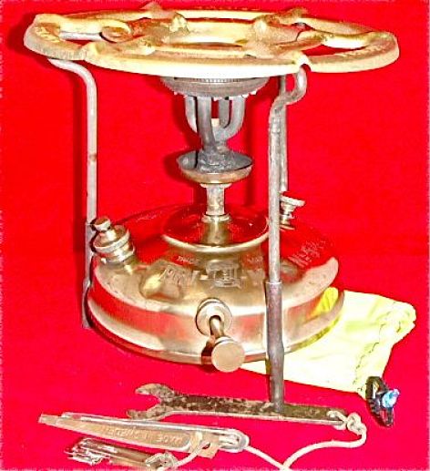

    Looking at this battered relic suggests that no one could possibly value it. However there is no way that I would part with it. It was the stove that I first used and the one that started my collection.

    At the last count there were thirty individual dints in it.
    After 1964 it got put to one side when we had a Caravette and then went family camping with a gas stove. In the 1970s it got resurrected again and was used for "lightweight" camping including hill camping. I like silent stoves for cooking. It was also used again for motorcycle camping

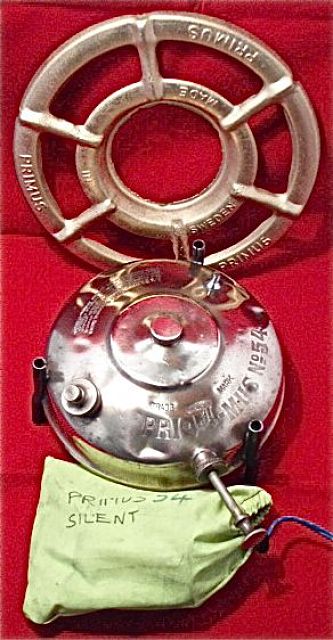

    Initially I did not have either a spanner or a reserve lid and if the spanner came with it one of my brothers had lost it. The reserve lid did not come with the stove. I used a leg through the burner tubes as a tommy bar to fix or remove the burner but eventually split a burner tube. My ''reserve lid" was a sharpened piece of wood dowel stuck in the tank top after it had been emptied. In 1963 I saw what looked like a reserve lid in a camping shop junk box and bought it. It fit so at long last I could carry a tank that was full of fuel.
    Over the years I developed ways of "improving" the use of the stove. My loose parts are always stored in fluorescent bags which cannot get hidden in grass. My spanner, prickers and tin opener are held together on string to make them more difficult to lose.
    I also learnt a trick for convenient parking of the reserve lid from a 51 stove that I bought. You tap the hole in the centre of the reserve lid and then solder a short screw to the tank which then becomes a parking boss. A 6 mm metric thread fits the hole perfectly
    1235226216-54_reserve_lid_in_use_opt.jpg 1235226243-54_reserve_lid_park_opt.jpg
    As you no longer need the chain you can remove the knob from the top of the reserve lid which, to me, looks a lot neater. It is so simple that it is a puzzle as to why Primus never did it in the first place. They provided reserve lid parking on most of their stoves so why did they stick the lid on a chain on the later 210s, 51s and 54s?

    The burner, inner and outer silent caps and the top plate are all replacements however all are authentic for the stove age.
