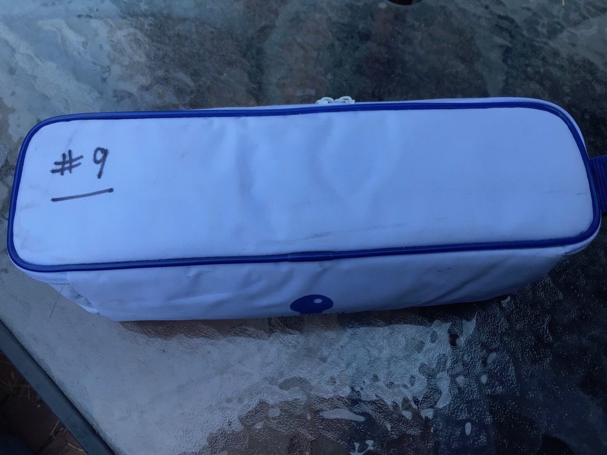

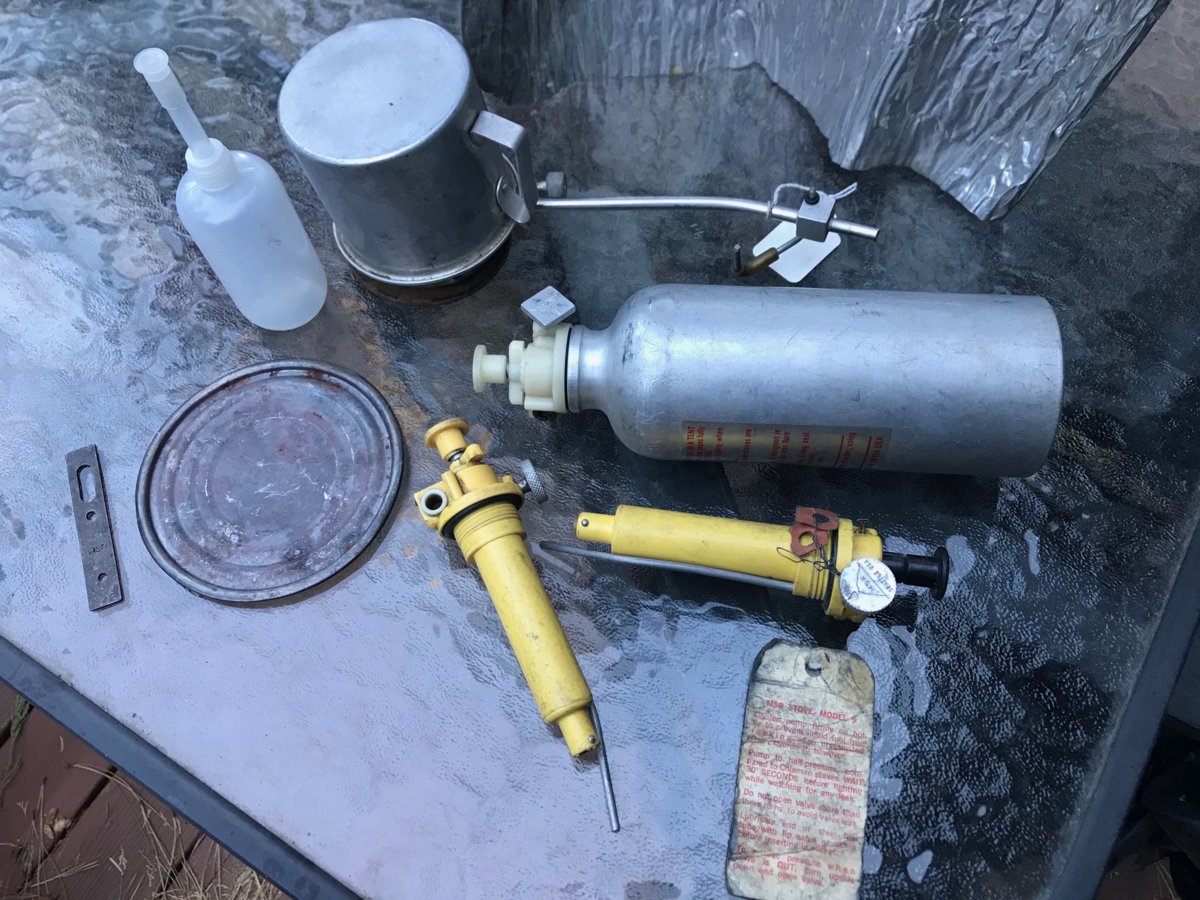

    Greetings, Stovies,
    Quite a while back, I was blessed to come into an MSR #9. This happened through the kindness of a fellow CCS member, who already had a #9, but was in negotiations to get another one. He knew I really wanted one of these, and so decided to put me in touch with the seller, from whom I bought this stove!! Thank you, Duane, @hikerduane , for your kindness and friendship!
    The seller was the original owner, who bought the stove in 1973. And, with the stove, came the original, white, square regulating knob pump...AND, when it cracked, as most of them did, the replacement pump that MSR send him, for free! The package also contained another pump, which ended up being the one the seller used until he sold me his stove. So, here's my MSR #9, and all the goodies that came with it, and also a few that I've added to the package. I carry my #9 in a padded case, meant originally for a hobby light/lamp, and it works pretty good. I think, however, that this special stove deserves something better, and will buy one of the new Outdoor Research padded bags for it, soon!
    And the contents, include:

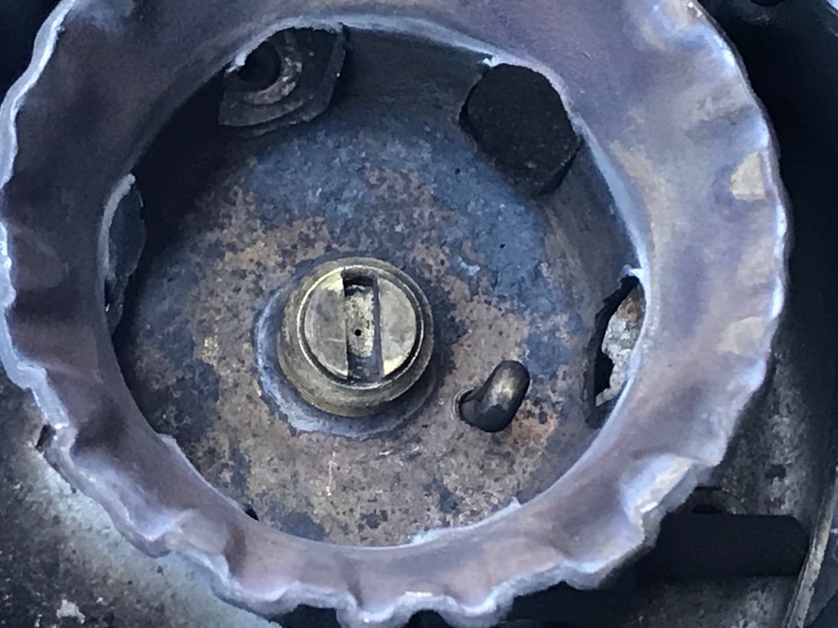

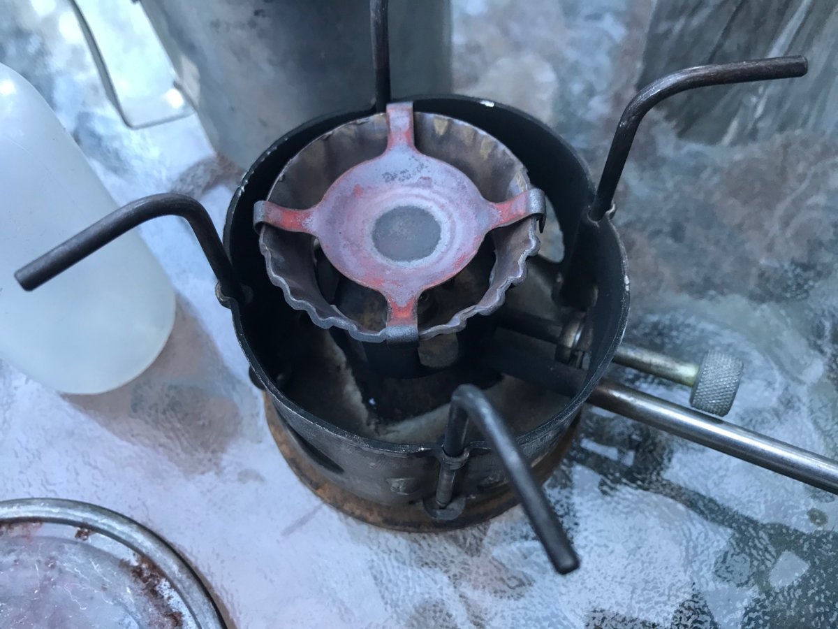

    The screwdriver tool did not come with this kit, but it's an older one from MSR, and works well with the #9. So, it has a new home here. Please note the heavily scalloped burner bell, and also the short, stubby pot support arms. Both are hallmarks of the #9, and you'll not see them on any other MSR stove.
    Let's take a closer look, shall we?!!

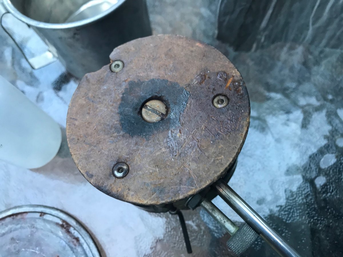

    Later versions of the #9 did not have scallops that were this heavy and pronounced. Rather, they were there, but almost indistinct. Here's the fiberboard bottom of the burner setup. You can see it's missing a chip, and deduce that this material was not as robust as one might want. This quickly led MSR to come up with the black, phenolic/bakelite bottom that appears on the #9A, and all other models, until the X-GK made it's appearance in the 1980's.

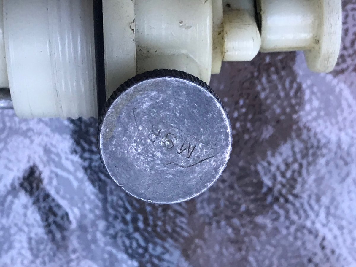

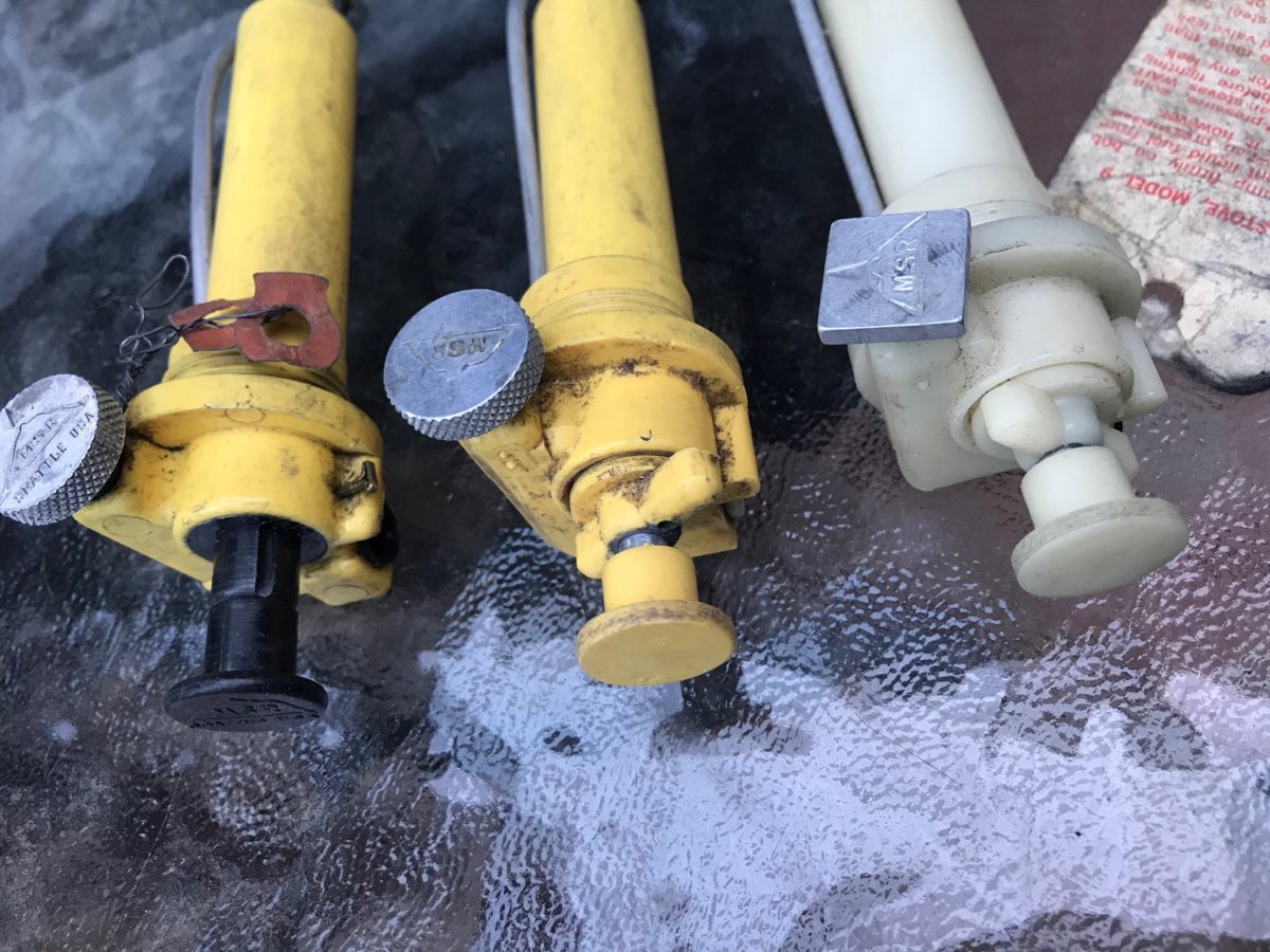

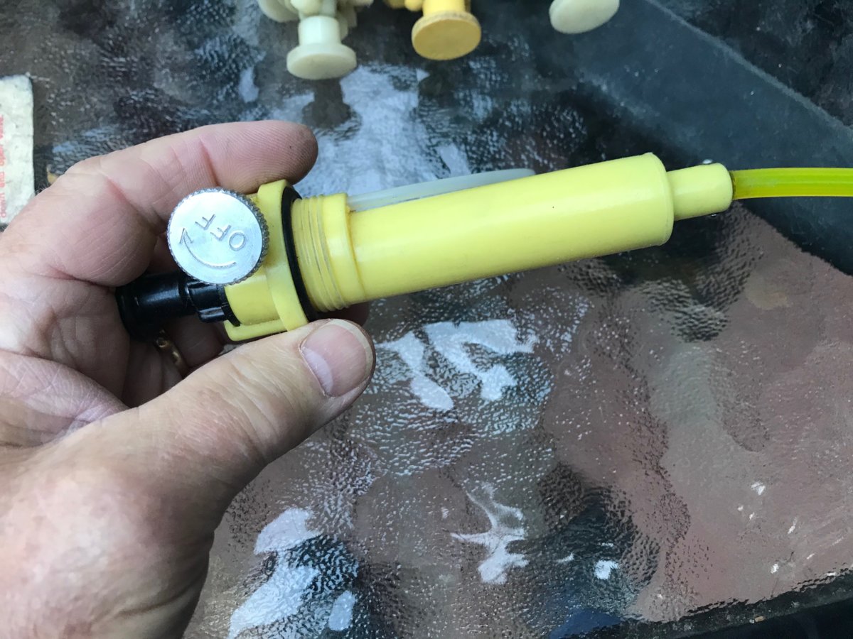

    Now, onto the pump(s)! Ahhh.... the pumps for the original #9 have a convoluted path, indeed! The original pump was white, and had a square knob on the regulating control. The plastic soon cracked, and MSR developed a replacement, made of a slightly different type of plastic. It, too, either cracked, or became misshapen, or both! So, MSR came out with what most of us thought was the first yellow pump. Of course, we were wrong about that!!

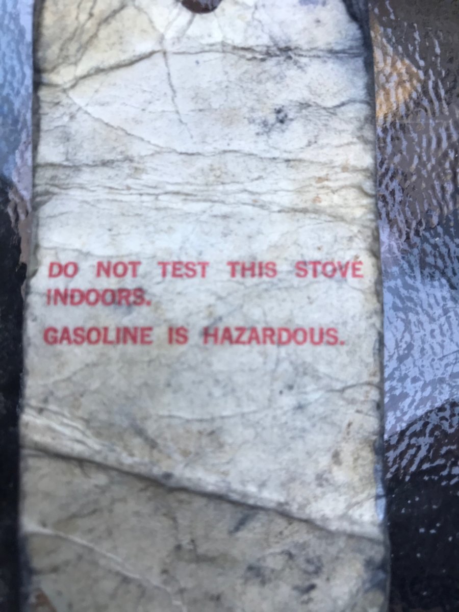

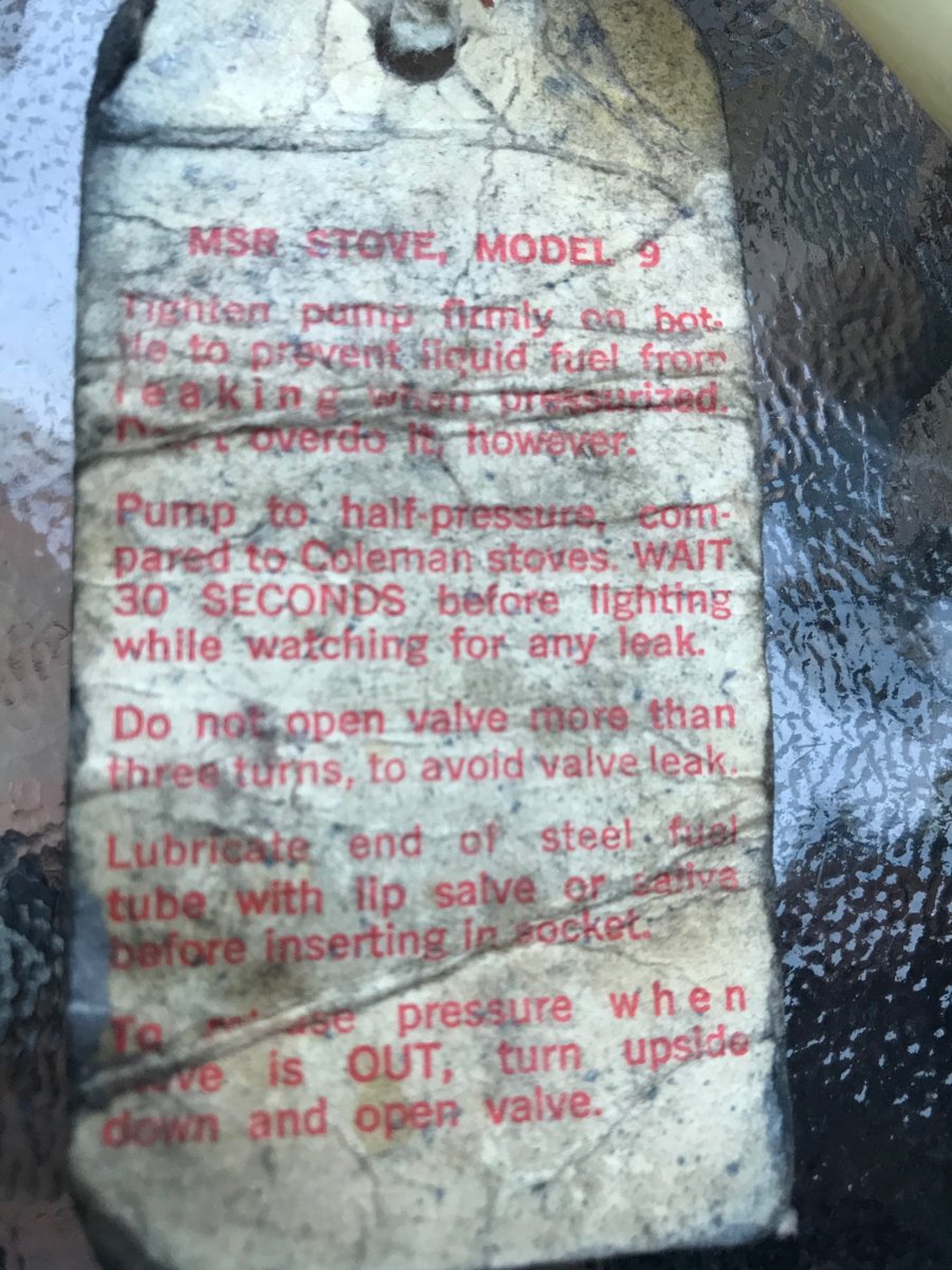

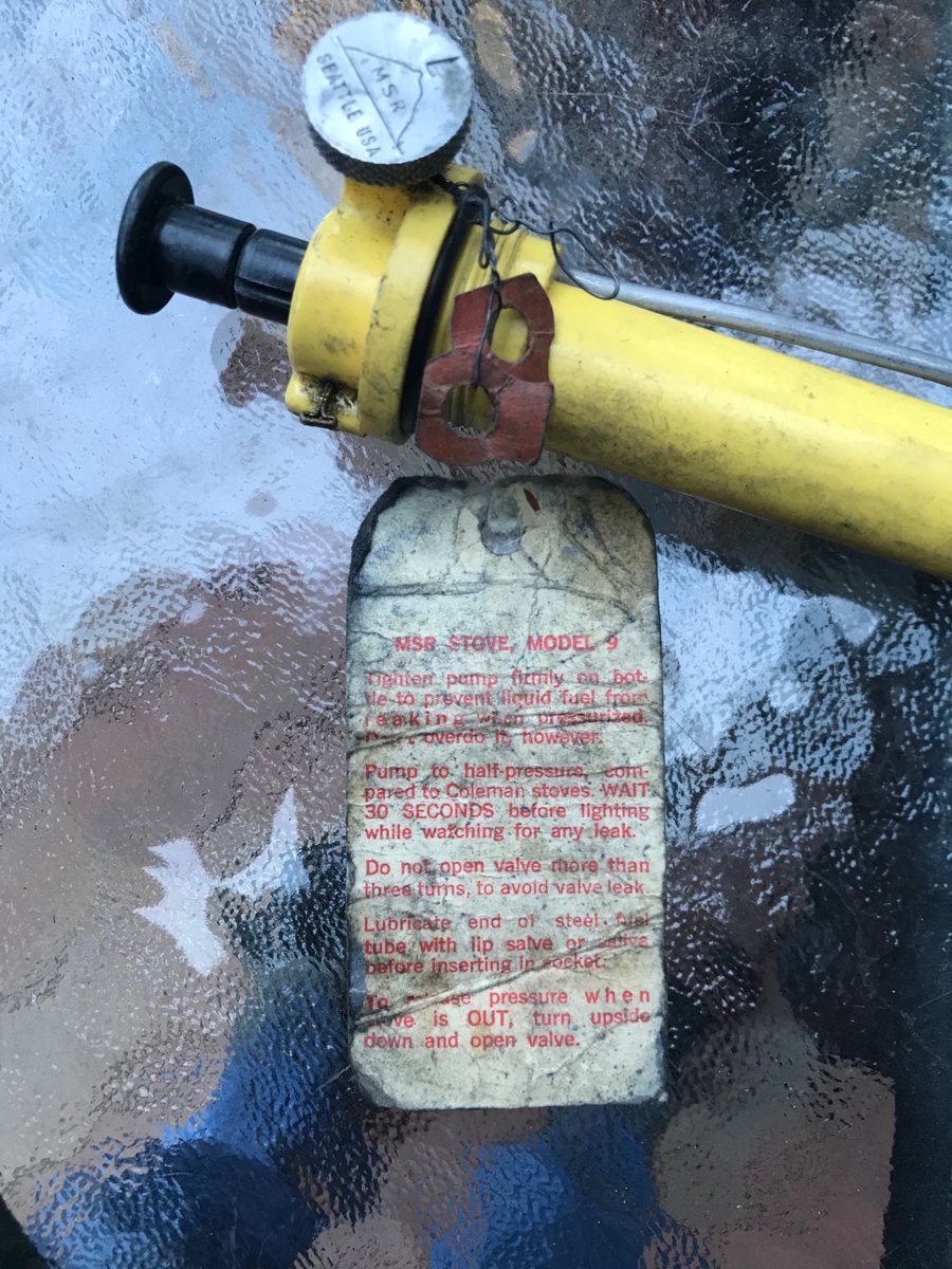

    The owner of this #9 was interesting in several ways. First, he kept all the stuff that came with his stove, even as the pumps cracked, and were replaced. Second, MSR recommended always moving the heavy paper label/instructions, to whatever pump was being used. And, this owner, did exactly that!! So his poor tag, which is in fairly nasty condition, was moved from the white pump, to the yellow replacement, and to it's replacement, as well. Hence, it's poor, but still readable condition!! You can see the wire, and reinforcement tabs, which have broken free of the label, on the top yellow pump! Cool, actually, that the owner did exactly as MSR recommended!!
    So, moving right to left: The original white pump, the first replacement (or WAS it?!?! More on that soon....), and the second replacement, on which you can see the wire and tabs of the label. I'll include two shots of the label, too, just for fun.
    Note the wire and tabs on the first good yellow pump, which the owner used, after the first two pumps were damaged.
    Speaking of damage, here's typical damage of the first two pumps that MSR included with the #9. See the crack, just beginning, under the fuel line insert spot?!
    Another shot of the crack, and also the deformation of the plastic. Sadly, the first yellow pump faired little better, and also deformed in use!

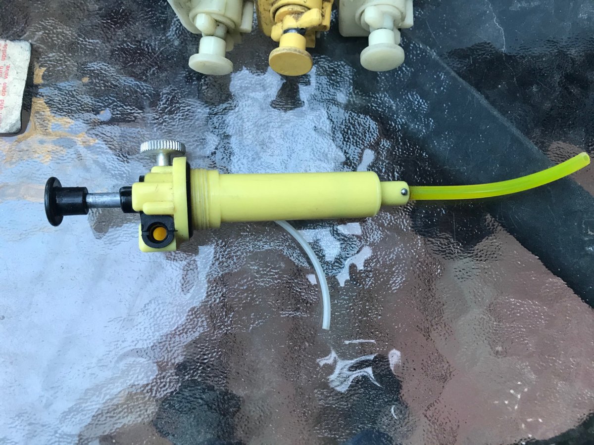

    The first good, and fairly reliable yellow pump was the next one, and the owner of this stove moved through them until he had this next pump, which, though in need of a rebuild, is strong enough to keep using, should one wish to do that!
    But WAIT!!! I told you earlier that the first replacement yellow pump might not have been first, but instead, second replacement!! I have no proof, but after this next pump came to live here, I now have strong doubts that the yellow pump was the first replacement!! I think, instead, that THIS pump was the first replacement sent out by MSR!!!
    So, here the first three are, all together, but imagine the two white pumps coming in 1st, and 2nd, with the similar yellow pump coming in 3rd!!! Interesting conundrum, isn't it?!!?! You can see the second white pump already beginning to crack! So, I believe it was #2, and had to be replaced, just like the first white pump did.
    Now, today, the pump I actually use with this excellent #9, is the newest MSR offering, and it works wonderfully!! However, I also rebuilt the last yellow pump, which I think is the best of that breed, and can use it, too, safe in the knowledge that it will keep working reliably, and safely!

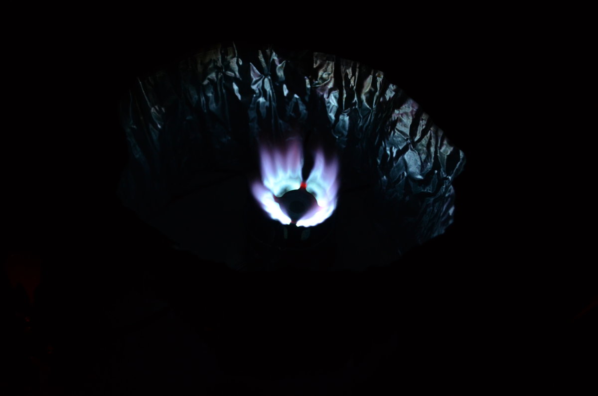

    I'll post the instructions in a bit. Right now, we need to see some flame shots, don't we!!?!
    And, my most favorite MSR #9 flame shot, which most of you have seen before, is this one!! What a powerful stove the #9 is!! In my experience, NO other MSR version of this family of stoves can best it, when it comes to raw power!!
    Below are the 1973 instructions. Note how simple they are, and if you look at what you can see of Monte's 1973 instructions, you will see that they are the same.
    Note the warning in the last box on page one!! ".... if you are not comfortable with this stove, please return it for a full refund"!!! WOW!! That's something very interesting!! I like it!
