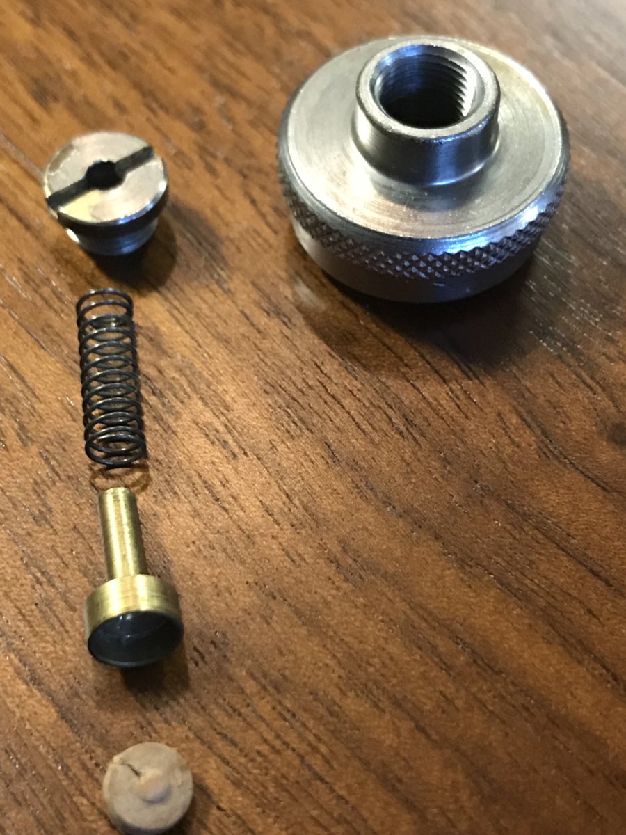

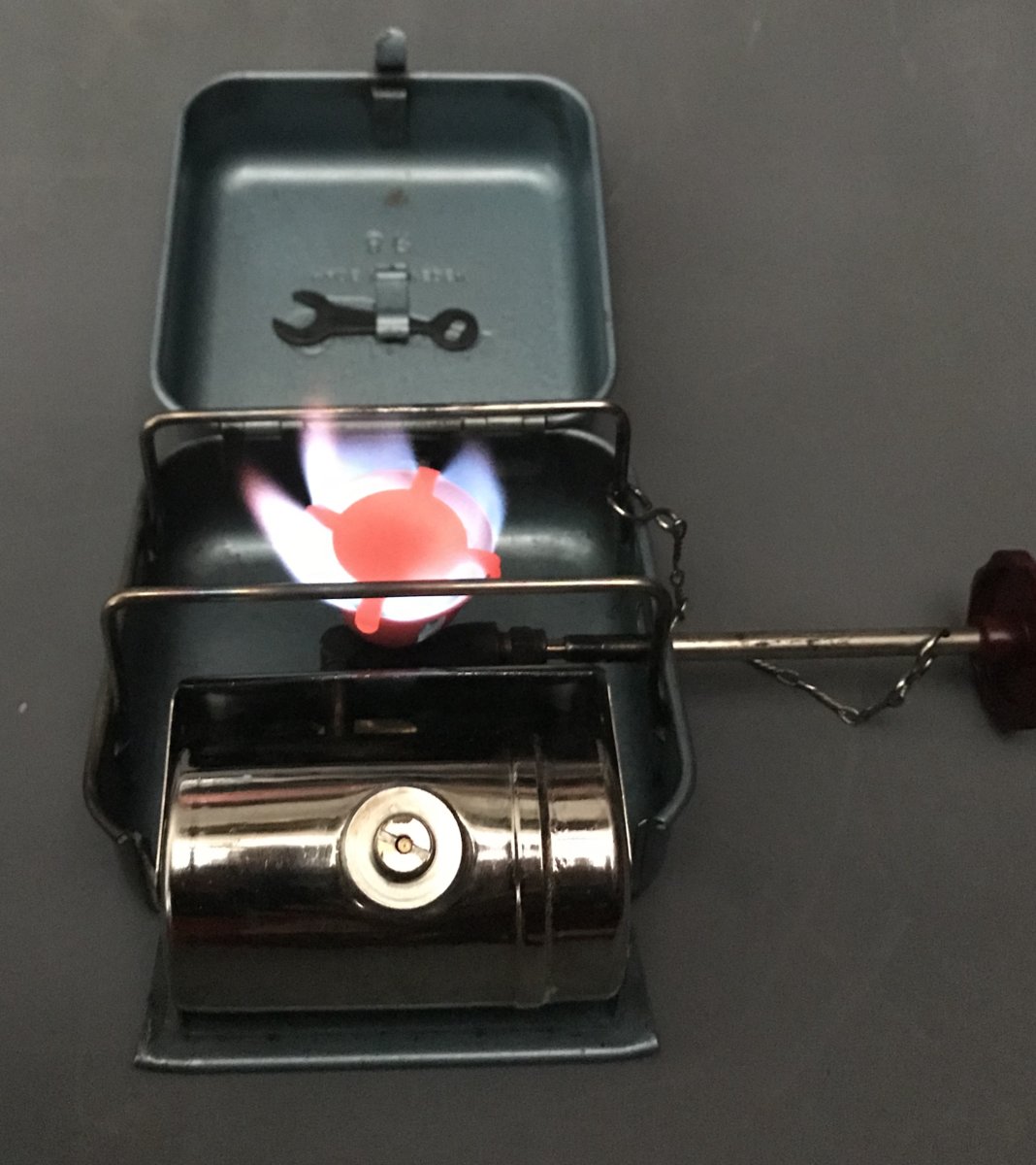

    I like these early 8Rs with the embossed Optimus logo.
    I've read that these debuted in '59 and since this one has a nickel tank (probably left over stock from model 8 stock) I'm guessing this is in that timeframe.
    Unique SRV assembly with it's long shafted PIP cup. A two day soak in acetone broke up the thread lock and it came apart easily. The pip cup accepts a pip of 5.5mm. A bit larger than most which run 4 or 4.5mm. This cork pip was in good shape and since I don't have a 5.5mm punch I decided to put it back in.

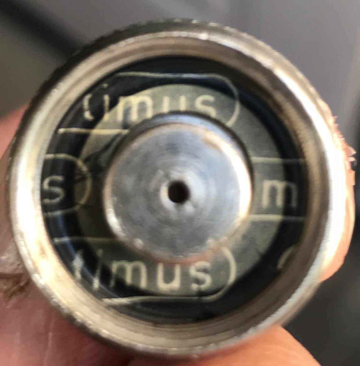

    The original cap seal was replaced with one from the Fettlebox.
    Runs great, cork PIP and all. Jerry

    Hello Jerry. Very nice example. I prefer the cork pips. They work well.
    Put a drip of fine oil into the hole on the underside of the tank cap to keep the cork moist and so it doesn't stick to the safety valve seat.

    Thanks guys!
    I’ll try that John, good idea.
    Jerry
