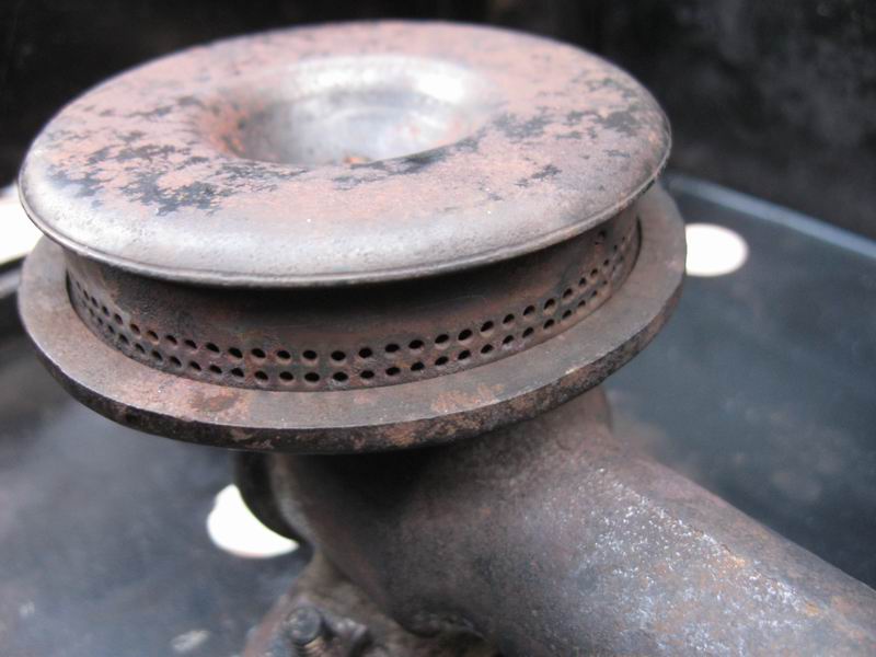

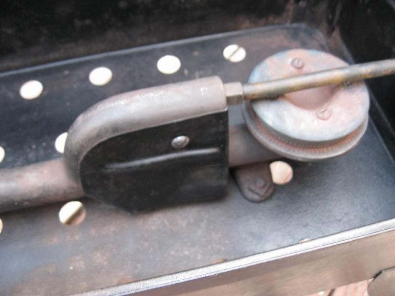

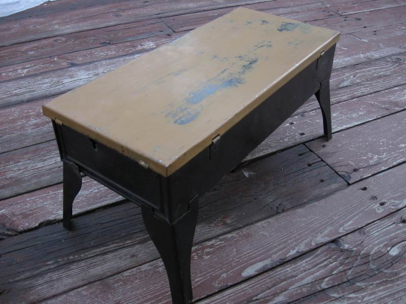

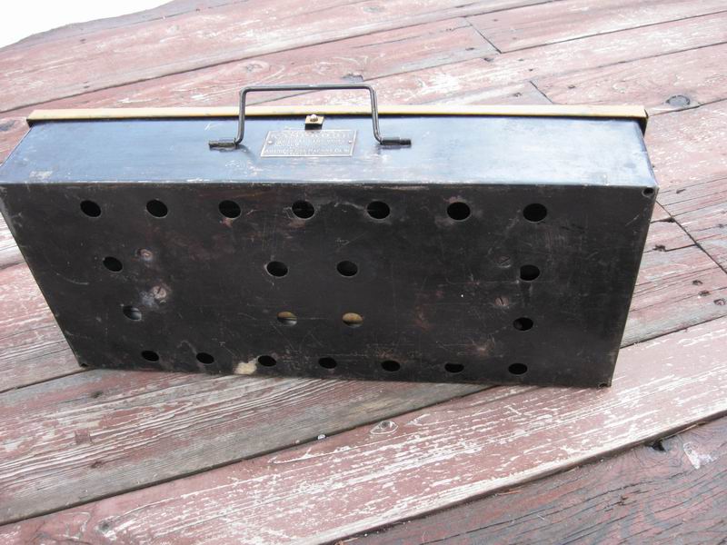

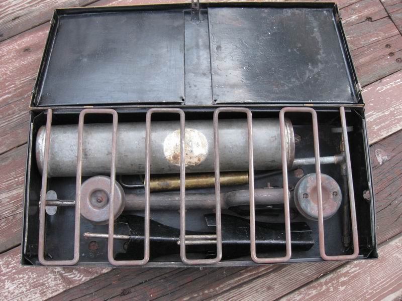

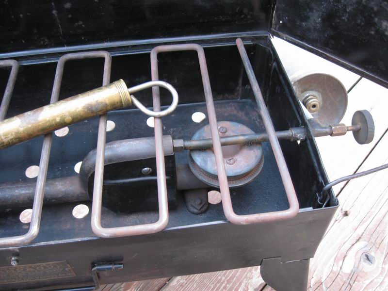

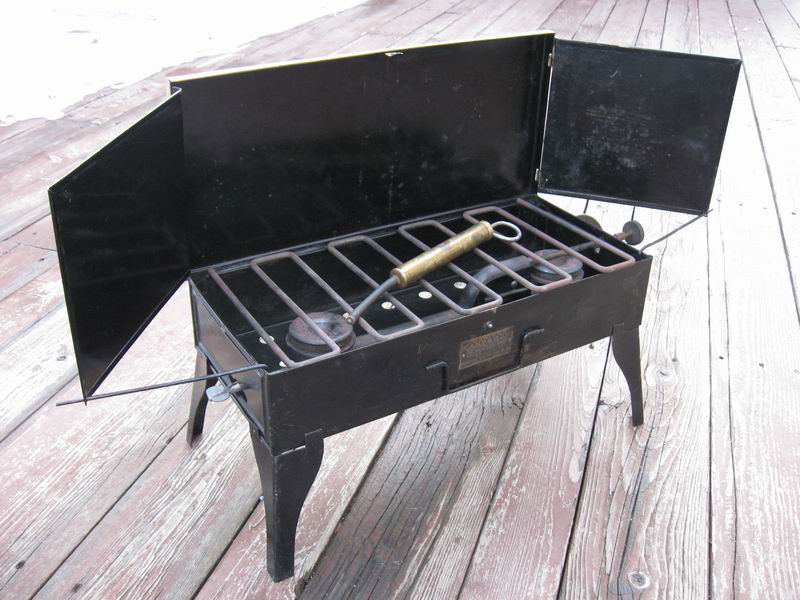

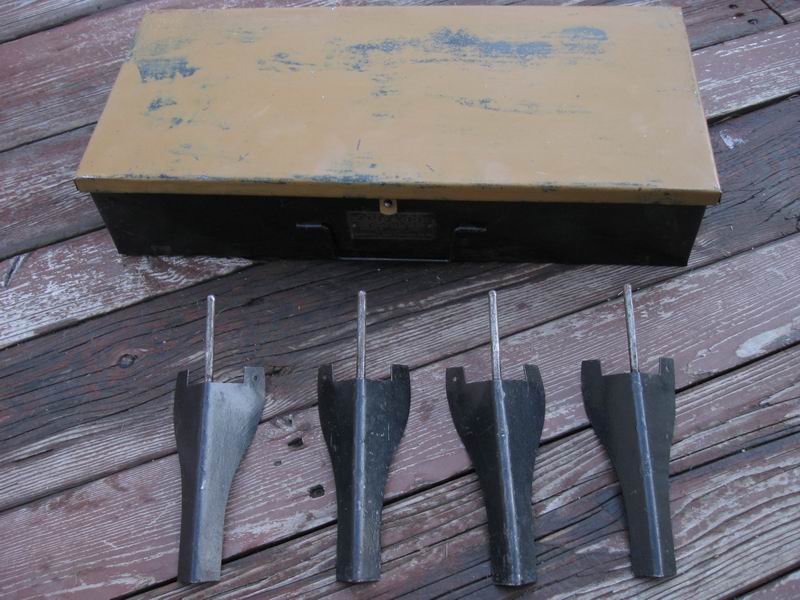

    Here ya go Guys and Gals . . . The Elusive Model #6
    A real Nice Find !!!
    Looks like it was repainted sometime over the last 80+ years . . .
    I "think" production was somewhere between 1922 and the early 1930's, but would be nice to know for sure . . . . . . . .
    Any info or direction for info anyone can share on the No.6 would be Greatly appreciated !!
    I was not able to run it as the pump bushing is old, and do not have any fuel right now :-({|=

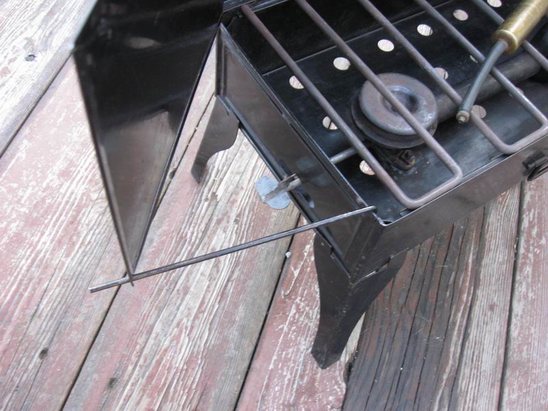

    Looks to be in very good condition. Never seen a complete #6 before. I have several KampKooks: #3, #7, #77, and others.
    Not sure on the dates since the earliest ones, like the #3, were late teens and early 1920s. I haven't done enough research on other models to say what possibly the date would be on the #6. I guess I would put it just after the #3 since it has many similarities to the #3, just bigger. So you probably have as close of a date as possible - mid 20s to early 30s - maybe even earlier.
    On one #6 the lid comes off for use, according to Terry Marsh's website. There is a #6 there and has straight steel rods for legs, where yours have the formed legs with steel rods built into them.
    Nice stove.
    sam

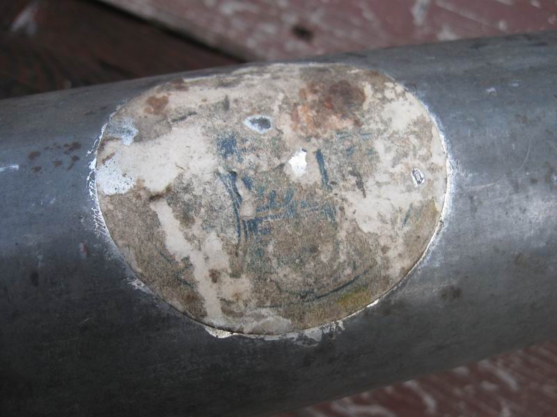

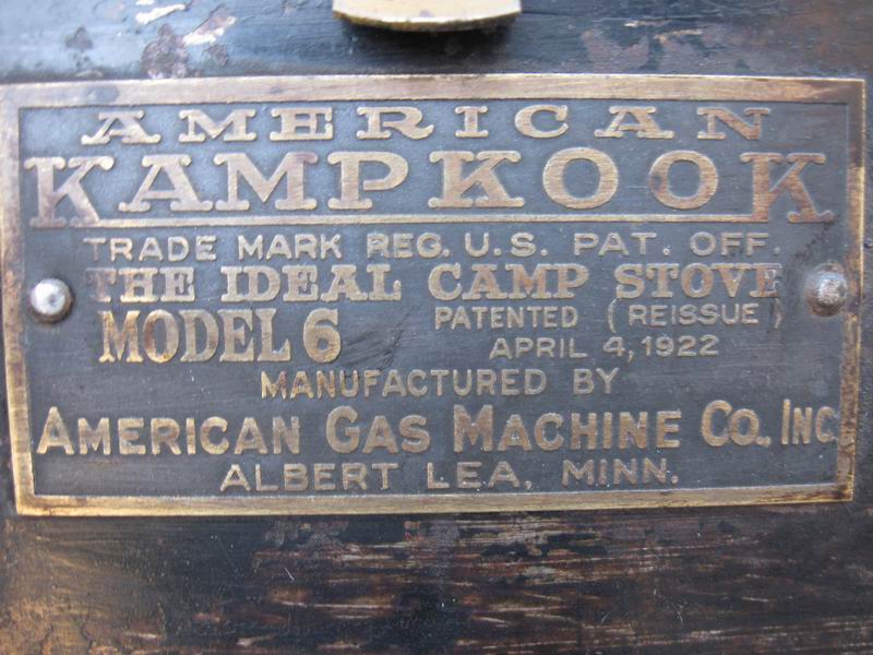

    Well with the tag saying Patent reissue 1922 - that would mean it is that or newer . . . . The lid is fixed / hinged on this one.

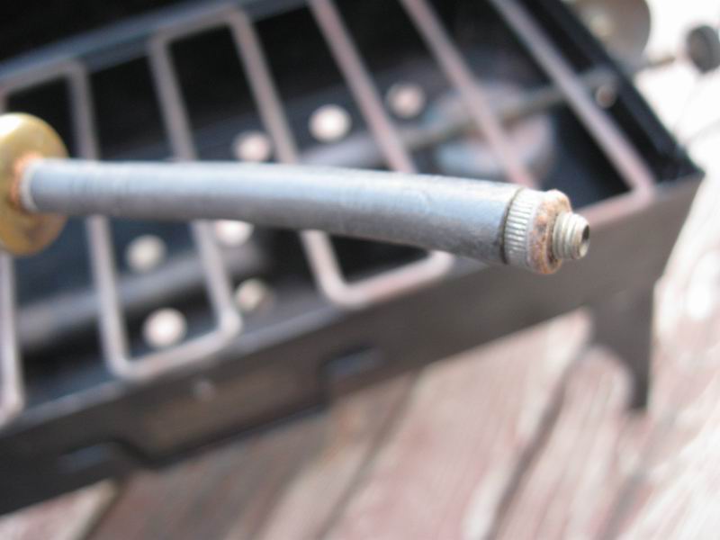

    I will have to figure out how to get the old Leather plunger in the pump working / repaired or just give it air by other means to pressurize it . . . . .

    I'm quite jealous of your stove! I recently came across my own No. 6 at a junk shop and bought it. I was infected with the Coleman Stove bug and I was drawn to this interesting relic of camping history.
    Mine is in pretty ruff shape and is missing the legs.
    I was wondering if it would be at all possible if you could take a couple measurements of your legs(i.e. Height of legs, height of post, smallest and widest width at the curves)?
    I'm going to cut out my own and braze in the posts as well and i just wanted to try and get it to be somewhat acurrate of a replica.
    Thanks for any help!
    -gmfiorini
