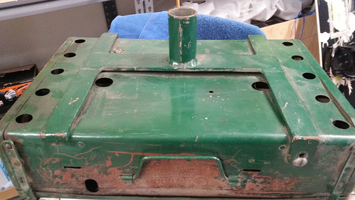

    Hi All
    Continuing my 4/4M obsession... I shall put this in the reference gallery to sit with the others as NZ found examples.
    I picked up this well used 4M on our local auction site, luckily for me almost free, and with a little waiting, free delivery too.
    So now I have a 4M with cast steel manifold and steel burner assembly as widely recognised/accepted as early 4M production materials (I believe they swapped back and forth between cast and pressed manifolds during 4M production run?)
    Copper paint coloured tank as with my 4NL and 4M with CI burners, but which according to accepted production materials for 4M's, this tank should be steel, it's Everdur, well at least nonmagnetic as tested by the caravan fridge magnet seen in above pic.
    Tank has the large 3 piece cap and red knobs, but no date (pre Coleman Canada stove date stamping start in 1963?)
    The main burner is part of manifold casting, auxiliary assembly and burner bases are pressed steel and auxiliary is connected to main by threaded pipe.
    Both burners contain 7 rings, 3 wavey and 4 flat (including the restrictor plate in main)
    The stove appears to have a locally made replacement grate, I guess the fact that the 4M grates are not attached led to the losses noted before.
    This stove also has a locally made stand system, 3 bolts and wing nuts attaching it to the stove and a receptacle underneath for what appears to have been a pipe upright with either a base, or a piece of pipe simply driven into the ground, I only have the attached piece.
    So again another example that appears to show that NZ was receiving 4/4M stoves that fall outside of the expected/accepted production materials, and I think that the inclusion of an Everdur tank with the cast steel manifold and steel burners in this 4M again possibly shows that NZ was receiving early development/run products when viewed in conjunction with my unstamped 4NL and the 2 known NZ found stamped 4M's with CI assemblies and Everdur tanks.
    But who really knows? And they're only 4M's after all.... lol
    Barrett
