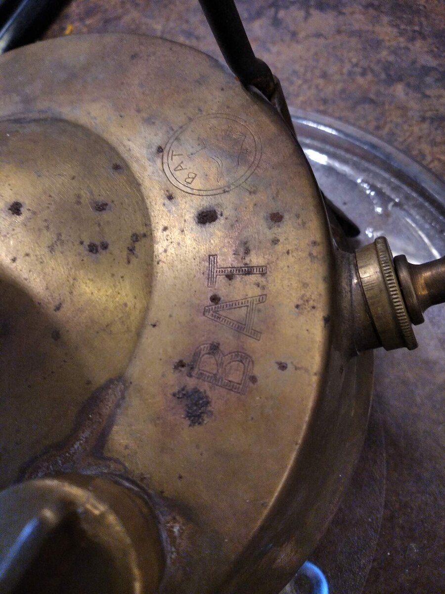

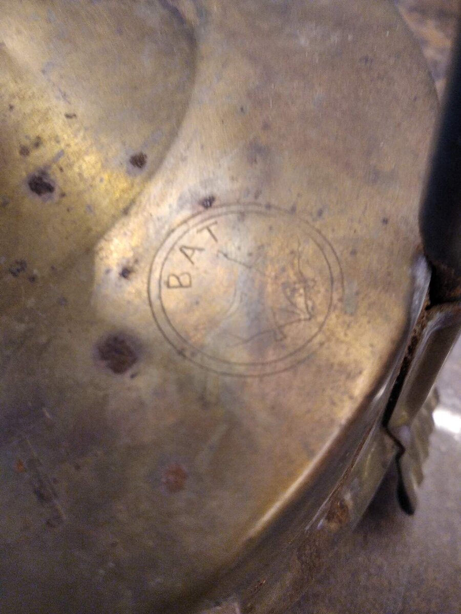

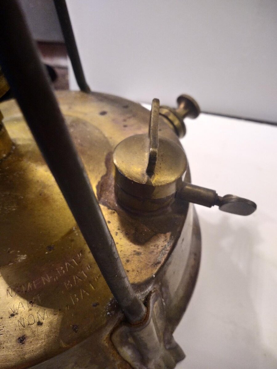

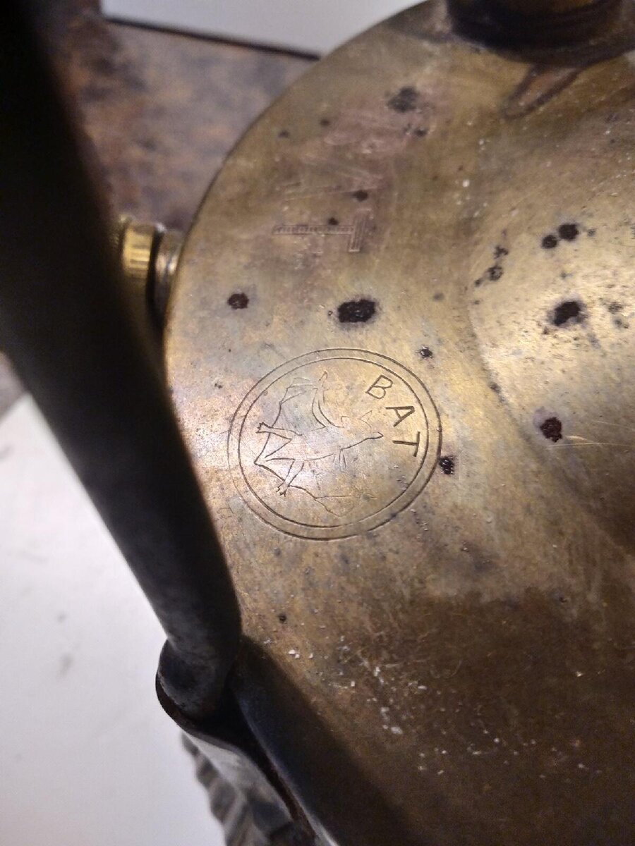

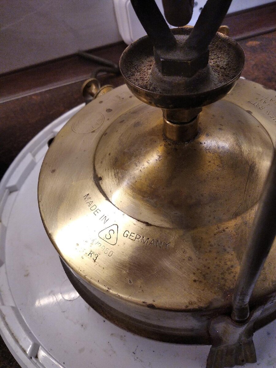

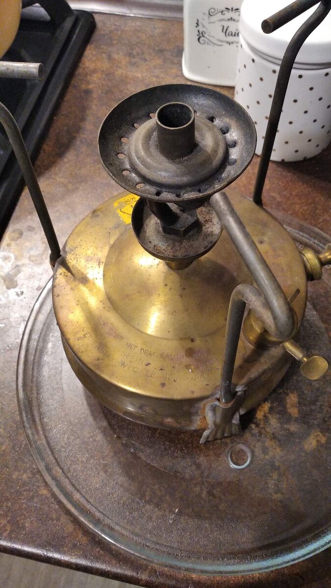

    This stove lives in Belarus and was made in Germany. Maybe in the 1970s??
    Bat Full 1.jpg Bat Full 2.jpg Bat Full 3.jpg Bat Burner 1.jpg Bat Burner 3.jpg Bat Burner 5.jpg Bat Burner 6.jpg Bat Burner 8.jpg Bat Burner.jpg Bat Details 1.jpg Bat Details 2.jpg Bat Details 4.jpg Bat Details 5.jpg Bat Details 7.jpg Bat Details 8.jpg Bat Details 9.jpg Bat Details 10.jpg Bat Details 12.jpg Bat Details 13.jpg Bat Details 14.jpg Bat Details 15.jpg Bat Details 16.jpg Bat Details 17.jpg Bat Details 18.jpg Bat Feet 1.jpg Bat Feet 2.jpg Bat Feet 3.jpg Bat Feet 4.jpg

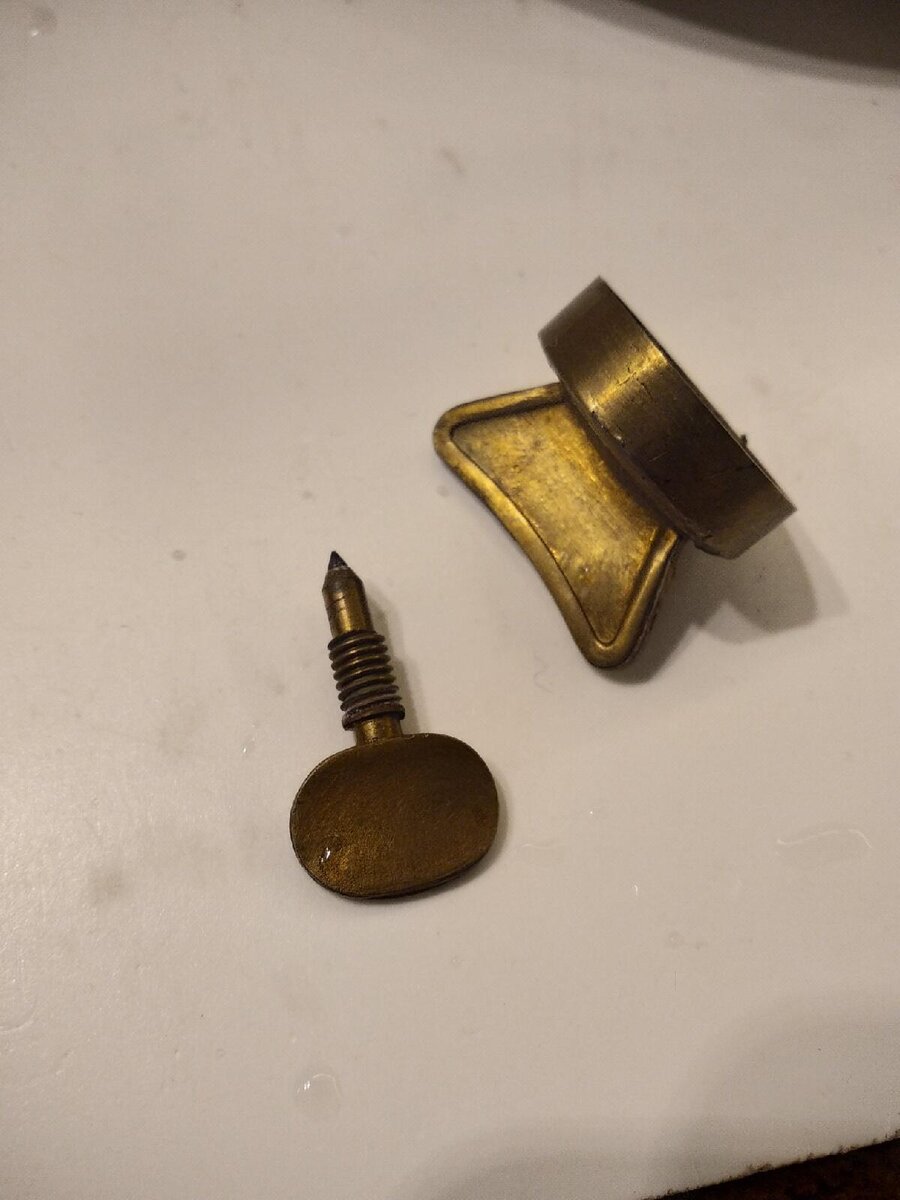

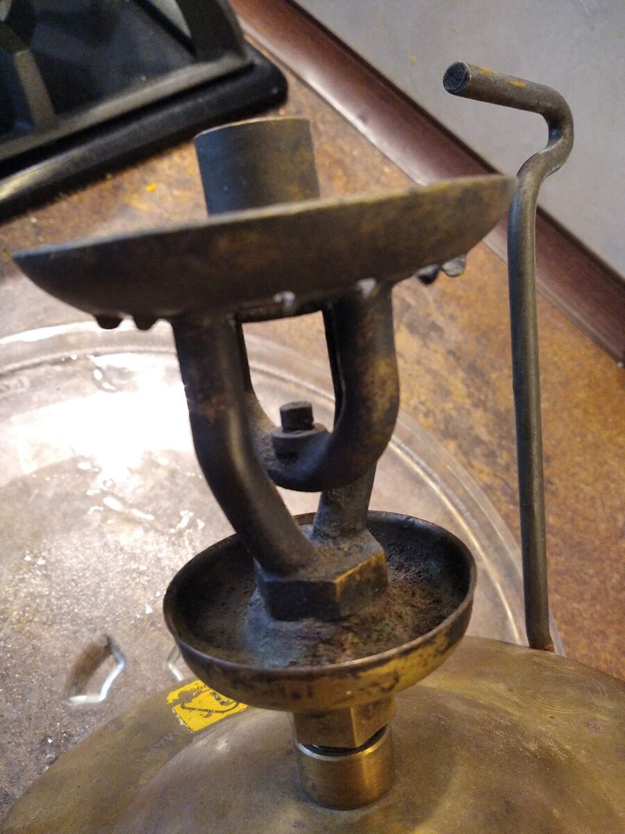

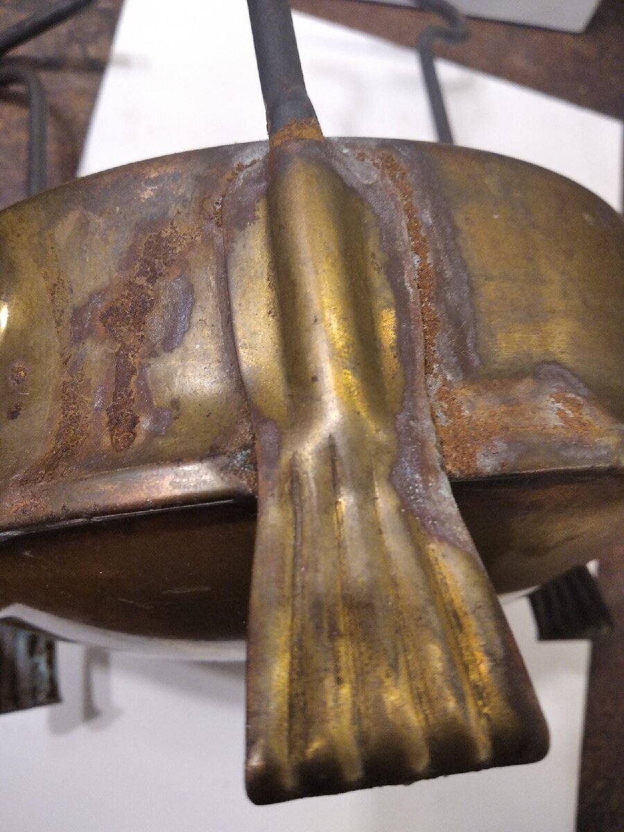

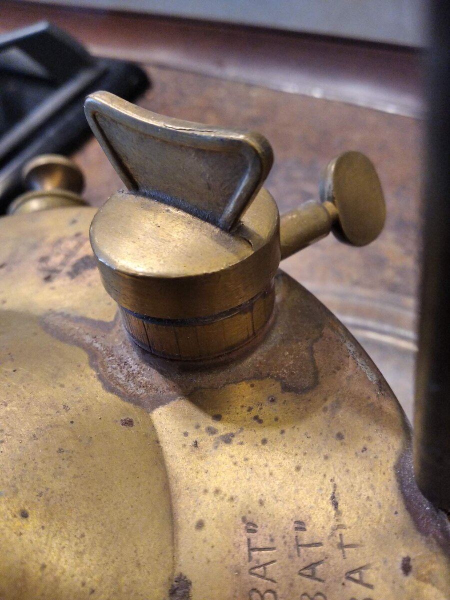

    How to clean the rust off the inside of the legs?

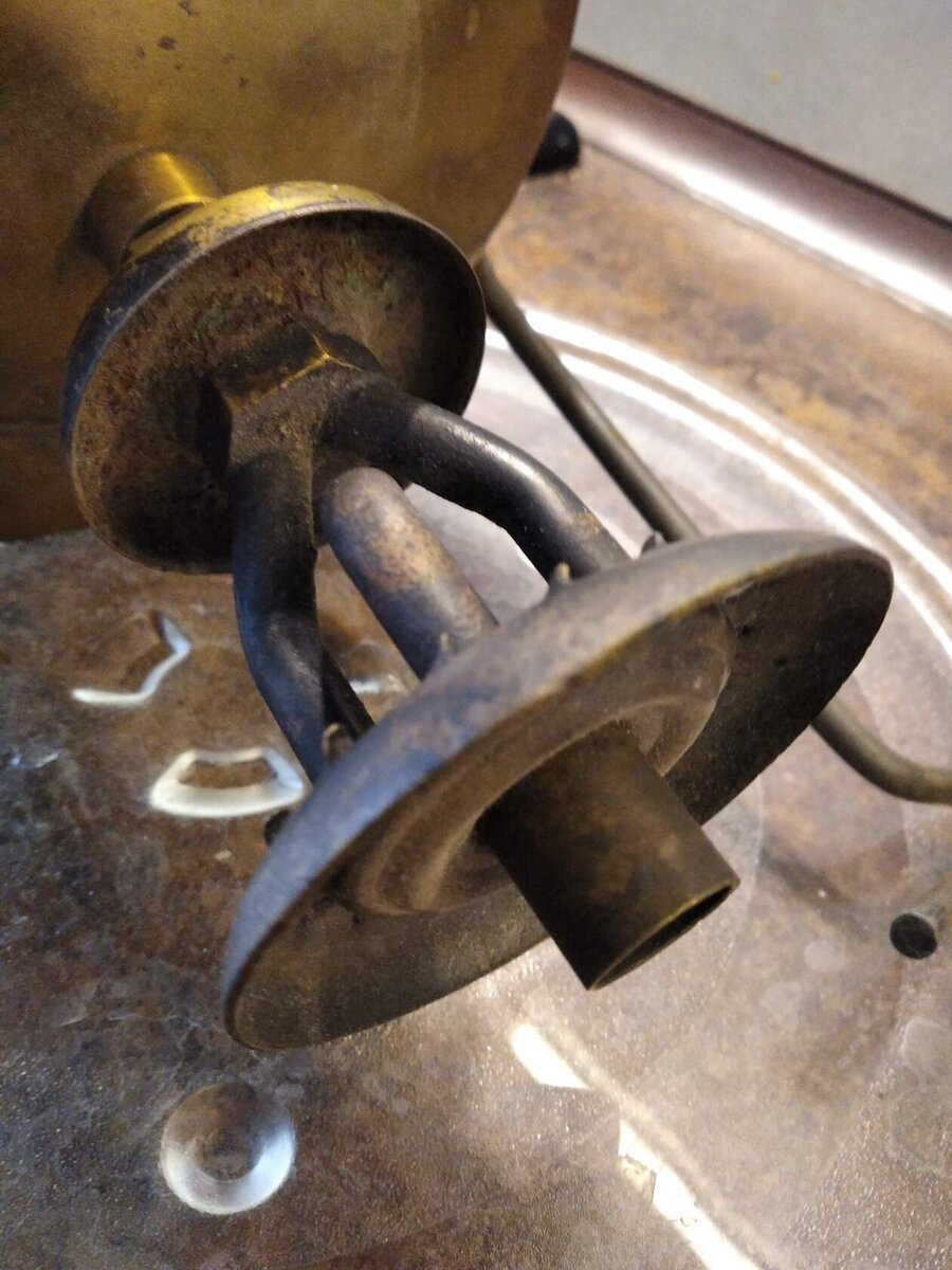

    How to clean the rust inside the burner port screw threads on the top of the tank...?

    The current owner says "My guess is that it may have been brought from Germany, in 1959, where my father served from 1954 to 1959."

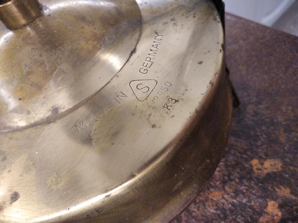

    I believe the model number is K3.

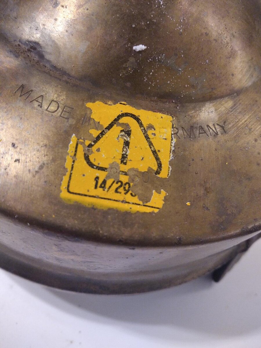

    The stamping under the yellow helps to date the stove .
    Evapo-rust will remove the rust but I'm not sure if it will remove the brass plating.

    the number under the yellow is 4/2950

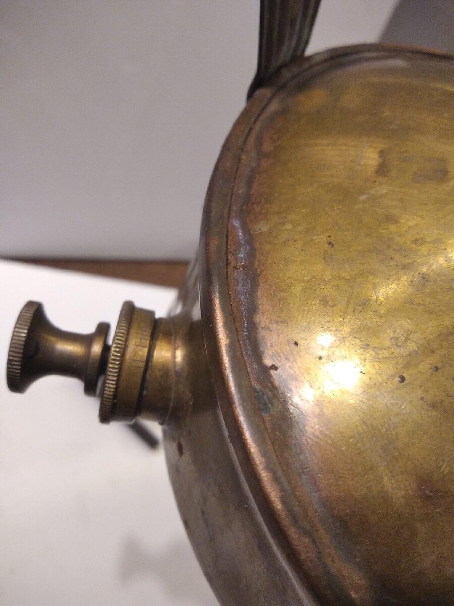

    The tank is magnetic, therefore brass coated steel??
  8. ROBBO55
    2,663
    @Neil Humphris
    Brass plated steel is quite common.
    The way I read the sticker details the stove was manufactured between 1956 and 1960. This date ties in with the family history of being in Germany between 1954 to 1959. So we can narrow the date down to 1956 - 59

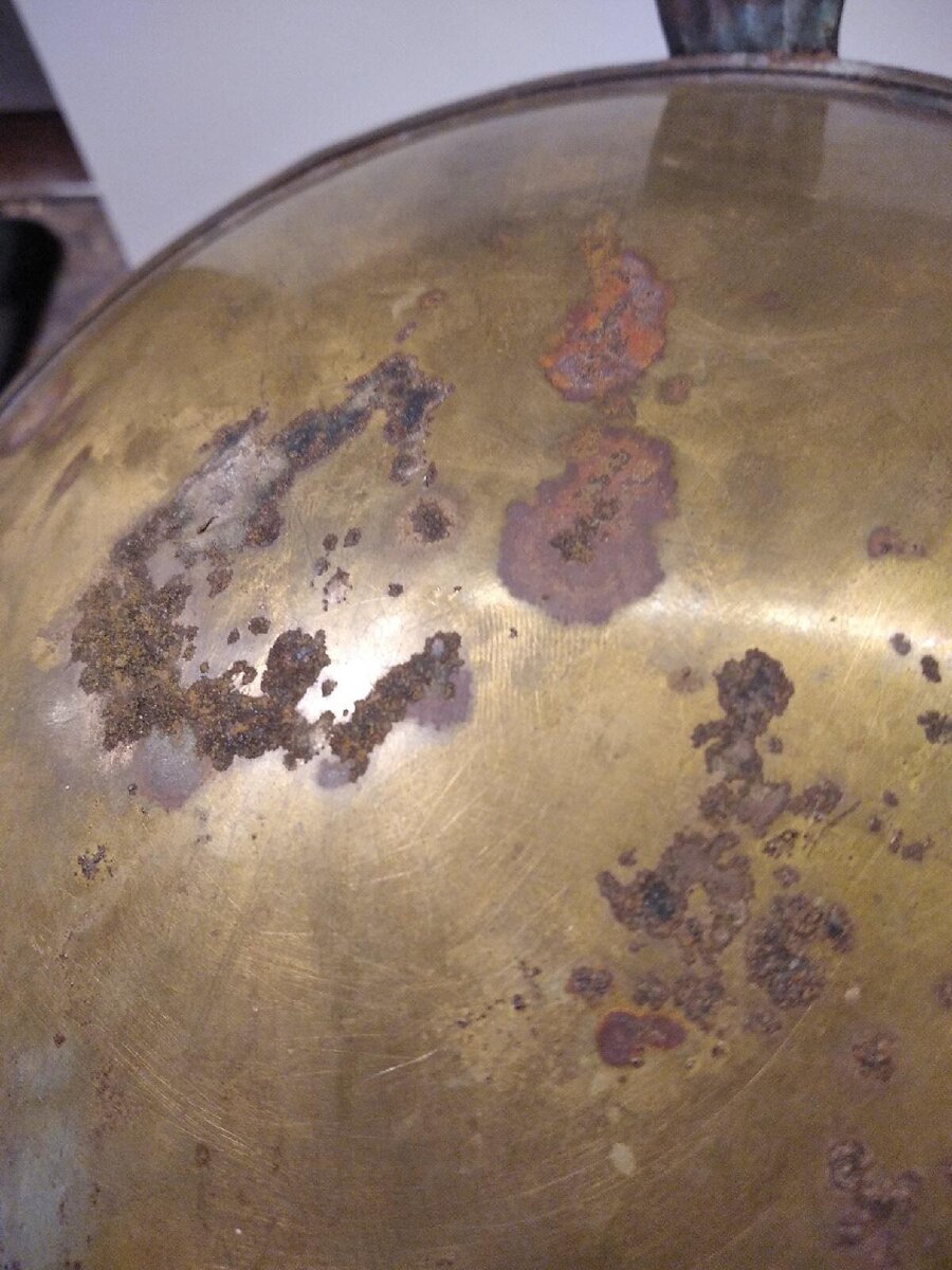

    В результате частичной очистки дна резервуара я удалил часть ржавчины с помощью химических средств.As a result of partial cleaning of the bottom of the tank, I removed some of the rust using chemical agents, as a result of which it turned out that the bottom of the tank is a puff cake made of steel and brass Metal, I'll attach a photo now, I can someone advise on how to fill the recess in the tank.
  13. Евгений Шаповалов Belarus
    Jan 30, 2021
    9
    Gomel, Belarus
    Есть еще следы ржавчины, что я старThere are still traces of rust, which I will try to remove at a later time. Thank you for the attention of everyone to whom my answer reaches, which I doubt a little.

    The yellow triangle with "1" was a quality class sign in the GDR meaning: "Standard class, suitable for the world market".
    The triangle with "S" meant "Sonderklasse", a first class label mainly used for export products. The "S" was in use until September 1960 and then replaced by a non triangle sign with the Letter "Q" with inscripted "1".
    There was also a triangle with "2" for lower quality products (used until 1970)
    It seems that your stove had been downgraded from S to 1. Produced for export, but later (1960) labeled for the home market, maybe because of the steel tank. There are also some BAT stoves with brass tank and steel bottom, I own one. They need special care because they tend to rust from insinde to the outside.
    Keep it as a shelf queen, there are not so many BAT stoves with paws feet!
