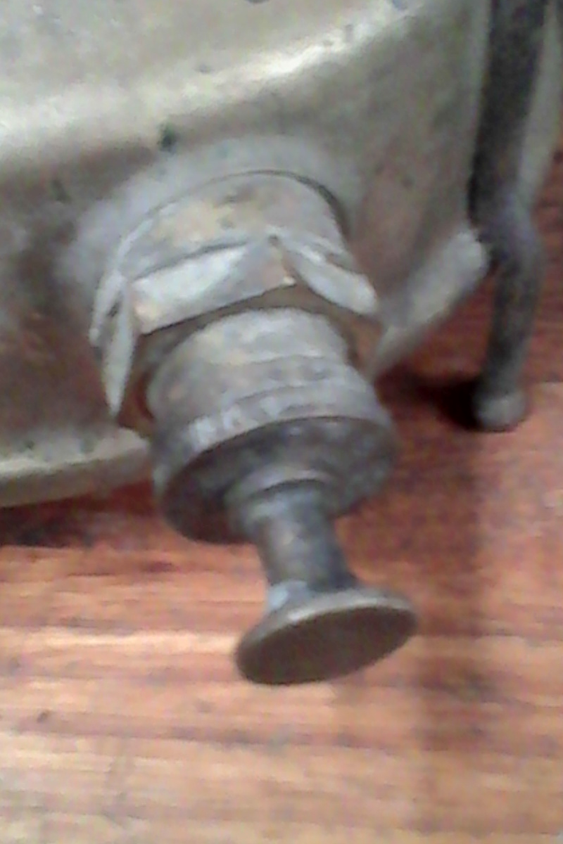

    To be thorough (!) this is the filler cap/SRV dismantled.
