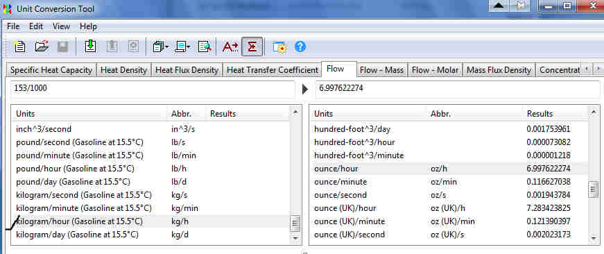

    I bought a BRS-12 on Eport. It cost $65 including shipping! LI's pictures are better than the ones I can take, but I would add that I think he was burning Kero as with Coleman it's a nice blue with the slightest hint of orange only at the tips. The box arrived is "not so great" condition but the stove was unharmed. Oddly they mention the spec's for Kero in BTU and Coleman in Kcal - my unit conversion tool image might help..... As a first impression - the pump is actually comfortable to use, no more mashed knuckles! It's very light, and the simmer control works well. I have only used it with Coleman fuel. An interesting tip on the box is to blow out the flame just as it's about to go out? Perhaps that helps to keep the soot down? Looks like an asbestos pad is used for priming and it holds A LOT of spirits. I use about 1/4 of an ounce and it seems happy. More when I learn more. Excuse poor pic of the round carry case, it's a simple nylon round case with a zipper on top, stove and tool fit inside.

    Two more tables will help with the somewhat unusual units used 1289874938-brs-12-capacity.jpg 1289874980-brs-12-FuelUsage.jpg

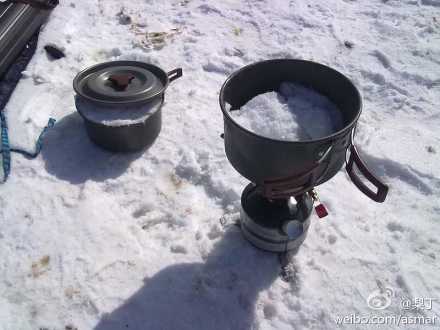

    1334057648-66a578b5jw1dqs7ptt7ioj.jpg 1334057648-66a578b5jw1dqs7ptt7ioj.jpg 1334057673-66a578b5jw1dqs7t9y4i4j.jpg 1334057687-66a578b5jw1dqs7hban55j.jpg
    cold environments works well

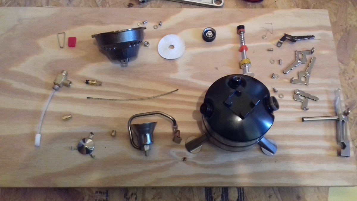

  17. Rickybob United Kingdom Banned
    Mar 25, 2015
    860
    breaks down very easily
    supplied with one jet it is claimed to burn kerosene or gasoline - no shaker widget under the jet but there might be room to fit one
    no coleman style self prime on this - just a simple fuel pick up with an msr looking filter and a needle valve with 2 o rings
    a thin cleaning wire in the generator and a primus looking burner bell
    bulin looking pump
    but what of the nrv?
