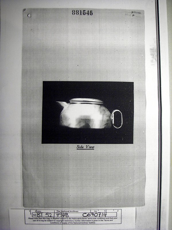

    Handsome-looking kettle, British manufacture so maximum capacity in Imperial Pints is 1 3/4, or the equivalent of the 1-litre Primus Litech I've pictured it with
    The Registered Design number on the base checks out as a 1956 registration - it's a case of identifying the date year by consulting a table such as this one:- http://www.925-1000.com/registry.html
    I applied to the National Archive for a copy of the Registered Design for the kettle, stumped up the princely sum of £4-something (including postage) and got a couple of photocopies back showing contemporary photographs of the prototype kettle. There was no accompanying text, which disappointed me a little, since I'd have liked to have read the designer's reasoning for putting the (uninsulated) folding wire handles outboard - they get scorching hot in use (the Bull Dog bites) and the offset weight of a kettle full of water makes it difficult to lift the kettle.
    The barrel distortion on the prints is down to my camera and not the copying process
    Posing the production model kettle to reproduce the perspectives the prototype was photographed by clearly shows a more curved shape on the prototype and differences in the detailing, primarily the handle shape and fixing arrangement
    In use it's wholly impractical. I've even tried some silicone sleeving on the handles and the silicone scorches at the ends nearest the flame - even with the moderate flame spread of the Primus 96. Simply, the handle's too low down and near the flame
    Curious design dead-end.
