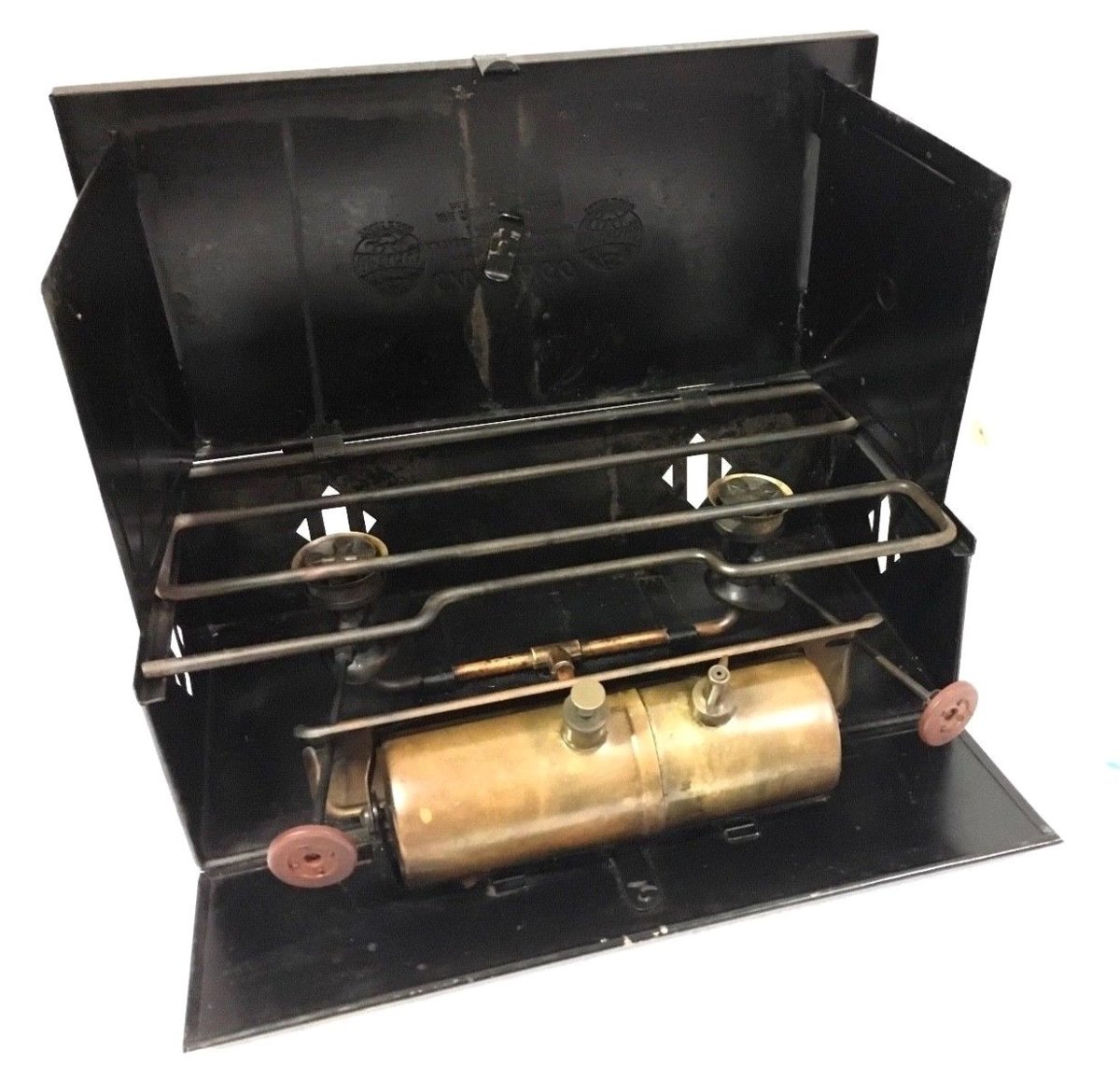

    For a 80+ year old stove this unit was in very good condition and complete.
    The box had little rust, no dents and no damage. The black paint was done by a previous owner and although it was uneven, it did protect the steel from the elements.

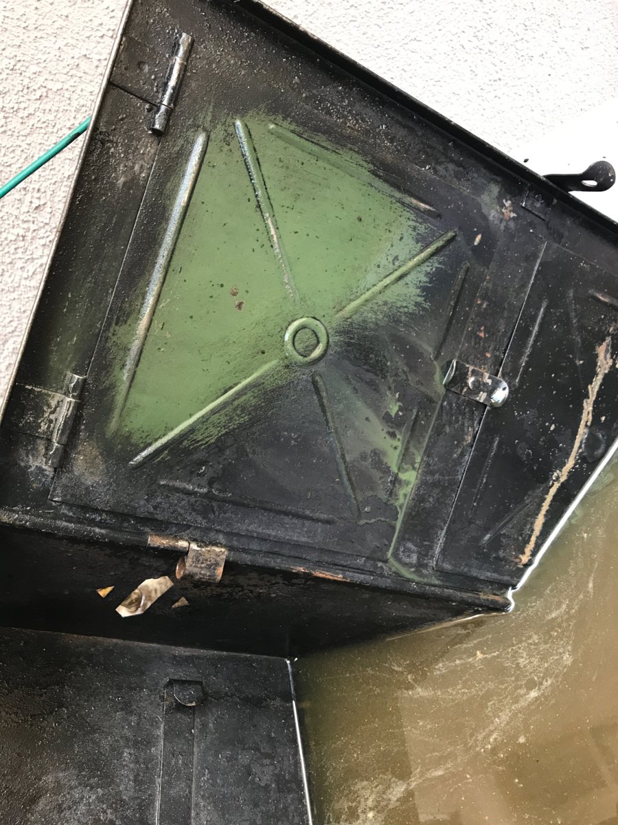

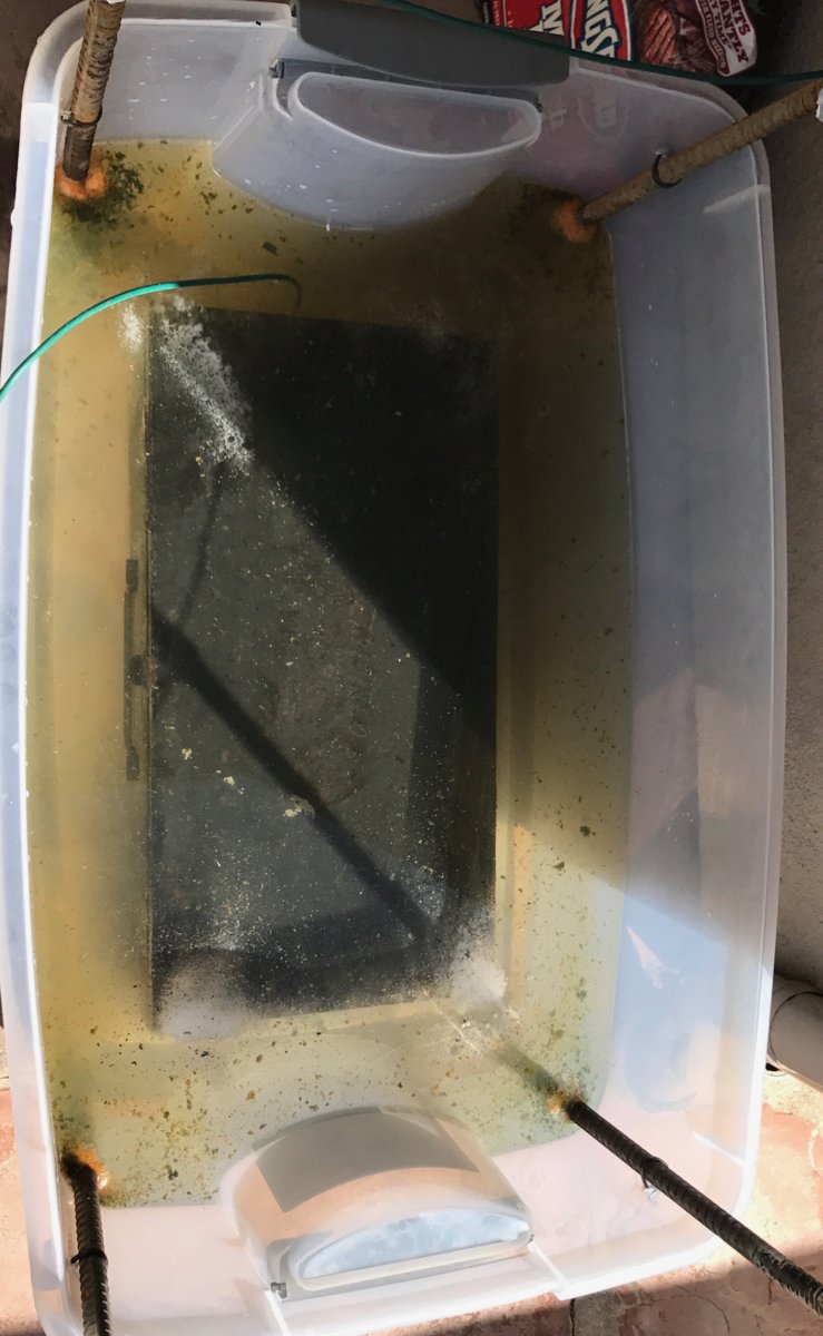

    A full day of electrolysis...
    The original color shows thru with the work of a stiff plastic brush.

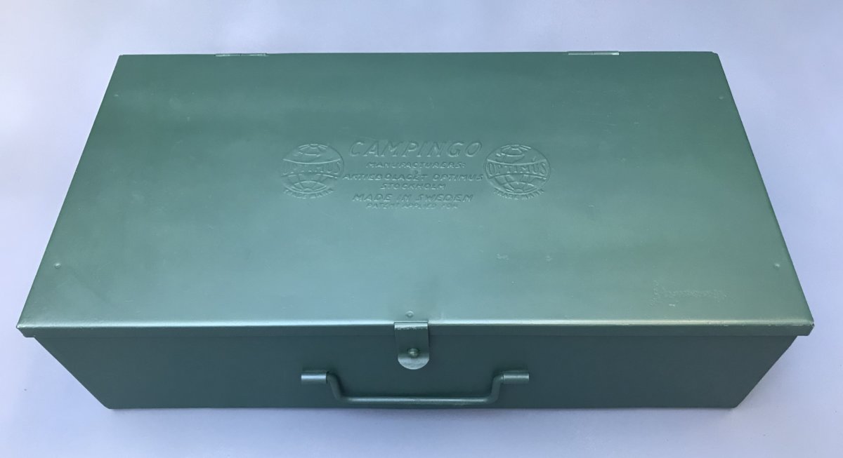

    I went with a different tone of green.

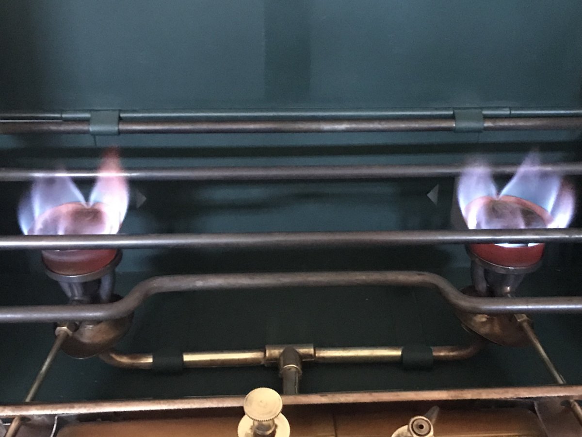

    The stove ran well with some typical fettling. Special thanks to John aka @threedots for helping me boost the burners performance. I tried running them without the rolled up brass mesh inside as I am running it on Coleman fuel. This created a "whooshing" every few seconds as the empty air space created wasn't being properly baffled. Once I cleaned the mesh and reinserted it, the stove now runs beautifully. Hot, loud and blue!

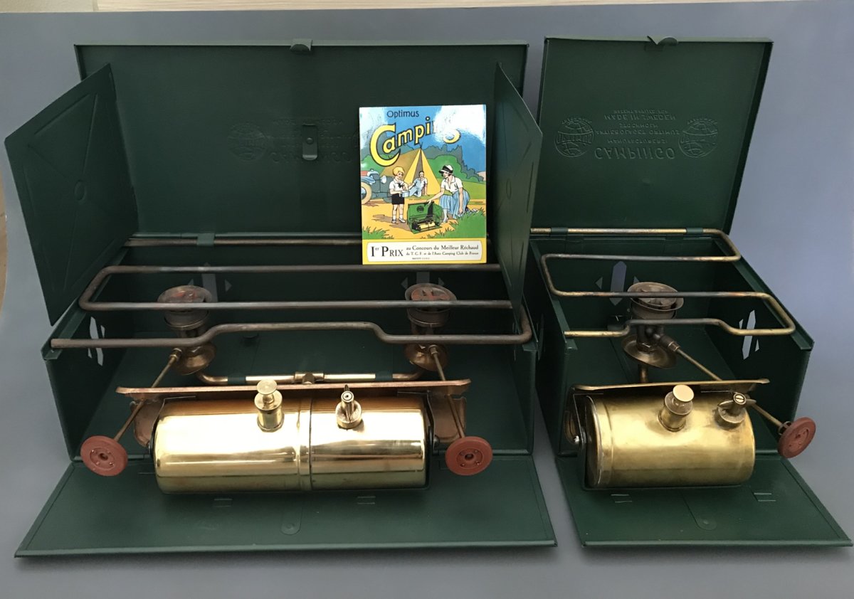

    Working on this stove was pretty straight forward. New seals, new pump leather, de-coking the burners, cleaning, polishing, stripping and repainting the case. Everything on these Campingos is more robust than later box stoves which make them a pleasure to work on.

    Really happy with this stove and to unite it with it's long lost and less shiny little bother.

    Hello Jerry.
    Nice restoration of 2 older model Campingos. They are I believe the second generation so hang onto them.
    The next type have the smaller control knobs and the different fuel cap with the smaller safety release valve like the earlier embossed Optimus 111s have.
