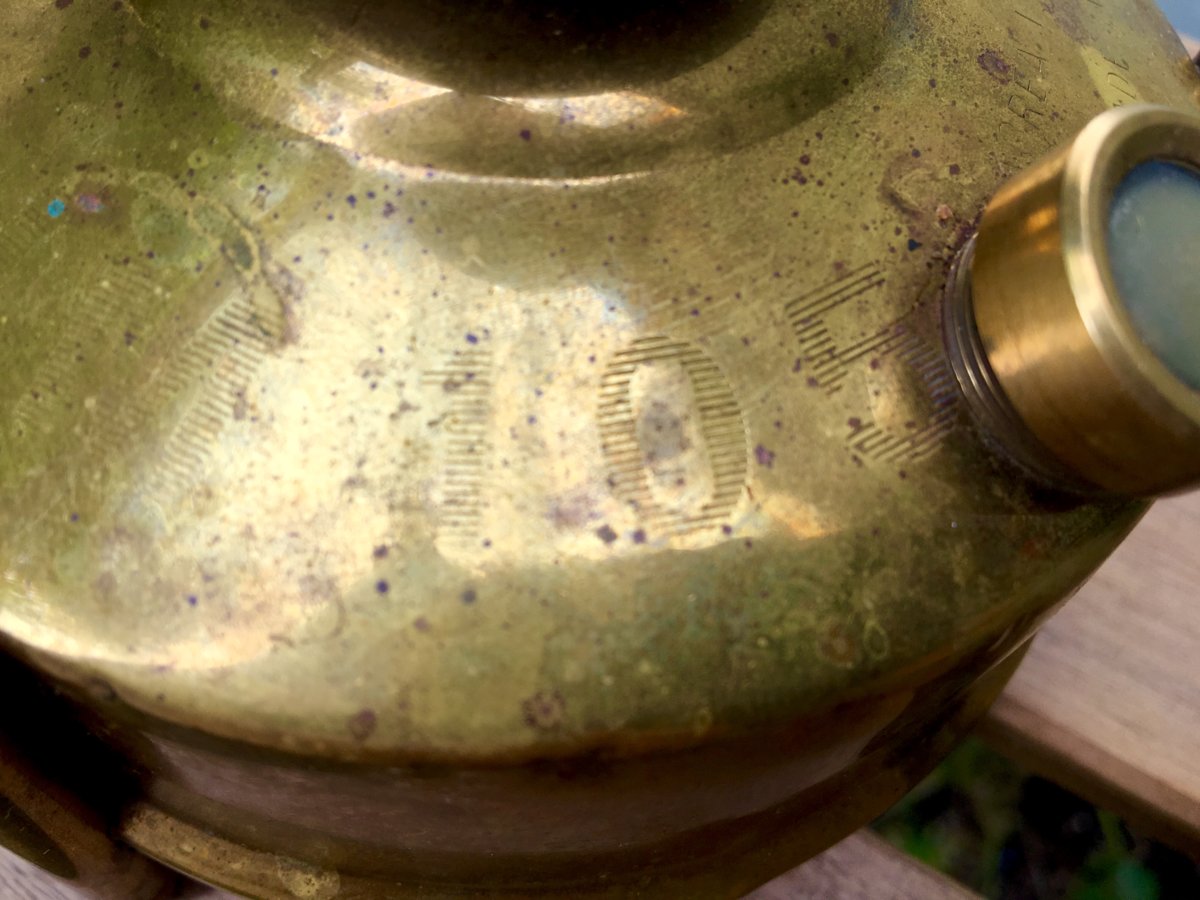

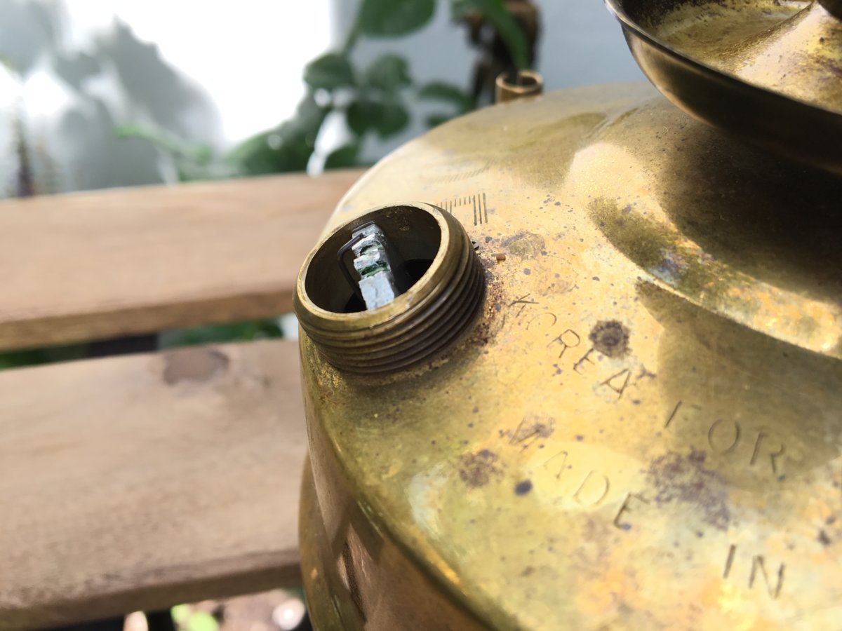

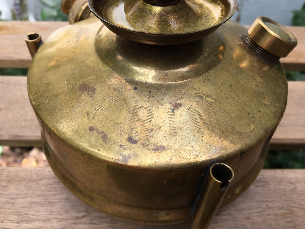

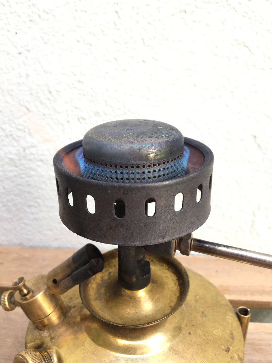

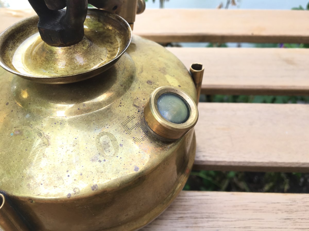

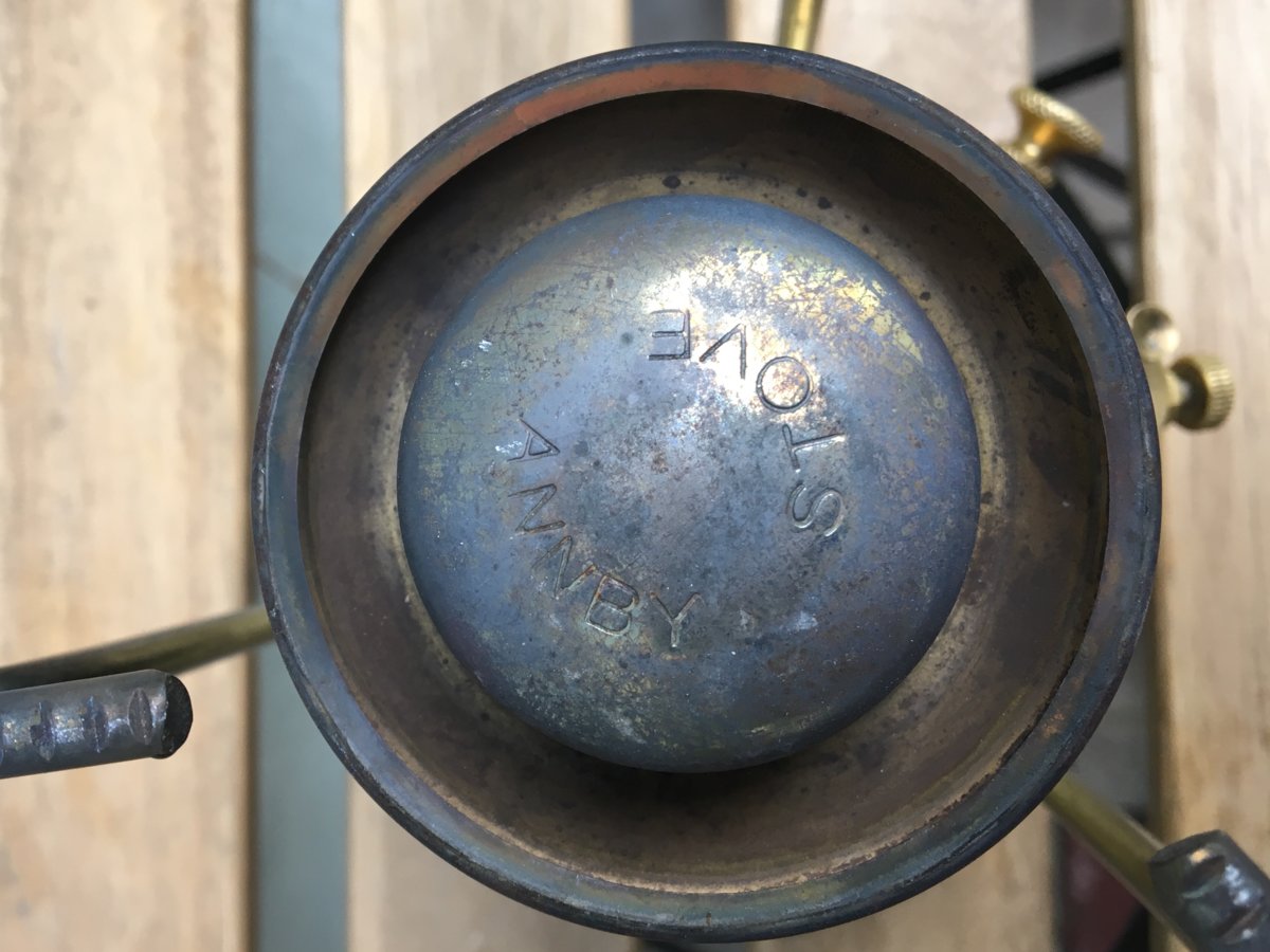

    I have found this little paraffin stove in a goodwill store and fell in love with it, and its nifty construction.
    It only came with what’s on the photos. So only the silent burner head.
    It has about a half pint/liter tank, a jet cleaner, a preheater, and a fuel gauge.
    Unfortunately the little plastic fuel window has gone opaque, probably because it’s previous owner put petrol in it. But after a good cleaning and some restoration it burns beautifully.

    You may be able to polish out the opaqueness of the fuel level meter using a fine plastic polishing compound/wax with a small buffer disc on say a dremel or an electric drill.
    Be careful though with the revs as too fast can create excessive heat that may distort the plastic.
