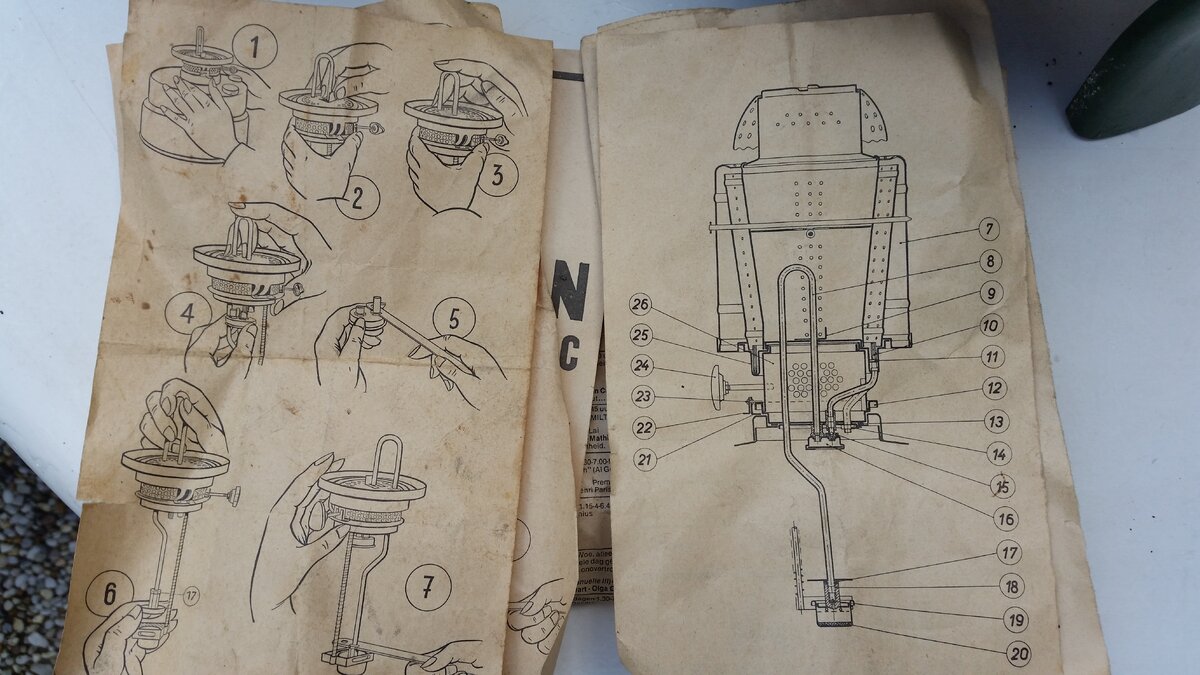

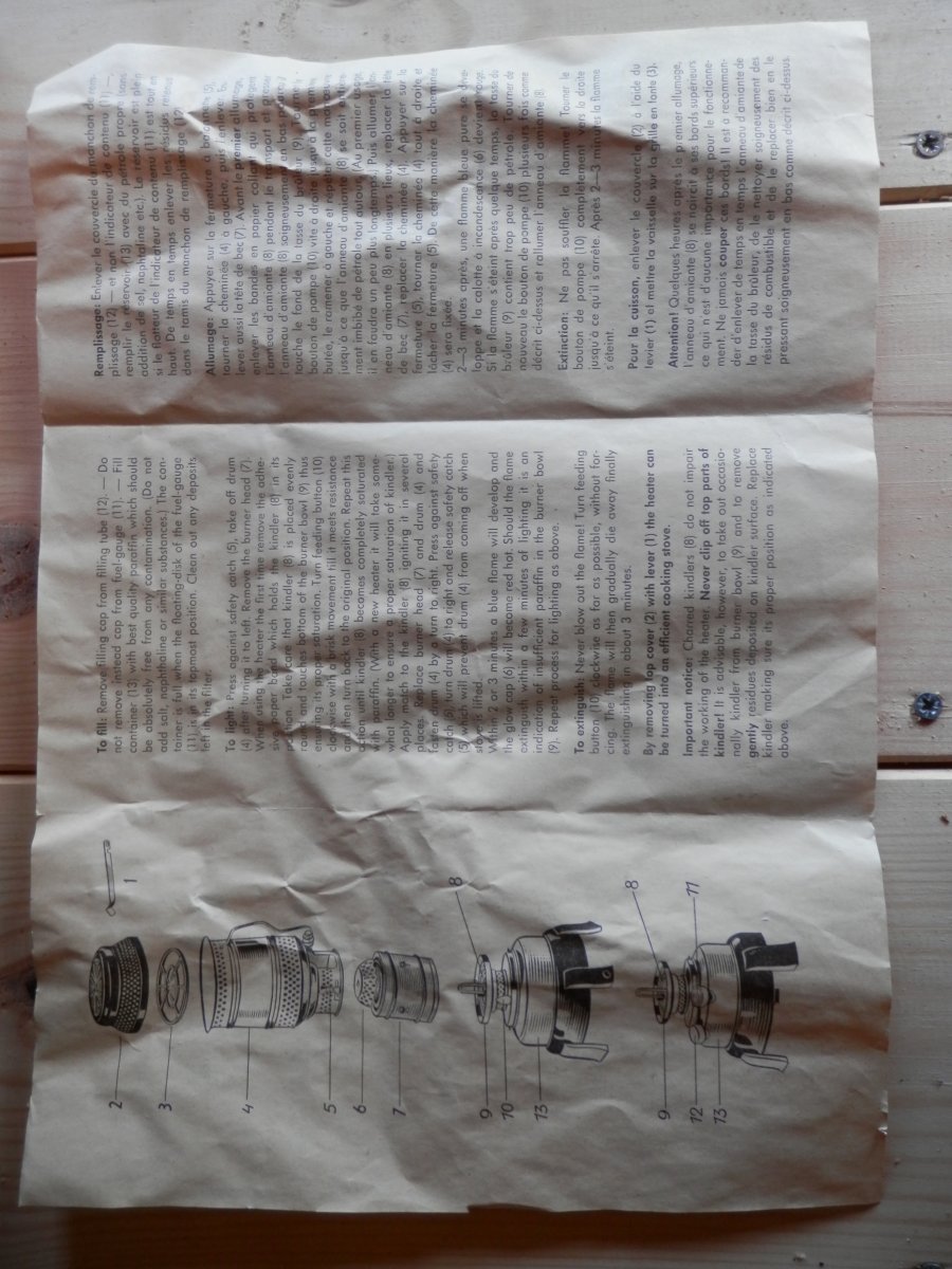

Somehow, I managed to "lose" a photo, never mind it only showed a spare "wick", clearly showing the word "amiante" which is french for asbestos. The heater/stove is now warming up the shed, the fount takes 3.5liters of paraffin. I have no idea at all what the consumption per hour is. Only drawbacks in my humble opinion; one can't regulate the heat output, and you have to more or less dismantle the heater/stove to light/extinguish it. The fine lady I bought it from found this in an old building that once was a shop. To sad she only kept/saved from the landfill one out of approx. 20 (TWENTY!!!) of these found in there! All brand new........ All the best, Wim
@Wim A great find. 19 went to land-fill! Arghhhh! Good to see those instructions and that hood lifting tool. You're right about the lack of regulation of course and that the chimney has to be removed to light the stove, but extinguishing is a simple matter of turning the igniter primer knob through 90% and the flame goes out afte a while (3 minutes the instructions say). Thanks to the instructions, I know now that the igniter wick is called a 'kindler'. Nice word for it. Thanks Wim! John
Hello Wim I must confess, the start of your post did not promise interesting news. But then: WHOA !!! Congratulations! The first time I see a Instruction leaflet, the great illustrated packing box and a dated document from a Demon. And now, I have read the name "SUPERAUTOMATIC" on the package! I am still suspicious to overlook something of the construction of this great stove. Thank you for sharing. Best Regards Radler PS. The picture of the new spare wick and its dimension would be of high interest for those who want to replace the old wick with a selfmade non-asbestos wick.

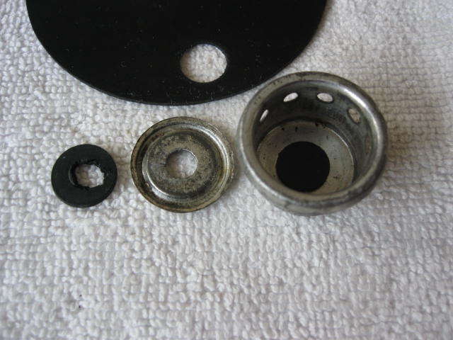

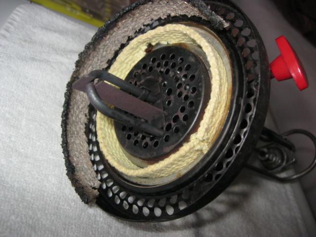

I have made new wick.Stove run better and silentely. Material of new wick is " 25 mm Aramid Wick " ,cut lenght about 25 cm. It's 60''' stove,wick diametre is 75 mm. D.

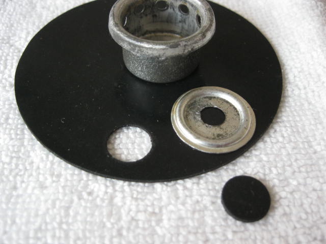

My stove will not going off.I broke old hard seal out and made new. I have not 12 mm ,only 10 mm tool,but it's enought.Th. 1mm. D.

@redcurrantjelly Welcome to CCS and glad what I featured gave some insight into what you have with your Ditmar. I don’t know of a source for spares but if you were to post up some photos of your collection of parts it would be a start to establish what’s needed to get it running. The ‘kindler’ wick needn’t be asbestos and a modern heat-proof fibreglass tape would serve. Contributor Dusan in his post above made one out of what he calls ‘Aramid’. Not sure what that is, but it looks like a sort of wood stove door sealing tape. John

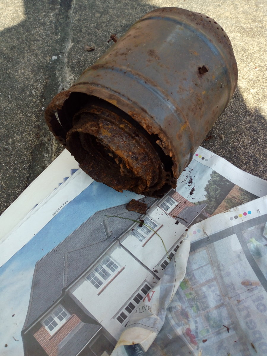

@presscall Thank you for your replies. Just posted a few pictures of my Ditmar heater. It is really in a poor state. Any advice on what is the best solution apart from throwing it away? I really hope not to have to come to that as it is so beautiful in its own way. I have started sanding it down, but even the paraffin tank is corroded and has wholes in. Many thanks.
I wouldn’t argue with you there, unfortunately! Holes in a steel fuel tank where paraffin’s the fuel can be patched (depending on the extent of the rust) with lead-soldered patches. In a petrol-fuelled pressure appliance there’s more at stake if the repaired tank continues to be porous. The worst aspect is the burner component made up of concentric tubes. That’s a tough one. Lead-soldered patches wouldn’t cope with the heat and any repairs would have to be silbrazed, which isn’t any more difficult but requires the right (MAPP) blowtorch. Fabricating any mending patches after cutting back the worst of the rusted metal would call for some skill, which perhaps you have. With the fuel tank patched the stove might work even with the burner in that state. Worth a try. John

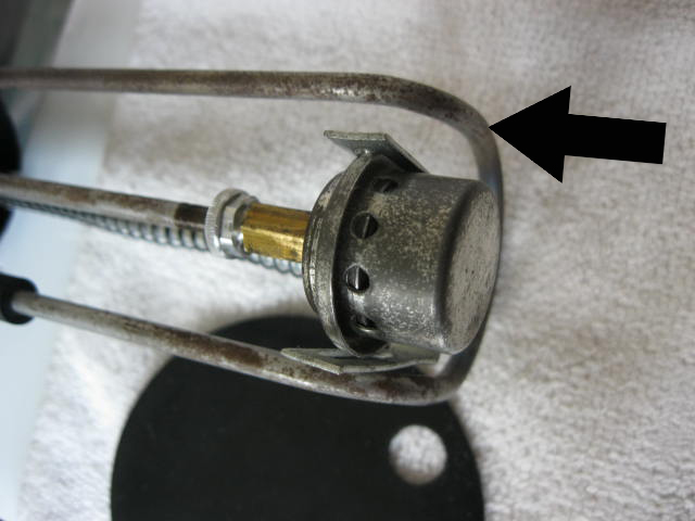

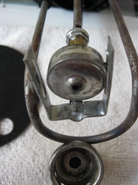

Good afternoon from the Netherlands, I got this Ditmar Demon but I do not understand how it pumps up the parafine. In the pictures shown there is al metal what I miss. I put a arow on the picture. Can you help?
@Peter Bevers I suggest you scroll back to the start of the thread and read my original post, combined with the photos. Only a priming charge of fuel is pumped to the wick trough by flipping the control knob a few times. Once lit and when the burner’s heated up sufficiently a thermo-syphon action feeds to fuel continuously to the burner until the control knob is rotated again, which halts the process - switches it off.
Good afternoon Prescall This one looks like there is never been a flame inside. I did read your post but I never had such a thing before so I really do not know how it is supposed to work. I think this one does not need what’s on your picture in the compartment what’s in the fuel , it is not in the papers that I have. Do you think I is supposed to work with the parts you see is on the pictures? I first need to order a new wick and try to get it burning. Thank you very much Peter
It looks complete and you’ve got the instructions for use, including a sectional drawing of the burner. The wick is essential to enable the fuel in the wick trough to burn freely and cleanly during priming. A ‘starter’ wick it’s sometimes called in equivalent AGA stove burners. John
