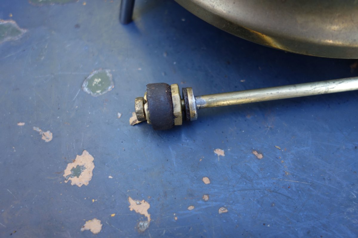

  8. pivo
    Jun 29, 2011
    20
    Thank you all for sharing your knowledge and information!
    I still add one more photo... The shape of pump leather cup assembly system doesn't include any hexagonal nut. These all are round - my almost similar, but a little bit younger No.1 stove I mentioned earlier, has hexagonal large rear nut and similar hexagonal small nut on the tip of the shaft.
    Parts were not jammed (that's one thing I was afraid of), so leather cup replacement won't be a big problem.
