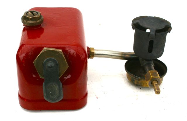

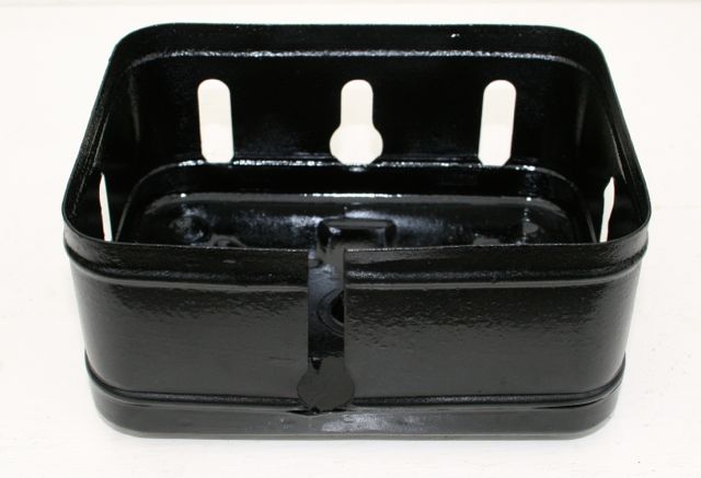

    The tin was pretty rusty so I used Hammerite rust converter before repainting it with black "VHT" brand engine paint baked at 94C:
    The tank was repainted with VHT calliper enamel and clear coat and baked.

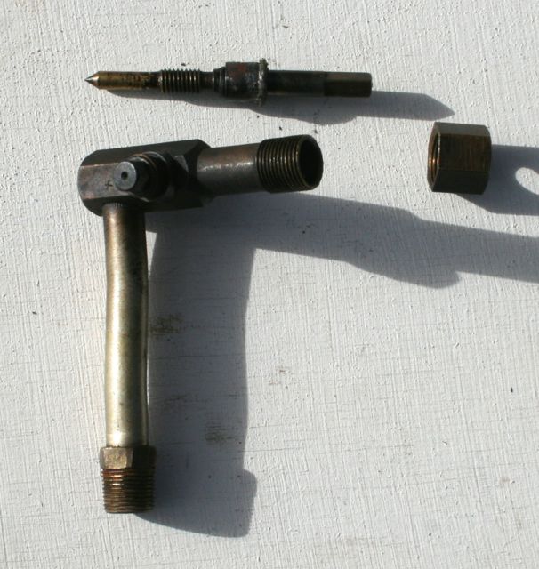

    The bits:

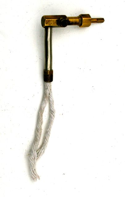

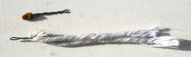

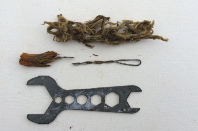

    (I replaced the wick)

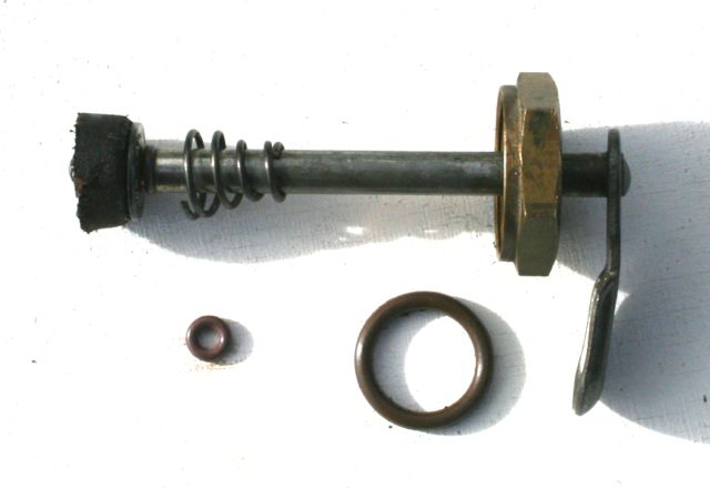

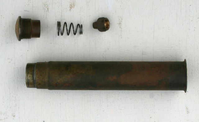

    The hardest bit was getting the NRV cap off, and then finding the spring was so hard it would not pump. I replaced the spring with a Tilley NRV spring and used a viton pip supplied by The Fettle Box in the pip-holder:

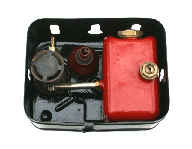

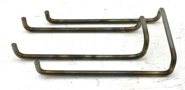

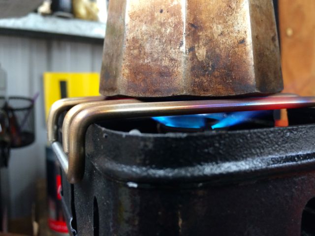

    It did not come with a pot support so I made two from 3/16" stainless steel - a small and large one:
    And here it is packed:

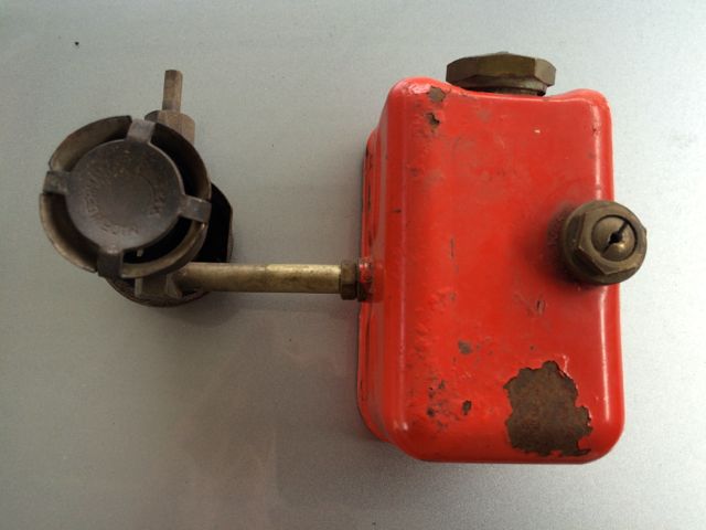

    As it came:

    I love how you settled the pot rests....very clever. :thumbup:

    Excellent photos of your fettle. They have given me confidence to undertake a wick replacement on my 9063. I've replaced all the pips and seals on the stove that I can. The only thing left to replace is the wick. Hopefully that will sort out the problem of a less than robust burn. Nice work Tony!

    The wick was easy. What was hard was unsealing the fuel line from the tank. I am very reluctant to force brass joints. This one was stuck hard, so I sat the whole tank and fuel line in 50:50 acetone and ATF for a few days. It came apart quite easily after that.
    I used cotton mop for the wick.

    Nice pot rests!!! The Baby is still my favorite gasoline stove.

    Tony: thanks for the tip on softening up the main point of attack. My fear of taking on the fuel line/tank separation has helped me avoid the project. I'll give it a go in the next few weeks. Fingers crossed!

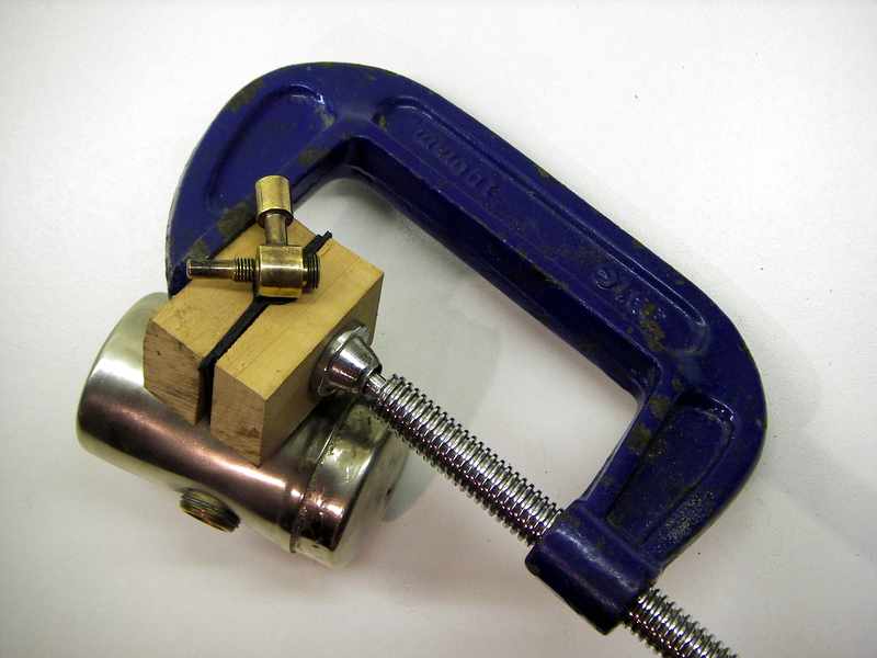

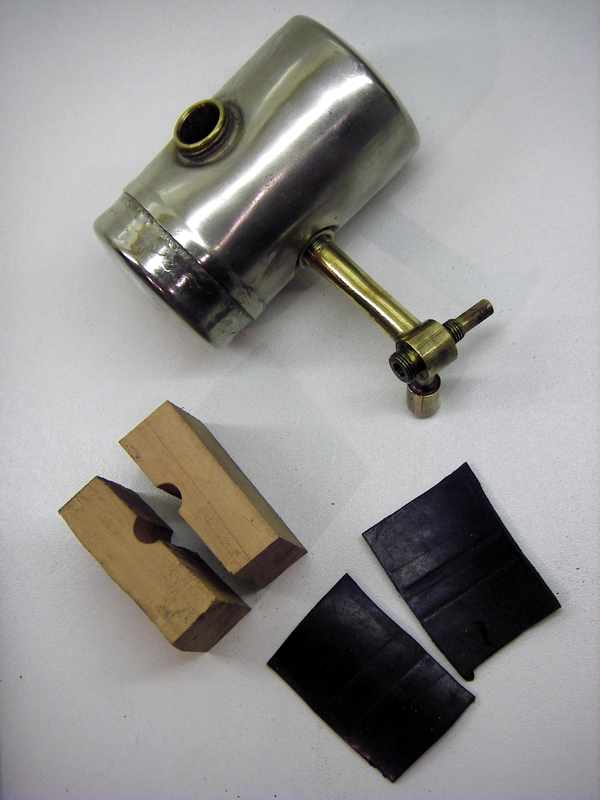

    Much better job you made of separating burner tube from tank than I achieved, Tony ... SURGERY
    Usually, the wooden block technique works
    Beautifully made pot rests.

    very nice fettle, love the pot supports idea!

    Having badly molested two Primus 71 nuts trying to remove them, I now take a very Zen approach to these kinds of joints:
    1. Soak in 50:50 acetone:ATF for three days
    2. Test and see whether a large spanner works without excessive force
    3. If that doesn't work, soak whole thing in Marine Clean at 60C inside an ultrasonic cleaner for a few hours.... That seems to work eventually. I think the ultrasonic cleaner manages to break down the seal formed by/in the joint.
    When I put these joints back together, I use copper grease.
    Xavi and Dave,
    I thought long and hard about the pot rests, and waited until I got everything back together and thought about how to fit homemade rests in the tin. Initially I was going to make two of the smaller rests, but after having made one and looking at it with the stove running, I decided the larger rest would be a much better idea.
    I did it using a vise, some heat from a propane torch, and by hand- bending the steel.
