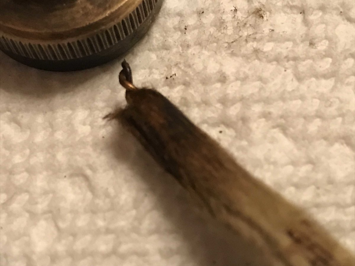

    The wick was in very sad shape, and was, quite literally, falling apart! It was charred pretty good, too. So, I'm really glad I took the time to check it thoroughly!

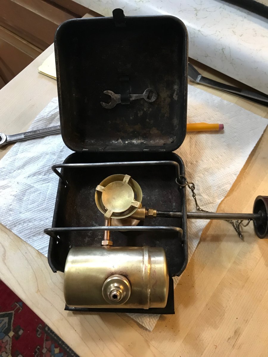

    And, here she is, assembled, once again, and ready for testing! By the way, I was told to leave the case as it was, because "it had earned it's stripes"!! OK, by me..... it is not my stove!!! So, I did as the owner asked.

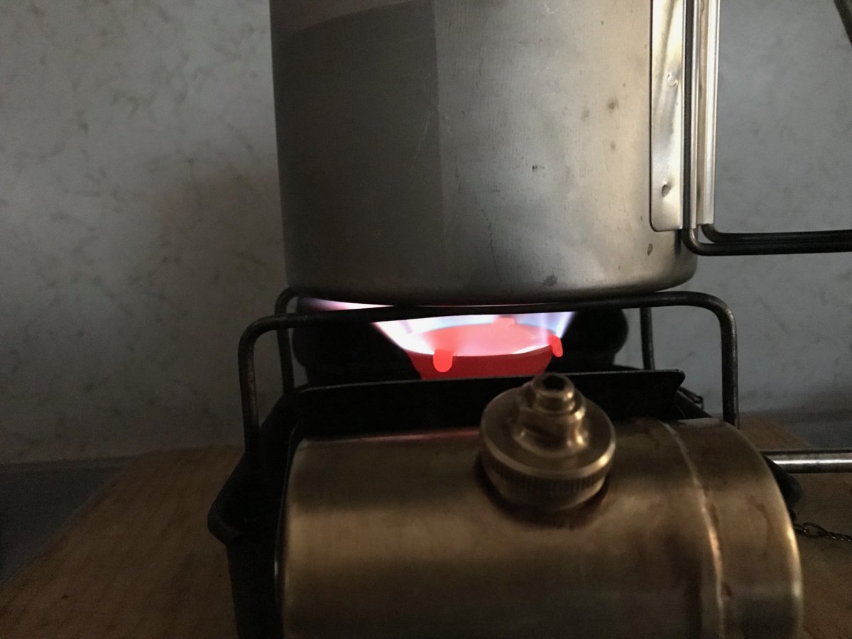

    I wonder how she will respond to my fettling? Let's see, shall we??? A good prime, with Meths, and here's what I was blessed to receive:
    Praise God, she works great!!! Thank you, Lord, for this success! I let her burn-in for a few minutes, then put an MSR Titan Kettle, half-filled with cold water, on the pot supports.
    I did not time this, but very soon, the little 8R offered up a very nice, rolling boil!
    The simmer is pretty good, but I want to much about with it, for a while, and see if I can get it better.
