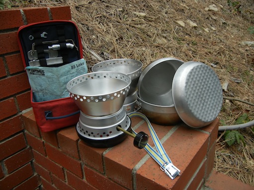

    First, the whole kit and caboodle.
    And, the basics, all ready to go.
    The tank is fine, size-wise, and with this outstanding powerhouse of a burner, I was in hopes that the Loke would soon be humming away, hotly!
    The windscreen, all setup with the extra pot supports, which are optional in use, but allow for using different pot sets than what came with the stove. Good idea, however, the windscreen and support are very thin aluminum, and bend VERY easily!! So, being careful is the way to go when installing and removing these extra pot supports. The windscreen is slightly out of round, so I decided to give the extra supports a go, and they worked perfectly.

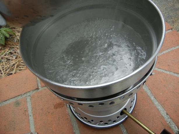

    With no problems whatsoever, the Loke 85 was quickly burning hot and blue, with no underburn! Just followed the directions, and it went like clockwork. :thumbup: :D
    Though I did not time the boil, the Loke soon had a lovely rolling boil going!
    Also, as we use our stoves to actually cook, and not just as water boilers, I had to check out the simmering capabilities of this powerful Loke 85. How's about this outstanding simmer!?!
    Oh, YEAH!! That simmer will work just fine, and it seemed very stable, too!

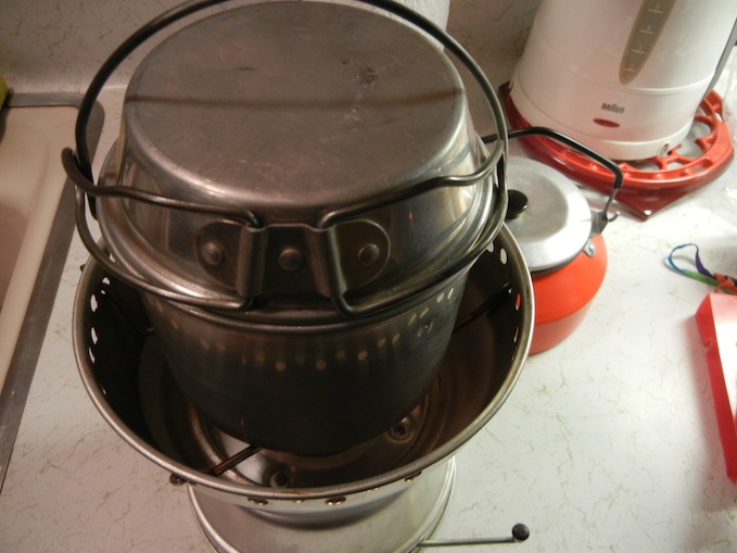

    Also, check THIS out! Note anything "interesting"?? How about TWO windscreens and pot supports!!
    For the sharp-eyed amongst you, the windscreen and pot support for the Optimus 91 Purple Flame, on the stove in that photo, also fits this stove!! The pots are slightly smaller than those from the Loke, but it "may" be another alternative, if smaller pots are wanted. Fun! However, there is a caveat which might keep me from using this setup.
    And, note the slight difference in the opening into which the burner fits and operates. First, the Loke screen, and then the Opti 91 version, which is tighter around the burner.
    Don't know if the difference in spacing is enough to cause a problem, so, at least for now, I'll hold off on testing the 91 setup. Here is the Loke with the proper sized pots, purloined from one of my three Optimus 81 Trapper stoves.
    And, the rest of the Loke's goodies:
    A quick comment on using the elastic straps to hold all the bits and bobs of this stove. It seems a good idea, in theory, but I'm not sure that in practice it will be very "practical". At first, I could not get the case to zip up with the packed inside it.
    However, the thought came into my mind that, if I simply turned the packed stove over, so the narrow part of the pot was on top, it might work, and VOILA, it worked perfectly!!
    Now, the zipper works much better, and I can see that, if one wishes to organize the small parts of this stove, and take the time to insert and remove them from the elastic, it should work nicely for them. Don't know what I'll do, in the field, but since my good friend Dag Ståle warned about the ease of loosing the pump, and possibly other small parts, maybe using the elastic is a good idea, afterall!
