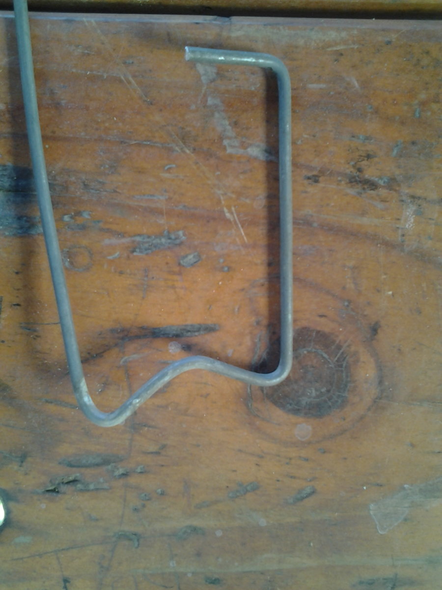

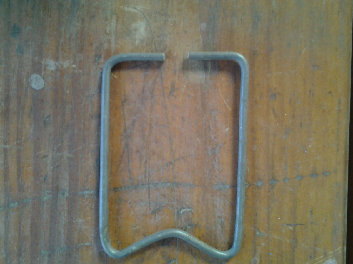

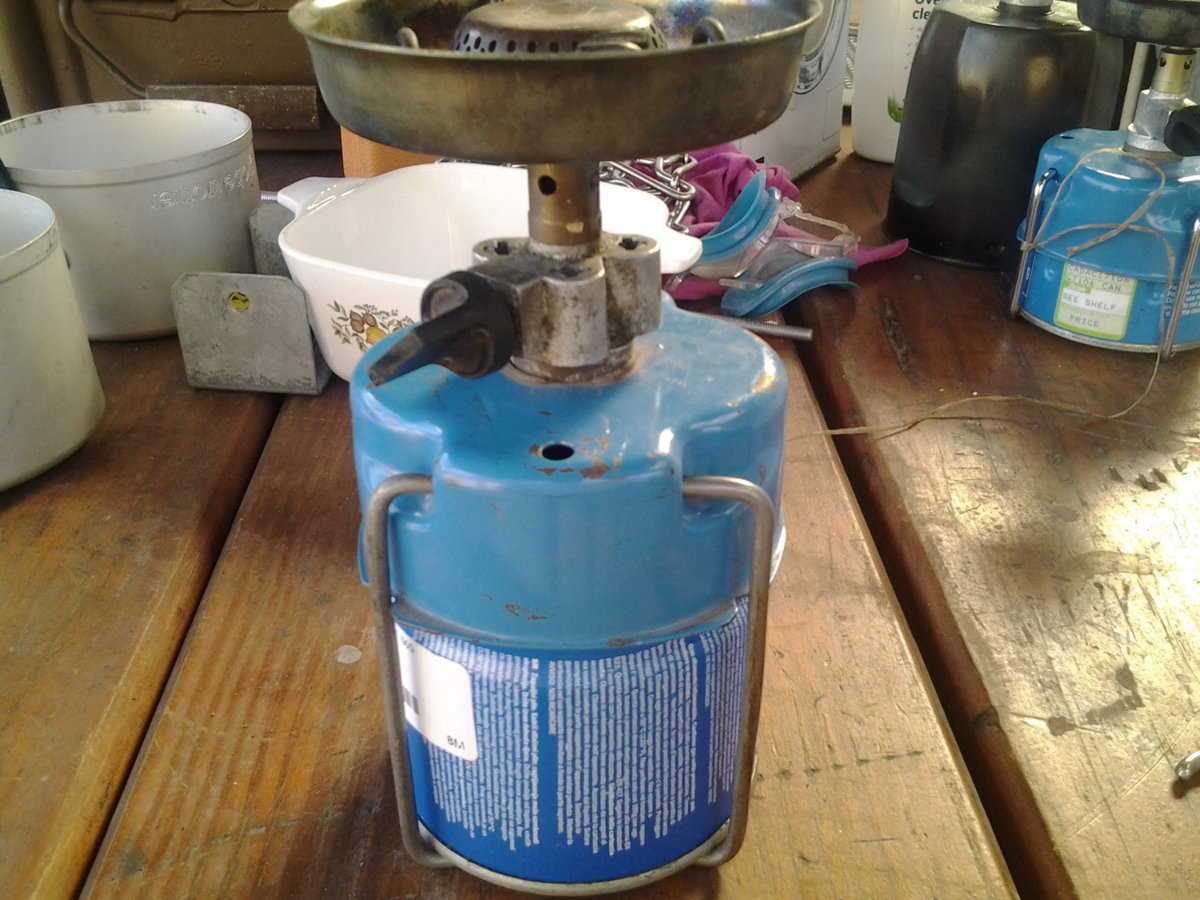

    The background to this is that I’m trying to put together the hiking equipment tha I had, back in the late 1970’s early 1980’s.
    After about a 40 year odyssey, I’ve managed to find just about everything... A Backpacker Kestrel III, A backpacker Elephant, Backpacker Benerdorm sleeping bag, and the Gaz Globetrotter cooker...
    But, there is a niggle in the wood there because as we know, the 90g canister for the globetrotter has become obsolete.

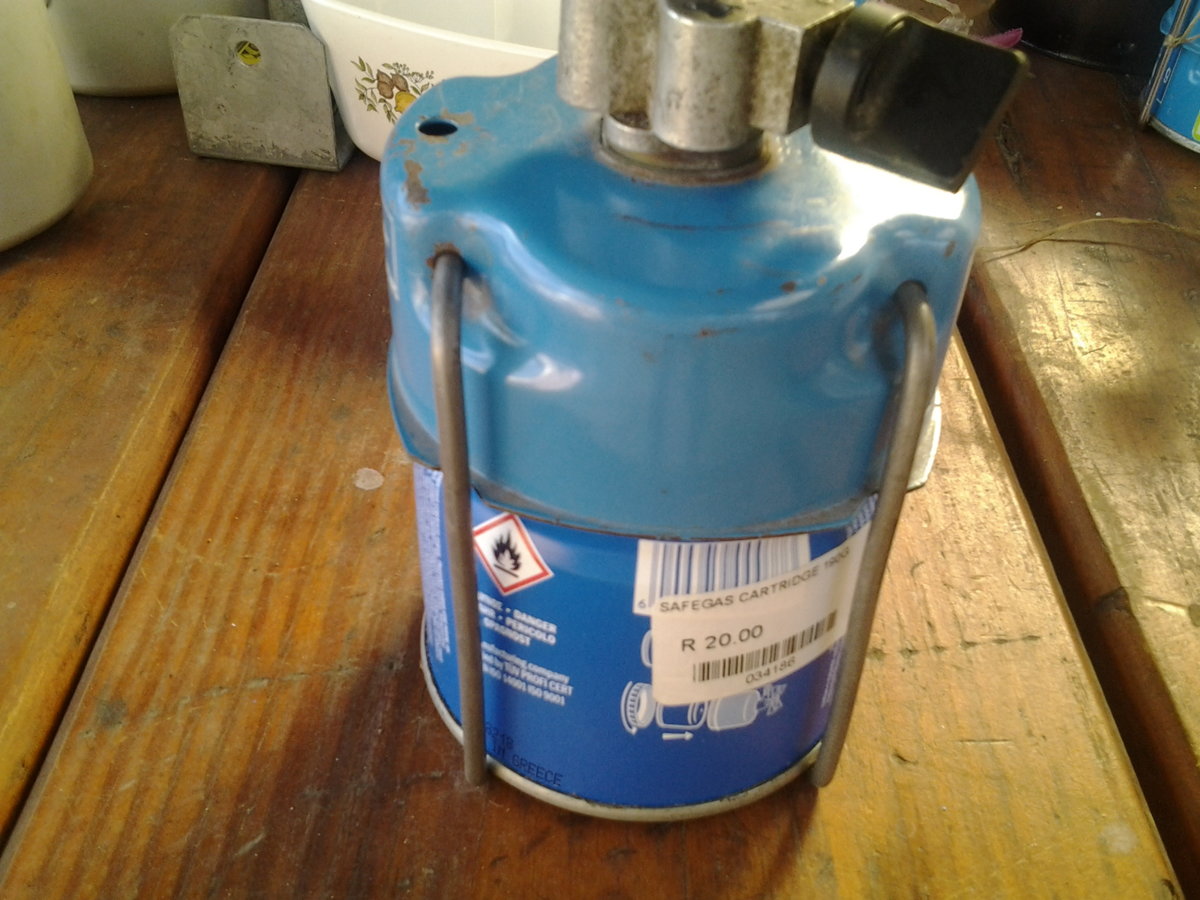

    So, in my search, I’ve managed to actually find two of them, one very scrappy, and the other almost brand new. So much so, The 90g canister that’s clipped into the burner, and still has gas in it, is probably the one and only canister that’s been on the burner.

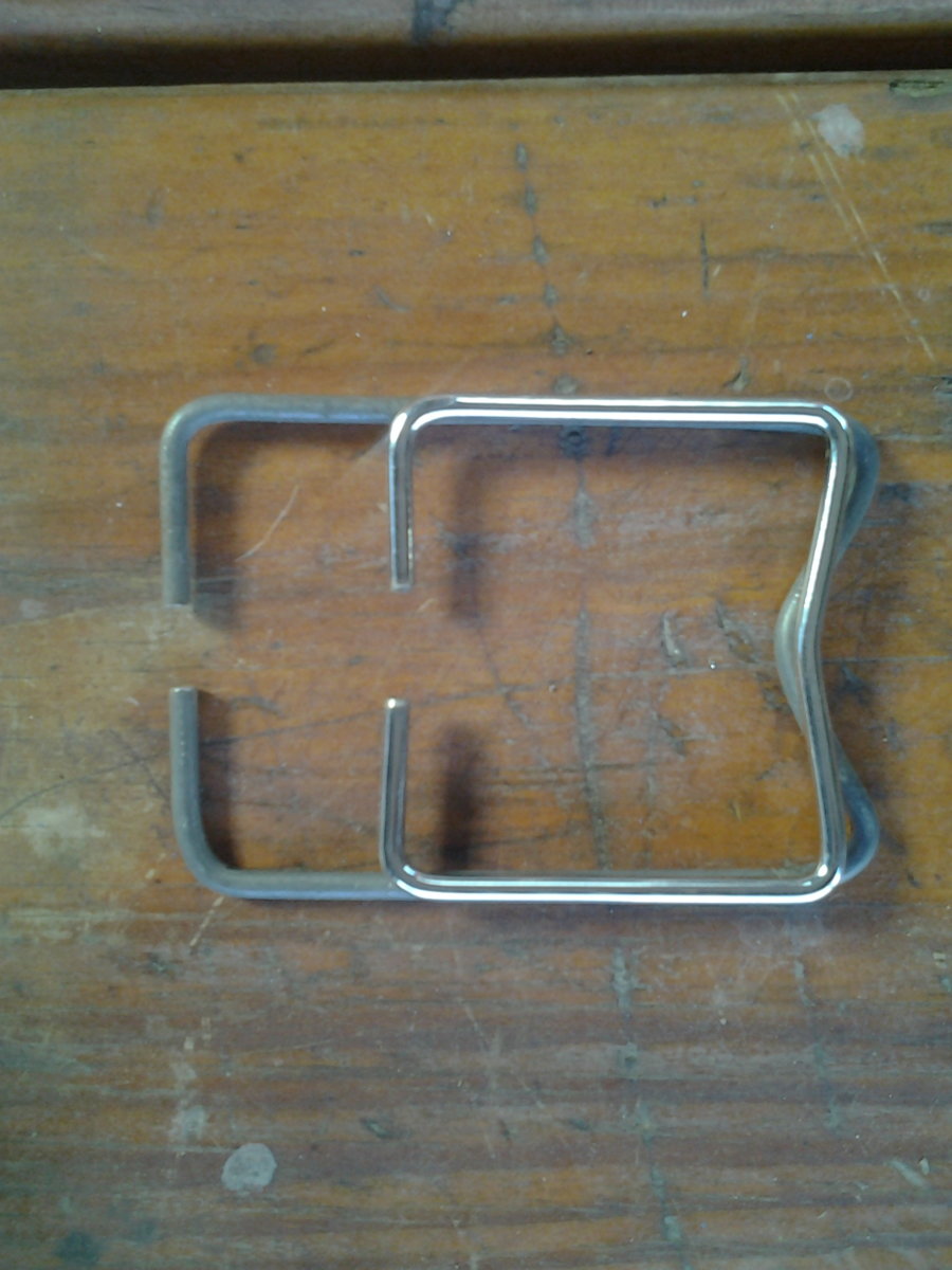

    After much deliberation about cutting the clips and welding in an extension, or bending up new clips I decided to try and bend up prototype clips just for a look see...
    So, The original clips are made from 4mm diameter wire, but I don’t know if it’s a higher carbon metal, or if it was hot bended, or both, so for a prototype, I simply used 5mm galvanised fencing wire....
    And really, A vice, a hacksaw, a file and a ruler where all the tools I used.... It’s so simple it’s stupid
    Once completed, with great trepidation I clamped in the bigger canister, and with thoughts of gas and canister exploding in a thousand directions I screwed down the burner & punctured the canister.....
    And the prototype worked perfectly, so much so, I’m not going to make another!
    So for all you globetrotter fanatics, here is s simple a way of modifying the canister clips, to suit the 190g canister, without having to ditch the burner.
    Personally I so much prefer the globetrotter’s burner because it has a little windshield round the burner, whereas the other types don’t, or the windscreen is too far from the burner.
    Ok, so that’s part 1 of the whole modification.
    Now because it’s taller than the original, the two billies won’t close over each other, so I’ll be fashioning a tube out of a thin piece of aluminium sheet that will go round the canister & burner but inside the billies so the the billies will be like caps over each end of the tube....
    Here are some pics, I’ll do comments on each of the pics, just click on them.

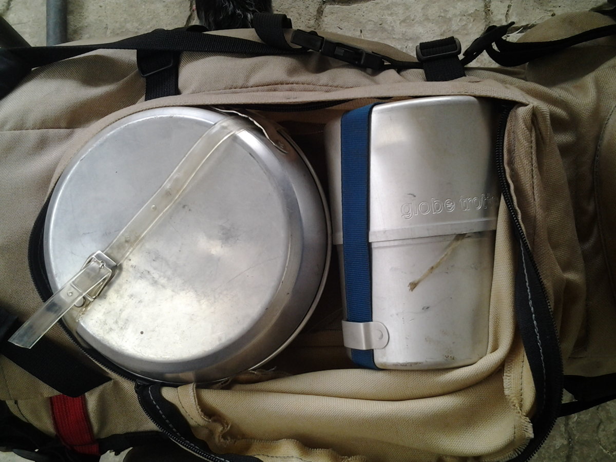

    Cooker
    Backpack, <Backpacker elephant>

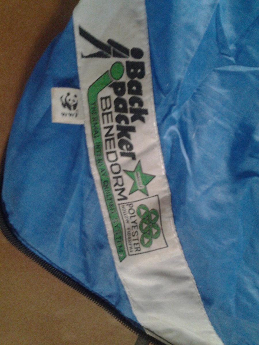

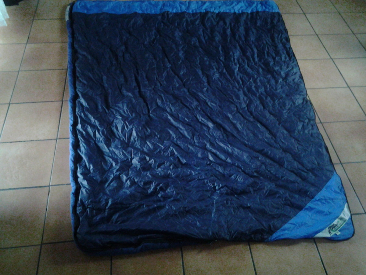

    Sleeping bag Backpacker <benedorm 3 seasons>
    Mess kit

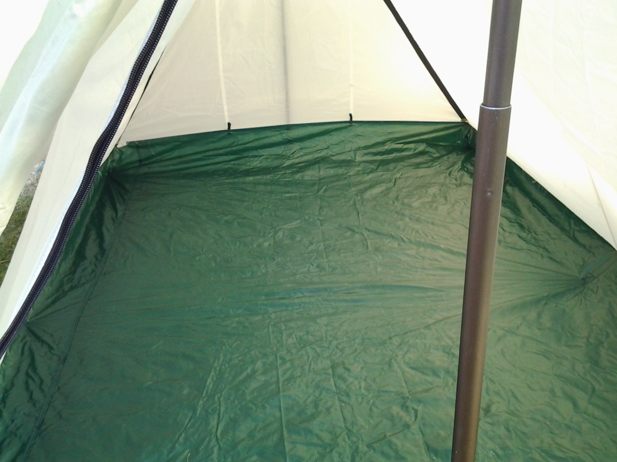

    Tent Backpacker <Kestrel III>
    Back then, in the late 70's early 80's this was the finest gear money could buy in SA.... Until the advent of the geosedic dome, this tent was the tent of choice worldwide for Himalayan expeditions.... beat that!

    Update on the Gaz mod....
    Seems I wasted a Sunday! bendin and twistin and restartin.......... Went to the flea-market last Sat, and I could have bought a junked prick system cooker with extended legs for R20 bucks ZAR
    Bwhahahahaahwaaaa :doh::doh:](*,)](*,) :rage: :cry: :cry:
  14. It'l Dodat
    Feb 6, 2018
    141
    Johannesburg
    So I popped in at the flea market and got lucky.... Another Globtrotter complete with billies and handle, and 2 UNUSEDcanisters....
    The burner's well used, the billies are OK, one has a minor ding but it's the cannisters.....
    So now, I have a pristine unit, with a half full canister clipped in and 2 unused cannisters.. She's gonna be, <As somebody here said>... A shelf queen.
    Brings my globetrotter collection to 3, one pristine, one OK but self modified <see above post> for the bigger cannister, and one, without a handle for spares...
    I've been dragged away from the project of making a wind deflector / billy-can tube for my modified one, because I'm re-configuring my Landrover Discovery II into a one person camper, so that I don't need to tow.... So far I've got it asll functional, but I've got to get it ready for June 16 holiday get together, but I'll get there...
    The pic of the self modified one... Stupid me.... Spent a goodly part of Sunday afternoon bending legs, when I can buy a junked Gaz cooker with the longer legs..... Saw it the week after I made mine, Last week it was not there, but the seller says he'll bring it next week...
